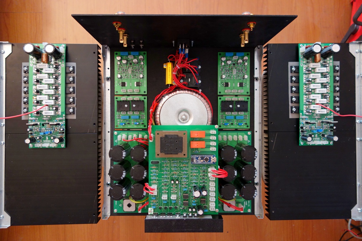

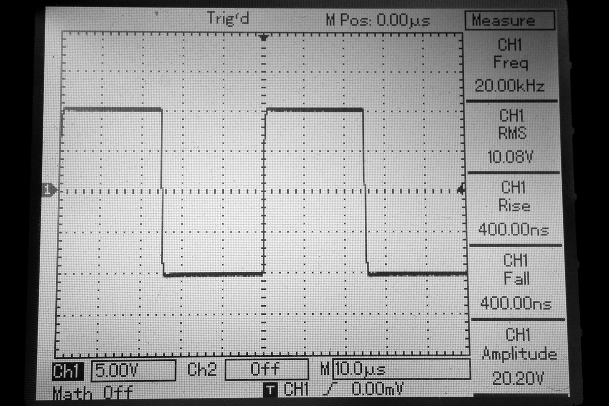

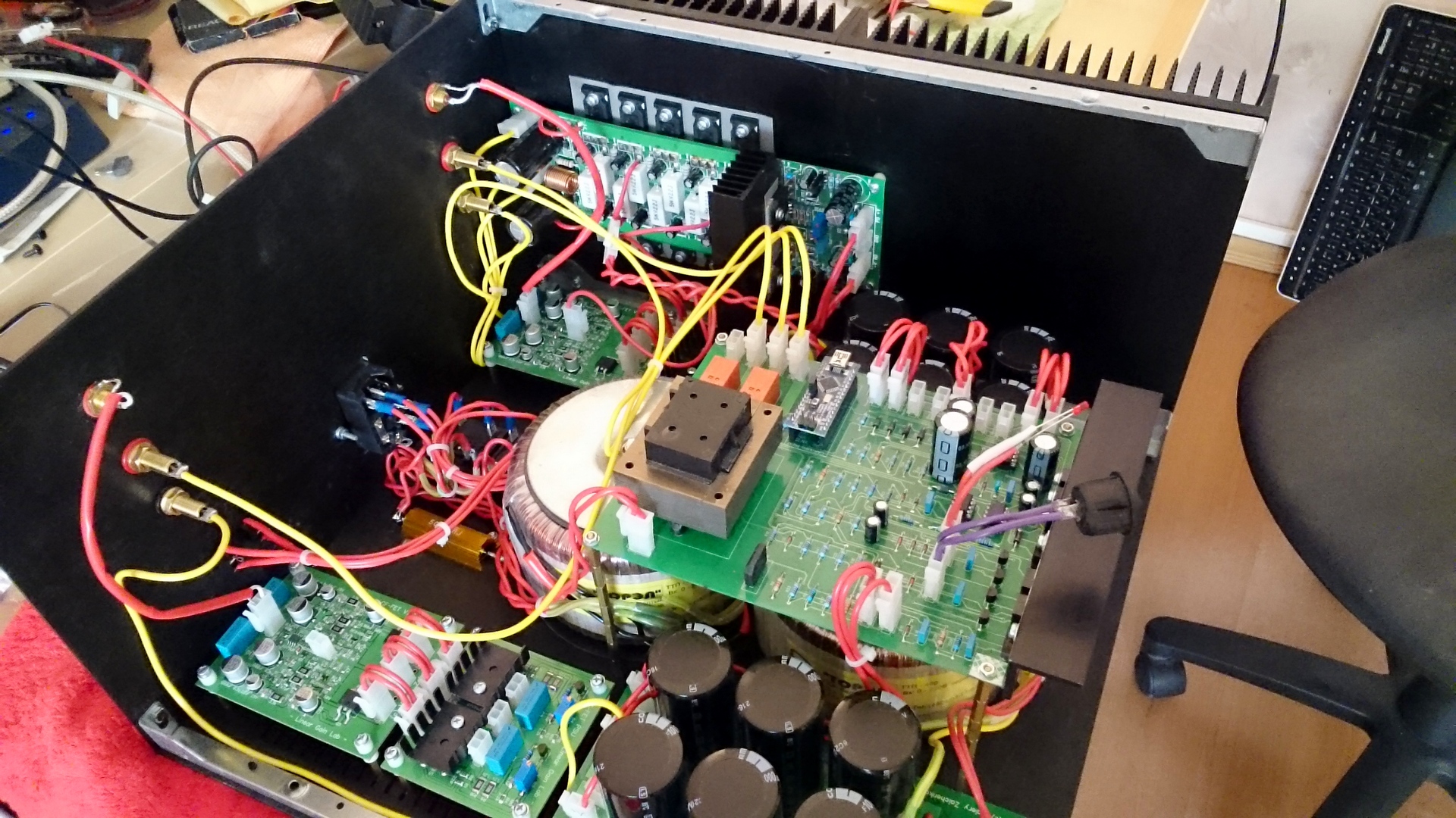

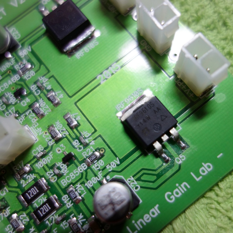

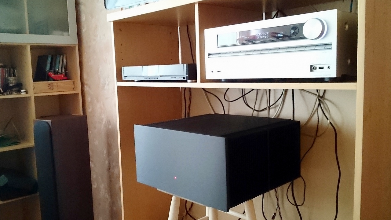

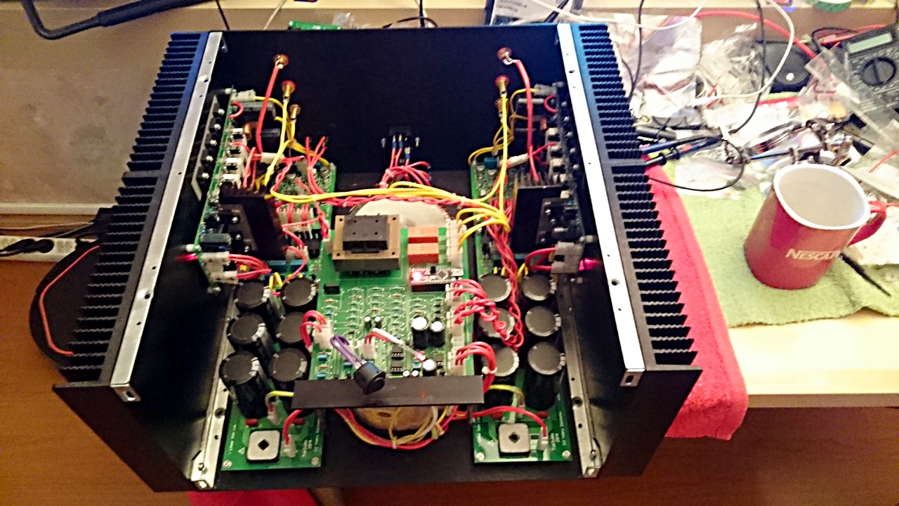

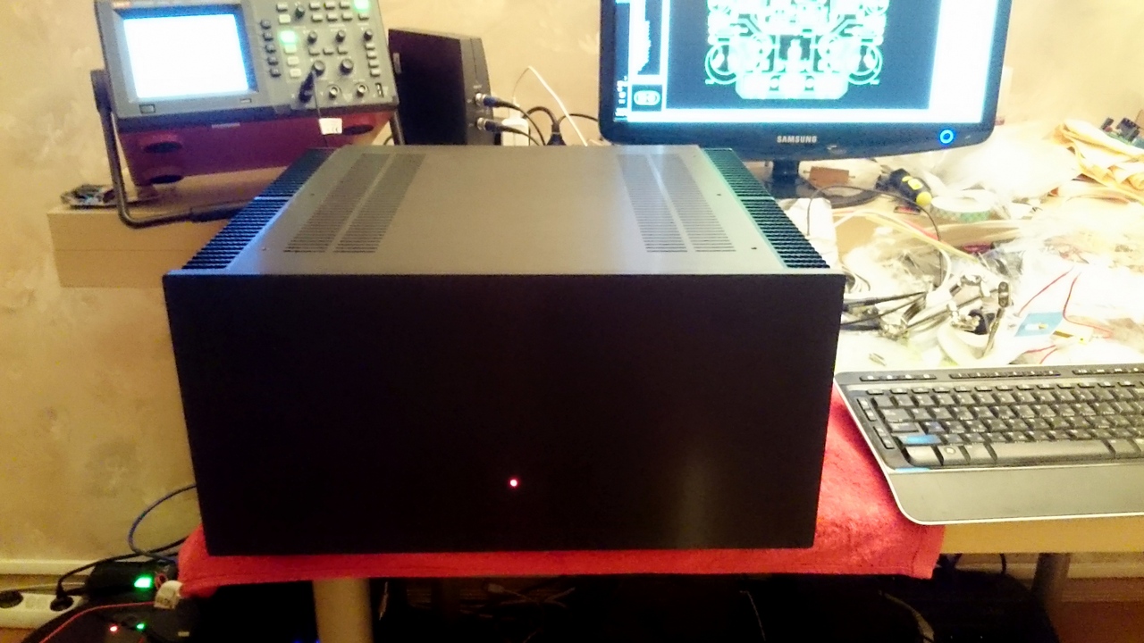

My power amp - CF-FET-V2.0
OK, it's already described in CF-FET thread, here are just some pictures.
Starting from the front-end PCB and early prototype testing, and ending with a finished "product".
I'm using it as a main power amp in my audio system now

for looks.
Even more ironic when you follow the route/wire from the output coil to the output terminal, Terry.
Coffee?What was there inside that Nescafé cup?
Coffee?
Sure, but hope not soluble. Would not look good beside that beautiful amp.
I agree. A little too close for my comfort, but to each their own. My liquids are always kept at least an arms length away. No jewelry either when around electronics. Learned that from an old Navy tech about 45 yrs ago.Sure, but hope not soluble. Would not look good beside that beautiful amp.

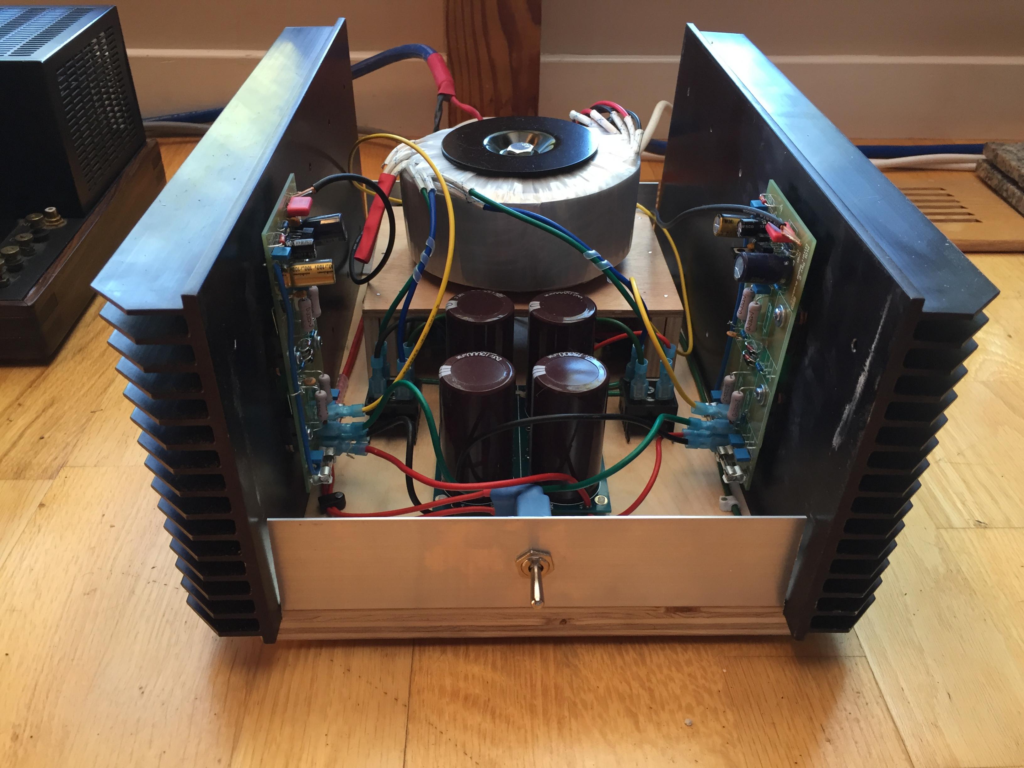

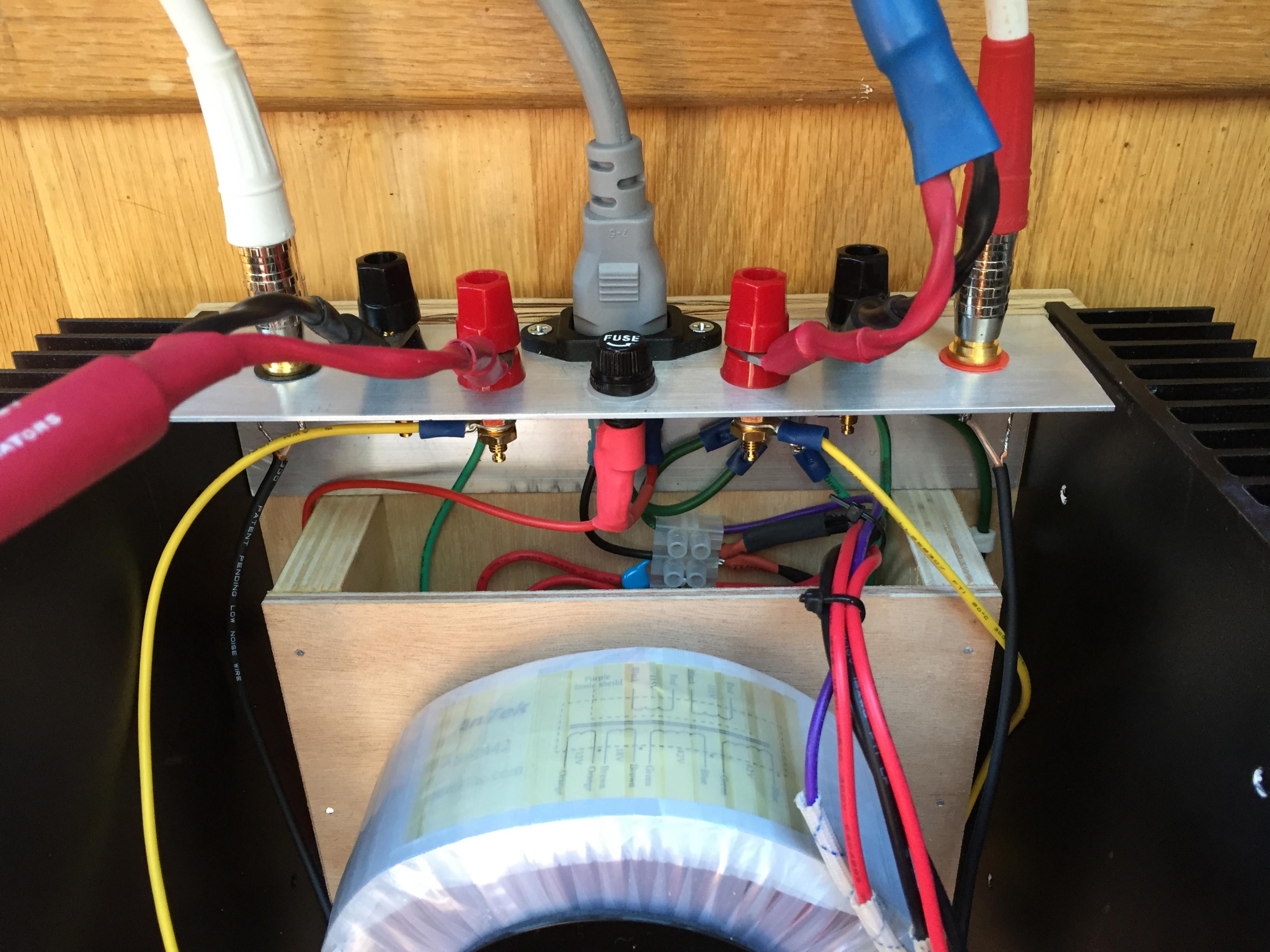

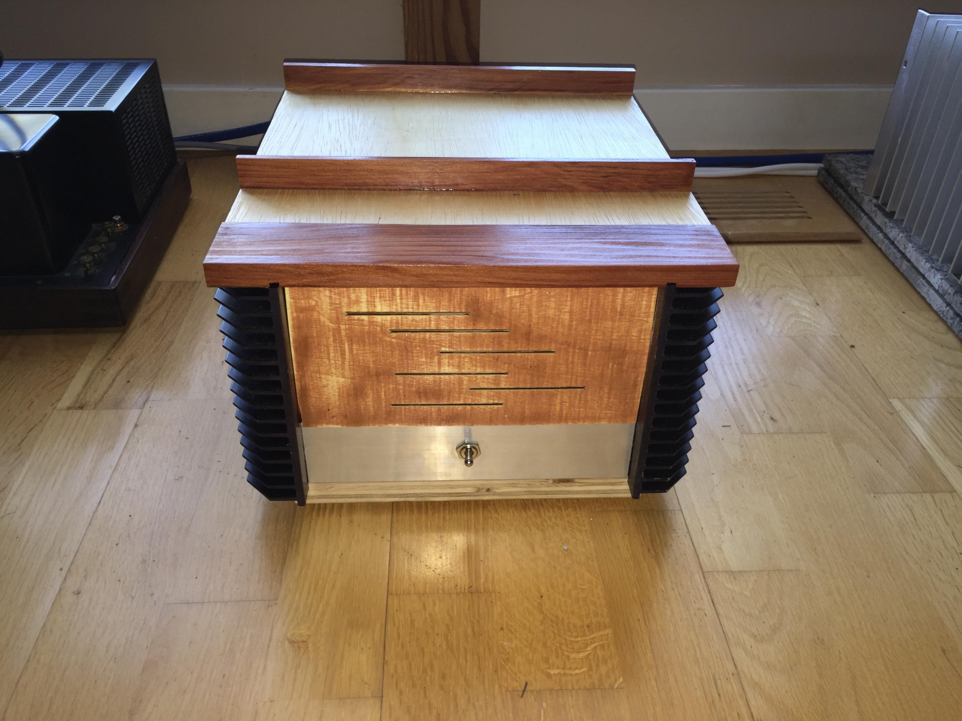

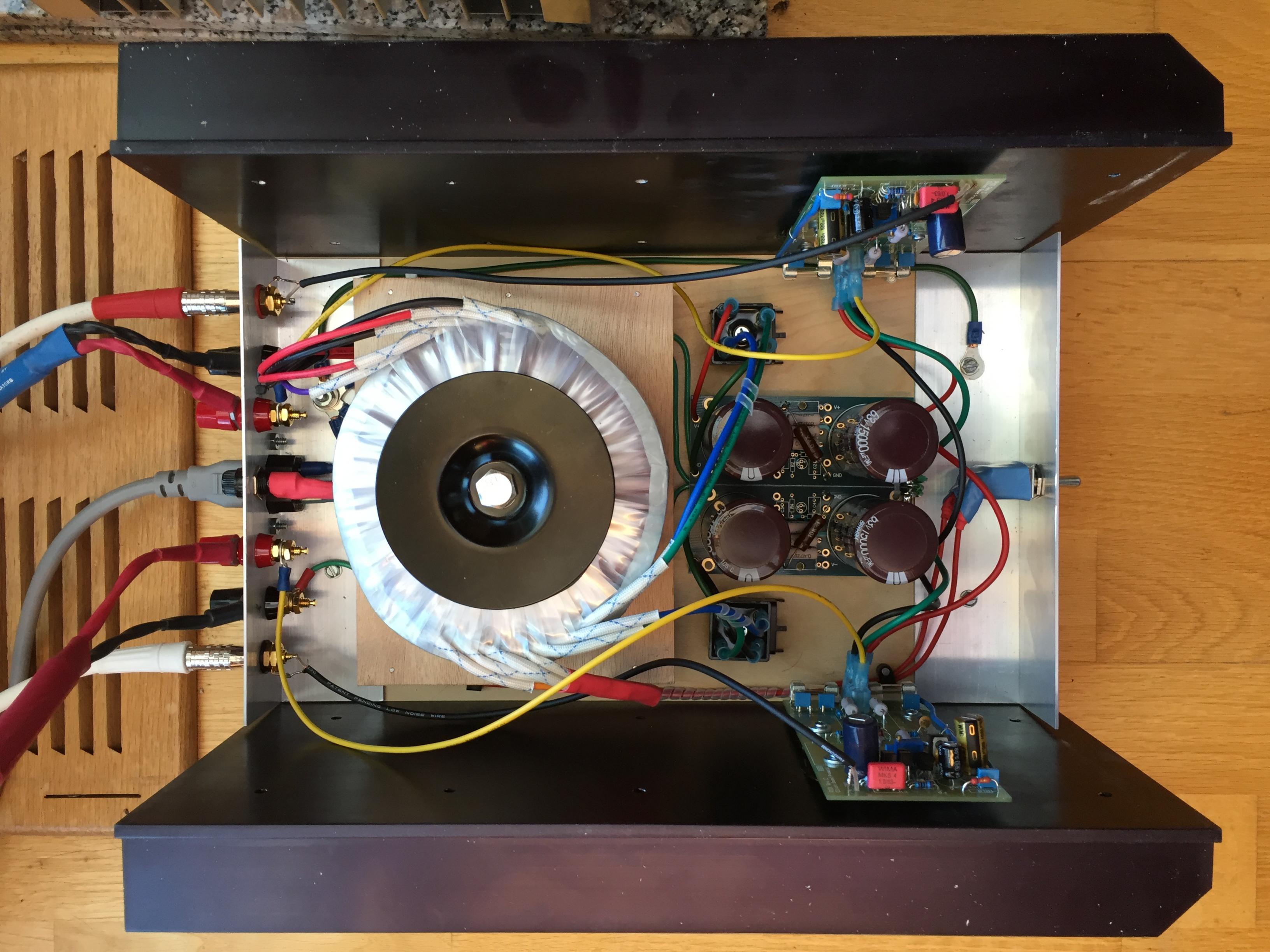

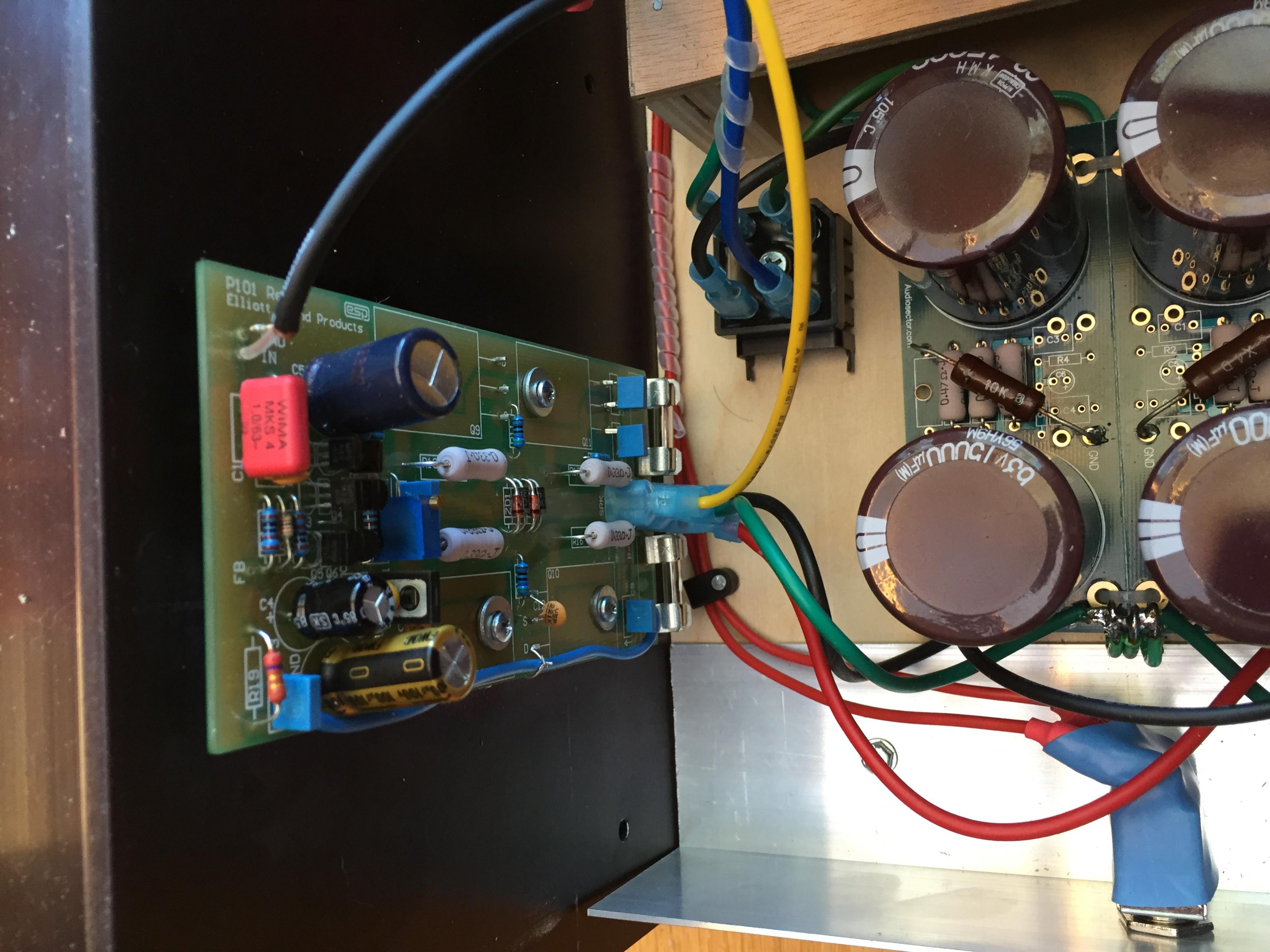

Rod Elliot P101 build
Inspired by Burning Amp, I just finished my new power amp. This is Rod Elliot's design, with his soft-start board and a diyaudio power supply board.
Shockingly clear and analytic so far with my (ridiculously efficient) Pi Seven speakers.
The case is not what I would like aesthetically, but for now it does the job. The metalwork is part of an earthing network that terminates in a star by the IEC socket and at the output end of the power supply.

Looks like the front heatsinks are just to for looks. I'm too cheap to do that. I would have to find something to mount on them. Beautiful amp!
Well, the heat still distributes to the front sections, however they are definitely less warm than the back ones. This is a result of not enough thinking when arranging the PSU
Very valid observation Already thinking about moving the relays right to the output terminals (and probably switching to the SS ones)
