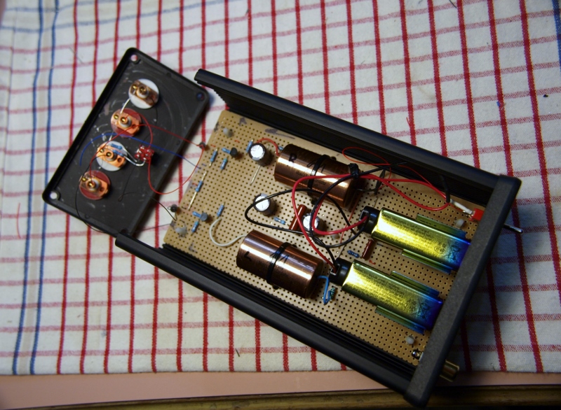

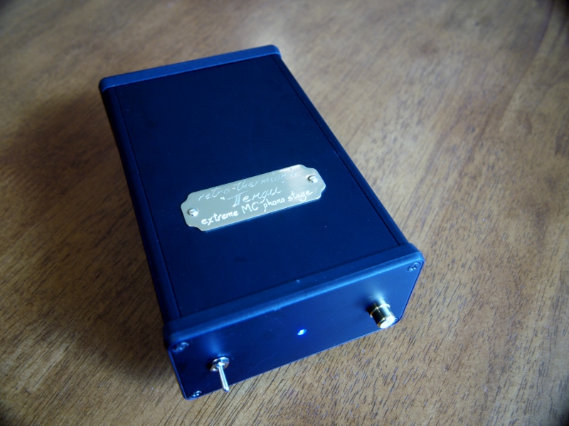

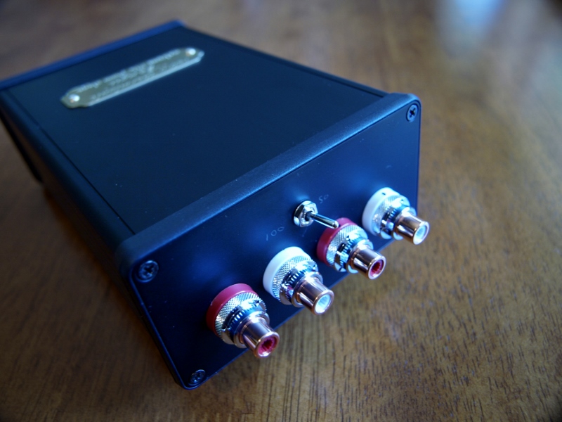

After building the Boozhound Labs MM and dedicated MC stage featuring the Russian PIO caps, I was inspired to build an extreme version of the MC stage. I was very impressed with the performance of the MC stage built from a kit. Having at hand some ultra expensive Audio Note (AN) caps, I thought what better use.
The AN are silver foil, paper and oil clad in a pure copper outer. The leads are fine silver wire and the caps currently sell for AU$427 each! To further ensure this was going to be a "killer" build I added Vishay resistor, Nichion electrolytic caps, solid copper high-end RCAs and a Hammond enclosure. All hook-up wire is silver plated fine copper and solder is WBT silver solder.
Construction is on Veri-board, there is a battery test point at the front and a soft blue "ON" led. On an initial listen the bottom end appears a little richer and the sound stage more defined. But early days. The cost of parts is over AU$1000! "Tengu" are Japanese mystical creatures let's hope this has a mystical sound to compliment the price.

my god i love this , audio porn
i wish i could hear this. fantastic taste sir

Just spent 6 hours listening to it with my new tube MM stage at a mates place. We both agreed it was very good though new. He has massive new quad speakers and the clarity and warm came through. Happy so far. Long way to go.

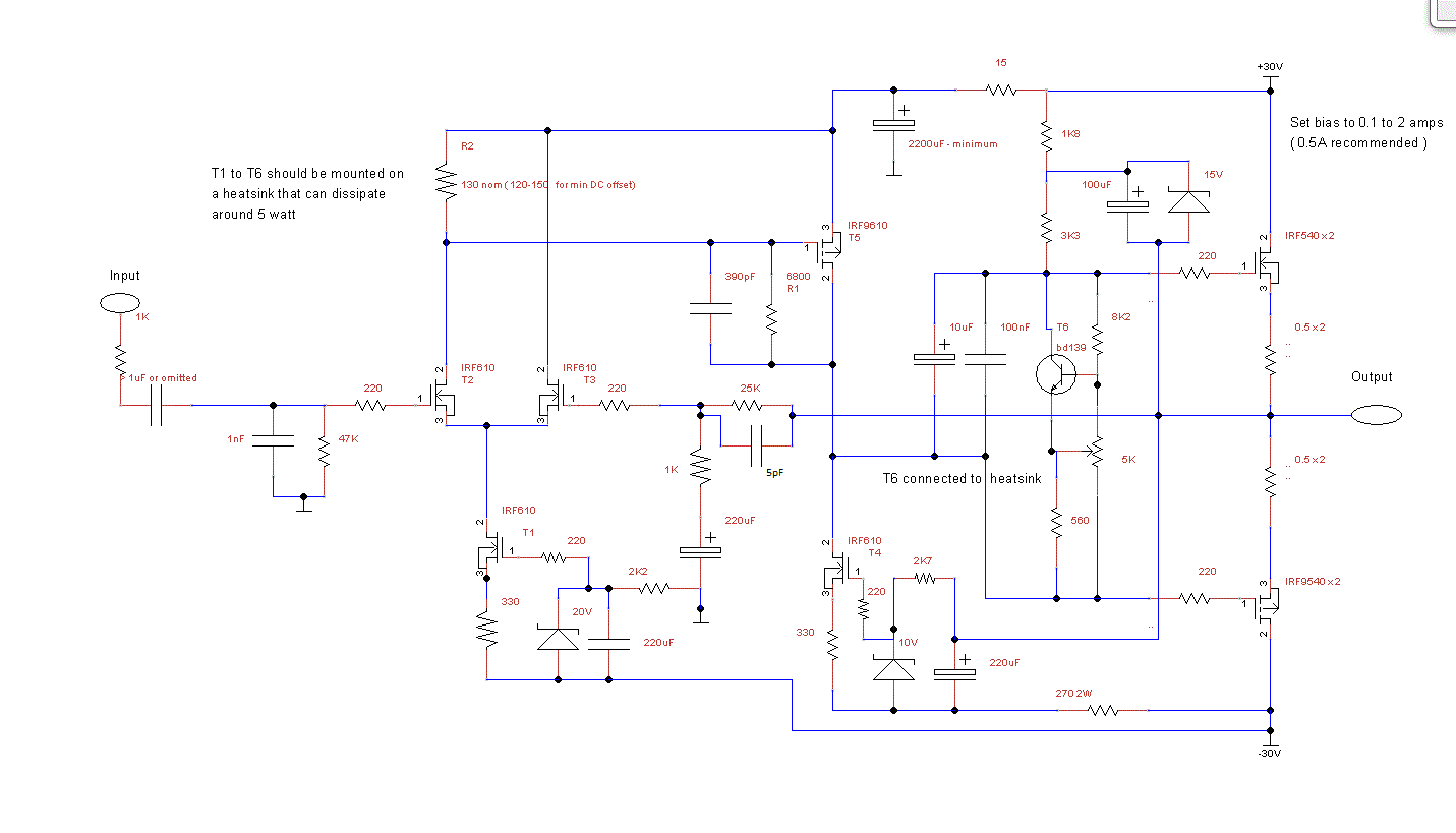

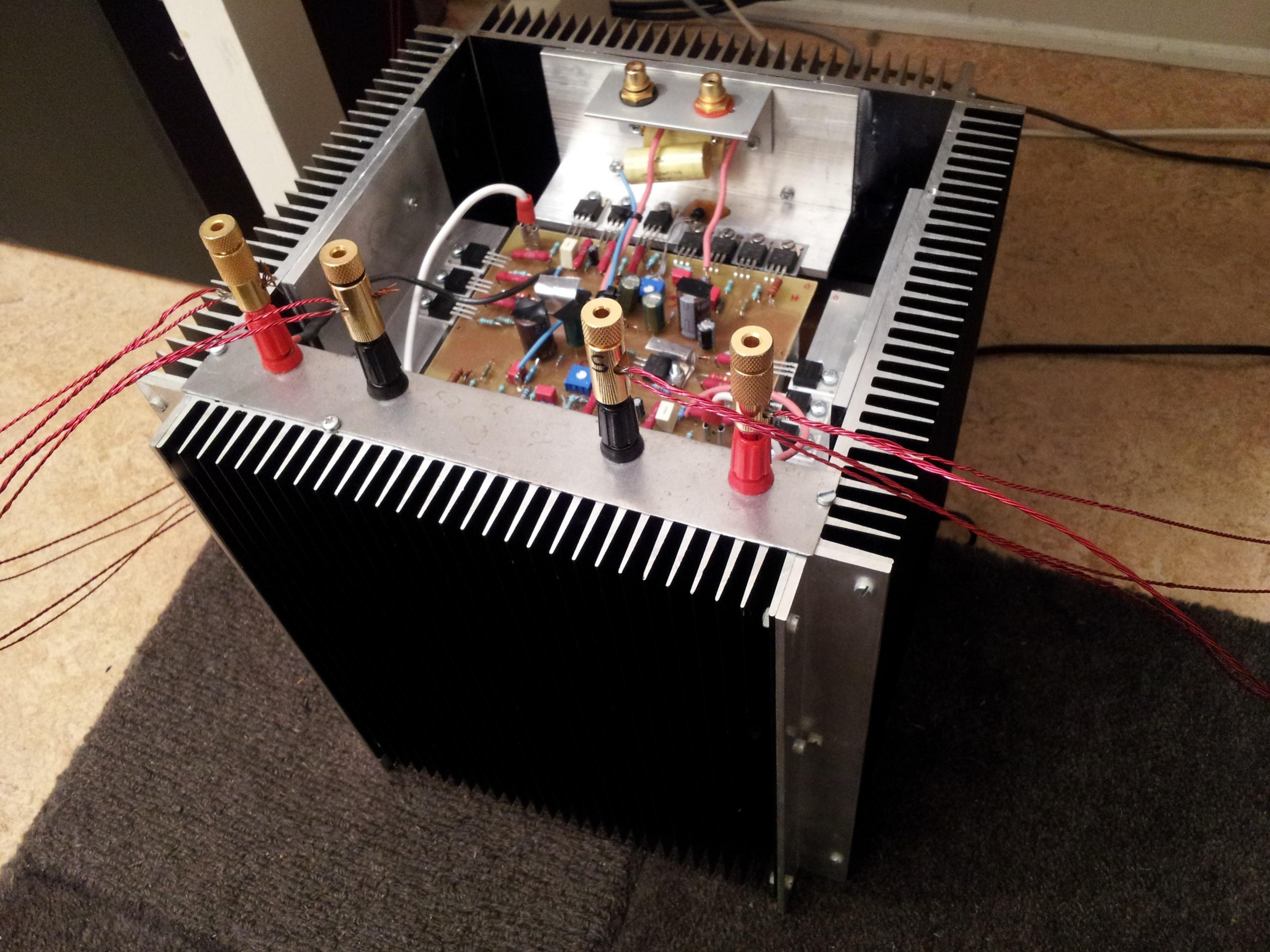

Here are two power amplifiers I constructed one or two years ago, and I think some may find them interesting and perhaps decide to build one for themselves.
Many DIY people use to build clones of Nelson Pass' amplifiers, such as the Aleph, and some of the First Watts. The first one is a mosfet construction that I call the NDH amplifier ( I have forgot why, but the name is good enough). With this one, I was inspired by the simplicity of Nelson's amps. He seems to like to use drain output constructions, probably since it's a good way to make things simple. I decided to build a source follower and make it as simple as possible, and this is what came up. I like source followers for various reasons. One is that the damping factor can be made quite high without using a lot of feedback. So it should be suited to drive speakers with a difficult impedance curve. I really like the sound of this one and perhaps some of you will find it interesting enough to build one for yourself.
Here is a link to google drive:
https://drive.google.com/folderview...hhNWNsQ0xuelFDeWZMZTFONmg0bUJzMGc&usp=sharing
I have uploaded detailed description and also PCB layouts.

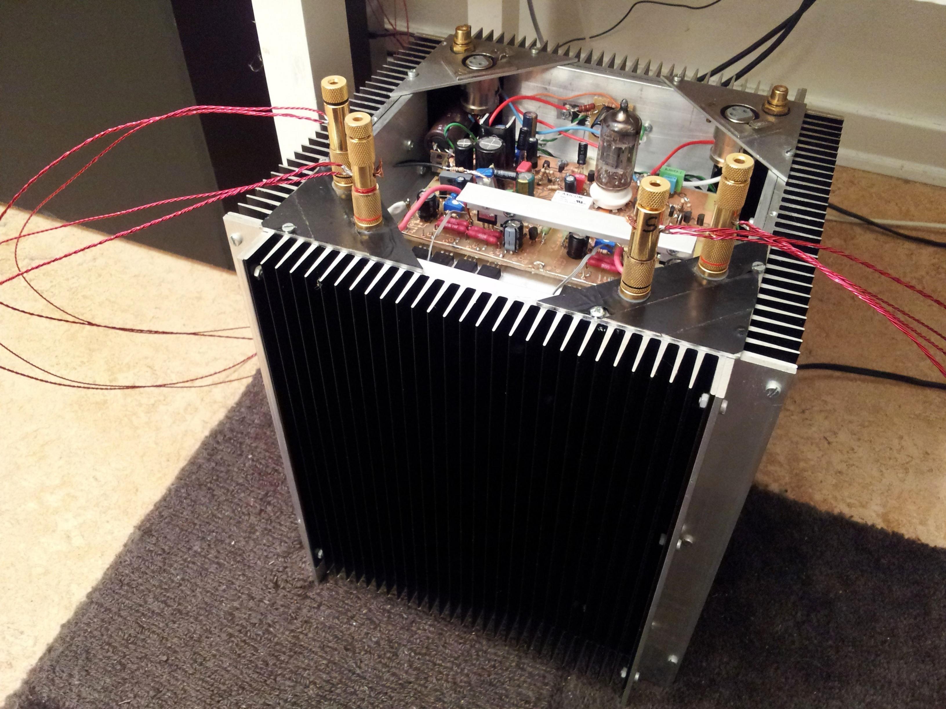

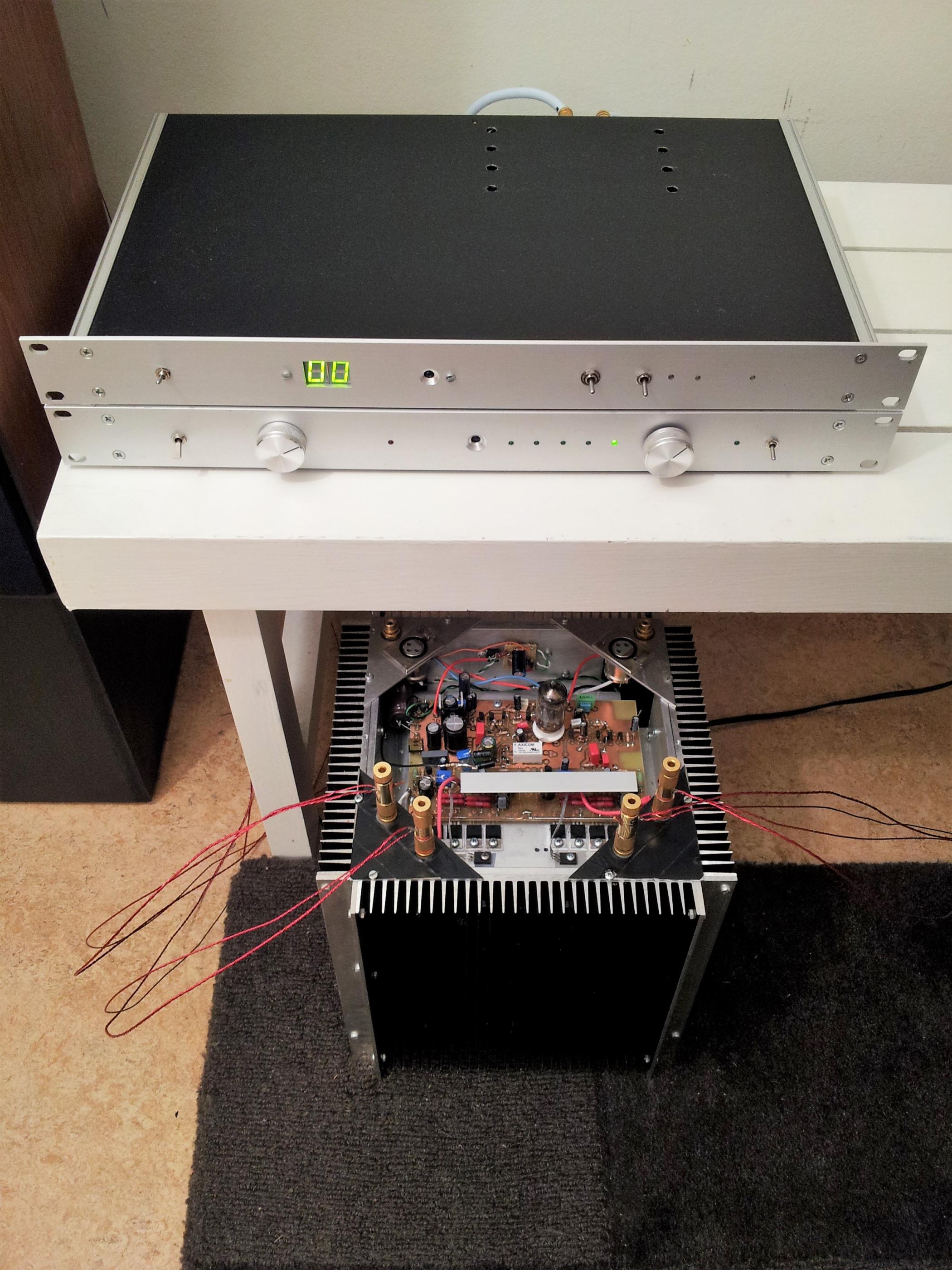

The second one, which I call "Amp667", is a mosfet/tube hybrid, but I will post it under this thread anyway. This one is also made with simplicity as a goal. A single ECC83/12AX7 tube does the voltage amplification, and some mosfet's delivers the current. I think the circuit is a bit unorthodox, but after I managed to iron out some flaws recently, this one is now my favorite.
Read about this one at my very simple site:

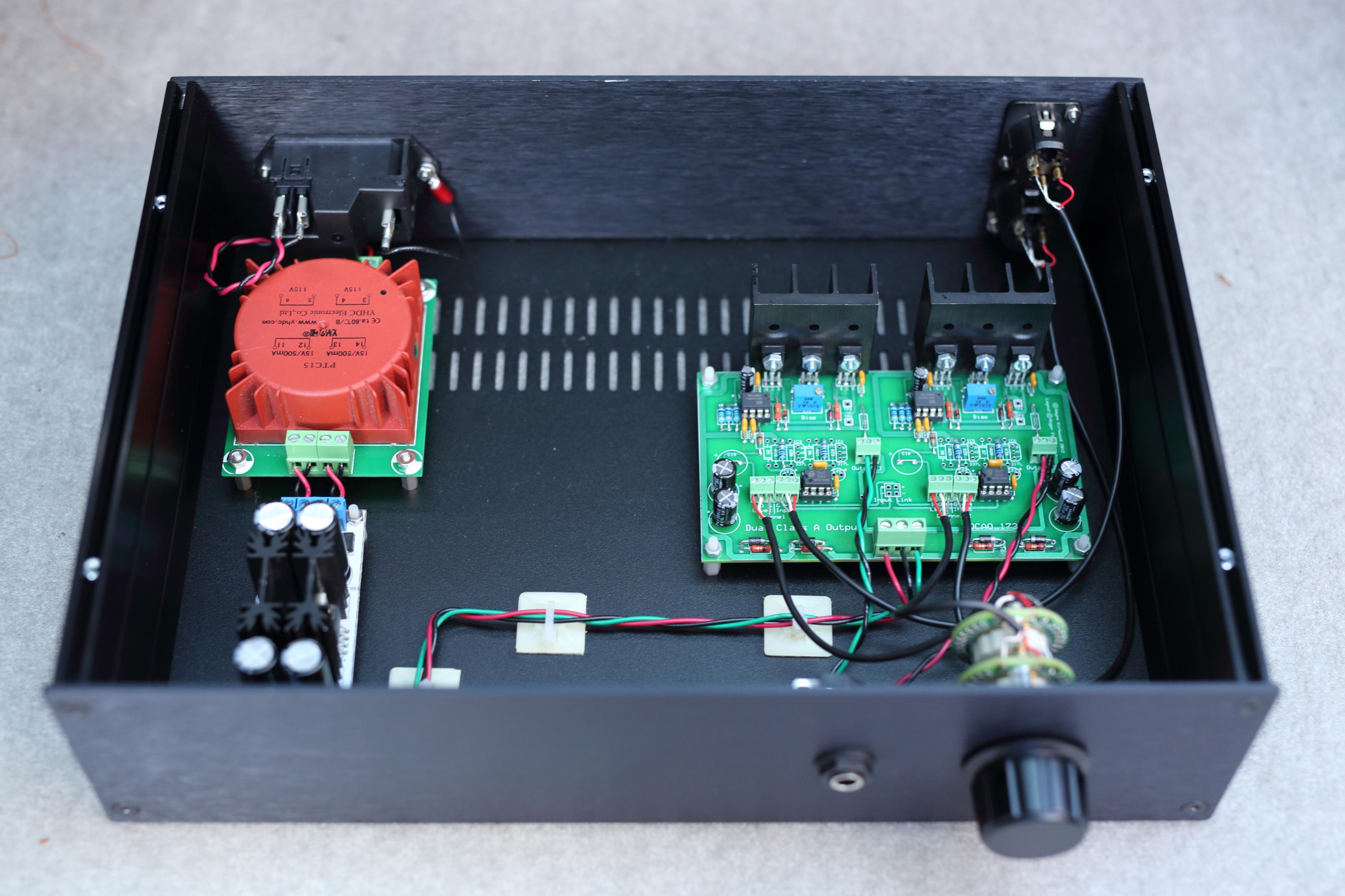

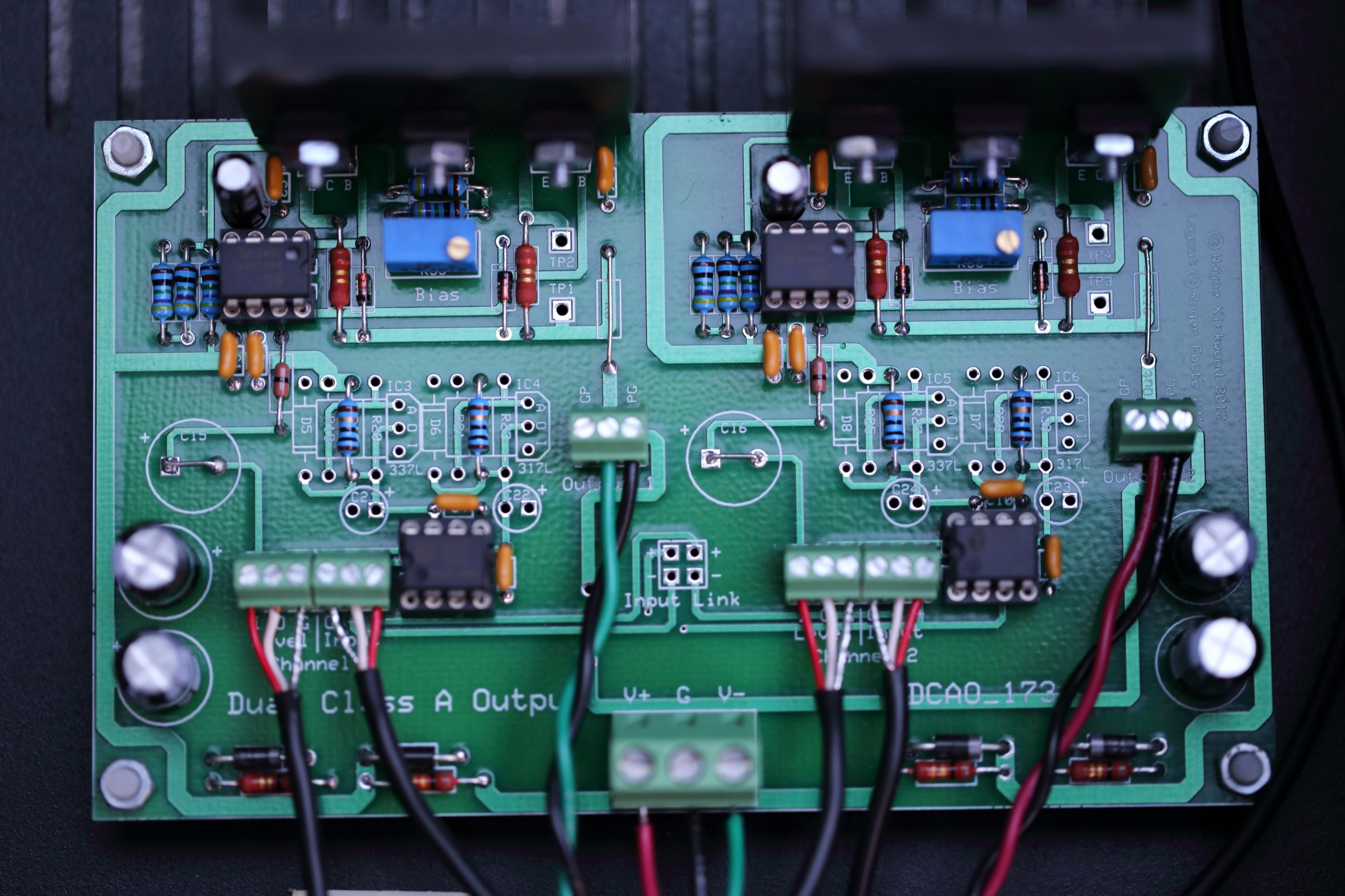

Balanced input, single ended output headphone amp. Many other uses too. Here is the build thread. Pro Audio Design Forum • View topic - Dual Class-A Line/Headphone Output Boards Now Available

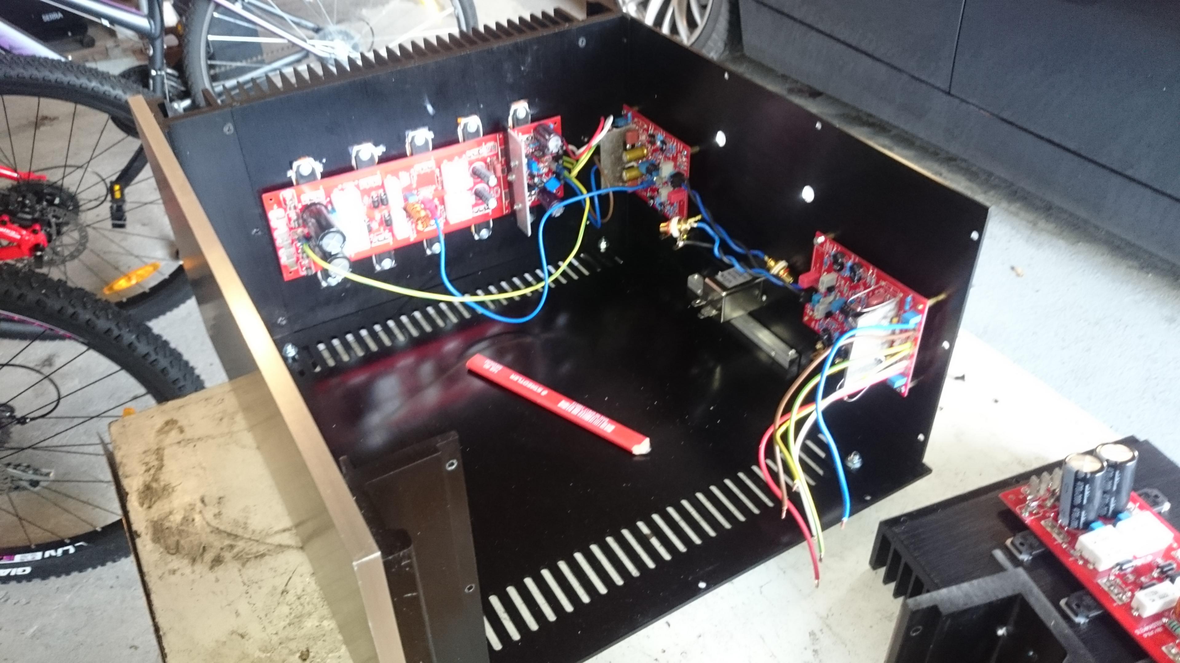

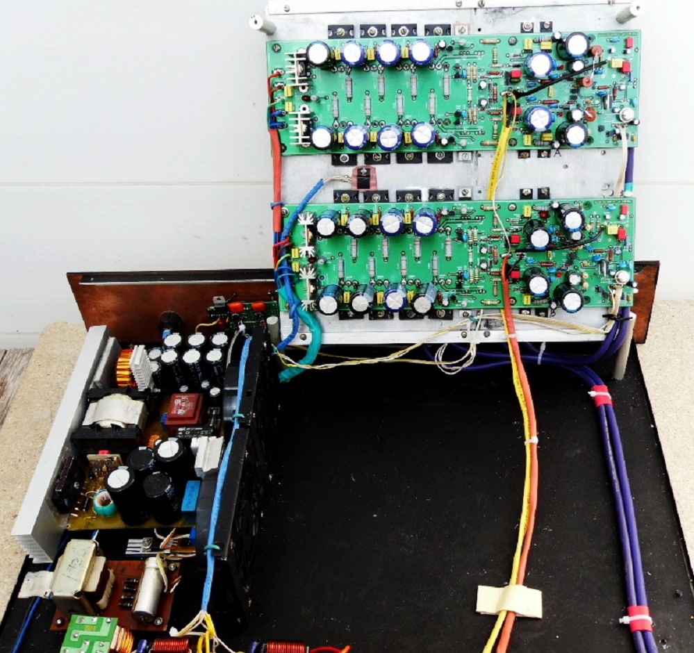

Started putting together a slewmaster.
some chassis details please. and those heatsinks, where can that size be bought?
thanks
gordie

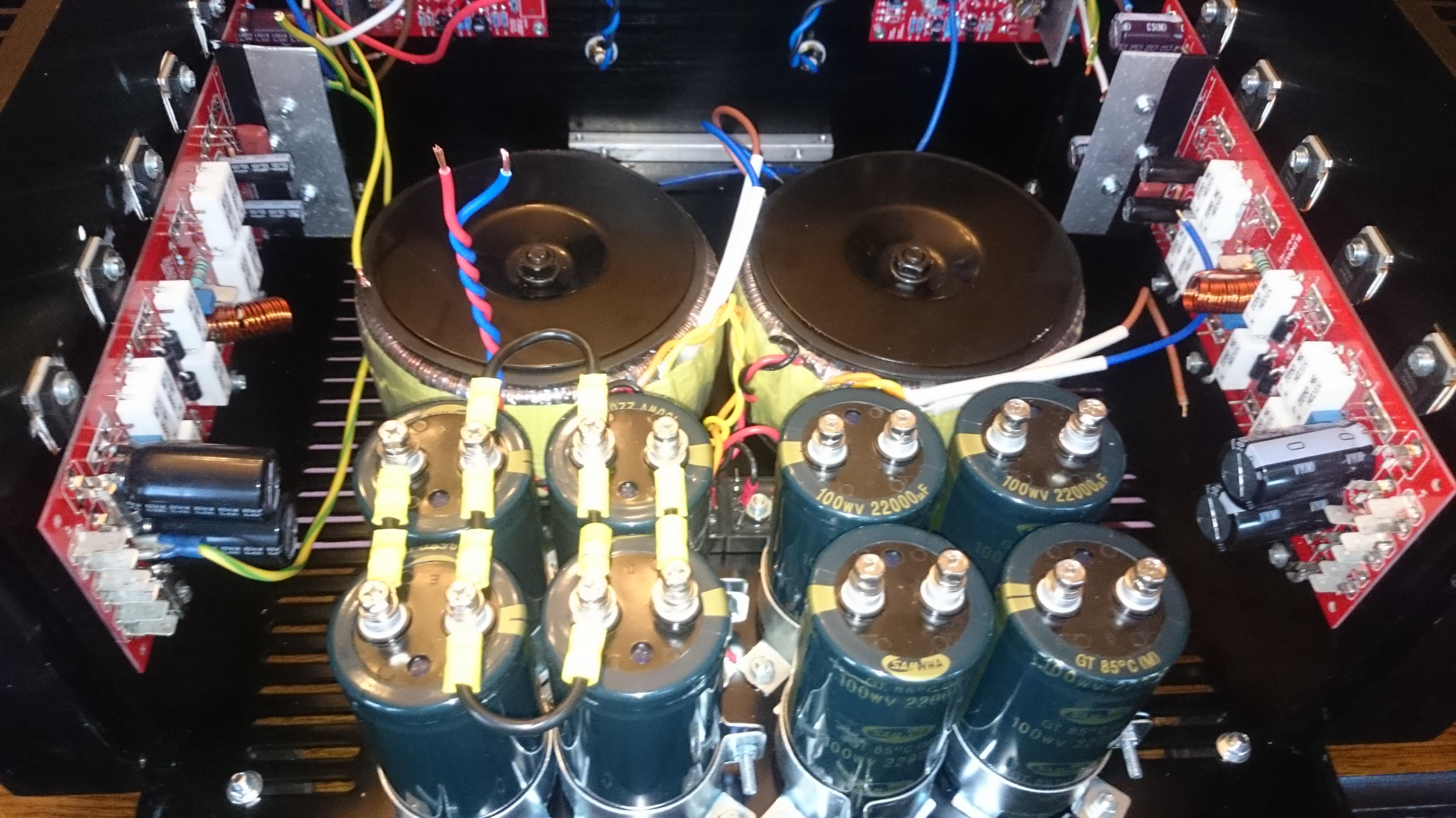

Here's the chassis.
Aluminum Chassis Enclosure Heavy Duty DIY Amplifier Preamp Very Thick | eBay
Got new transformers today 625va 2x55v so now there's just some wiring left.

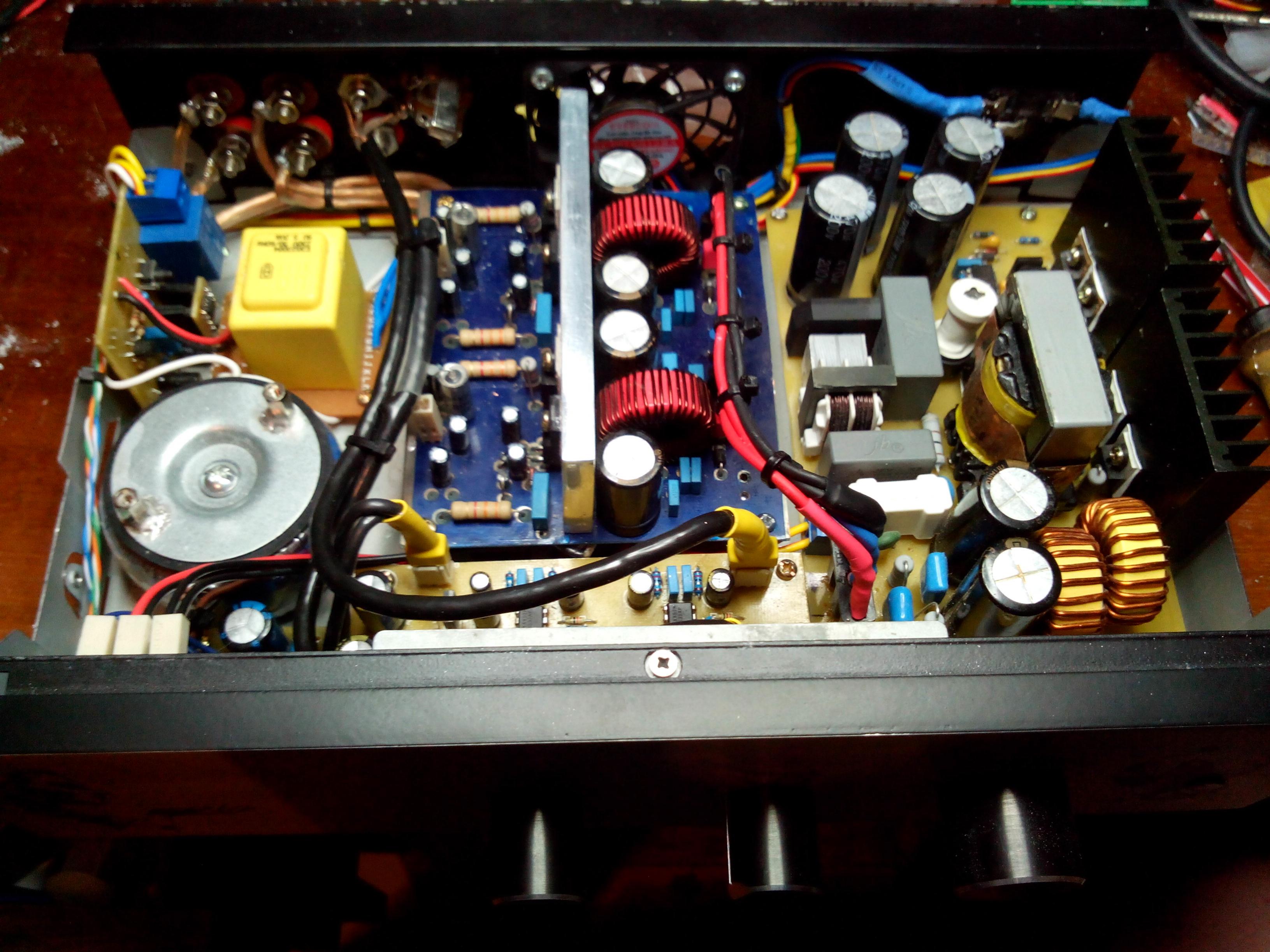

I have built several amps around the 2092 as well and quite like their sound. Of course pairing them with a subwoofer helps the bass tremedously. One is built around the LJM L25D modules and it is a very lively amp indeed.Sertofan, the IRS2092 is meant to be the best gate controller chip around. I have it in a few different Class D amps.

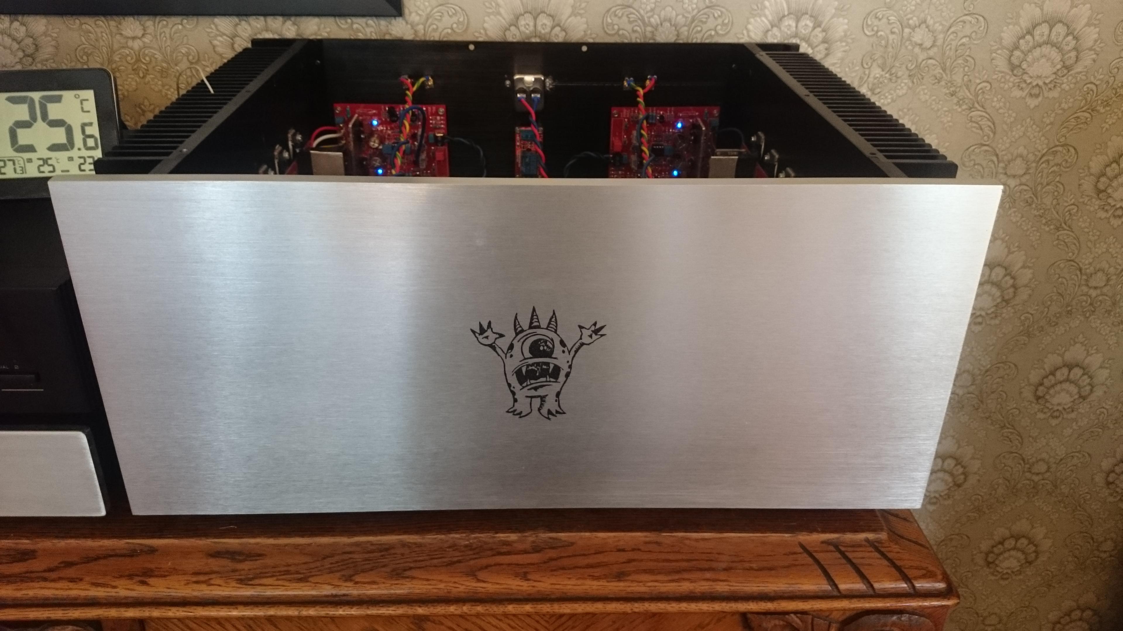

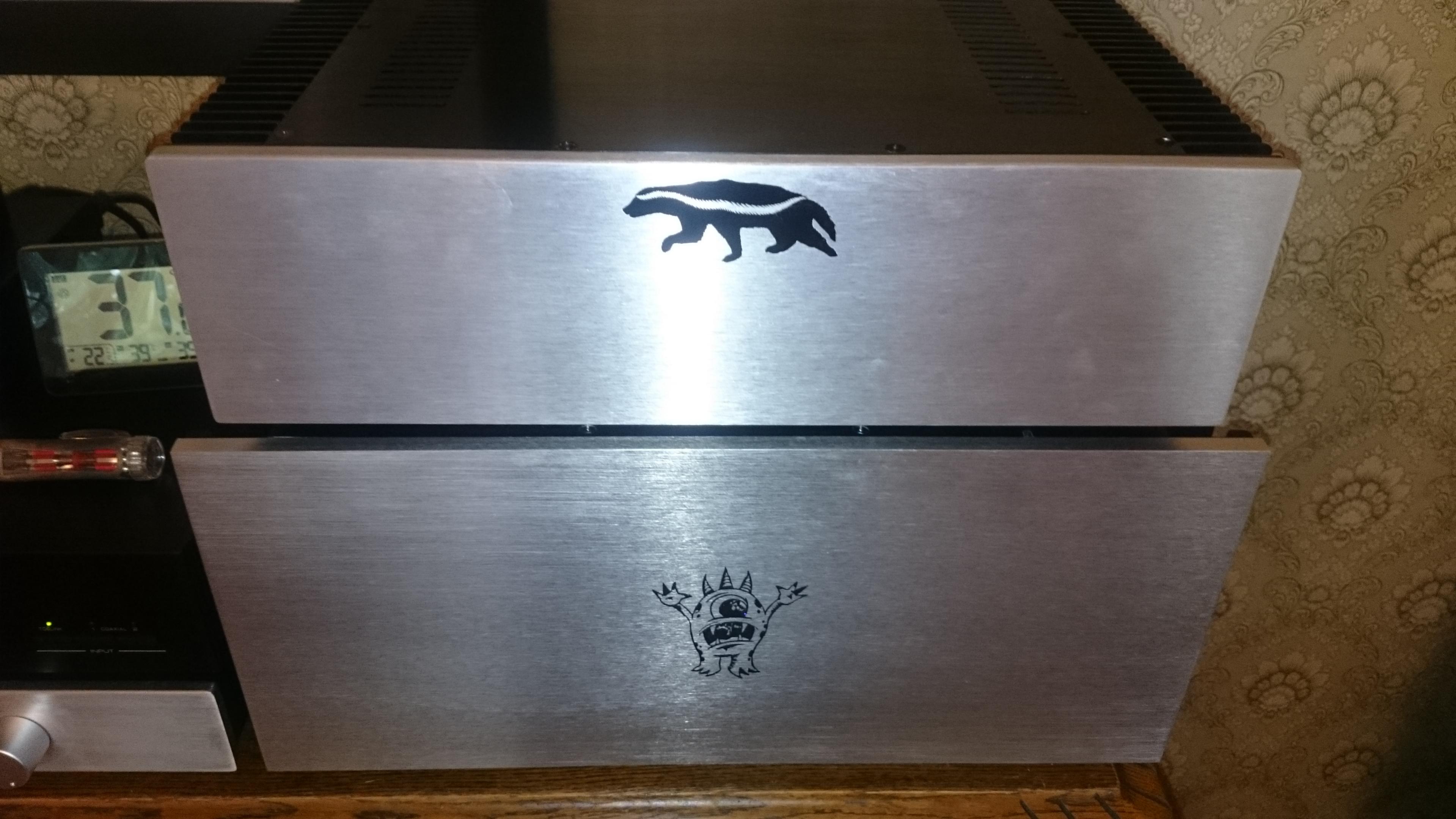

The slewmonster
And there goes my coffee
