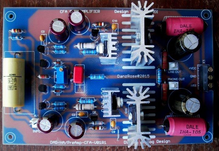

CFA headphone amplifier using JFET input (2SK246 and 2SJ103). It inspired by RN Marsh design (a thread here although I did know the exact circuit).
My jfet model in simulation seem not good enough. Some value determine empirically. Now, I use it as pre-amp. It sound very good.
Next time I will try to drive headphone.

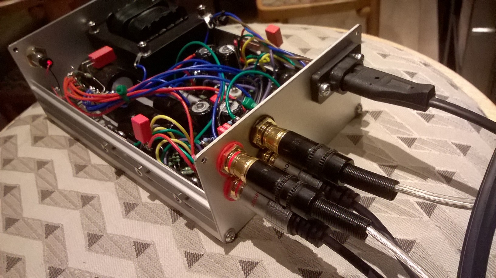

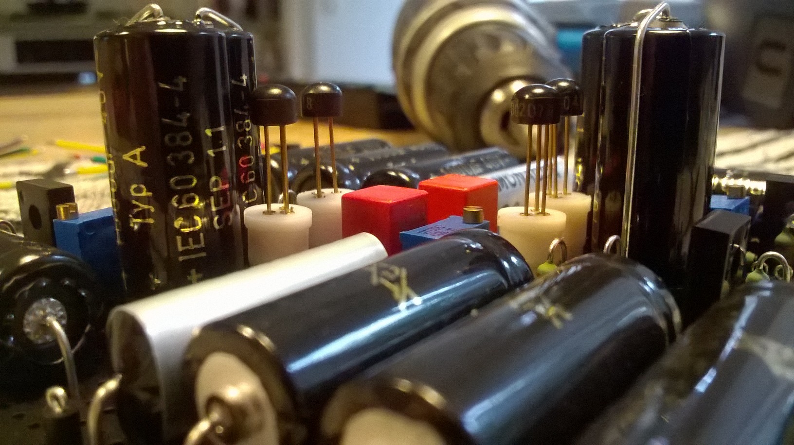

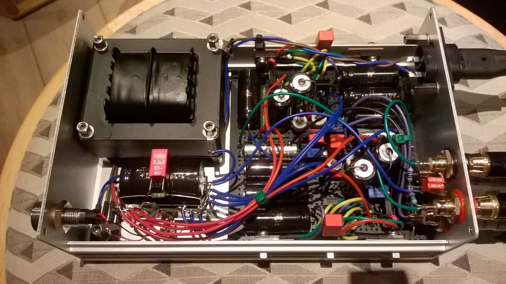

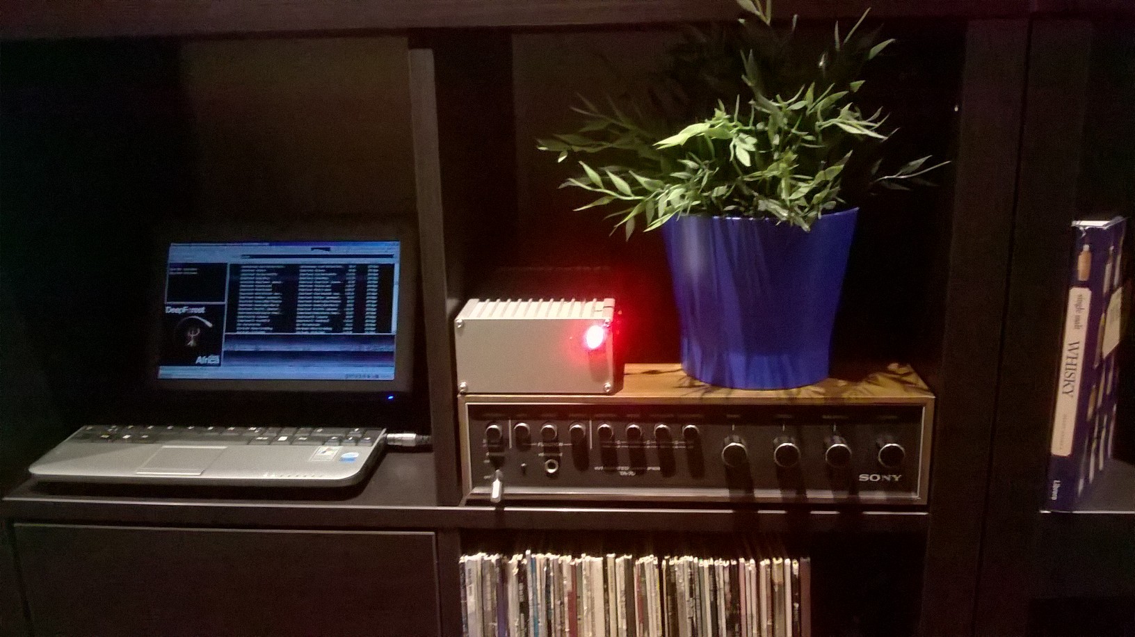

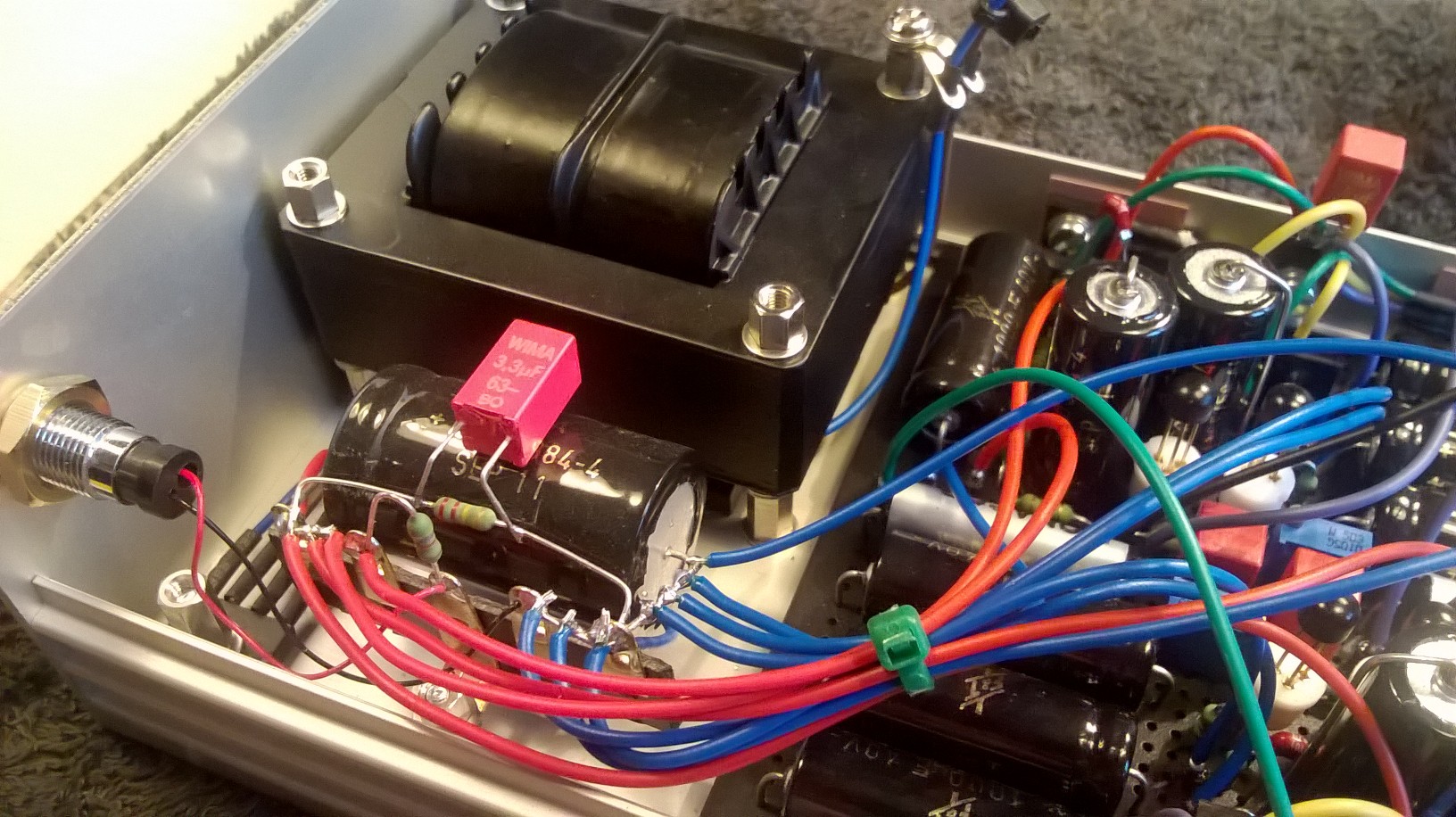

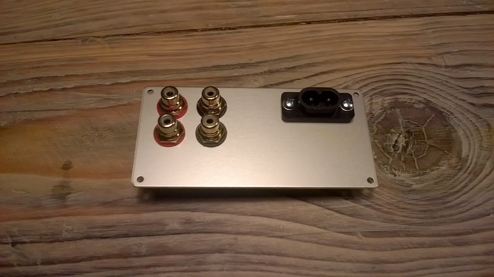

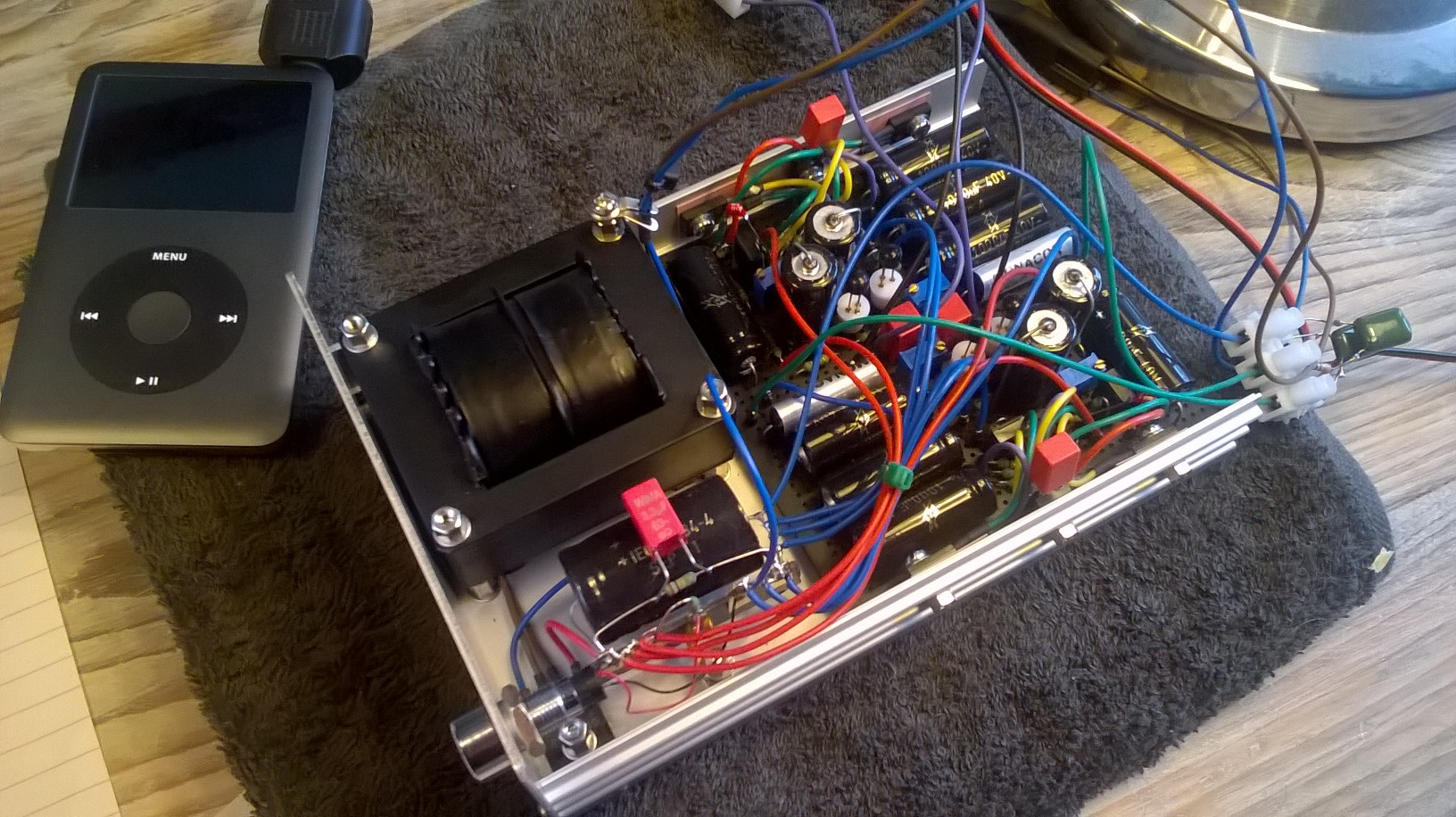

Mini Solid-State Amp 6+6 Watt
Today I finished my new fully discrete 6+6 Watt book-shelf amplifier!
I tried to make it as compact as possible with a kind of HAL-9000 look😀
As one would expect I guess.
It is an old-school single supply / current feedback design based on a singleton input stage, a bootstrapped VAS, high HFE drivers and power transistors.
all resistors are 1W metal oxide resistors.
all bipolar caps are Wima / Monacor.
All electrolytic's are Fischer & Tausche
only the transformer is 40 years old😉
transistors:
singleton: BC204B
VAS: BC207B
drivers: BD137-16 / 138-16
powers: BD441 / 442
transistors:
singleton: BC204B
VAS: BC207B
powers: BD441 / 442
Edit: (a thread here although I did NOT know the exact circuit).
Can you post a link to the circuit you are using?

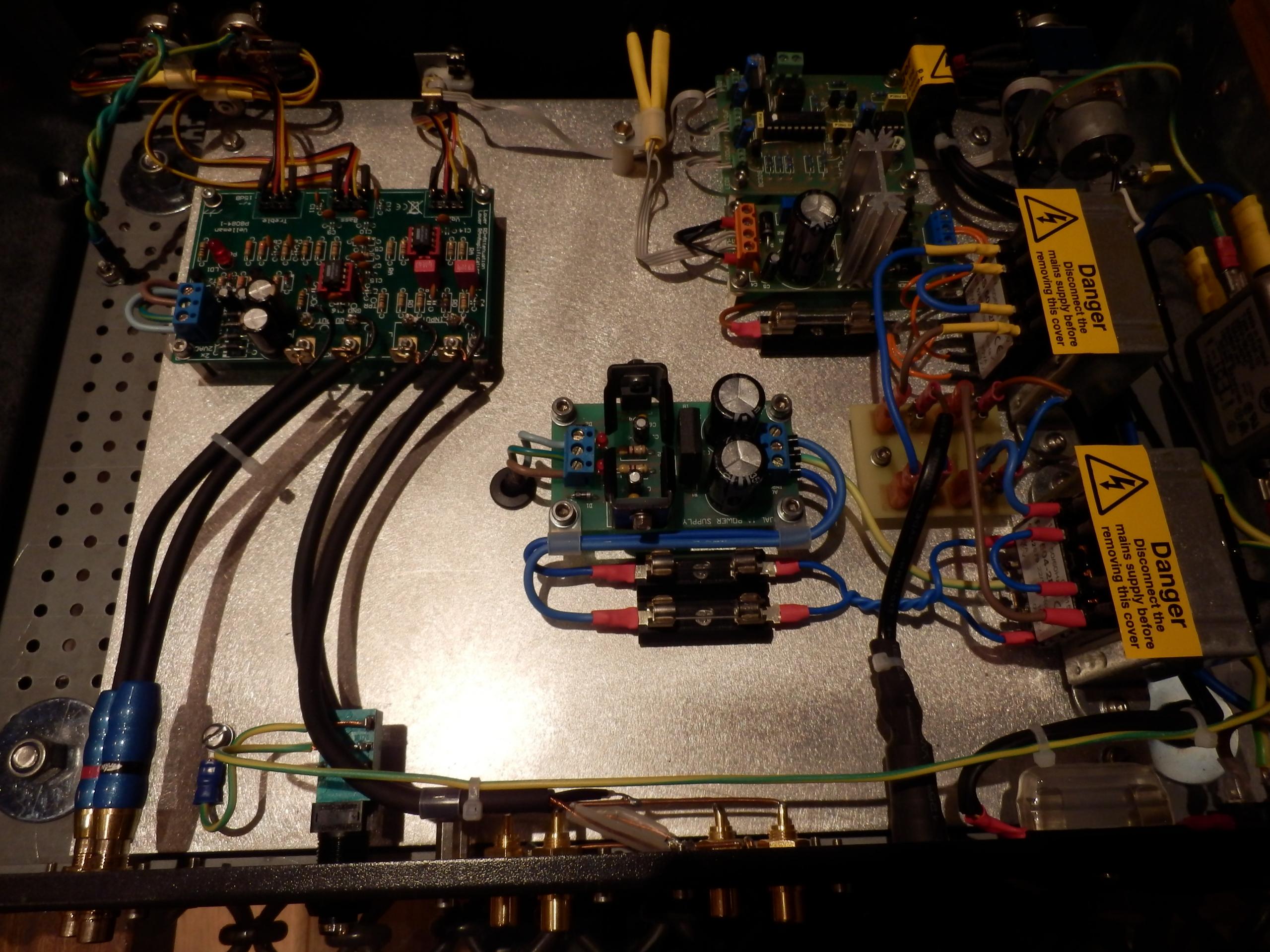

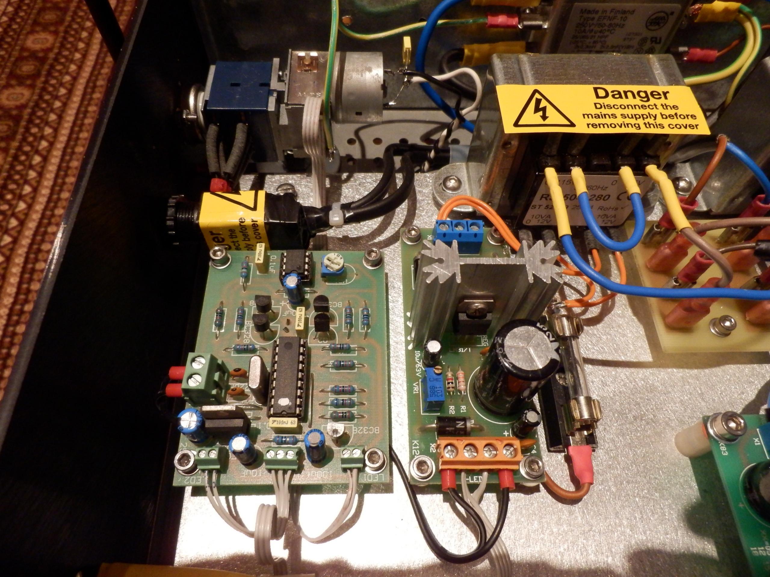

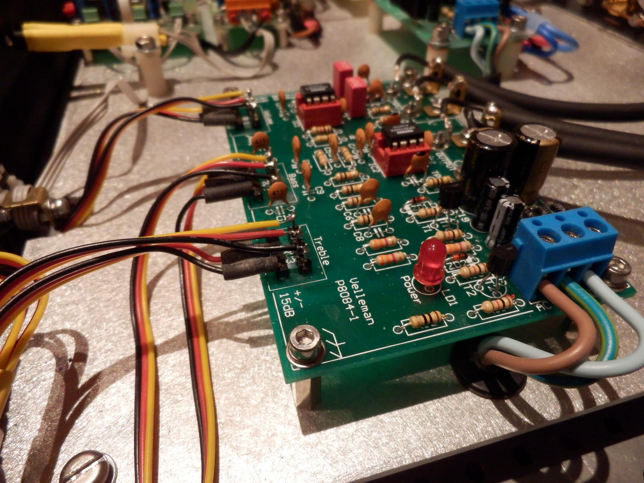

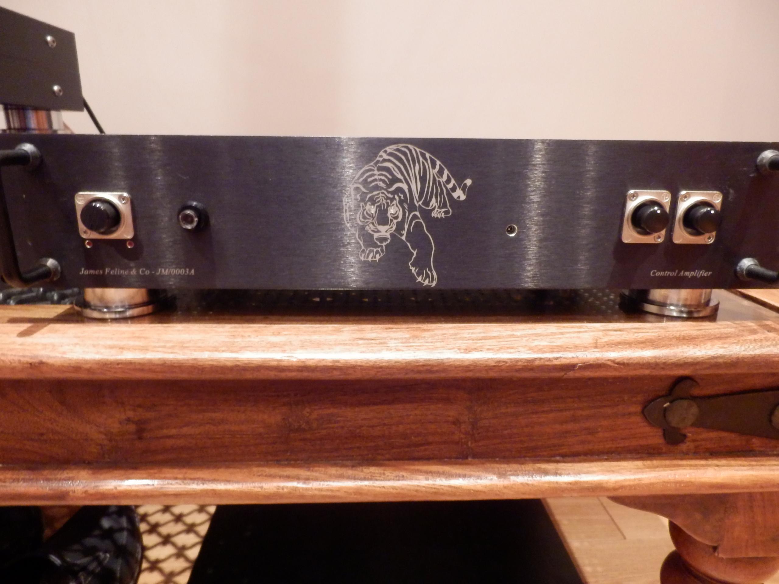

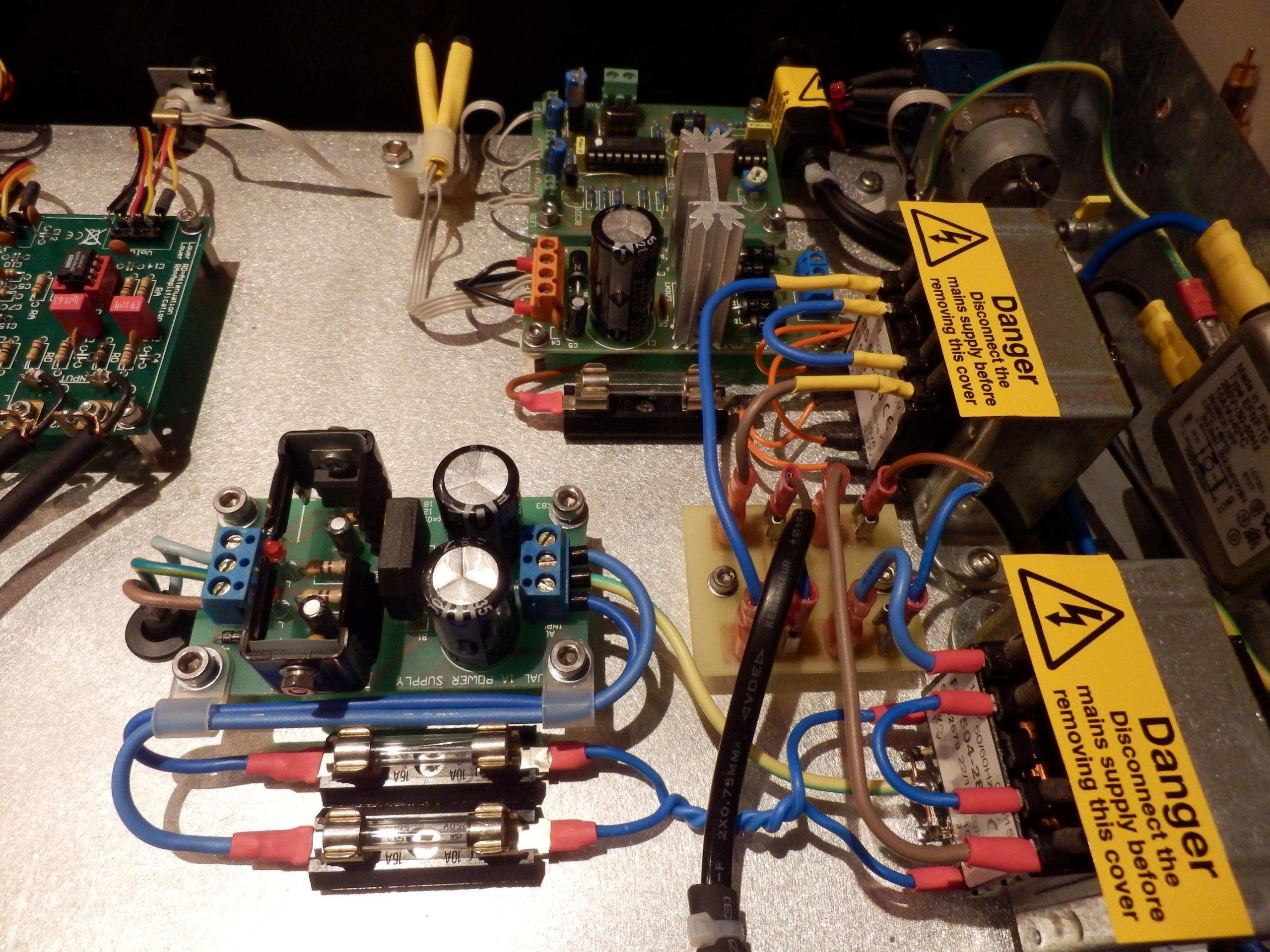

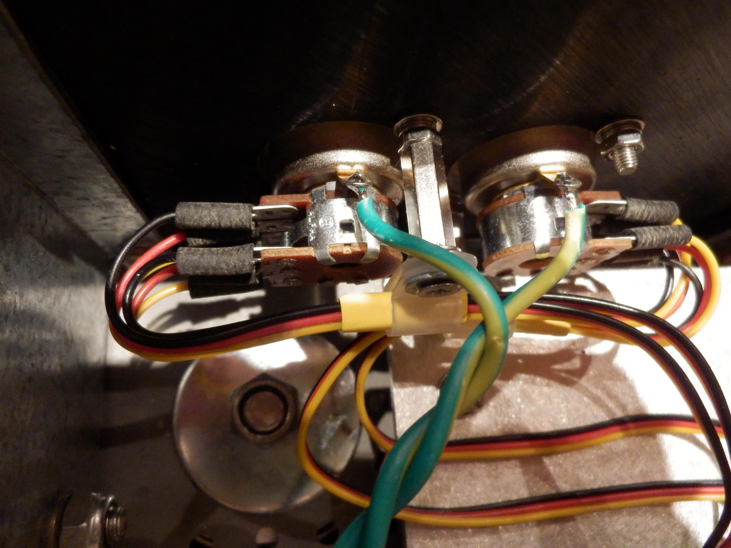

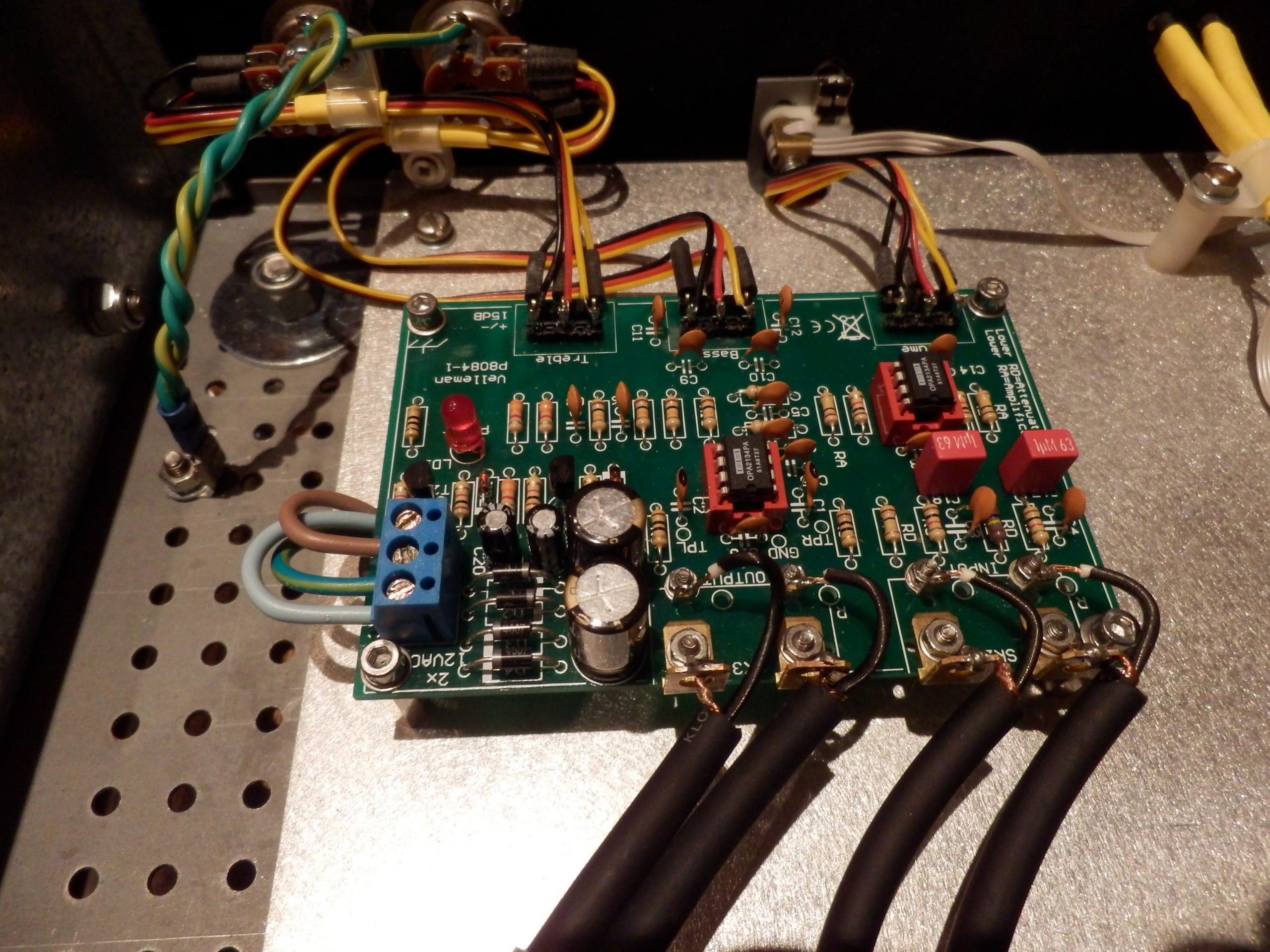

Completed Velleman preamp k8084
Complete preamp .. no hum and sounds really good
