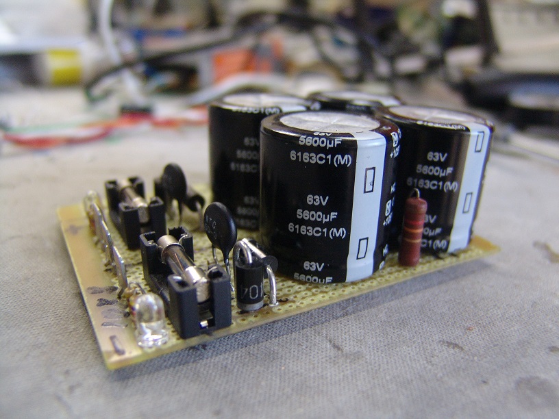

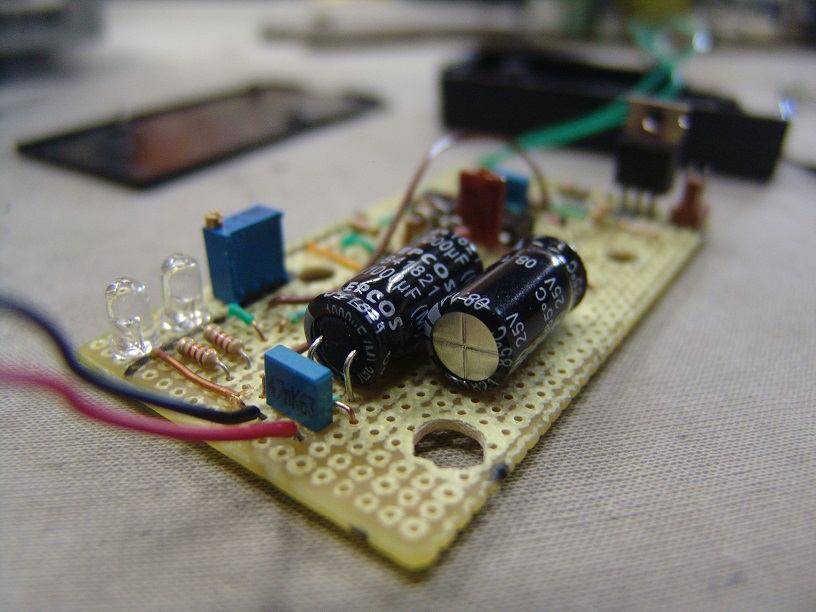

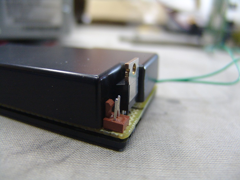

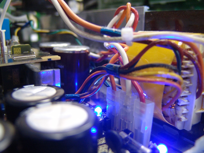

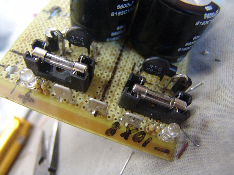

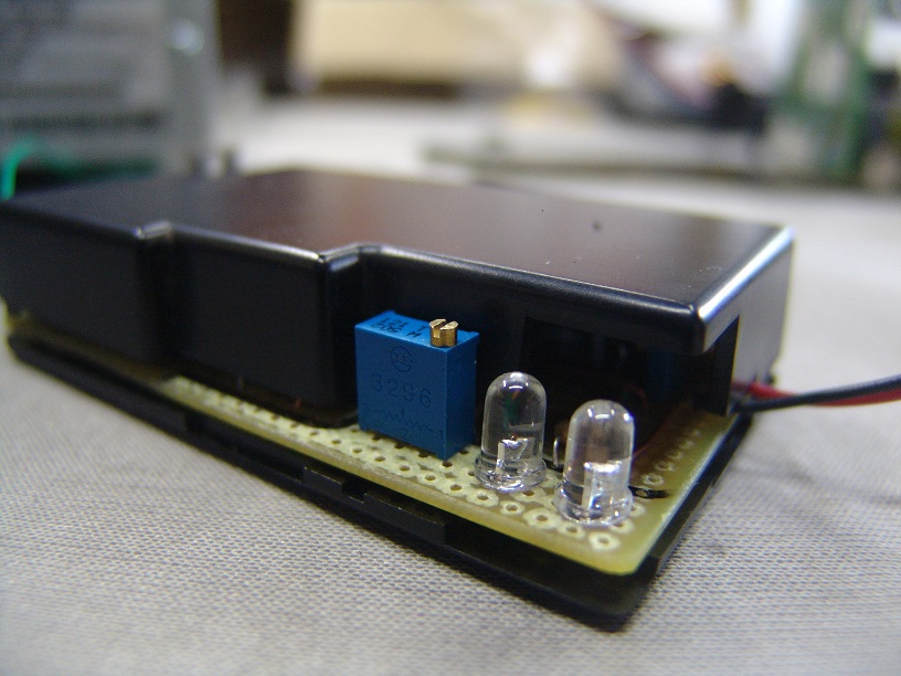

165% more energy for Sony Muteki STR-KM3

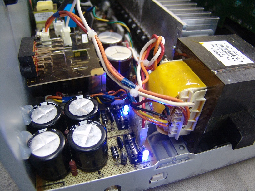

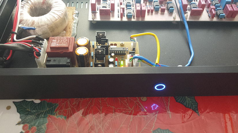

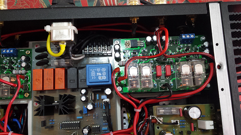

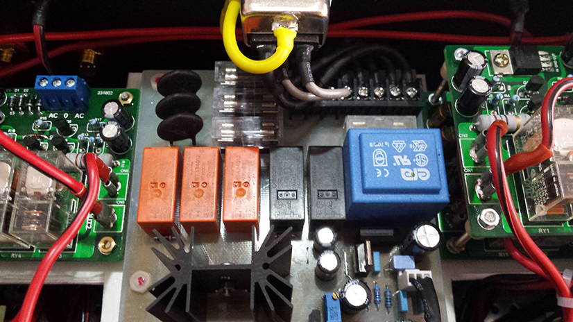

I was fixing a Sony HT Muteki STR-KM3 with a faulty power-on relay, and I decided to add a fan to cool the excessive heating drivers, and a capacitor bank to raise by 165% the energy reservoir (from 13,600 to 36,000 uF).
PWM controller inspired on a @bimo's blog post.
Capacitor bank has NTC+diode to limit inrush charging current, and a reverse diode do let energy flow backwards in each rail.

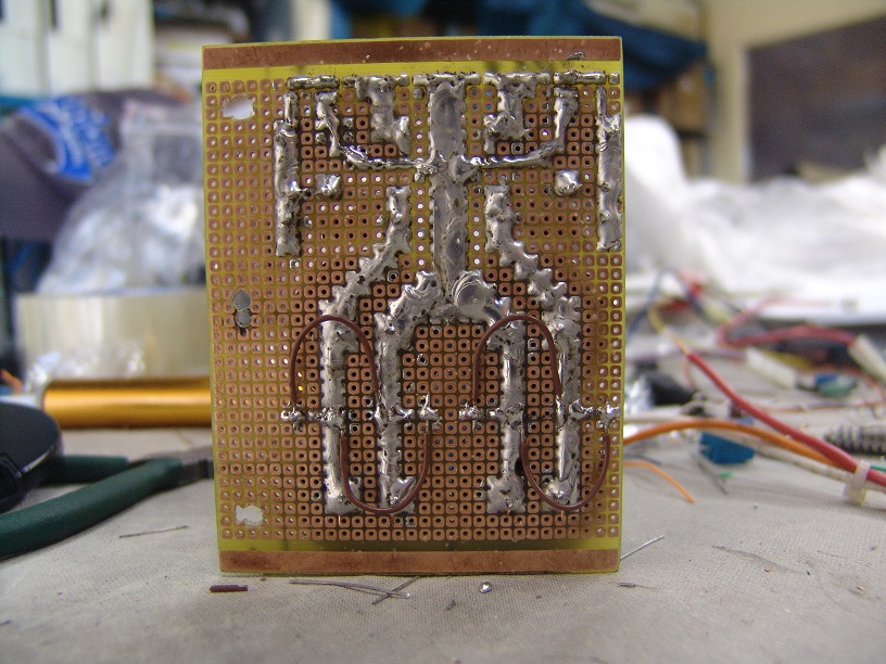

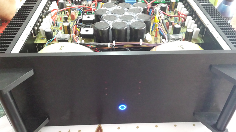

pic3 shows 4 loops of wire connector under the circuit.
These will be effective interference emitting aerials for the high current pulses between the transformer and the smoothing capacitor/s
The general rule is:
minimise LOOP AREA.
minimise LOOP AREA.
Thank you for your advice!pic3 shows 4 loops of wire connector under the circuit.
Those loops in that Nazca Lines-like tracks were the easiest way I found to parallel those resistors with the big capacitors to provide some discharging after power off.
This is a kind of add-on board, connected in parallel with the original power supply circuit. Of course there is a lack in voltage due to the diodes. But it seems to be working fine, and that the overall performance of the HT got much better.

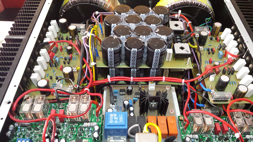

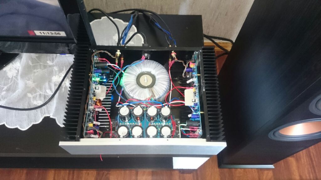

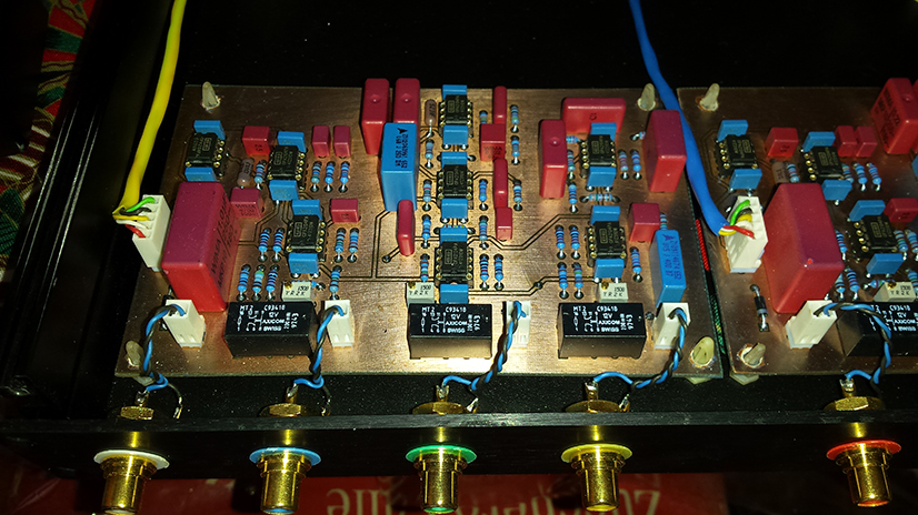

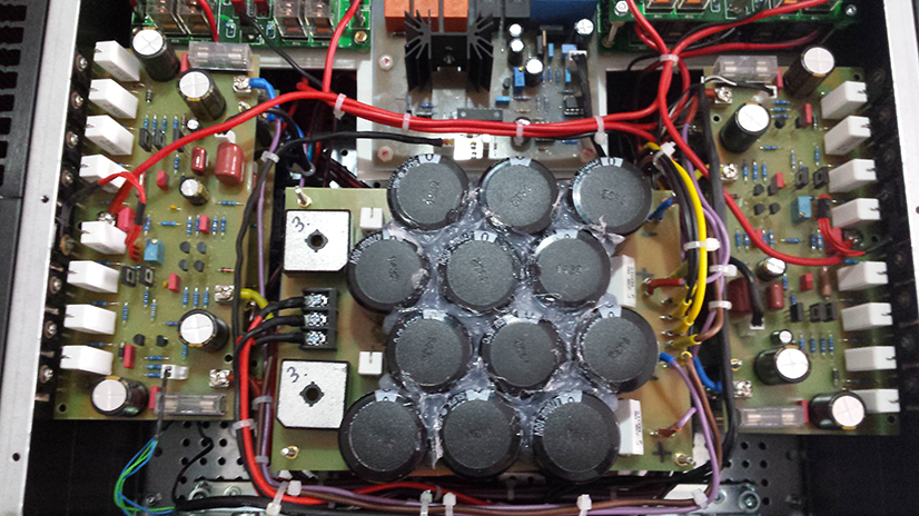

finally i have finished my active crossover and 6ch power amplifier.
the active crossover and power amp are for my 3 way speakers (using seas excel drivers) whith i am converting to active.
I am using the opa2134 opap in the active crossover and the cap and resistors are high quality.
The power amplifiers is 200w/8ohm , i am using 3x600a transformers each for 2 channels and each channel has one bridge and 14000uf capacitors per rail, except the channels 1 and 2 which have 18800uF per channel per rail. I have made a circuit using micro controller to power up those transformers via ntc and then they are shorted using relays. Also the micro controller board has a circuit which senses the audio input and can power up-down the amplifier.
everything seems to work fine. i have not yet tested using my expensive speakers. So what do you think?

I think a lot ! Best high density arrangement I've seen. I thought stuffing two amps
was tough.
Are they high PSRR designs ? Multiples on a single PS dictate this. But , L/R
active EQ to each speaker might reduce any errata. You would then just
have the combined LF - HF ripple for just two channels. Would act
like a dual mono , in this case.
Still , good "stuffing" 😀 !

they are the AV400 class AB amplifiers. i have been using this design several years and i am very happy with that. those amps works with +- 70vdc. each channel has its own power supply.
now i will work on my speakers to remove the passive crossovers and make another holes to the granite base (very difficult) for another two sets of connectors.

Hi ioannidis,
Nice, but dense.
There is one thing you should change as soon as you can. Remove that stuff around the filter capacitors to allow free air flow. Capacitors do generate heat and you are making them hit higher temperatures like this. Also, if you can, leave more space in between the top and lower sections for the same reason.
Other than that, nice and clean. Active crossovers are the way to go! Good decision for that as well!
-Chris
Nice, but dense.
-Chris
That 'stuff' appears to be hot wax/glue. Presumably to help damp the capacitors?Hi ioannidis,
Nice, but dense.
-Chris
yes, Redj this is silicone (not hot) to help damp the capacitors. i never had any problems using it in that way.
Hi ioannidis,
Well, you don't need the damping as much as you need the air flow.
If you miss an oil change, the engine doesn't seize immediately. However, it will get you in the long run. Component temperature is the one thing you have to keep as low as reasonably possible. So don't do anything that raises the case temperature - given a choice.
Here's a stat for you. Failure rate doubles for each 10 °C rise in temperature. In your case, the capacitors will simply be old before their time, reducing the sound quality slowly over time. Outright failure is dramatic, but doing what you have opposes high quality construction. Just saying since this is easy to rectify.
-Chris
-Chris

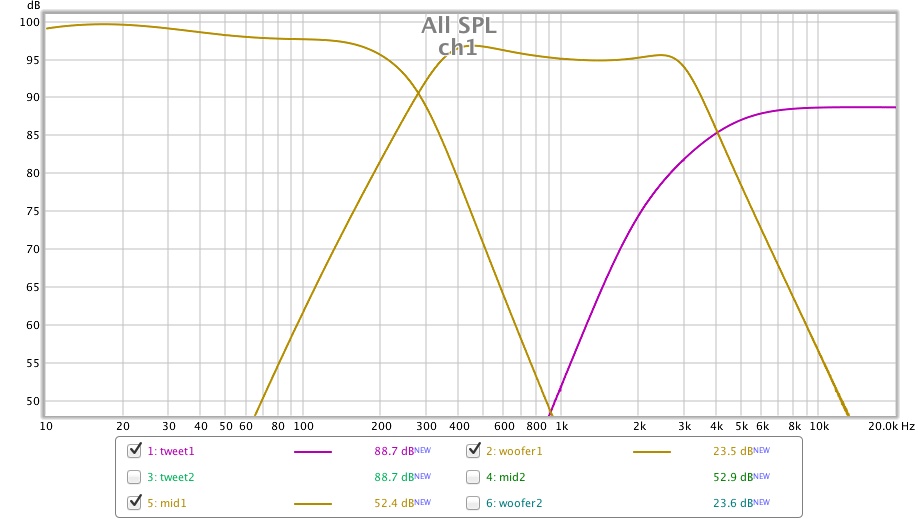

now i will work on my speakers to remove the passive crossovers.
Hopefully your passive crossover is not good enough. So you wouldn't have to worry about dumping your active crossover and put the passive crossover back on 😀
You know, Magnesium cone naturally wont have a smooth frequency response. And it is not easy to make it smooth using active crossover. May be you want to use passive notch filter, I don't know. Let us know how you deal with it 🙂
no, i have built those speakers by myself. The active crossover is designed using LEAP software and using the frequency response curves of each driver, so in simulation the response looks fine to me. the crossover is 24db/oct in all sections so the magnesium cone problems are not in the useful range. the cross frequencies are 300 and 3khz.
below is the real measured frequency response of the crossover.
i just measured the wattage drawn by the amplifier when is on idle or playing music low. it is 300w. I expected this number because i was running for several years two channel version of this amp and it was about 100w idle.
the heatsinks are hot and you barely can touch them. 🙂 The idle current is about 90-100ma per mosfet and there are 24 on each heatsink.
