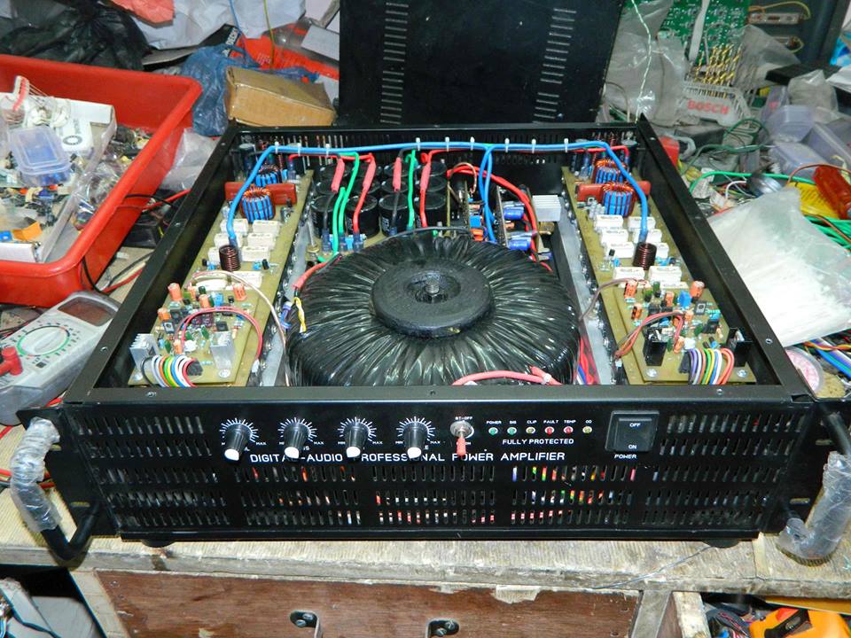

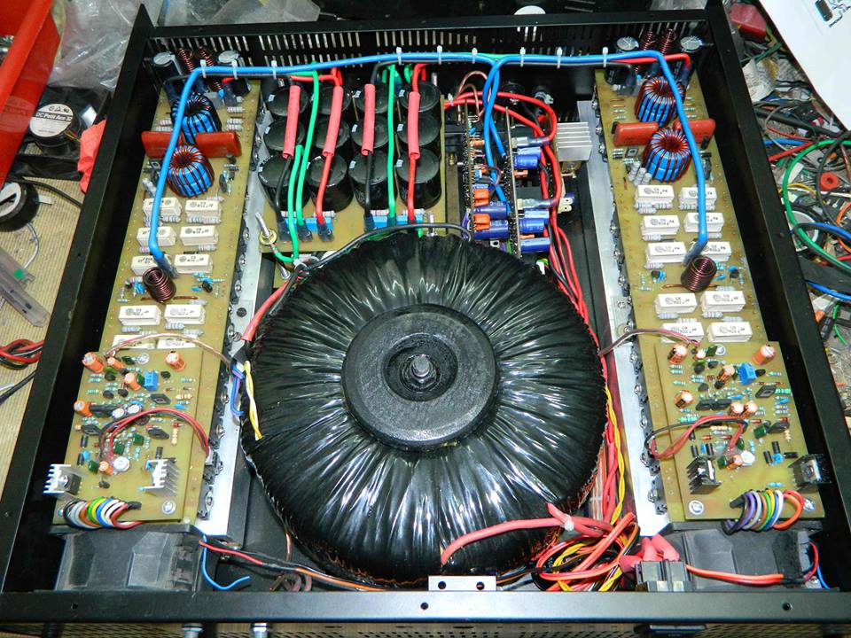

Hello
greetings my CLASS D amp with input limiter and last 2 pictures my
HD CLASS amplifier with torridal transformer wound and made at home
warm regards
Andrew😉
warm regards
Andrew😉
Hello
warm regards
Andrew😉
You mean Class H ? Class D can do that (1KW) with just 2 pair to-264 MOSFETS.
For class H that is as nice as any OEM - excellent work ... very Neat !
My apologies - first one looks "D" . second amp is a "work of art".
OS

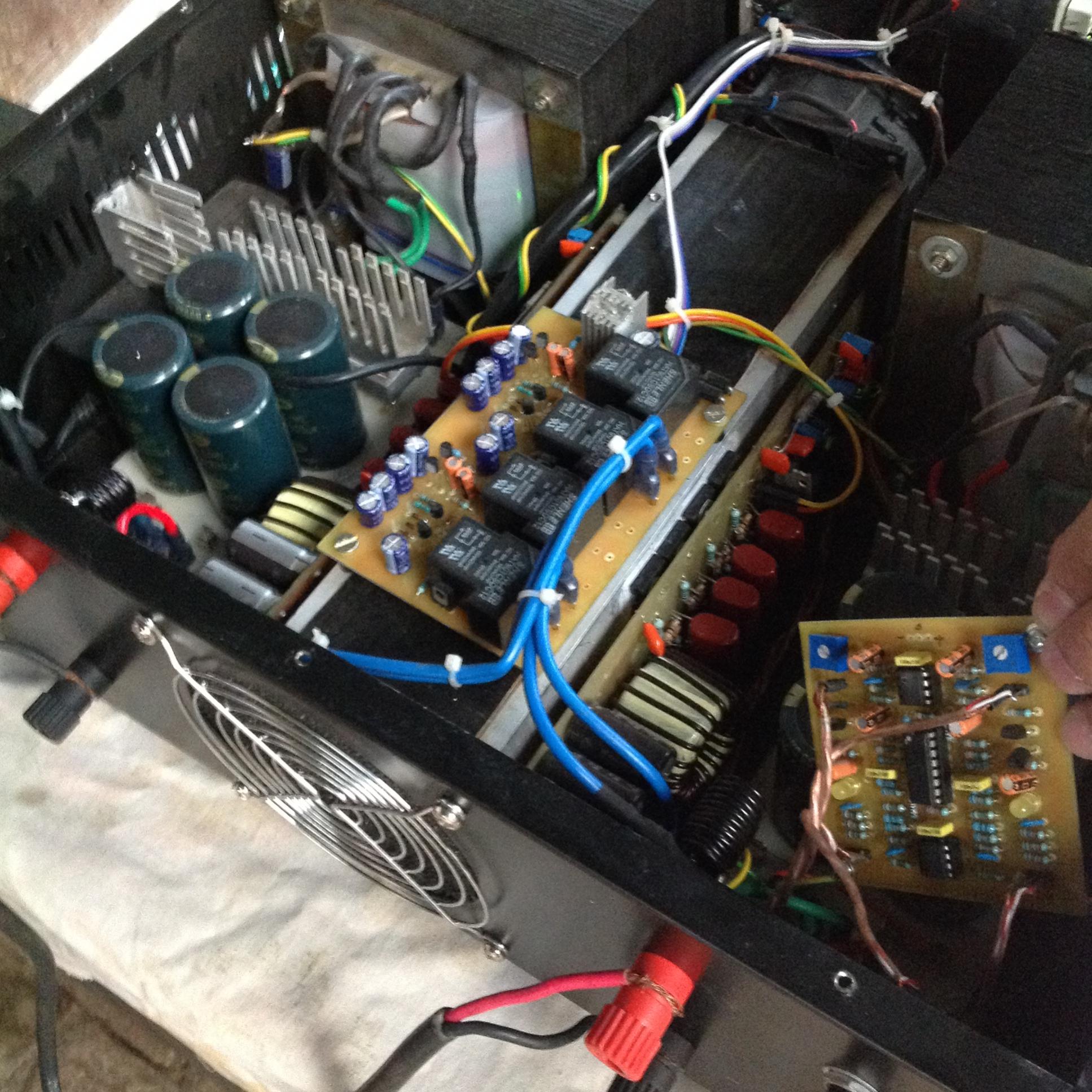

Hello Ostripper
greetings first picture is a class d amp for 1 ohm impedance loads
yes second amp EEE engine yamaha HD class is a sweet sounding amp
can you help me with a SSR relay 50 ampere i need to build for short
circuit protection for my amplifiers your protection circuits are state of
art i am trying simple short circuit protection with a mosfet relay
reaction time is much faster
warm regards
Andrew
warm regards
Andrew
Solid State Loudspeaker Relay
This looks like what i need maybe i can make it with my limited knowledge
That one is close to the one I am listening to right now (21'st century protection).Solid State Loudspeaker Relay
Jwilhelm updated the original mechanical. We use Infineon FET's with >100A peak.
Works real well !!
If you built those two amps - the SS relay will be easy !
OS
https://www.facebook.com/sameer.audio
Hello Ostripper
greetings the first vedio on this link is the short circuit protection copied
from QSC PL380 its working still needs to be tweaked and the SSrelay
to be used hope i can make it
warm regards
Andrew
Hello Ostripper
warm regards
Andrew
