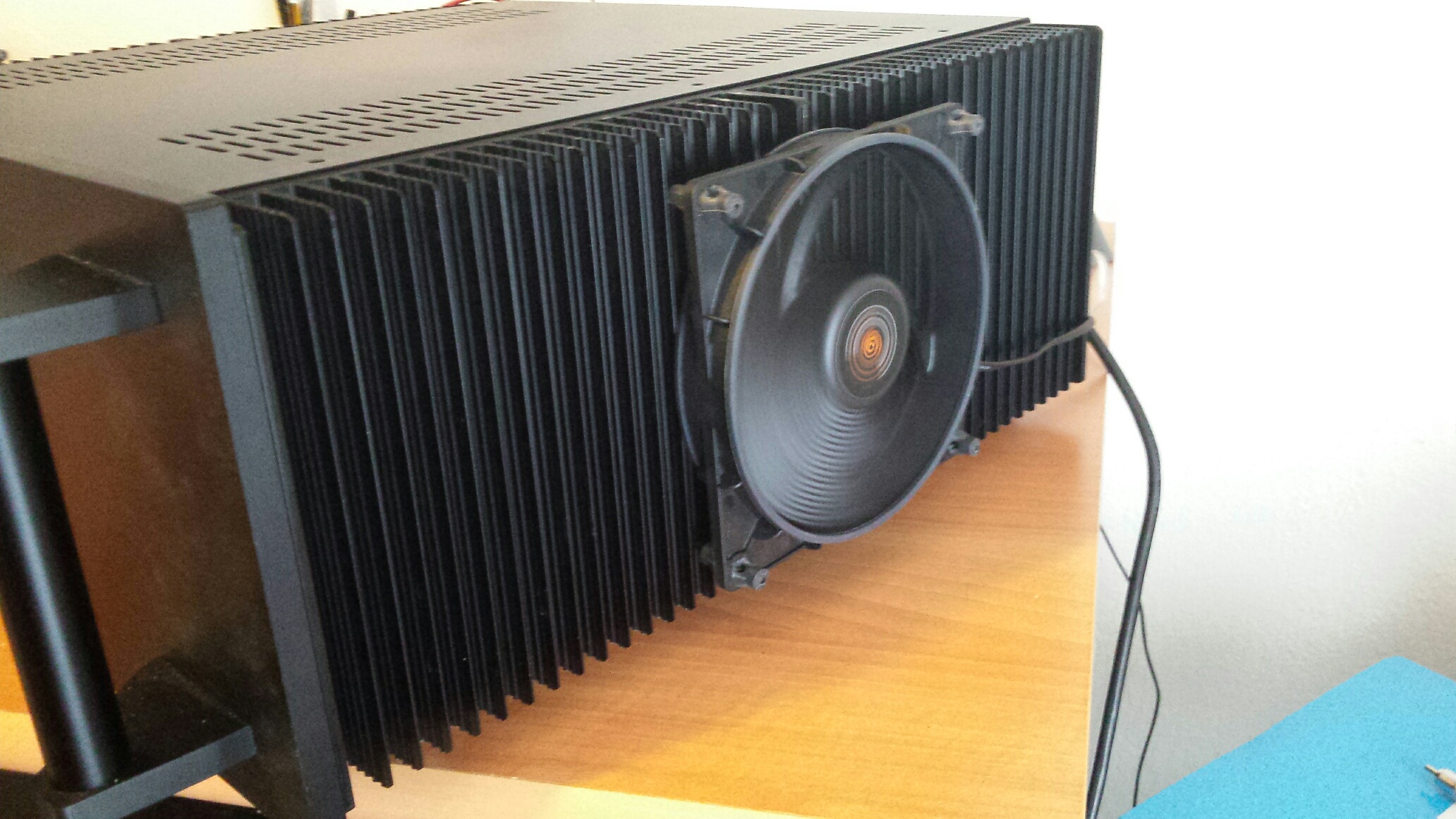

temp problem solved

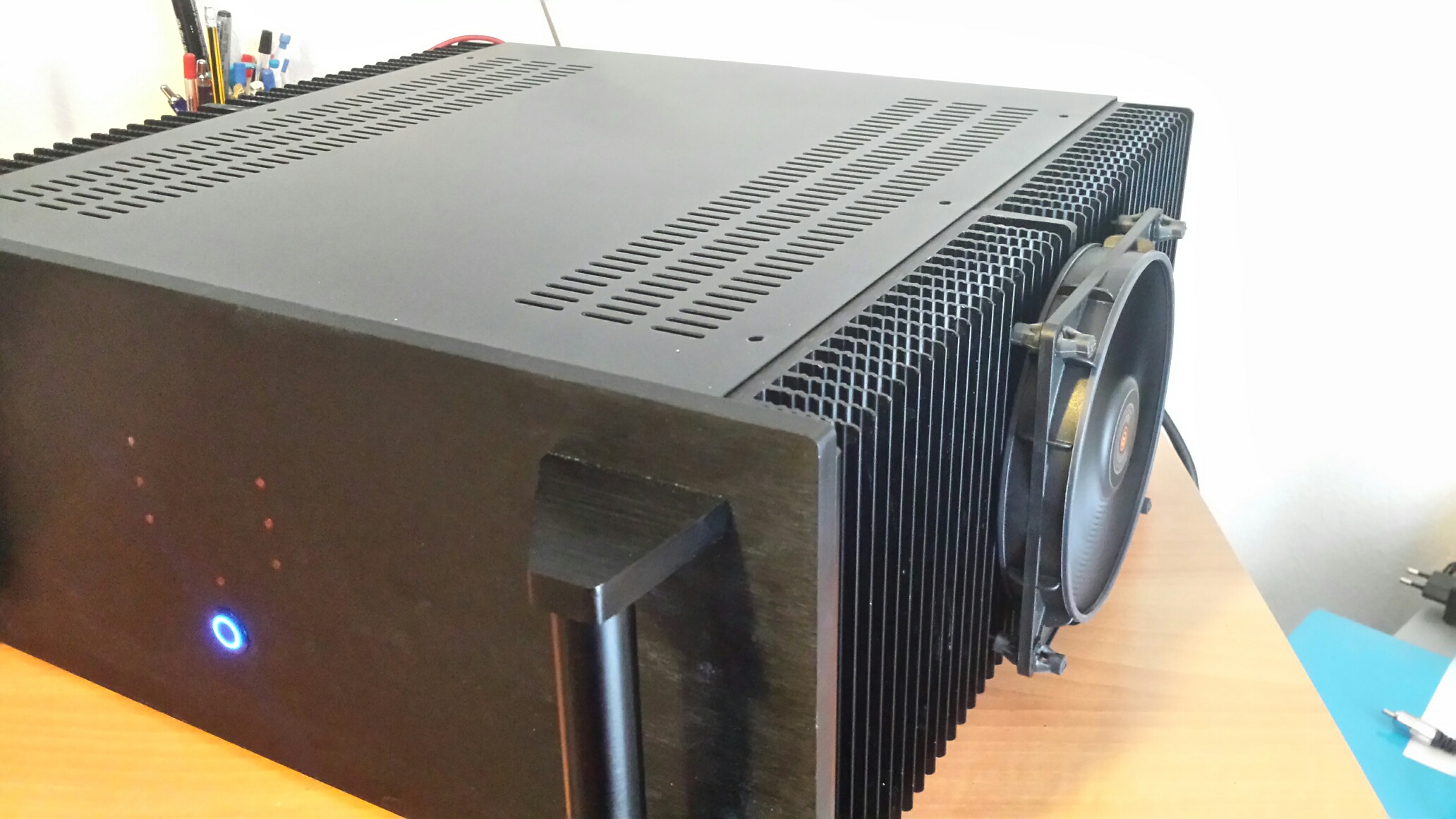

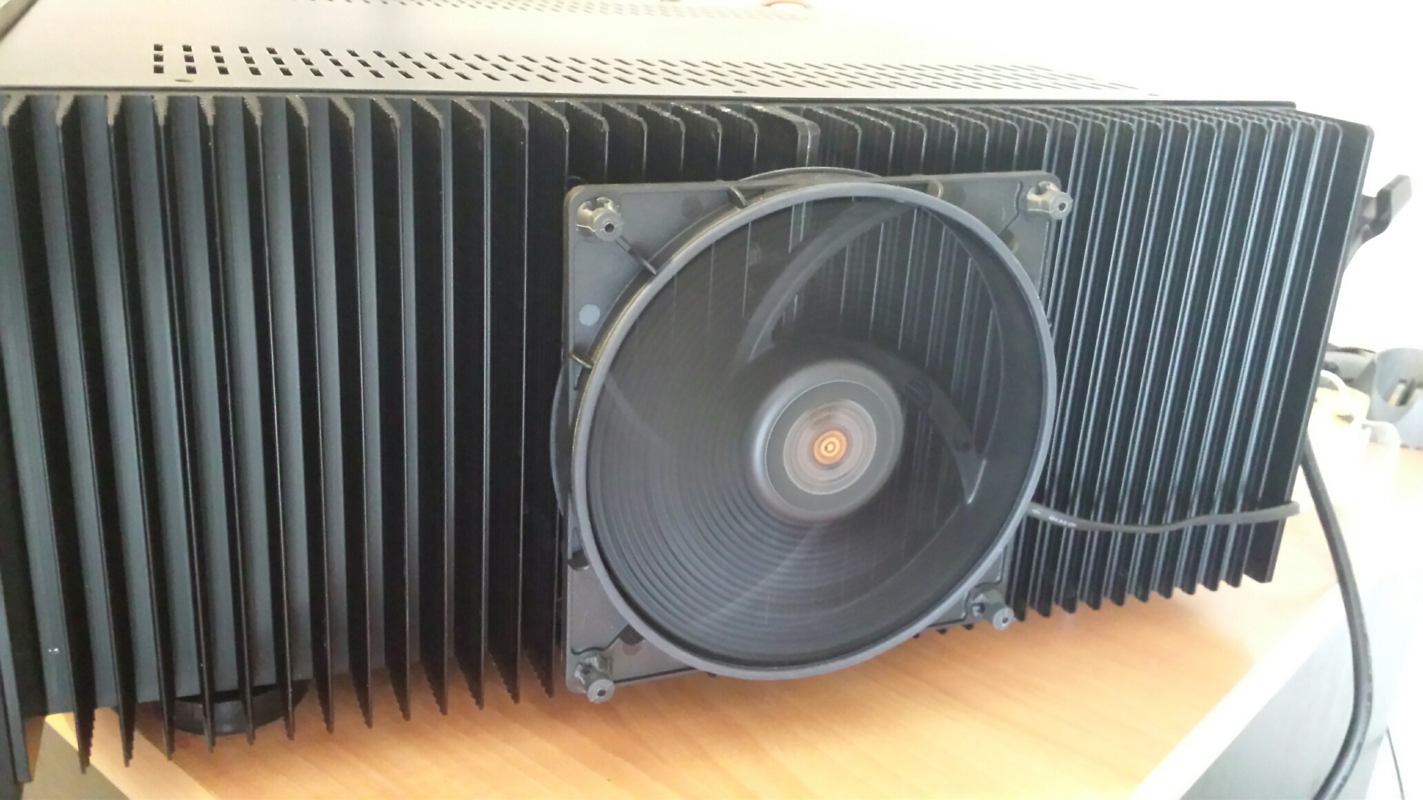

hello again,
i have installed two very quiet fans on those heatsink and now the idle temp. after about half hour is about 45C at the highest point (before was about 65). those fans are from be-quiet a german company which makes very quiet fans. I run the fans about 7.5V each and they are 14cm in diameter.also i opened the case after about 1 hour at idle and the capacitor temperature is about 38-40C. Now i think it will be ok.

I see you have those fans in the middle (where your outputs are).
That's another hard learned lesson for me. Spread those pairs out , the extrusions
will conduct better and any single pair will have the same thermals as the next.
With many pairs close together , middle devices will be hotter - end ones cooler.
On BJT's , Vbe will be different on the paralleled devices. Amp will work , but
if you were to approach thermal limits , one pair would fail prematurely (the
hottest ones).
PS - your fan in the middle most likely equalizes this thermal deficiency. Without it ,
center could be >10C hotter than the ends.
OS

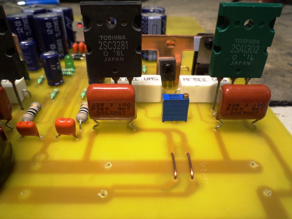

It's always nice to have parts you are comfortable with, no doubt. However I did discover that the current ON Semi parts are more than satisfactory. It would be nice to have a pile of parts already paid for!
Why the 10 turn bias control? Those aren't reliable compared to the normal single turn types. The range of control can easily be made to cover what you need so it isn't hard to adjust. Just asking, that's all.
-Chris 🙂
well Chris you are probably right even though not important those give a feeling of extreme precision which is a small obsession.
the wise thing to do is a fixed resistor or a resistor with a trimmer in series in order to be able to move within small acceptable range .
I loved some Japanese amplifiers that have for example 15 mv bias over resistor X and the '' reading " of the trimmer is exactly in the middle ...

I do a 390R plus a 500R bourns 10 turn trimmer (in series).
Those 500R's are set at 250R when bought new. Builder stuffs it ,
output stage is about 60ma bias. The full trimmer range
will give about 0-200ma per device
If the trimmers wiper goes bad - full 500R .... no bias. Trimmer open , also collapses
the Vbe. can't be too careful with 5 pair Sanken MT-200's.
PS - never had a reliability issue with those ten turn trimmers. My Vbe just passes
<1ma through the divider - microwatts.
OS
