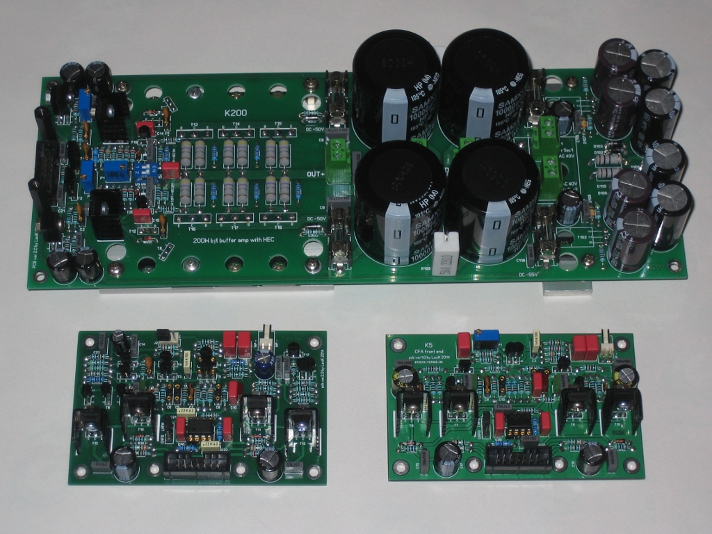

A K200? I'll have to look around and find out about it. It appears as though it is using the NJW type devices, so that catches my interest right away.
-Chris

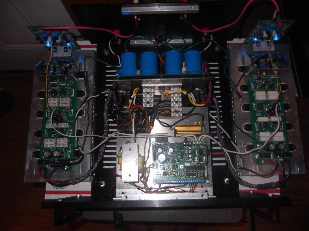

Modular EF3 w/ HEC. I'm embarrassed ... I'm "scared" of the HEC's
local FB !
Still , modular. Watch out , HEC does not "get along" with some input
stage topologies.
OS

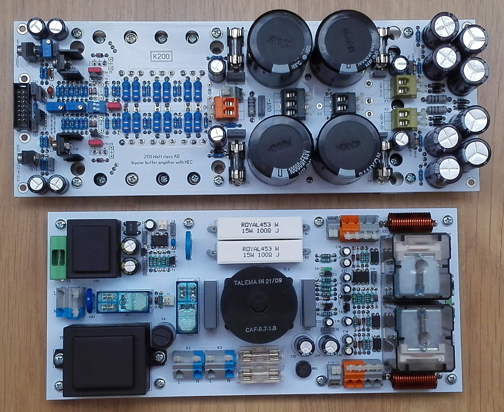

Prototype has been built (green, pcb v2.0), it works well, it's stable. White pcb is an improved version (I hope). Open loop thd is 0.05% (1k, 50W, 8ohm), with HEC 0.005%.

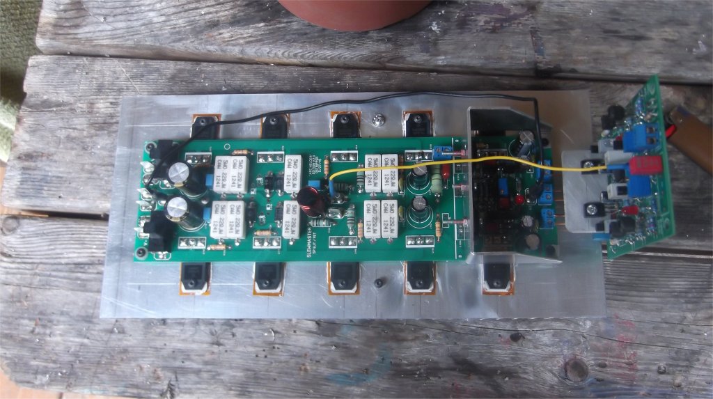

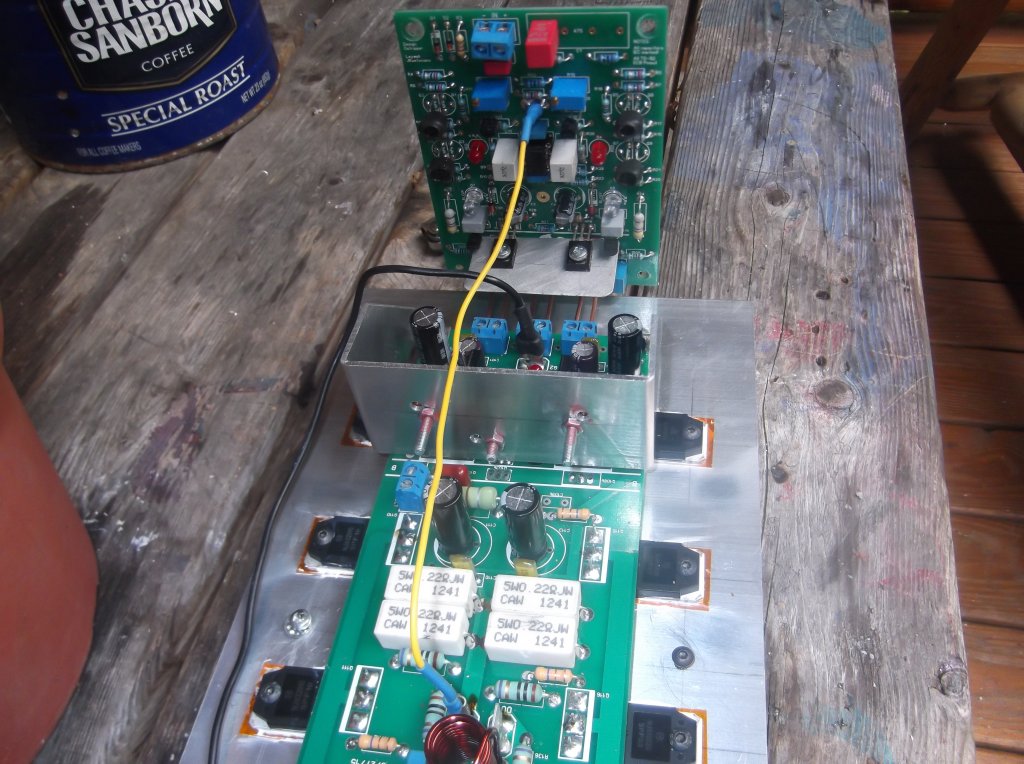

(below 1-3) The new slewmaster V3 output stage with
a (leach) "spooky" amp running it.
V2 was real good (with a big extrusion). V3 will do well on a 3U or 5U.
38C inside , 45C outside (Hot here ! 35C+ ....
Output devices "spread out" really gets that heat dissipated. Under 1C/ or
1mv bias difference on any of the 10 outputs.
I like how the thermal math worked out nearly exact. The .4C/W HeatsinkUSA
rating came out to a 18C rise. With 45W total idle - I'm at exactly 38C.
OS

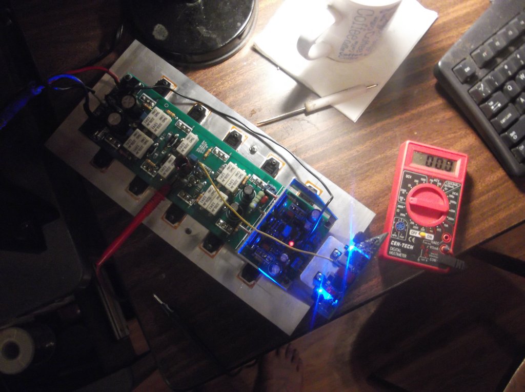

plain ol' EF3 new OPS ...
It workz , shakes the house most thoroughly !
(below). Had a few problems , easy to fix ... with a superior design .
The IPS led's told me the what the fault was , and the protection kept
my woofer voice coils from being "slag" ...
- how cool .
OS
