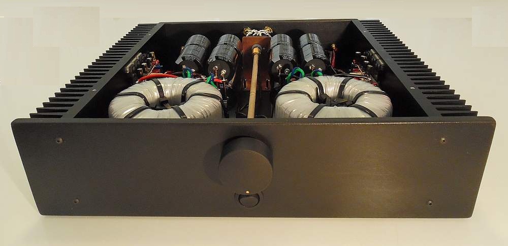

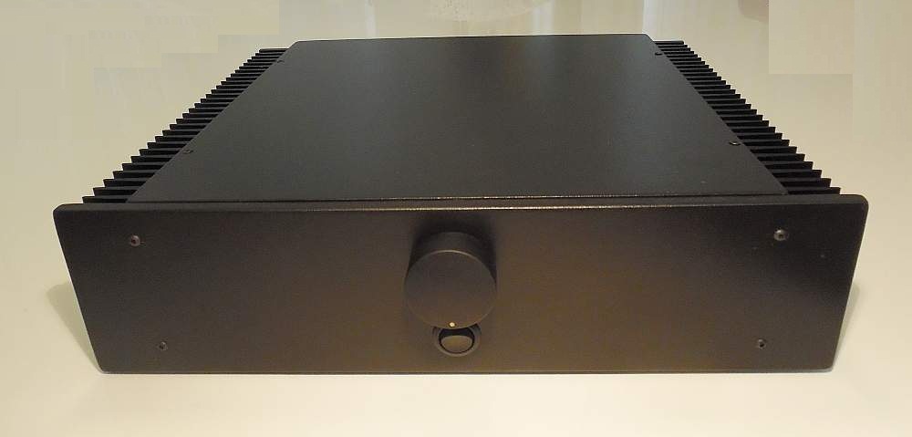

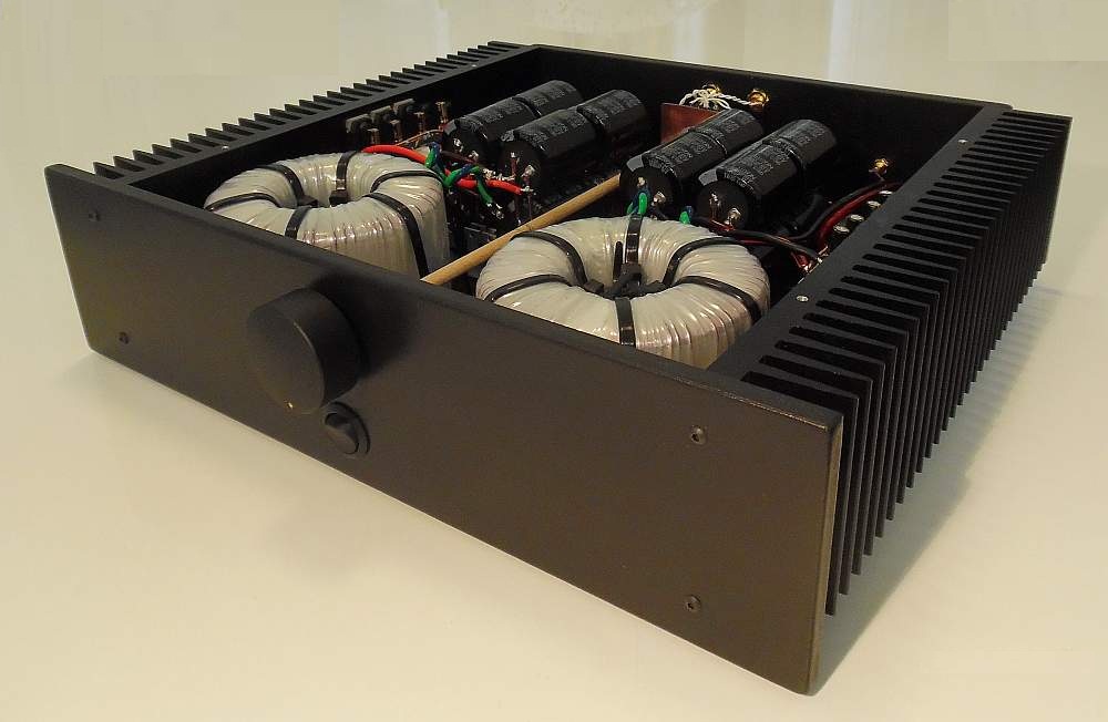

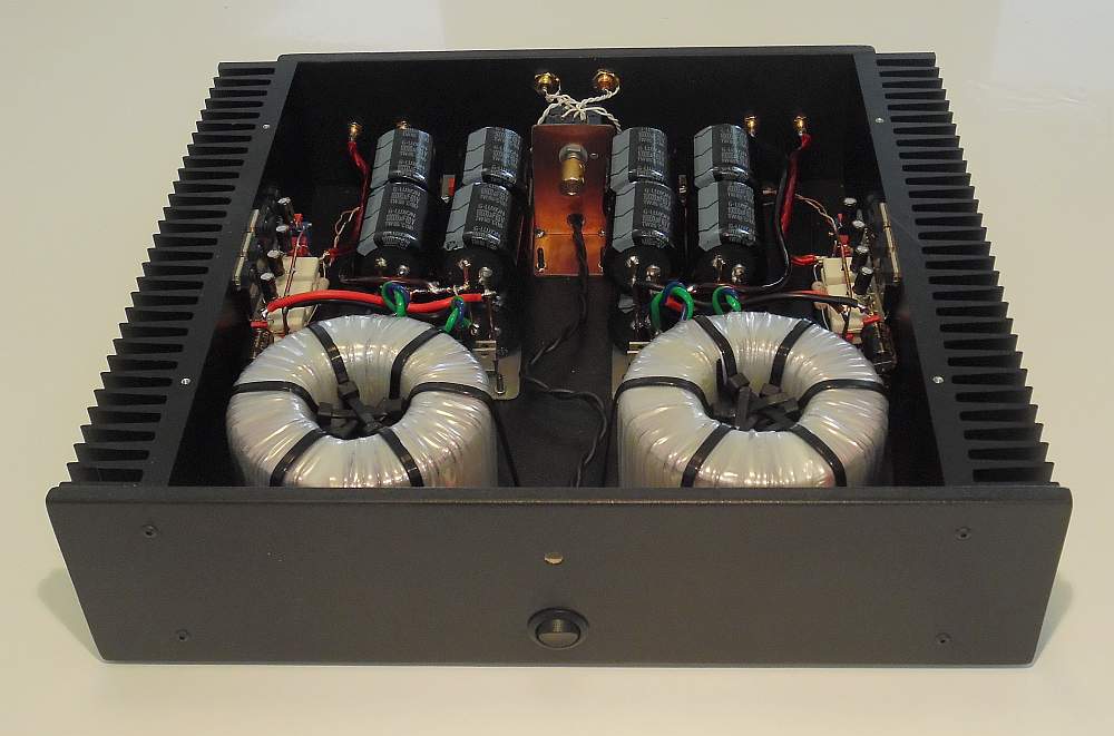

Ahhh, no. The design is too simple. Its great that you like the sound of it, and I am sure it doesn't sound bad. Mosfet or BJT outputs need better drive than a simple tube circuit can muster. If this design is expanded on a little, you could really make it better by isolating the tube from the output stage.
Is there a relay circuit to only connect your speakers after the DC offsets have stabilized? For tubes, the delay will often run a couple minutes, at least one. This is for solid state output stages. Tube - transformer outputs can remain connected to the speakers as long as the amp is well behaved.
Is this your first amplifier build? If so, you have done a pretty good job with it. The one minor thing I would suggest to you is to use washers and lock washers between the nut and your output transistors - even with the TO-220 case style transistors on the heat sink. Make sure you don't over-tighten these your transistors. Most people starting out do.
Please take my comments as constructive. I think you did a decent job putting the amplifier together.
-Chris

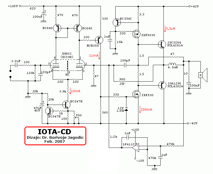

Hi Chris,
design is absolutely fine. Look up IOTA-CD amplifier by Dr. Borivoje Jagodic.
Ofcourse DC relay connects speakers after everything is stabilized, and it takes just about 15 seconds. Amplifier uses DC servo.

Cool , drivers are current sourced ... which keeps OP bias stable until
the valve stabilizes.
One step beyond -
Vzaichenko's hybrid-http://www.diyaudio.com/forums/solid-state/262450-ultra-high-performance-yet-rather-simple-hybrid-more.html
... uses 3 stages with the valve on the 1'st. red led
Vf keeps VAS current stable here (until the valve stabilizes).
Just the old Sansui 3-stage with a Valve instead of Jfet's.
ALL of Dr. Borivoje Jagodic's designs are rock stable with solid engineering
behind them. My studies involved his designs to gain my present level of
understanding. :eek: He's "the man" (for amp design).

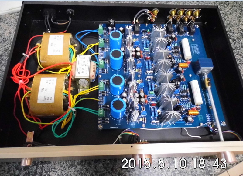

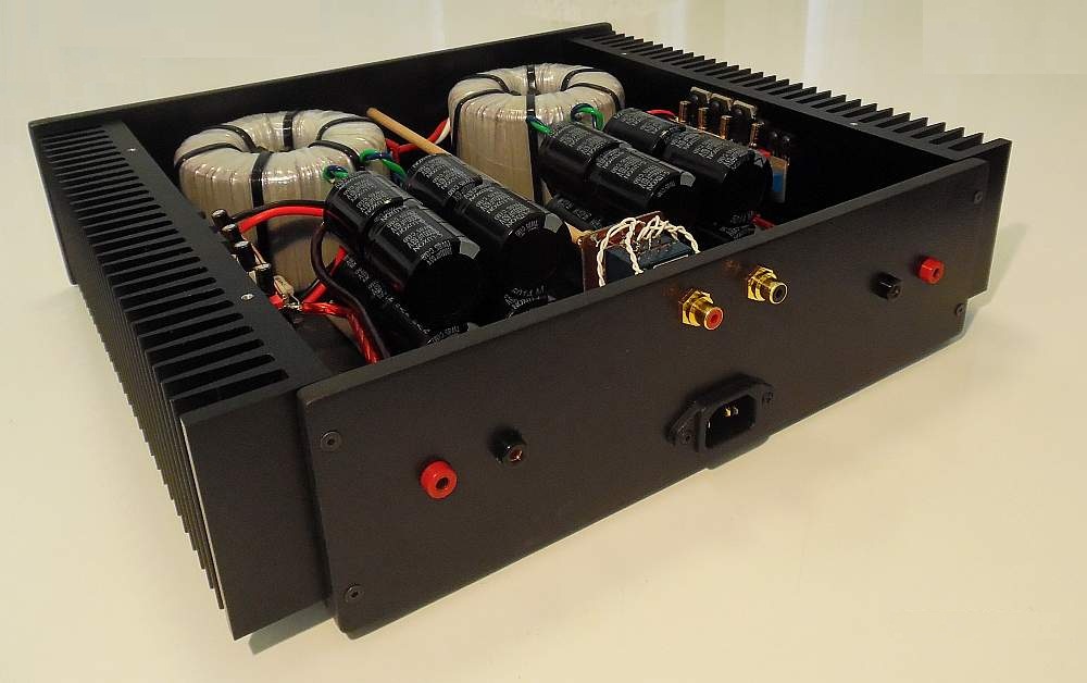

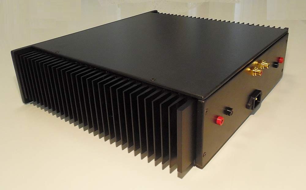

Started it yesterday and did hurt my back by lifting it off the ground to the table, completely silent if Laptop is turned off while RCA's are connected.
Biased to 30mA each channel, @ 25C room temperature without cables attached to amp. Sound wise, it has potential :D

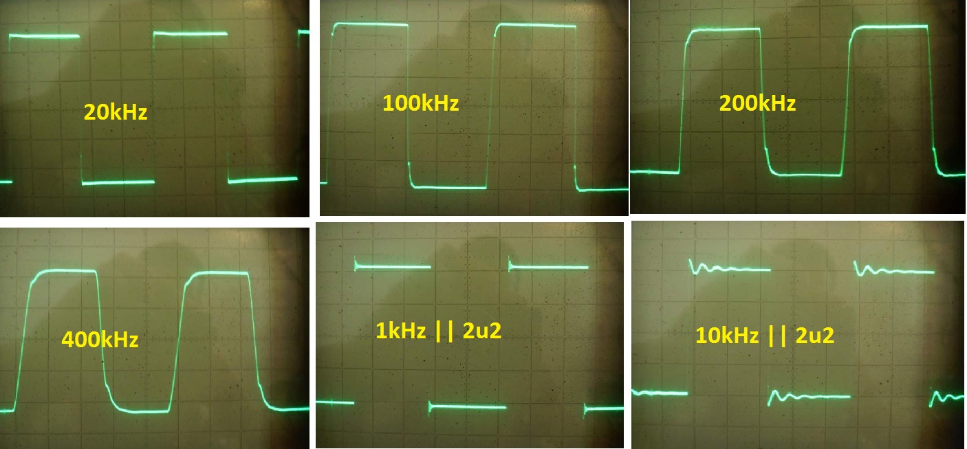

8 Channel APEX A-14 amp finished, sound awesome.
  • topolgy: (advanced) symasym
  • PS: 2 x 300VA trafo, 2 x 2 x 40mF 60V
  • OPS: 3P devices
  • chassis: painted MDF
  • measurements: attached
  • sound: 's cool... :)

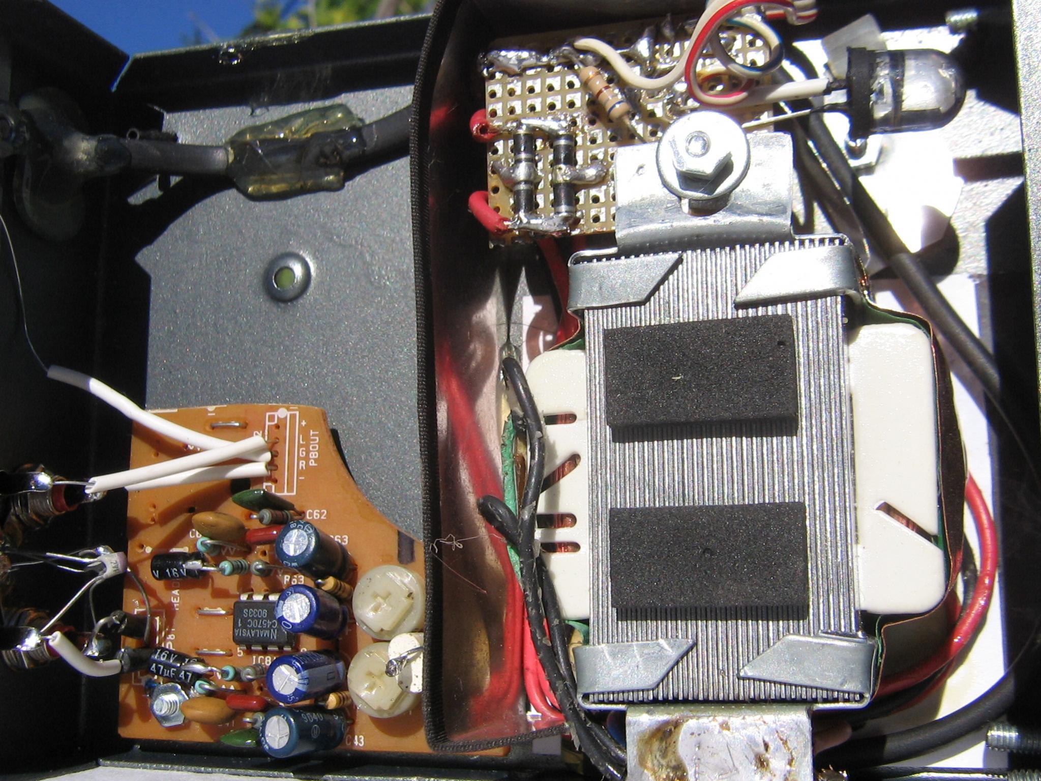

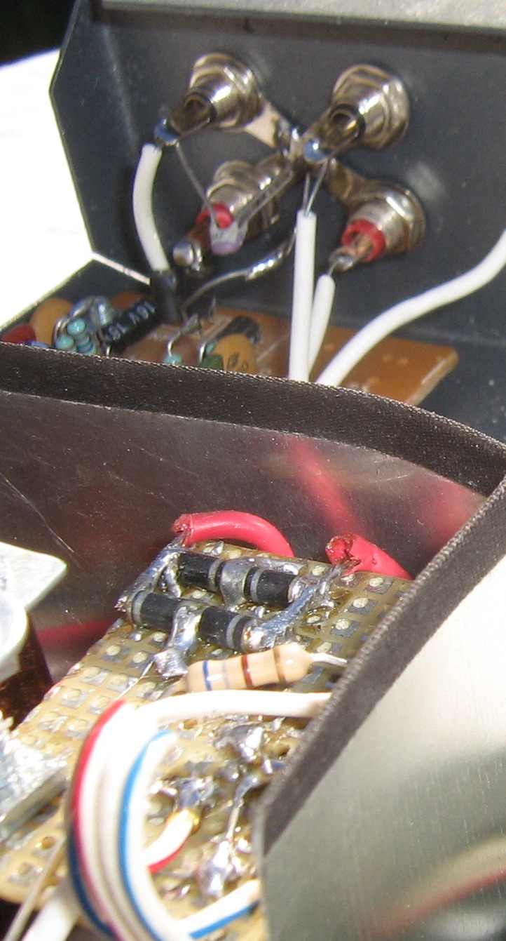

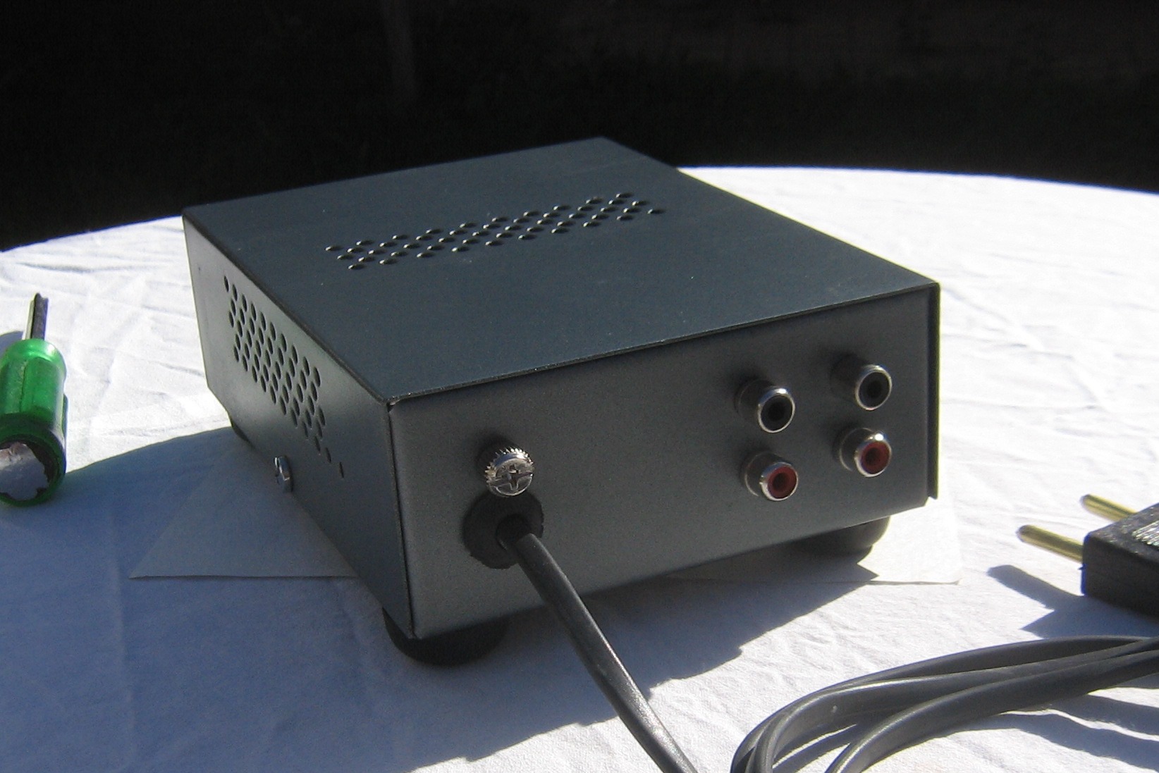

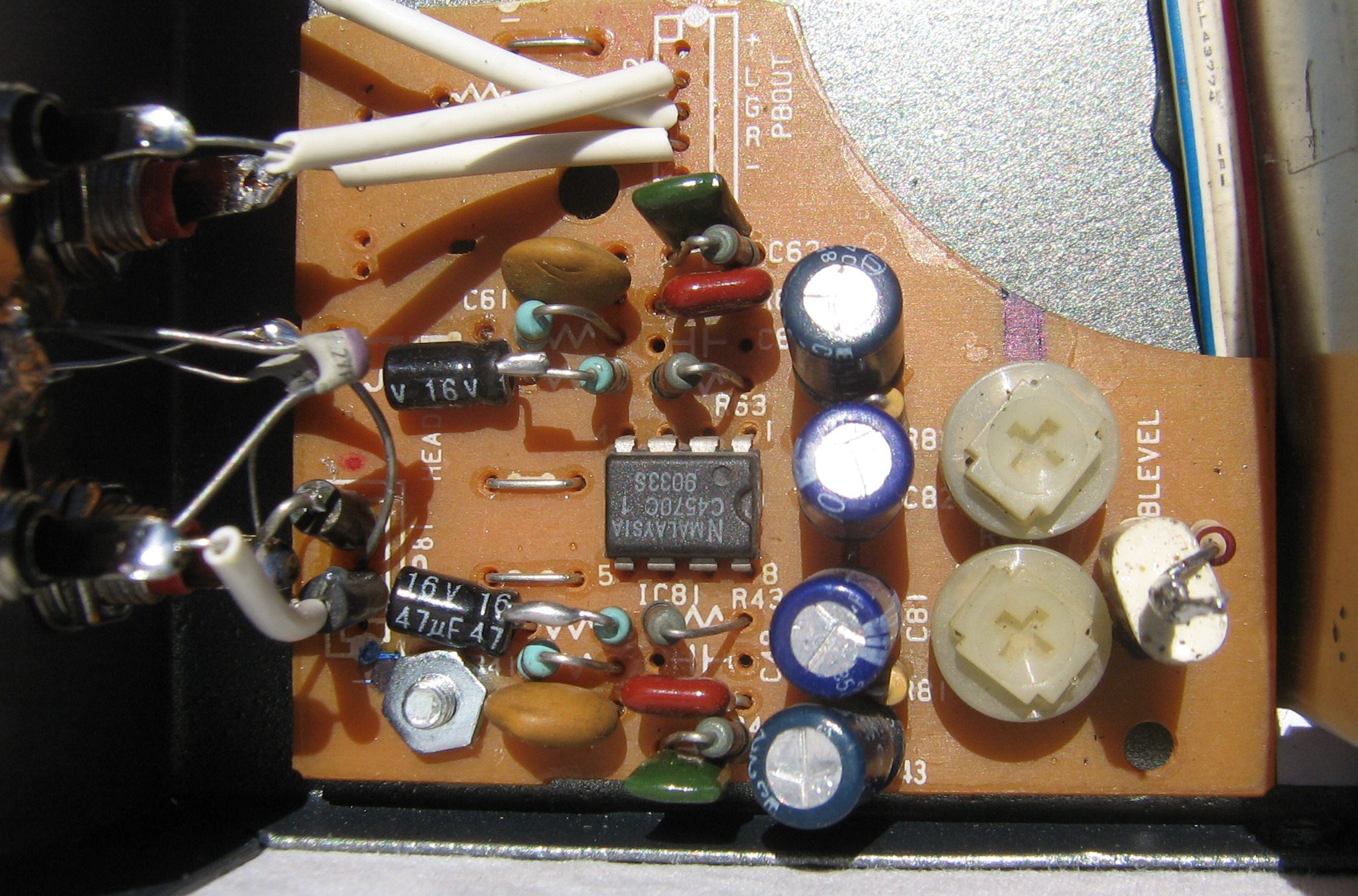

RIAA phono preamplifier from scrap parts
A communications device metal box, and a tape head amplifier board (from an old cassette player) plus some paint work and an acrylic front plate, repurposed as a nice RIAA phono pramplifier...
