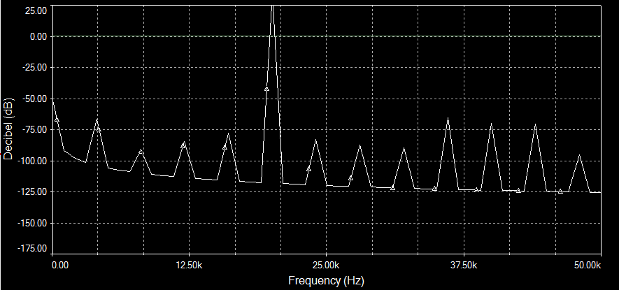

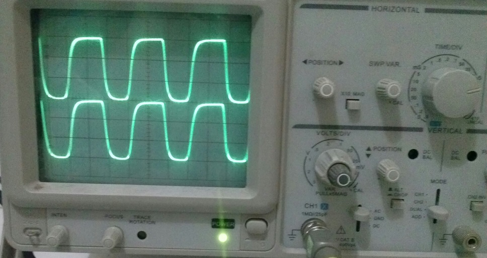

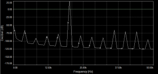

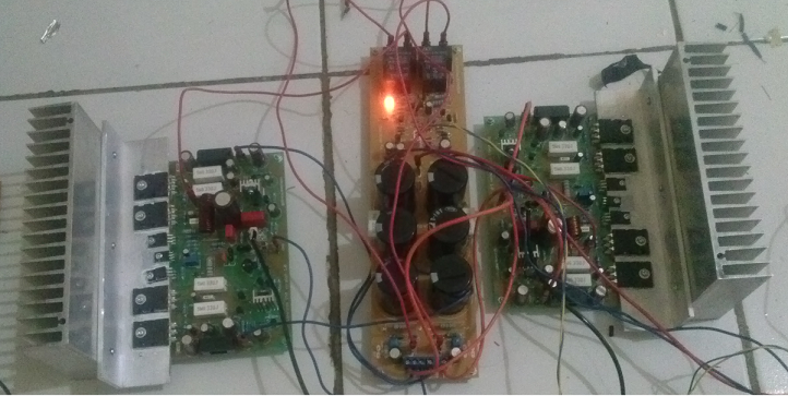

No parasitic oscillations. Amp is stable.Twisting the wires and/or tiring them together has not had any effect on the amp. This simple design has exceeded my expectations

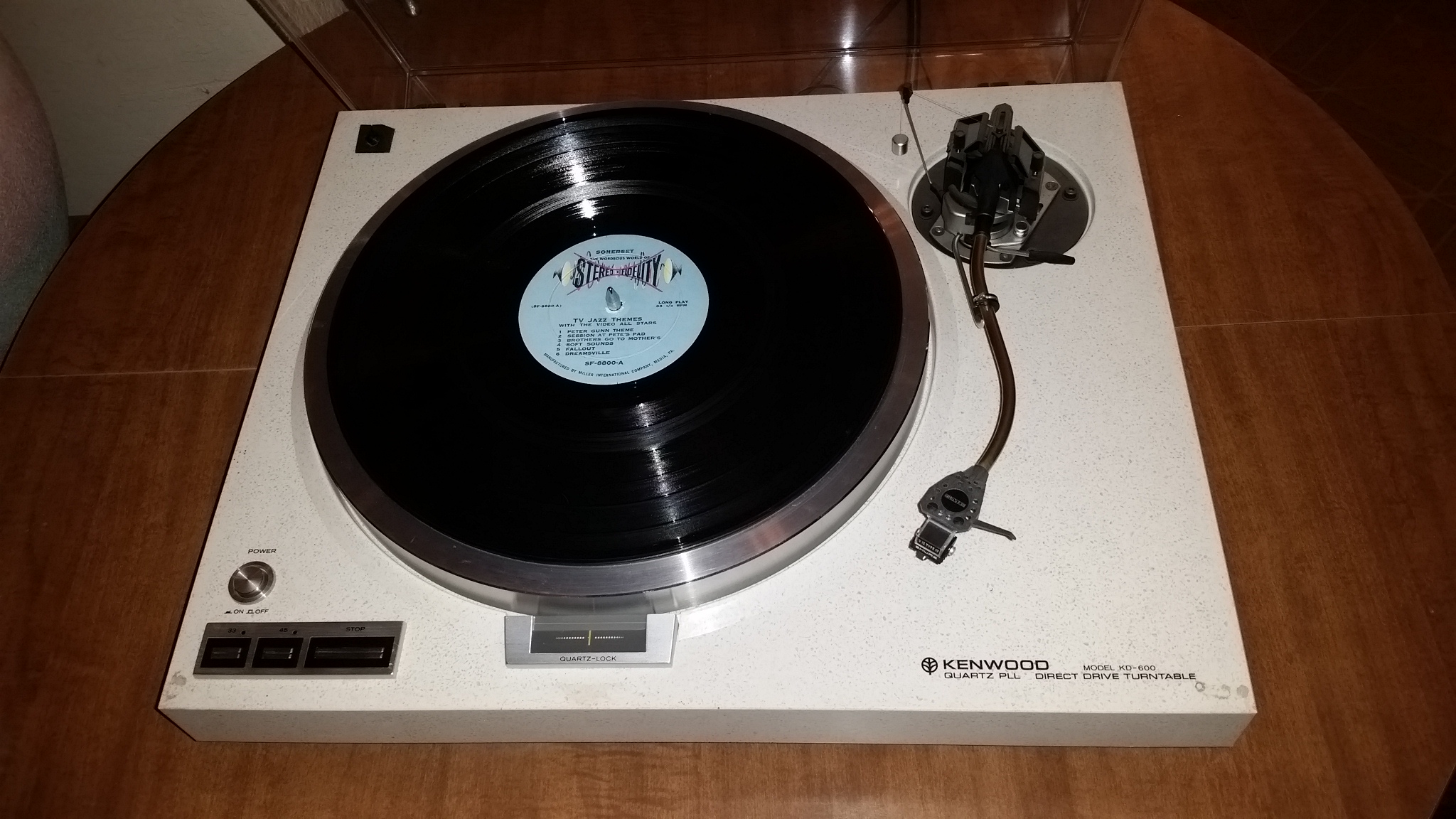

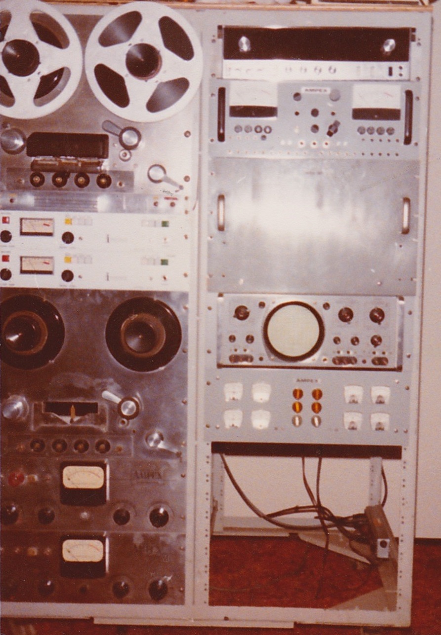

This was my sound system in 1979. My turntable is on slides behind the large panel on the right. A few years later I bought a Kenwood KD-600, SME arm and Shure V15 Type-IV-Cartridge.

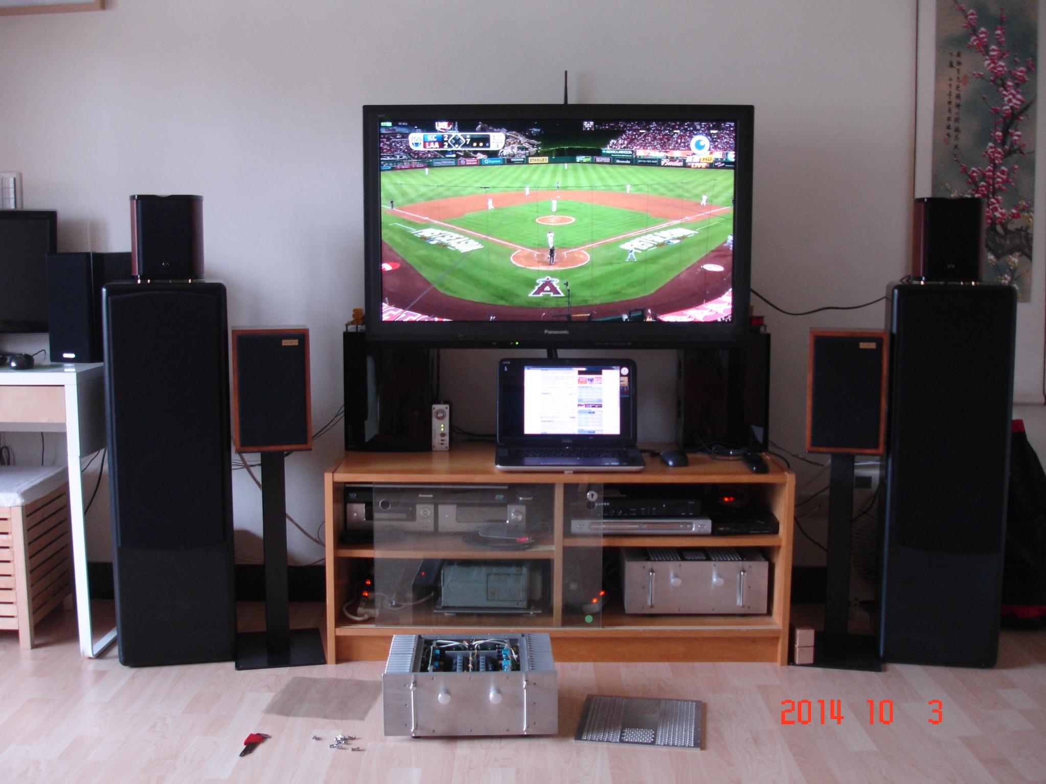

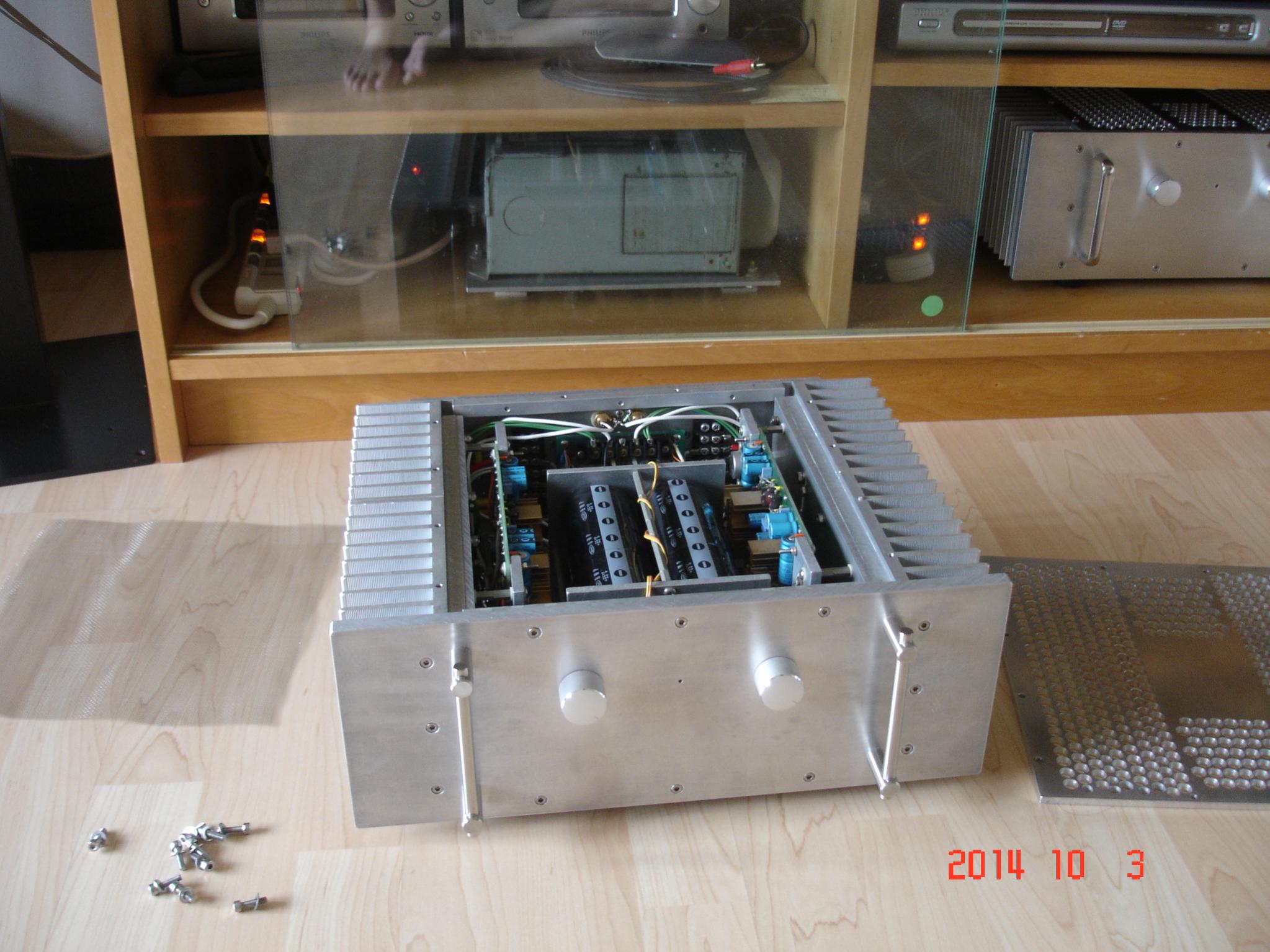

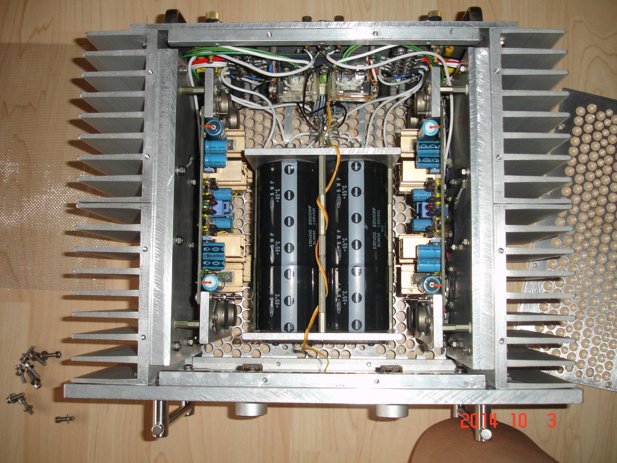

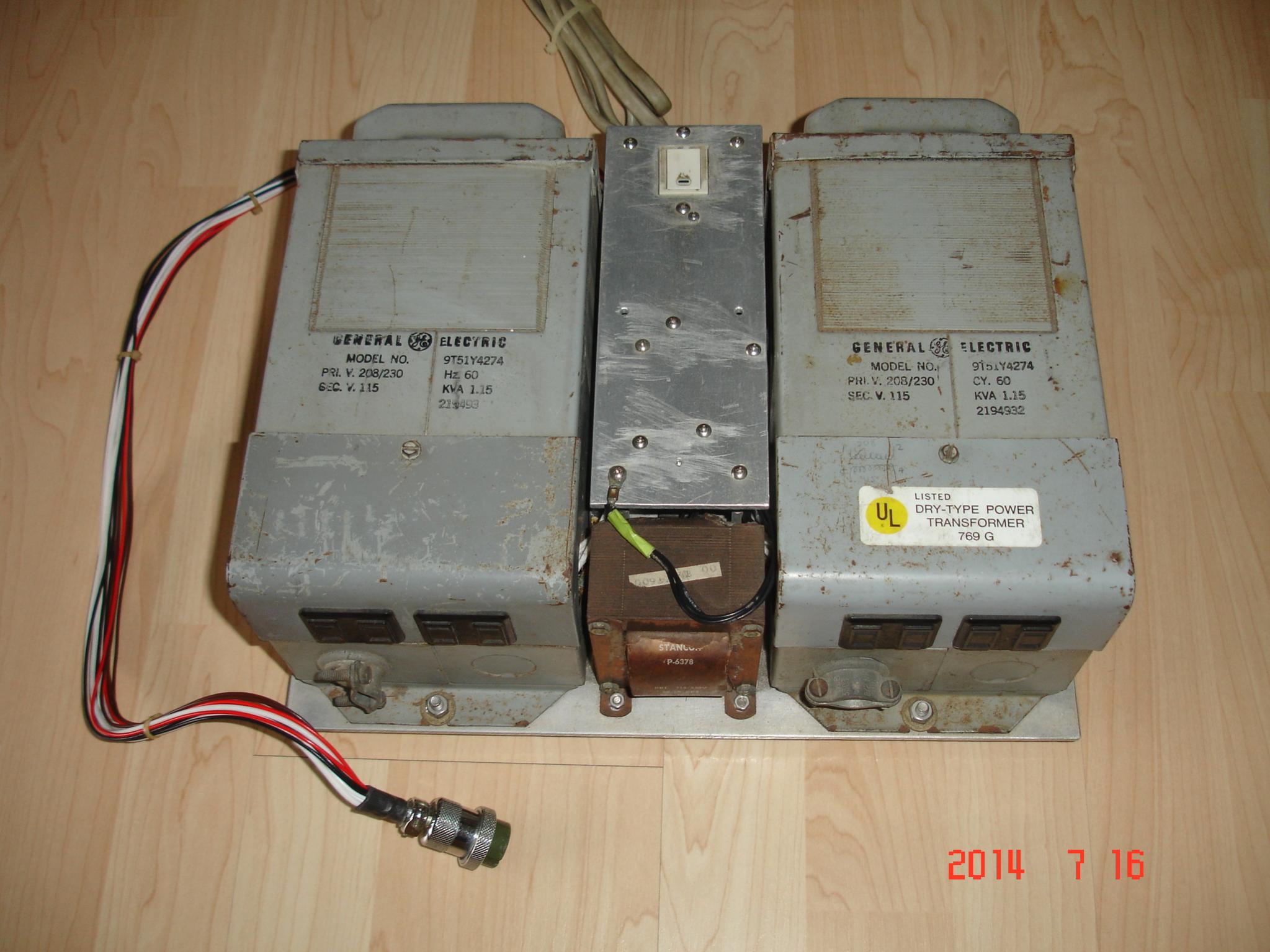

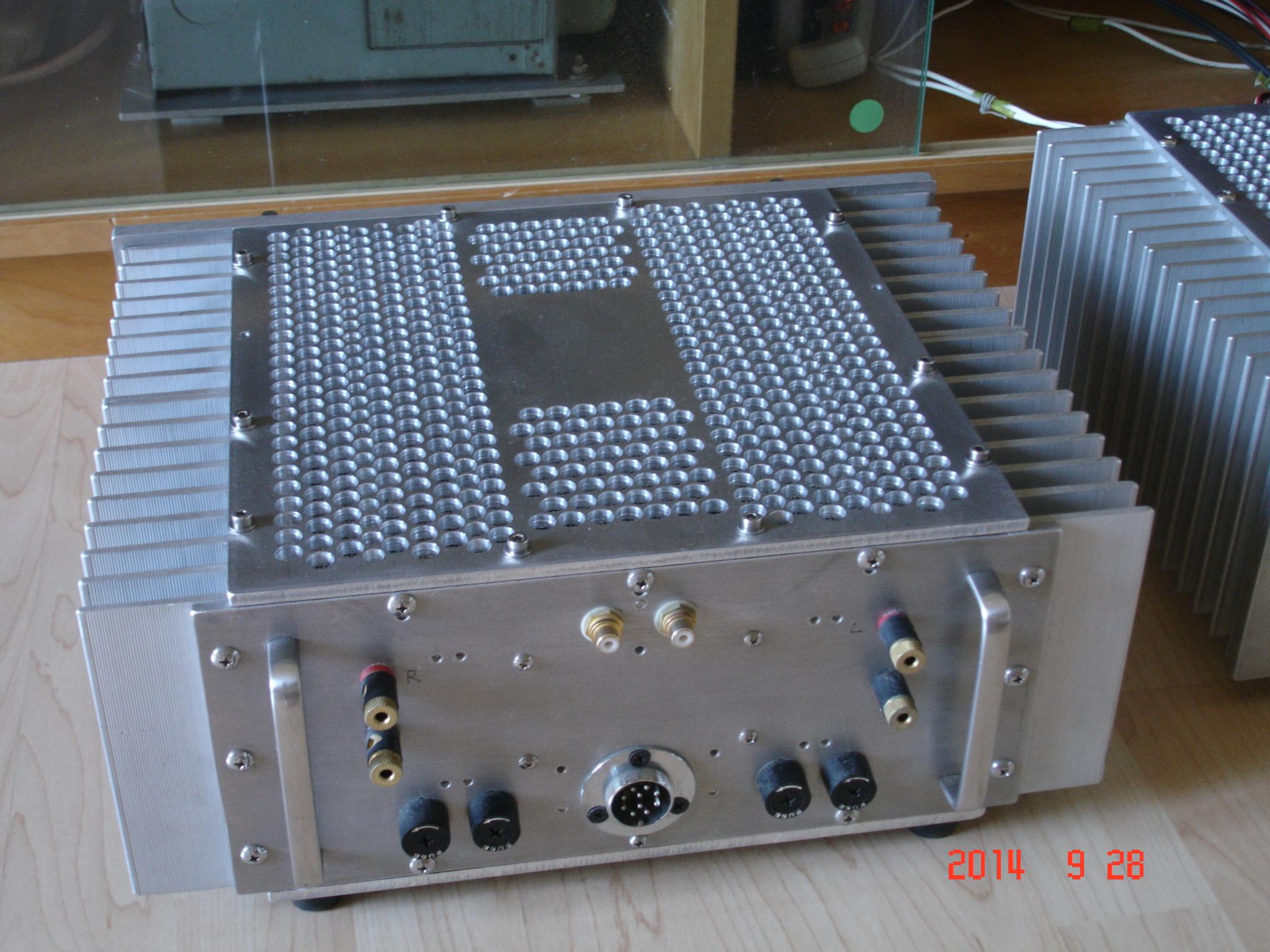

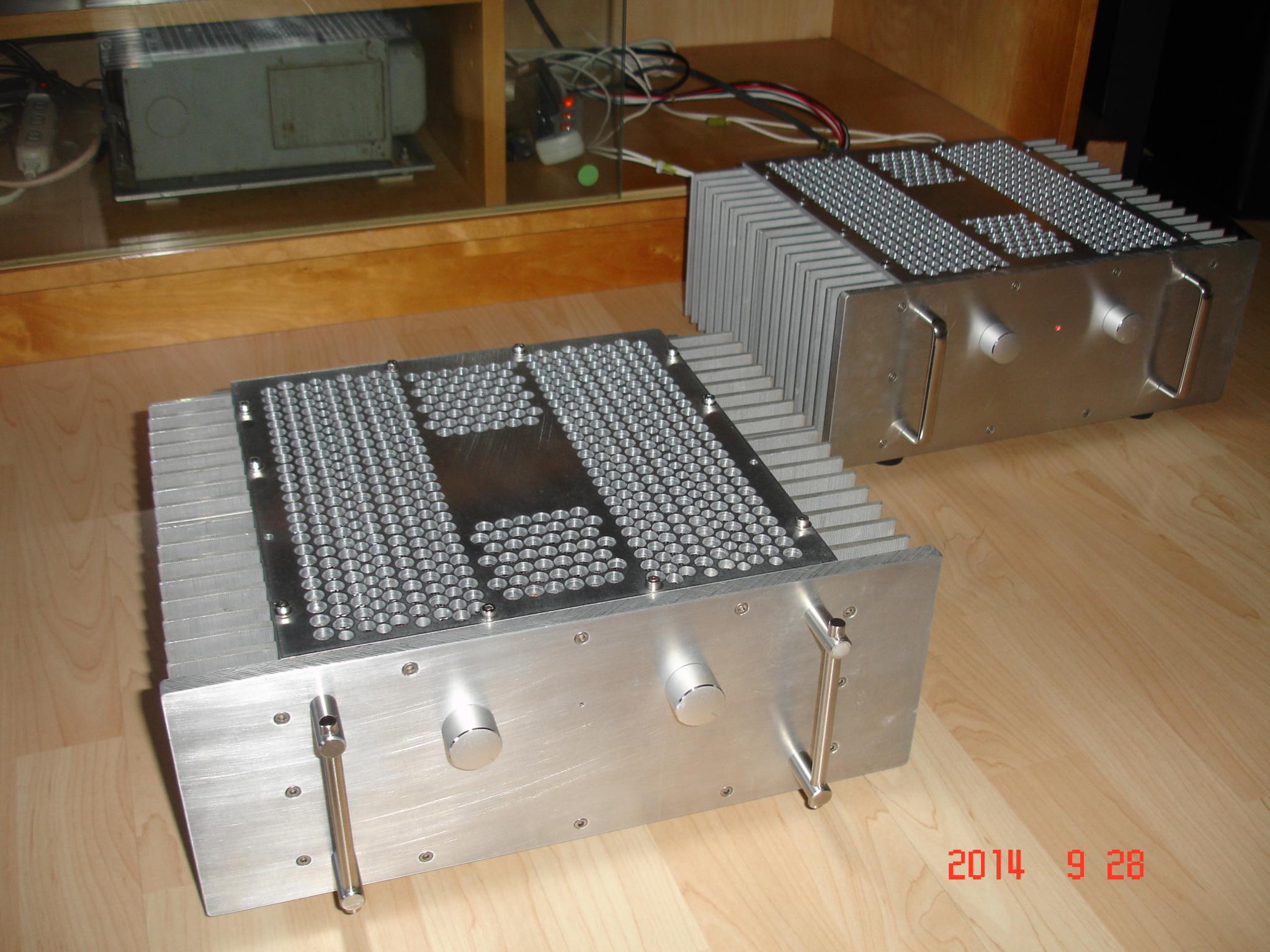

Yes, I intend to build it as solid as I can.

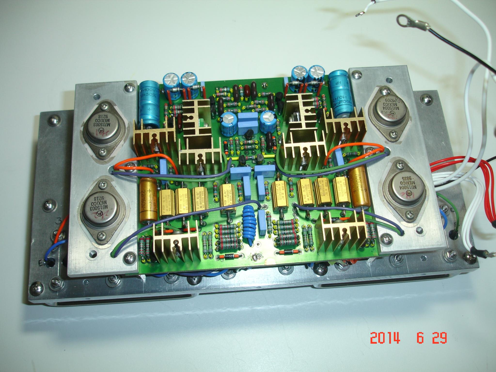

Attach photographs to show the inside structure of it and the components in my living room.
Just cleaned it couple months ago so it looks shining still.
Awesome leach build , MUCH better than most. Triple OP is the only way to go, took me over 2 years to realize this.

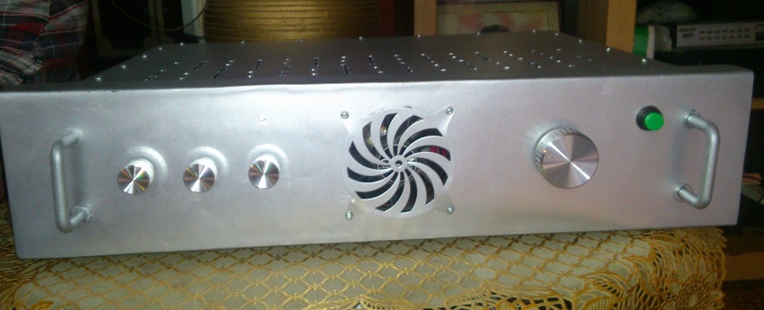

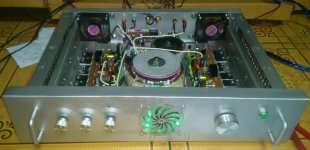

Attach photographs
Likely to sound a lot better than your class D integrated with dual triode valve input stage
(Philishave 908)

Hello Arius,
Excellent design and works!
A good design always looks beautiful and makes people feel comfortable.
John
Very beautiful construction.
Respect for the laborious task of the perforated plate 🙂
All for better air flow and heat sinking
John

Likely to sound a lot better than your class D integrated with dual triode valve input stage![]()
(Philishave 908)
You are absolutely right!
John
