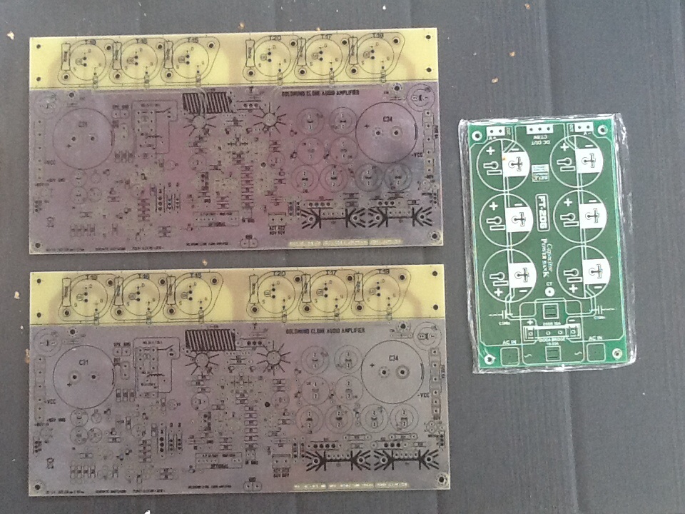

Next project
Next project: Goldmund Mimesis Clone :D
Boards arrived 10 minutes ago, thanks to Linvalb who had a spare pair of boards for me :nod:
I'm excited to start!

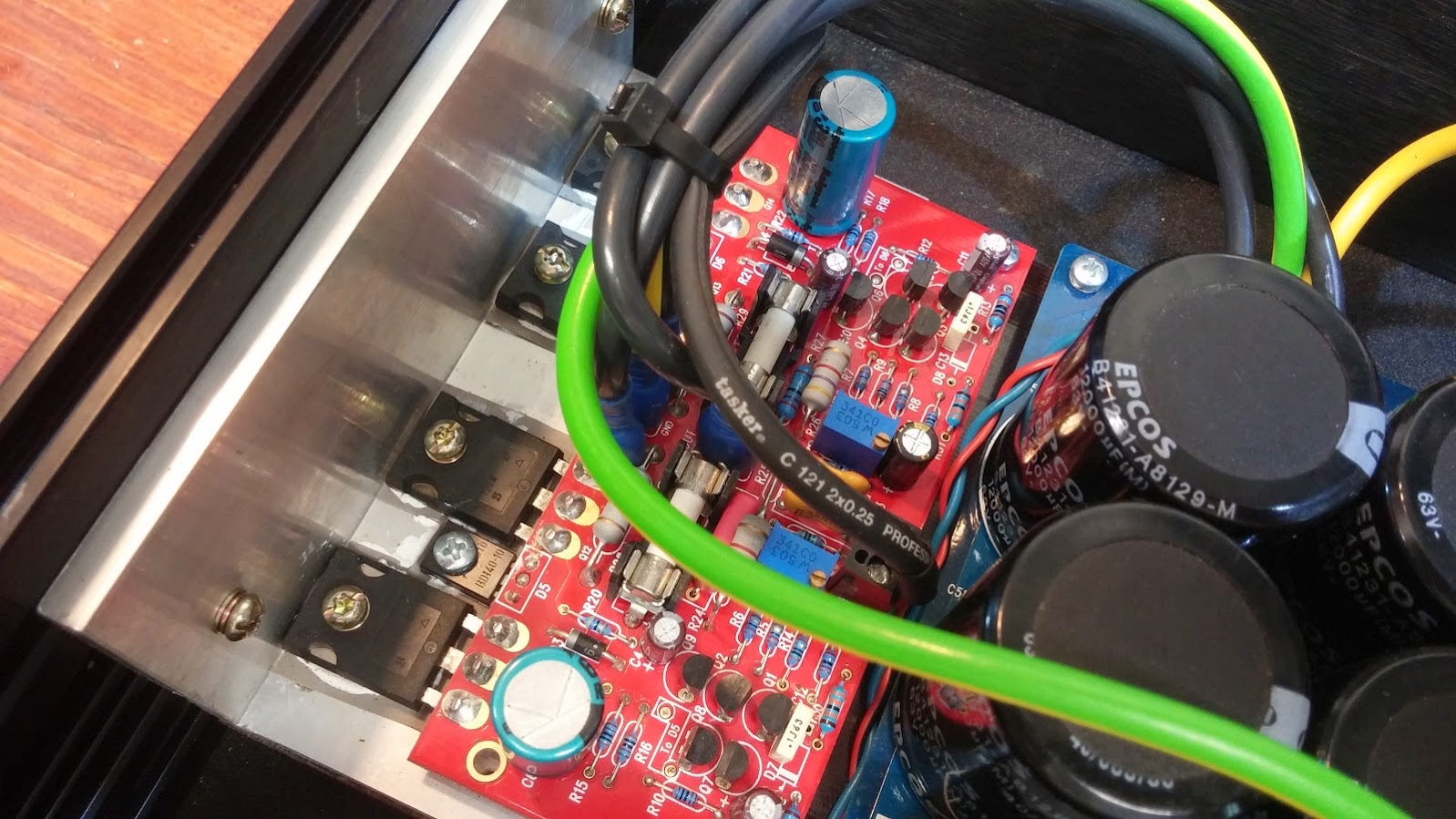

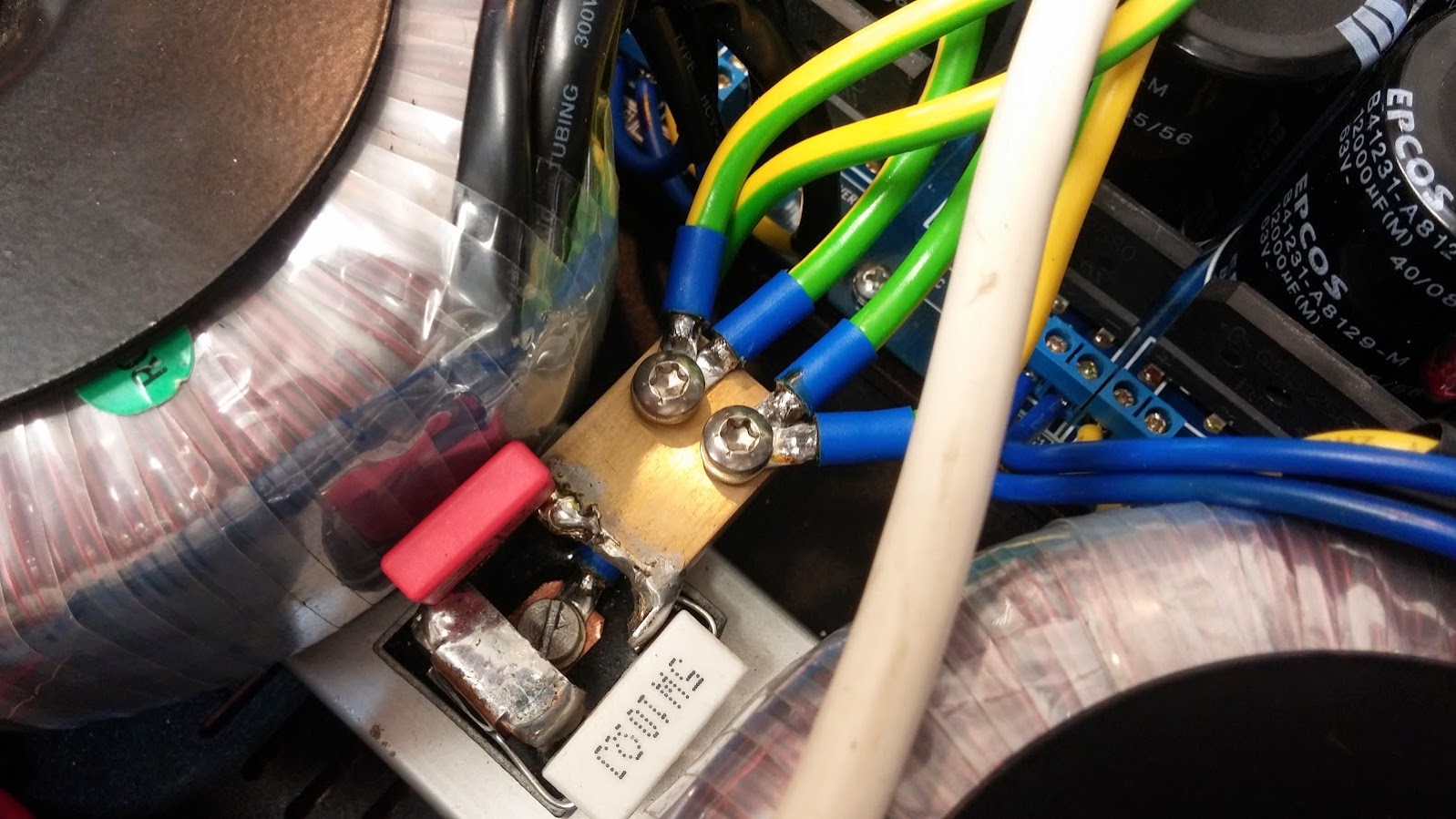

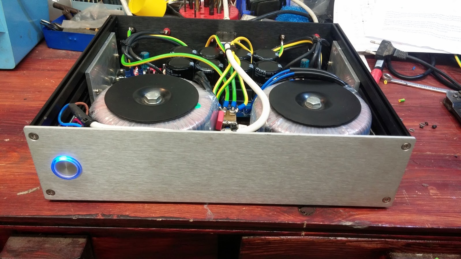

SKA GB150D
My first DIY project ..Dual mono construction, 2x 300VA toroidal transformers, dual rectifier PSU, 8x 12 000uf Epcos... :)

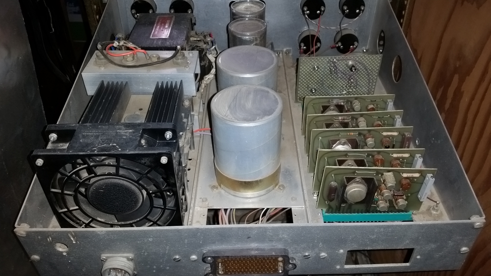

Power Amplifier with 1 kW Regulated Power Supply
This is my first power amplifier started when I was in high school; the amp was built from 1966 to 1968. Both chassis are made with scraped semiconductor test equipment from Fairchild Semiconductor, they needed room for the new uA709 tester. I made the front panels form blank rack panels. Most of the other components were purchased at various surplus stores.
The power supply has 5 regulated outputs; +/- 50 V @ 10 A, +/- 15 V @ 500 mA and 24 V @ 1 A. The regulator boards were etched with a process I developed using contact photographic negatives and ferric chloride on a hotplate with a bubble etch tank.
I designed a nonlinear current foldback circuit, which charged the 10,000 uF caps at a constant current of 1 A until the voltage reached 45 V, then increases to 10 A as the voltage reaches 50 V. This limits the capacitor inrush current until the end of the charge time. The +/- 50 V and +/- 15 V supplies are floating in the power supply chassis and are only connected together at one point with a ½” x ½” brass common bus bar in the power amp chassis. The first board in the power supply chassis is an auxiliary power supply, which is not switched off with the line power relay. It provides the line power relay with 12 VDC for remote power switch in the power amp chassis.

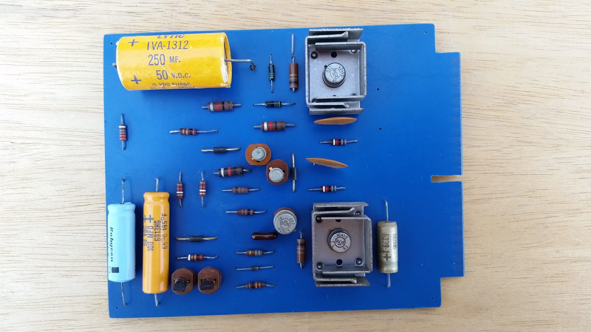

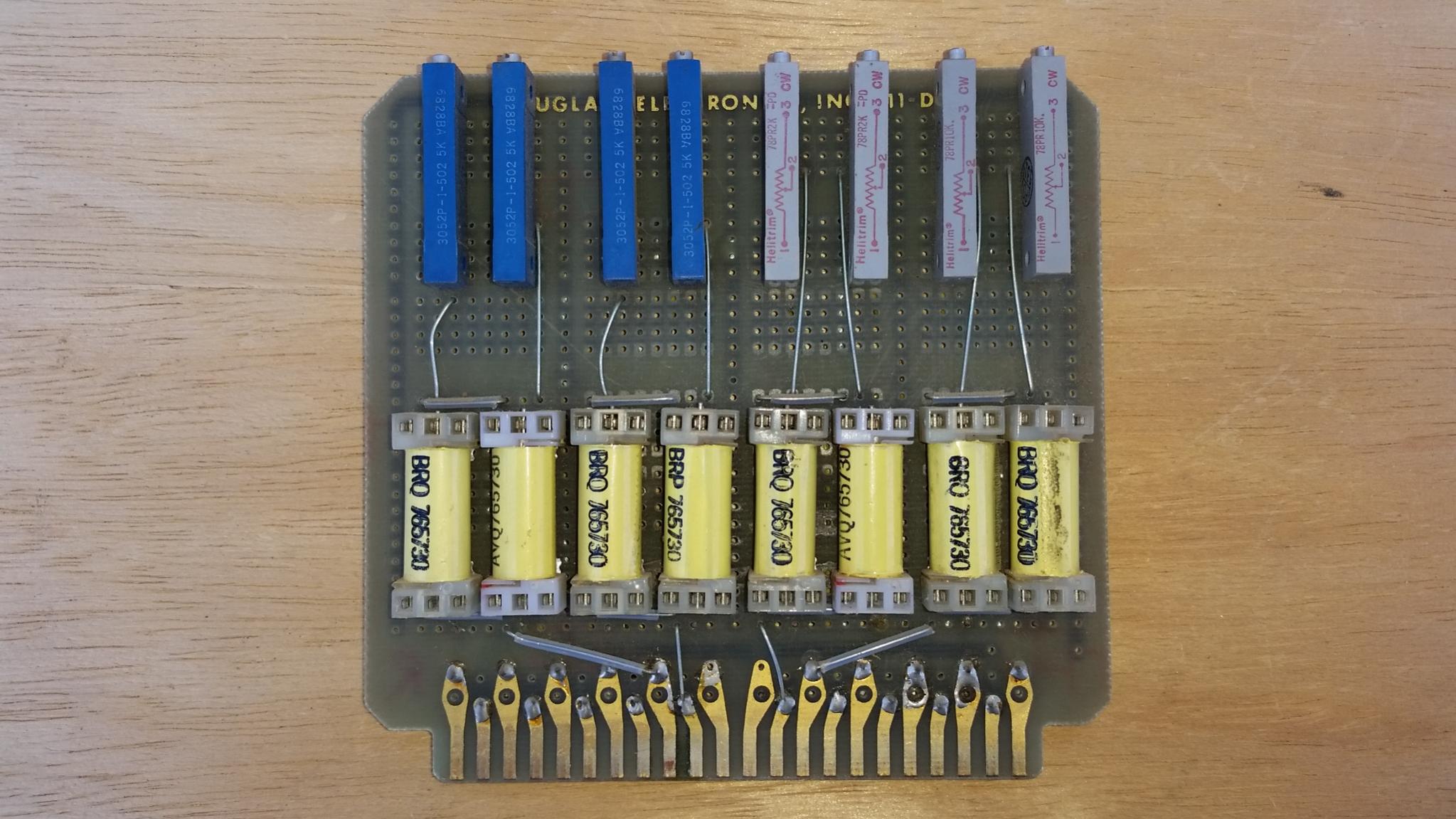

The input relay board has trim pots to set all the levels individually. The RIAA phone equalizer board amplifiers are discrete Intech Op-Amps. They are low noise FET input amplifiers with a 10 MHz bandwidth. The Intech A-148 amplifier was designed around 1965 and is the same basic circuit as the 990 Discrete Op-Amp, except for the FET input stage and inductors.
The power amplifier is a quasi-complementary symmetry design. All boards were designed to take advantage of the 22 pin edge card connectors, which allows interchangeability, bench troubleshooting and testing. Many years later I built a power amp test fixture also using 22 pin edge card connectors.
