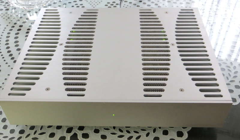

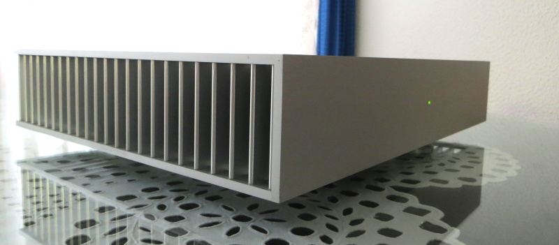

Hello, everyone, for the first time sent a message, this is my DIY amplifier of 0dB
Looks very impressive!
The best DIY amplifiers are coming out of Taiwan 😀

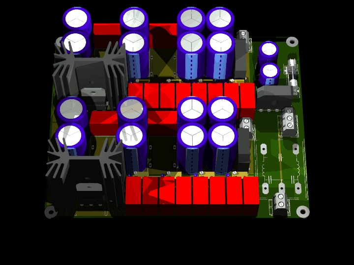

I only can say that:
These fully differential designs (from input to output, without conversion of balanced input signal to single ended) can give amazing results.
For example, with just +/-38Vdc supply rails per module (total four amp modules bridged per two) and a circuit implemented at whole with original trustable ONsemi BJT transistors (no need for Toshiba or Sanyo or Sanken small, medium, high power e.g. 5 pairs DH4411-D45H11 output transistors per amp) you could easily obtain an output power of 2 X 140 Wrms @ 8Ohms (20 - 20,000 Hz +/-0.1dB) with just 0.007% THD, a bandwidth close to 750KHz (-3dB) and a rise time of 0.5μsec (-68V to +68V) or a slew rate close to 250V/μsec.

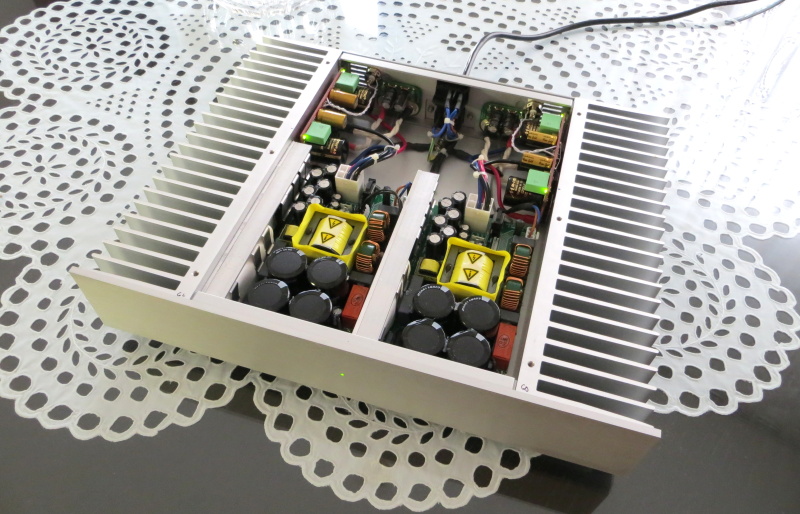

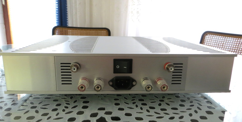

Apparently is a true symmetrical design. There are four amplifiers total, bridged per two, to form the LEFT and RIGHT channel. And of course only balanced (XLR) inputs are offered of which the hot(+) is connected to the input of one amplifier and the cold(-) to the input of other. The speaker is connected across to the outputs of the 2 amplifiers, the pos. terminal at the output of "hot(+) amplifier" and the neg. terminal at the output of "cold(-) amplifier". There are some significant benefits offered by this topology.
Hi FOTIOS Thank you! Your analysis is correct!
Operating voltage + / - 48V, power 1400W each transformer
This 0dB no voltage amplification circuit
It means this is fully differential (bridge) impedance buffer stage, having 0 dB voltage gain. It accepts balanced signal from any low Z high voltage preamplifier. 😉

First One modules transformed into VSSA chassis. It is enough compact? 😀
Simplicity and technological sense, is great work! 😎
Switching Power Supply sound performance then?
Hello, everyone, for the first time sent a message, this is my DIY amplifier of 0dB ...
Very tidy!! Well thought out, good board work, nice assembly with quality parts ... Totally.
... Four amps, two per channel, balanced Input, dual P-supplies ... !! Crazy like a fox !!
