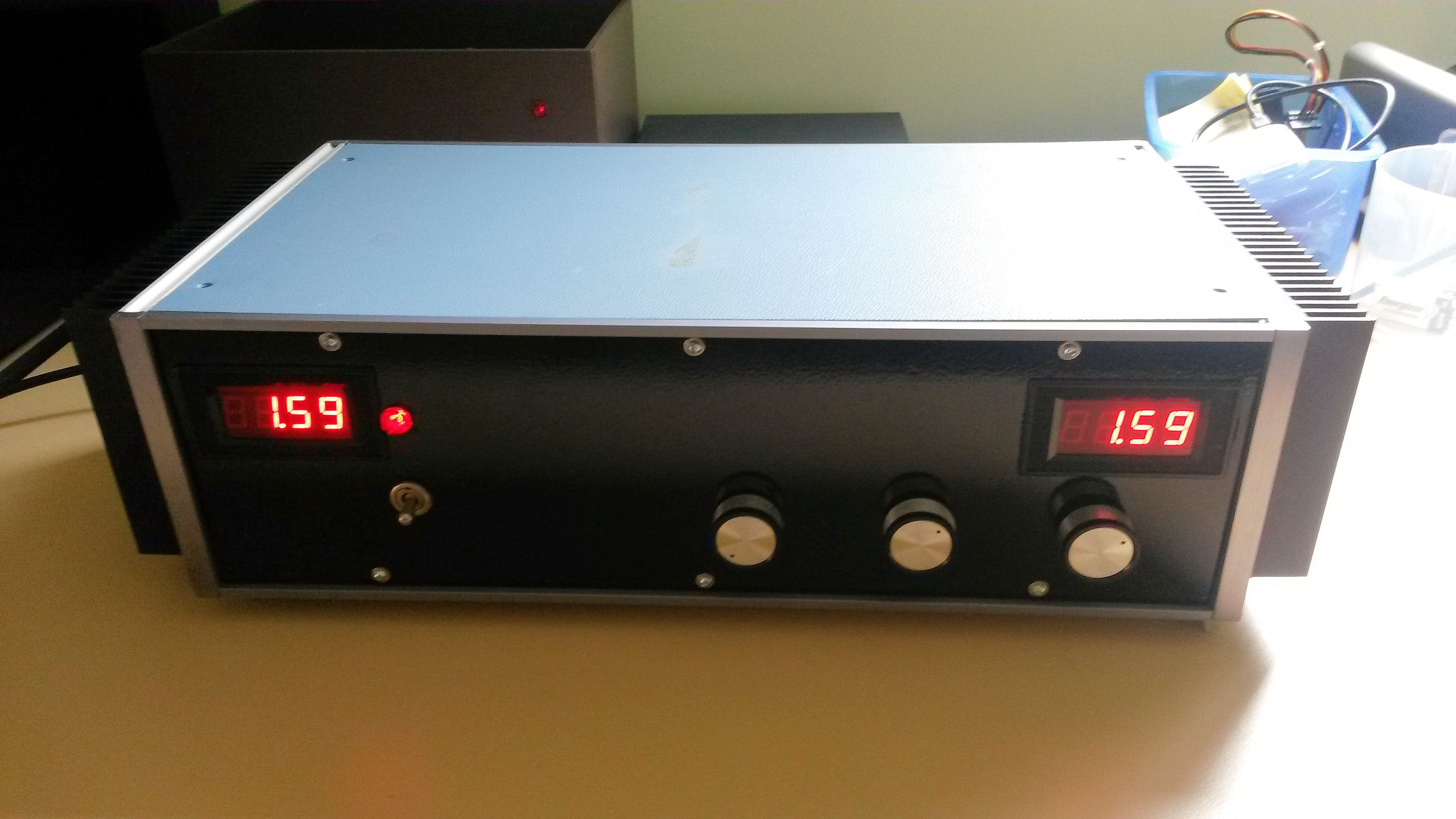

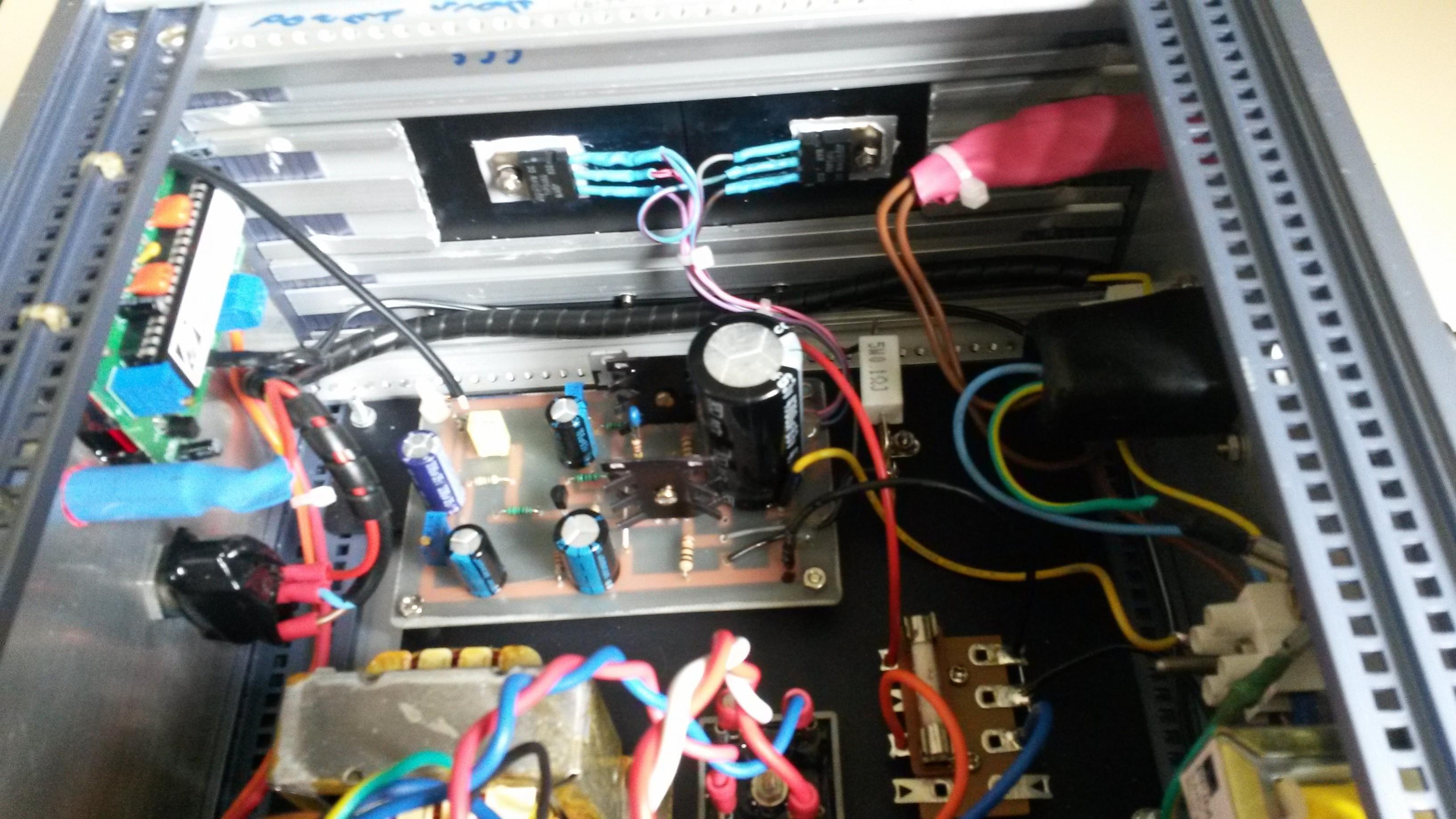

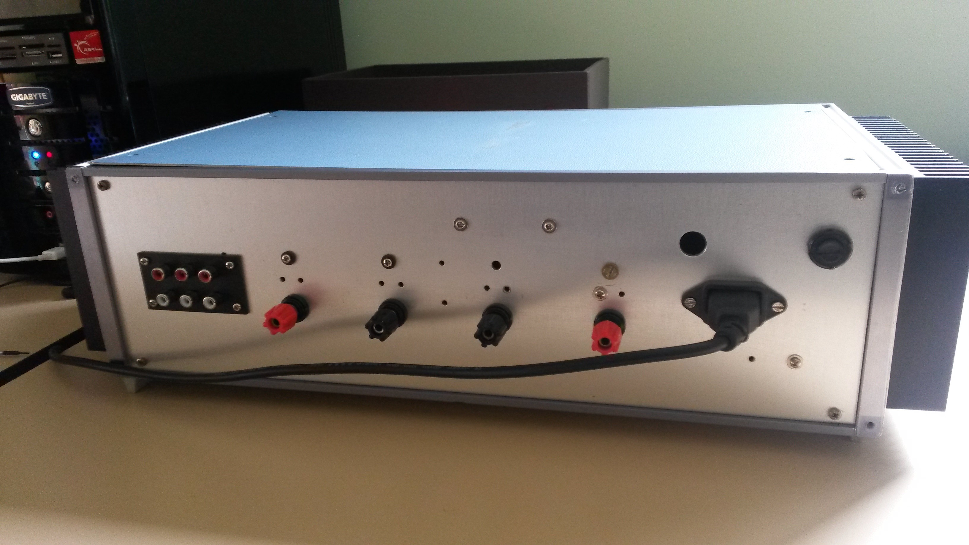

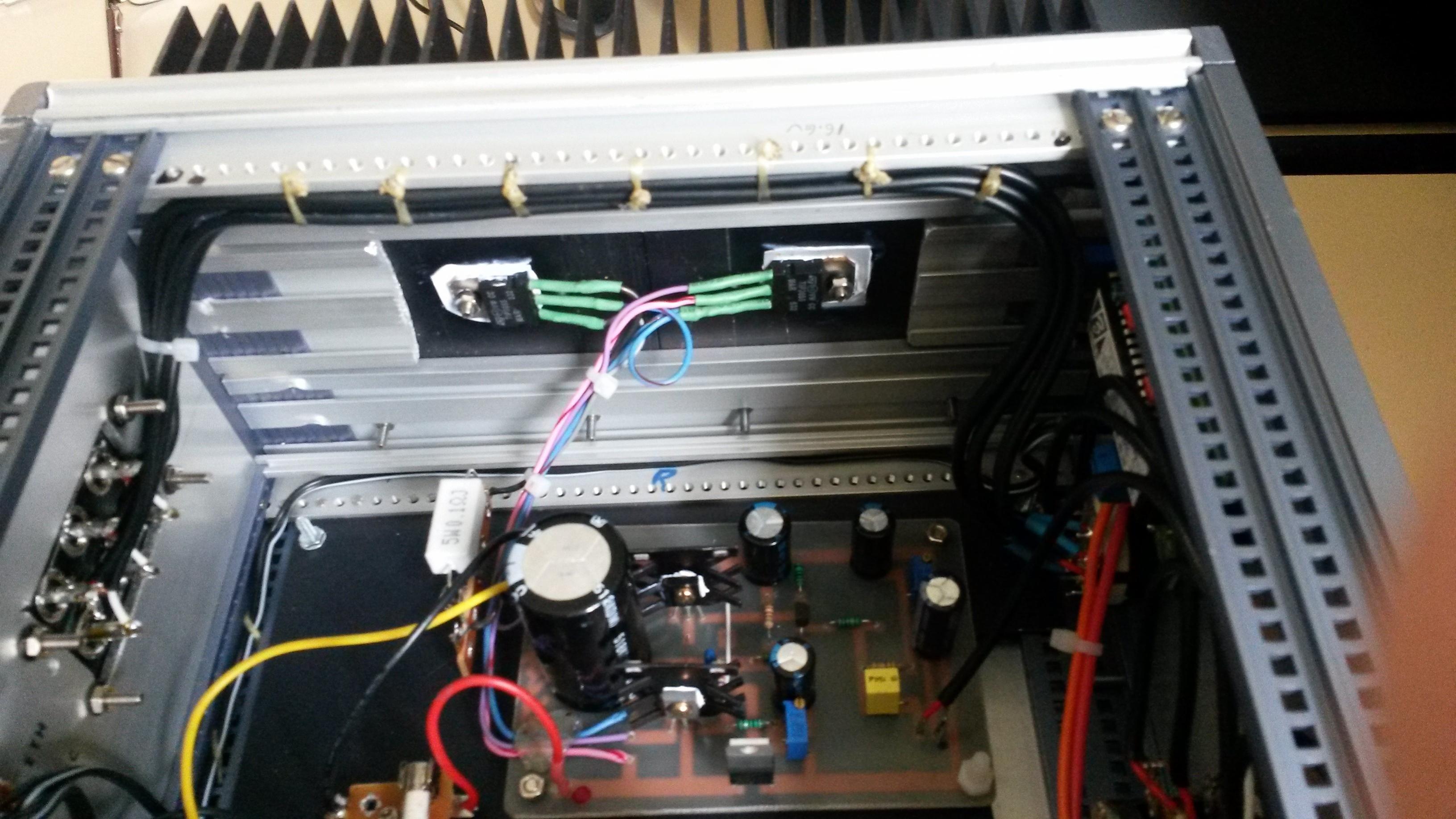

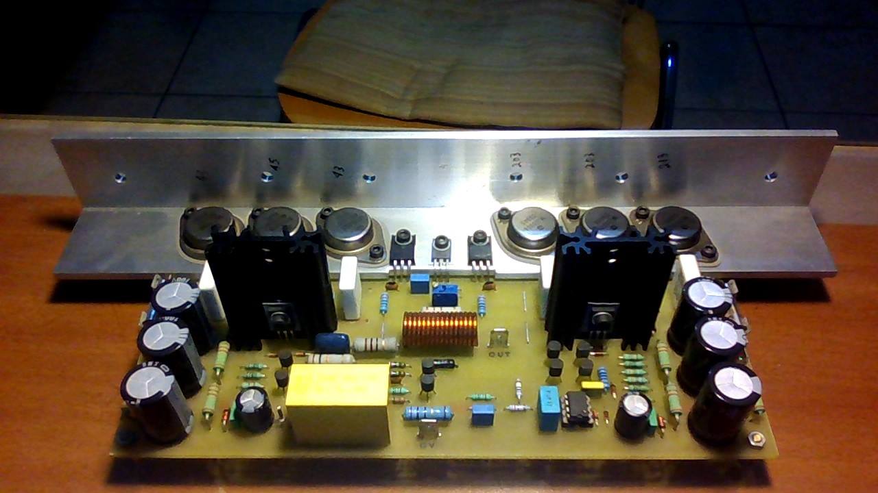

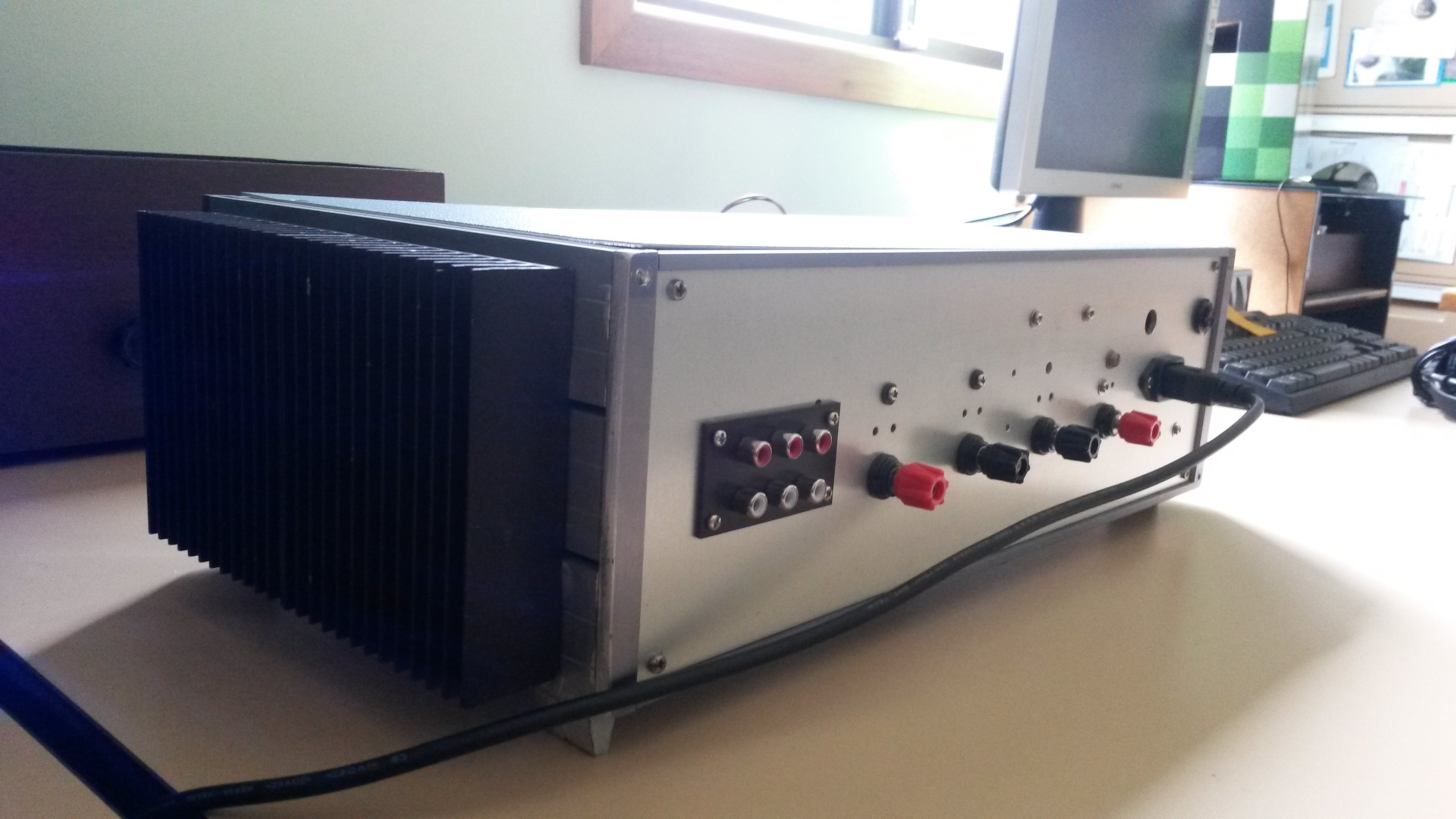

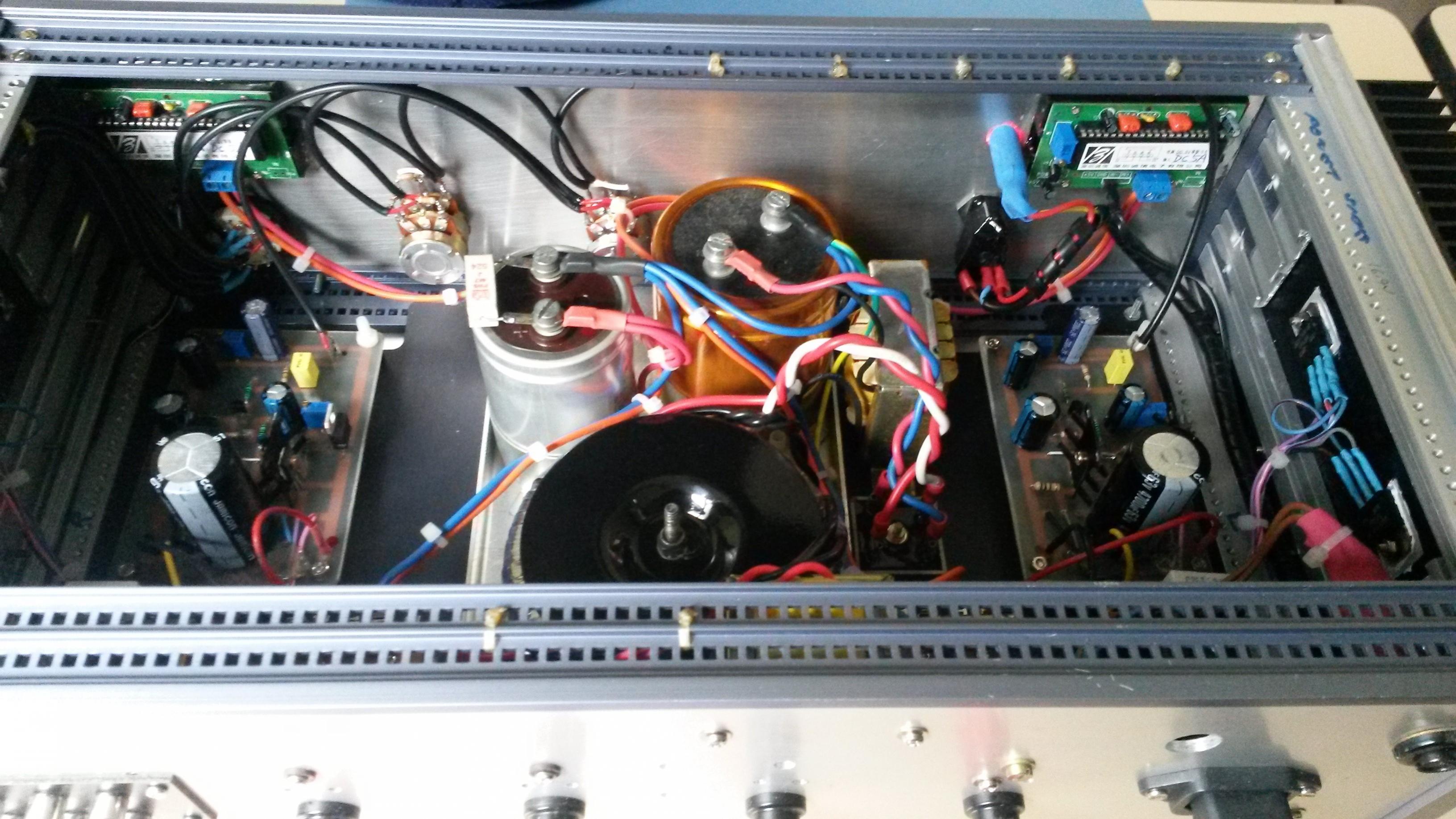

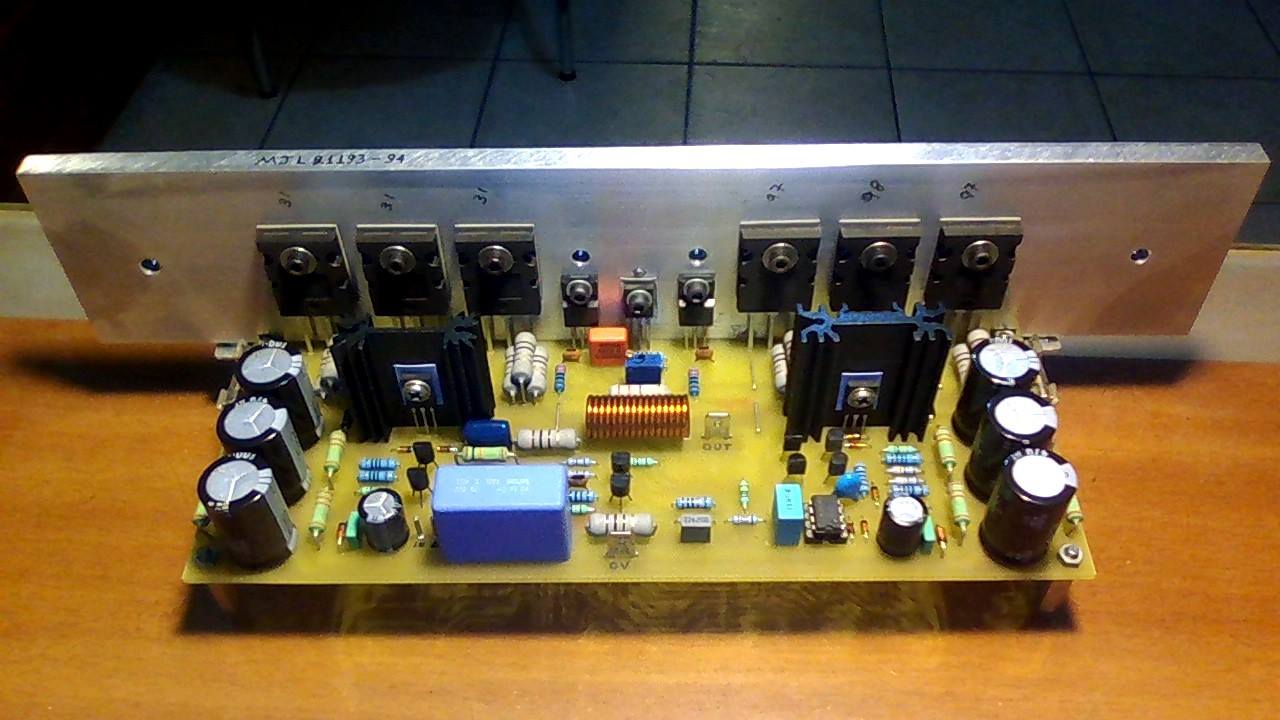

My P68 with 8 output transistors, supply pcb with DC protection/delay and Diyaudio soft-start.
My Class A amp
Pure class A based on the "death of zen spec" 54 watts dissipation for 15 watts rms output into 8 ohms per channel.
Construction though is very very wrong
The #1 thing that you don't do is to twist the cables and even more worst tie together the 3leads of a NPN and PNP output transistor ..."heavy" currents flowing there in C and E of each transistor will interact at some point with the B
Bad practice
