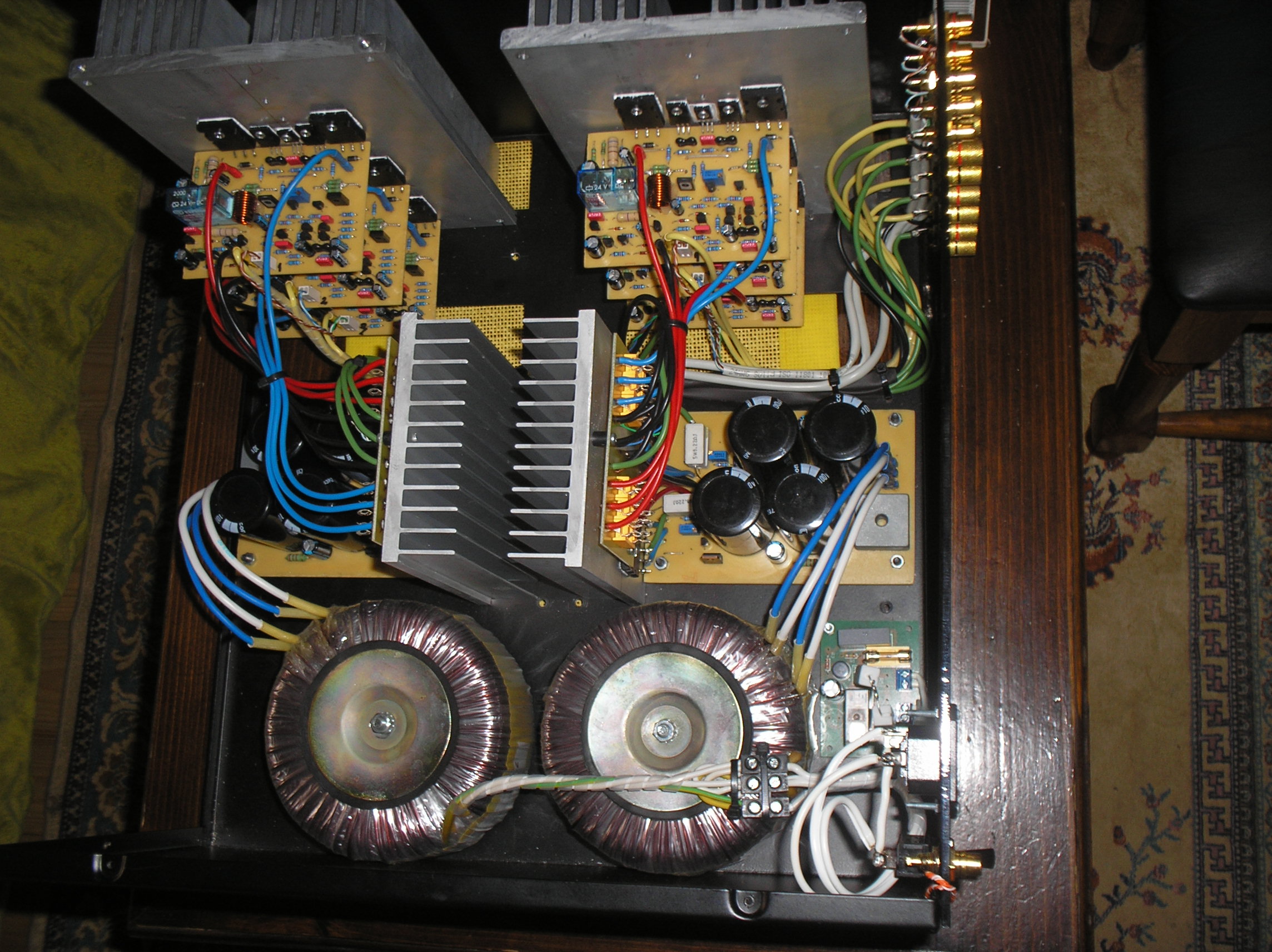

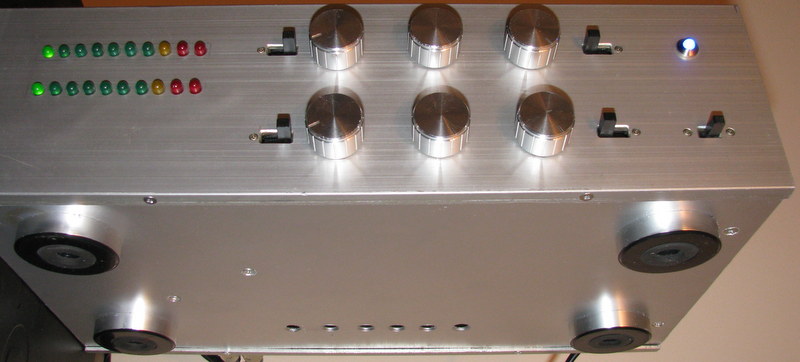

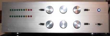

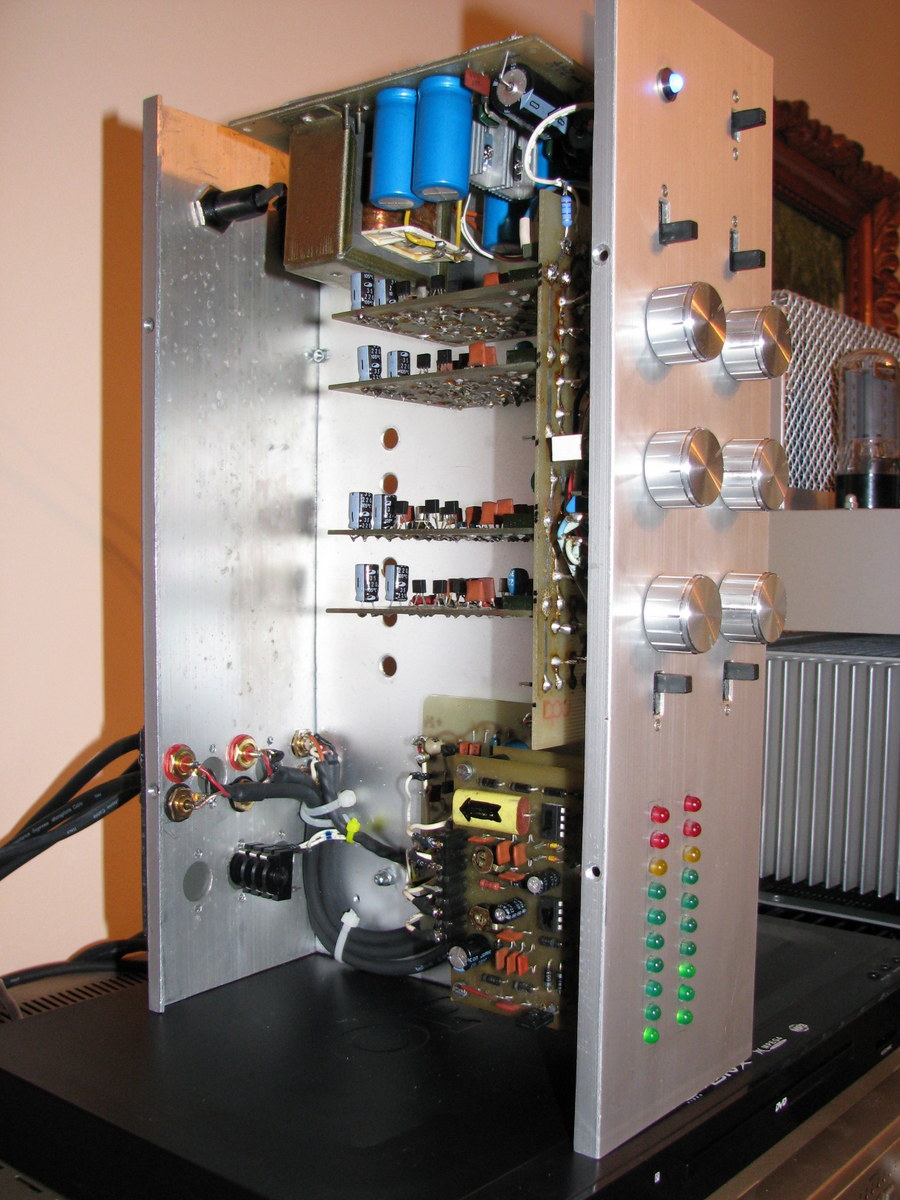

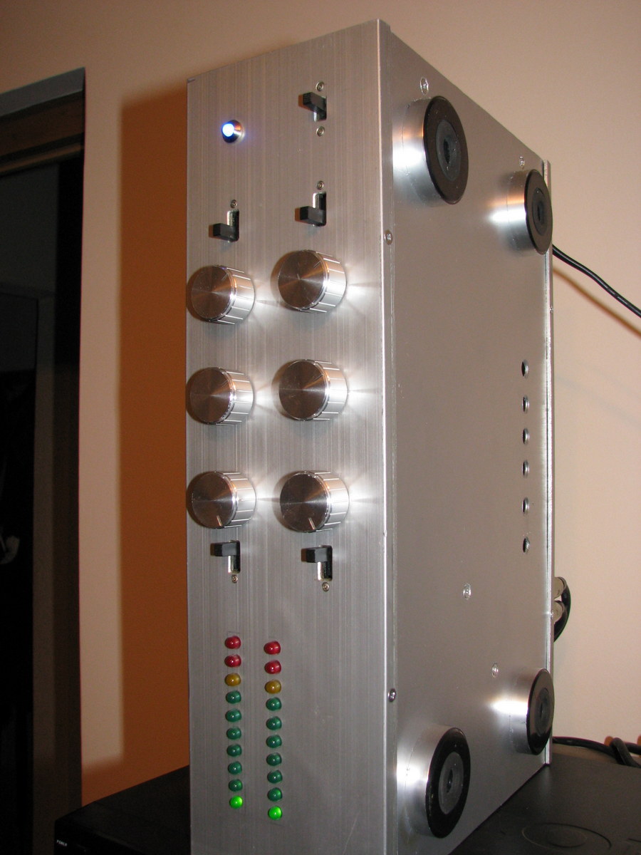

My 33 years old preamplifier , recently I have change some parts ...... Schematic from Electrosonic Ltd.

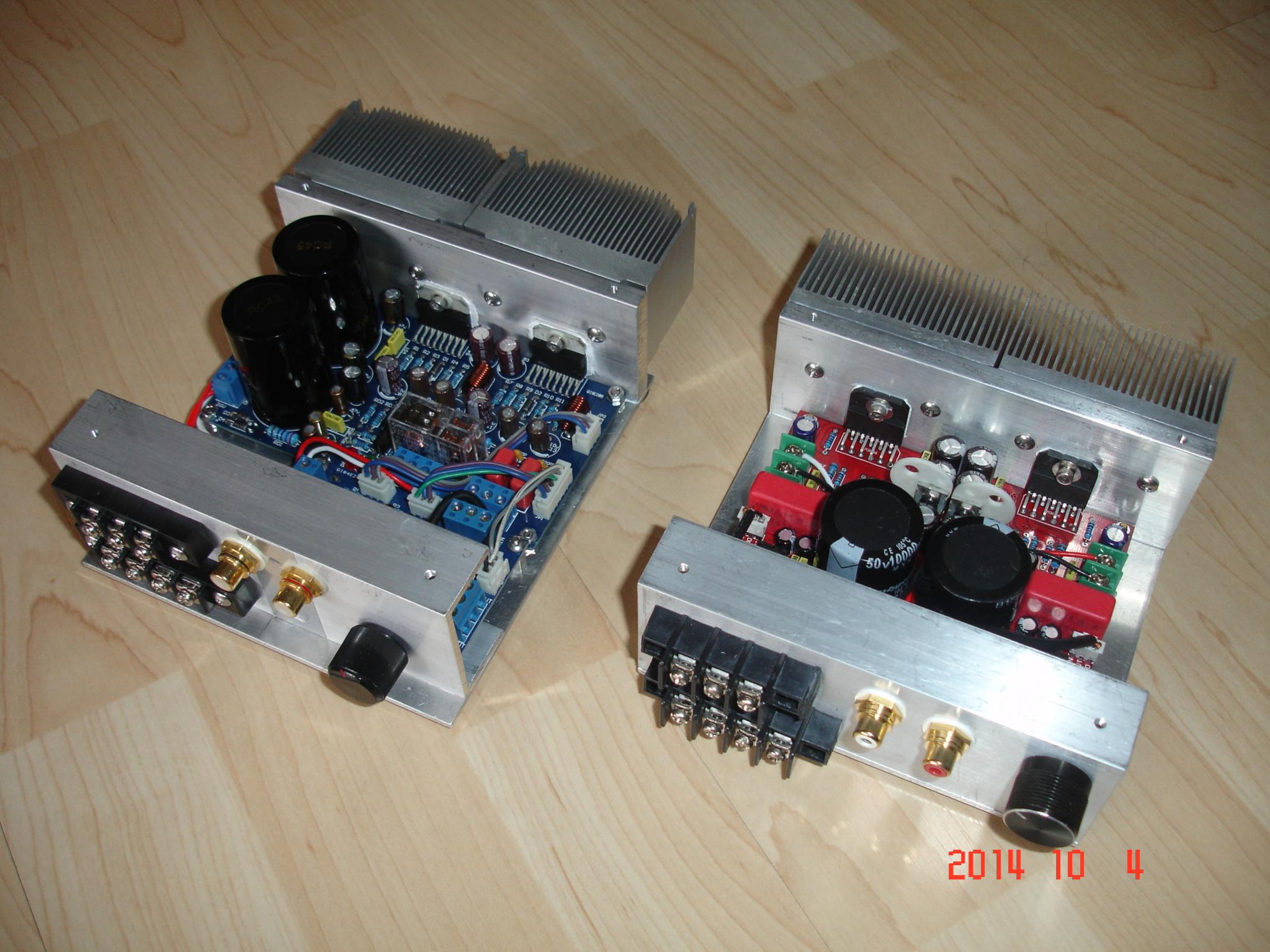

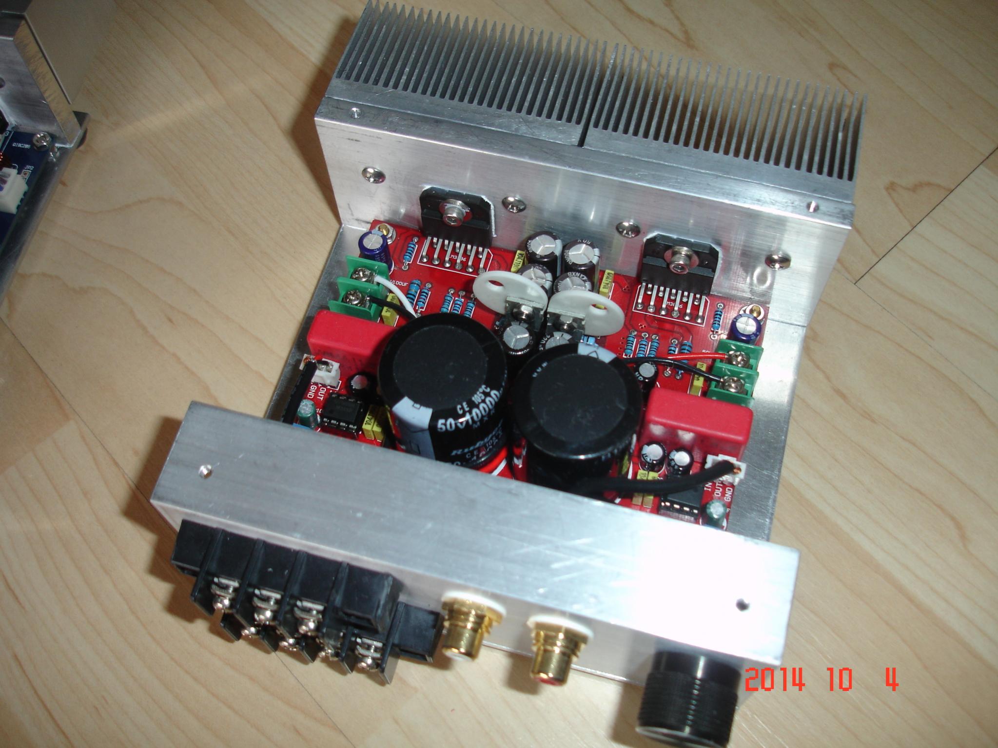

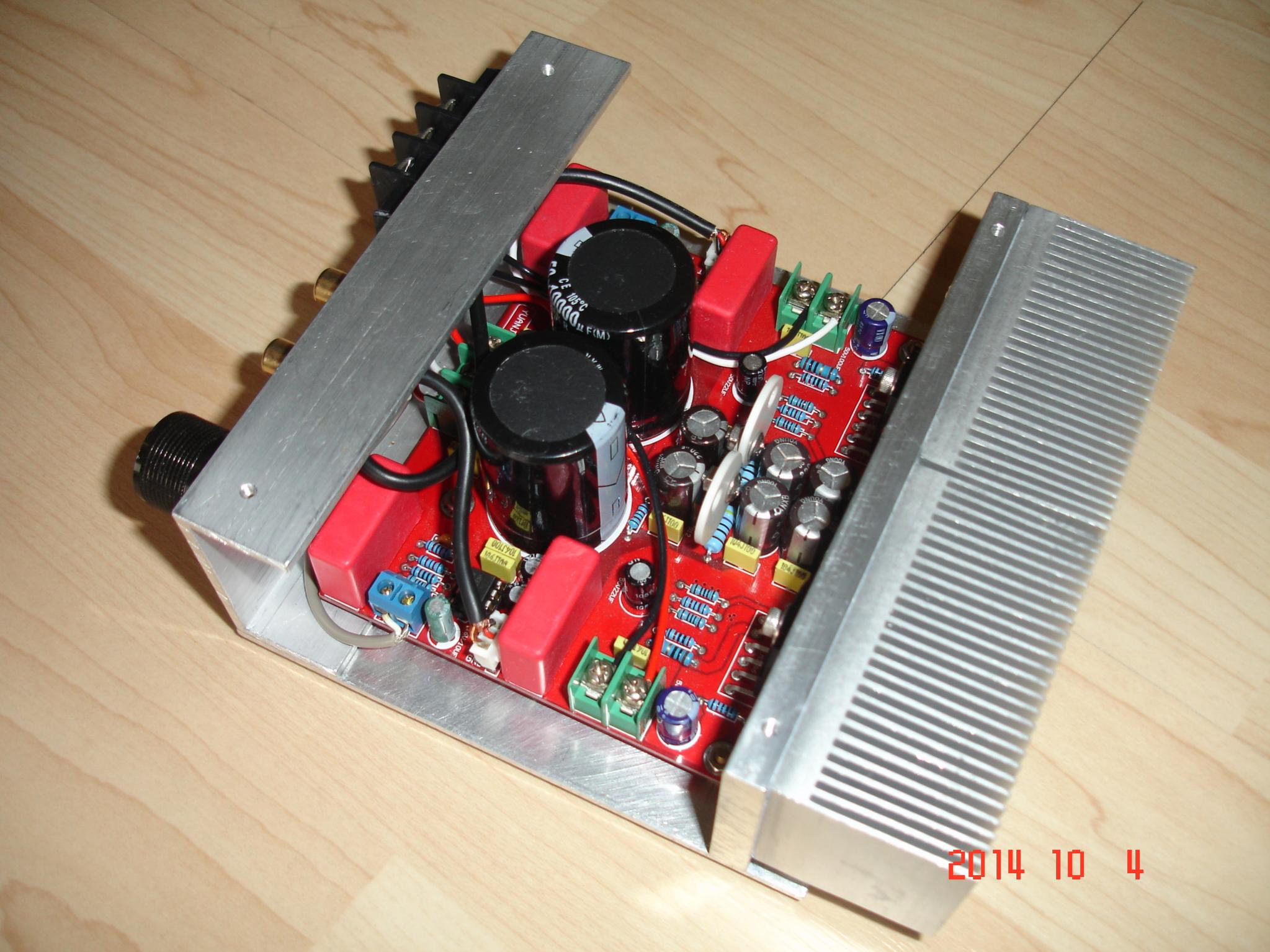

Two little toys, LM3886 and TDA7293 chip amps.
1. Sawn in half 2'nd hand CPU heat sinker.
2. Minimized Al chassis.
3. Power transformer located externally.
-- No need to re-invest for a same spec transformer (save $ or provide flexibility for fun 😀 )
-- reduce the potential noise.
John
John
I like the LED vu meters! 😎
John

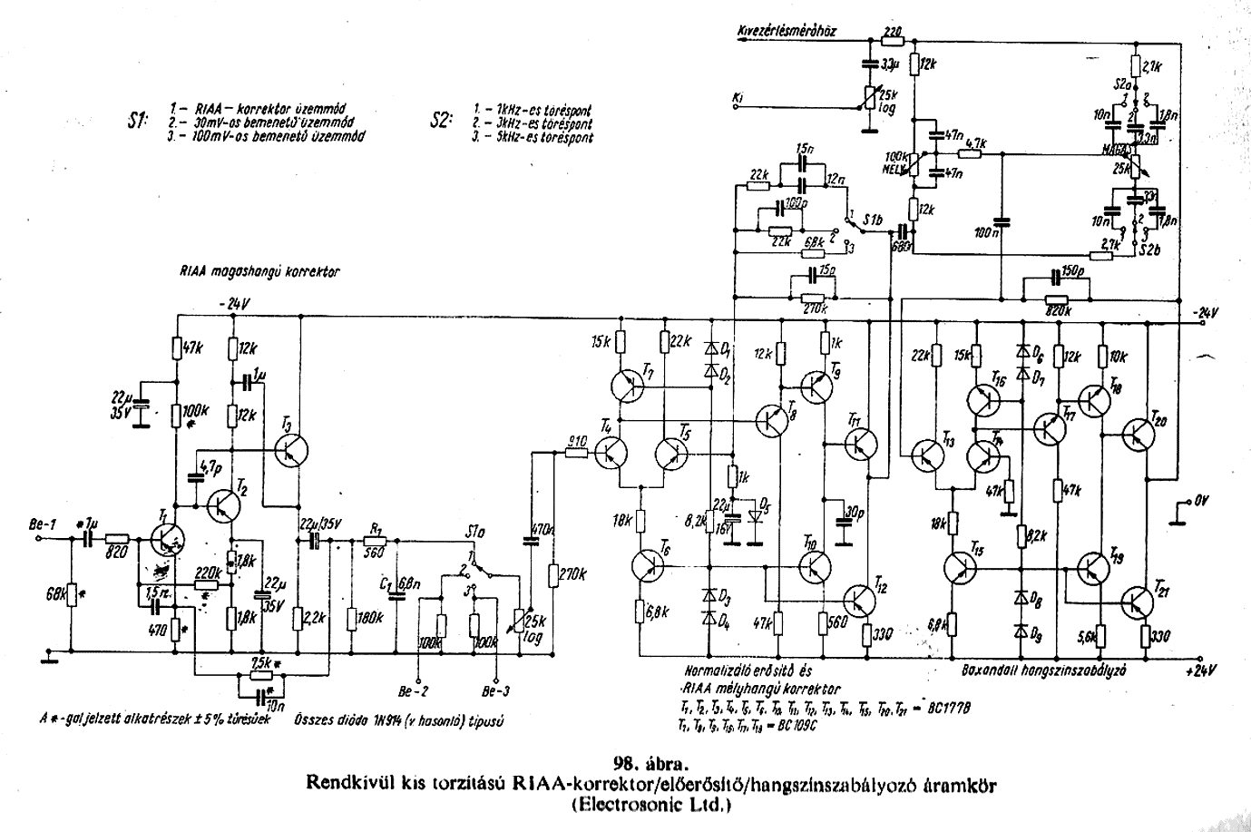

Any reason not to throw it away? Schematic?
John
Nice compact amps,I will build as yours soon ......
@Jay I's in function sometimes to compare with my vacum tube preamplifier😉
Schematic attached .....
Wow, ancient PNPs. I would prefer this than chip-based baxandal tho.

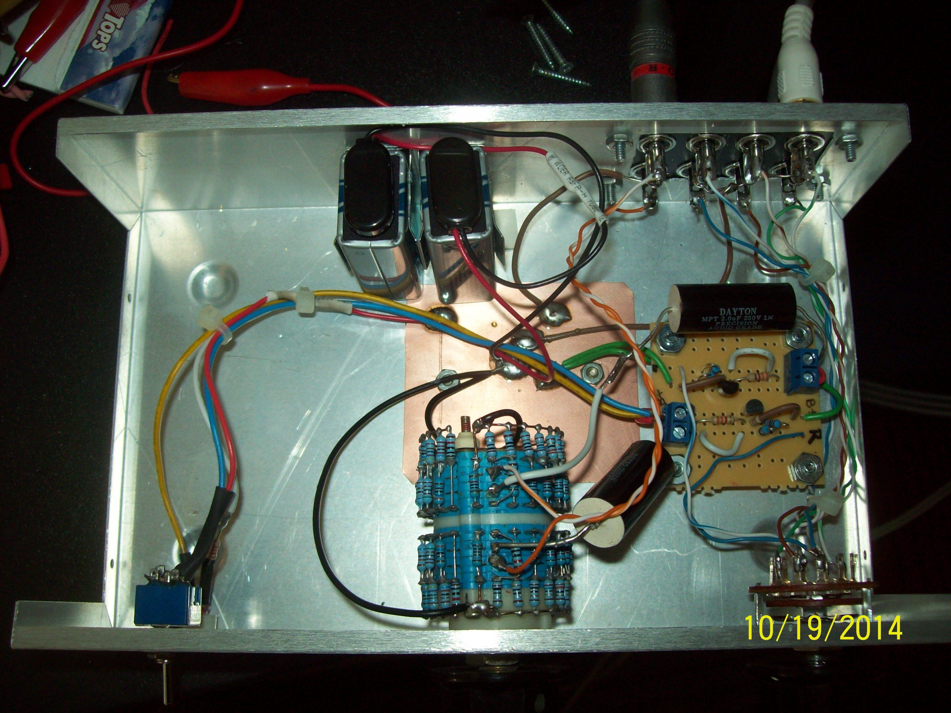

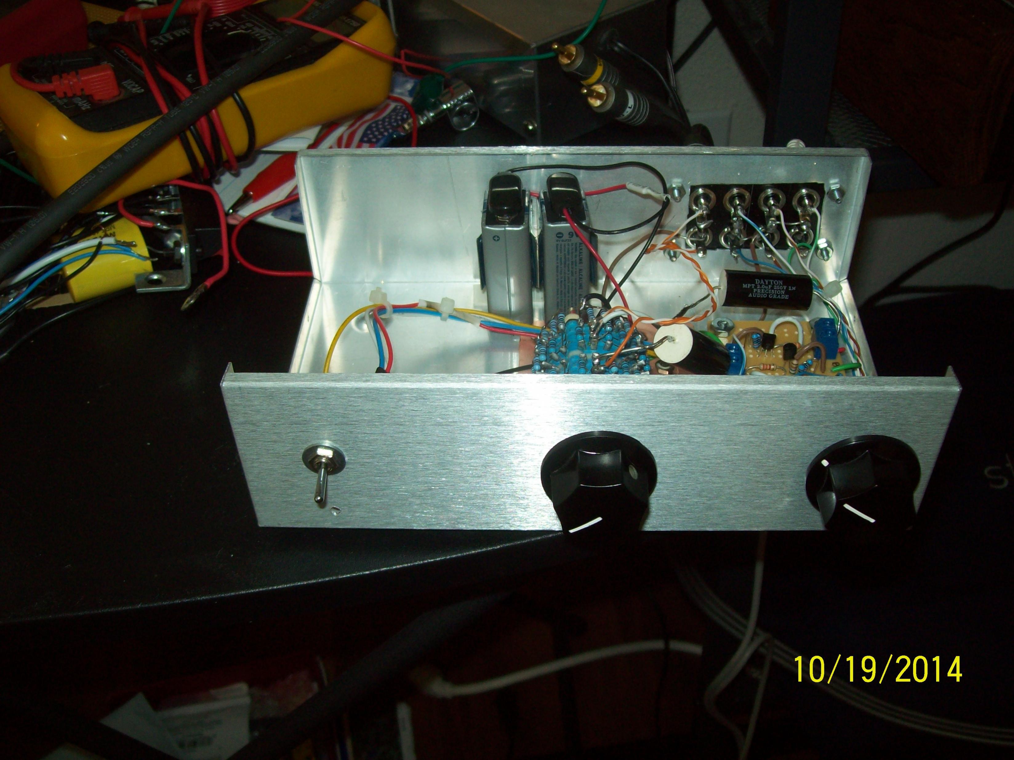

Battery powered pre
Needed a boost for my small power amps - this was a great solution. Had doubts about MPF-102 as audio device, and had a devil of a time getting two matched per the procedure at beavishifi.com (went through over 40 jfets), but the result is very good IMHO. I made the coupling cap to the volume control semi-removable, as with these Dayton caps in place, squares are outstanding from about 100 Hz through 100Khz, with some irregularities below this. In listening however, lows do not appear to be a problem as they are present, and of "good quality" (for me). I will want to try some different caps for the heck of it. I realize that improvements can be made dealing with input capacitance of these devices, i.e. buffer etc., but I like the simplicity of it too much-and as long as the music presentation is good..........its good.
Beavis Hi Fi
Terry
Beavis Hi Fi
Terry

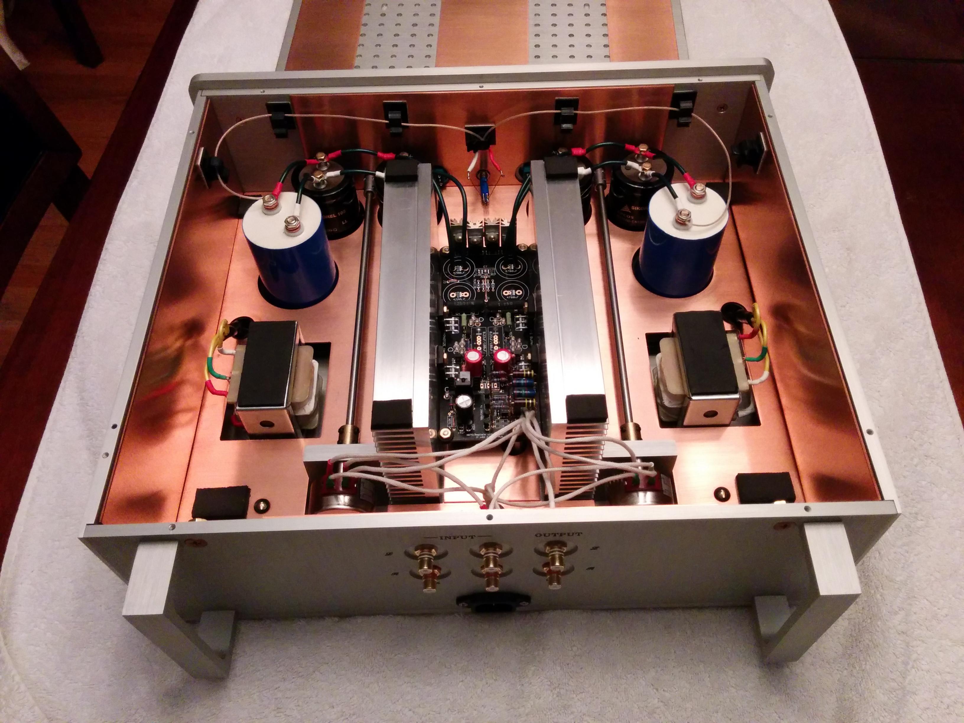

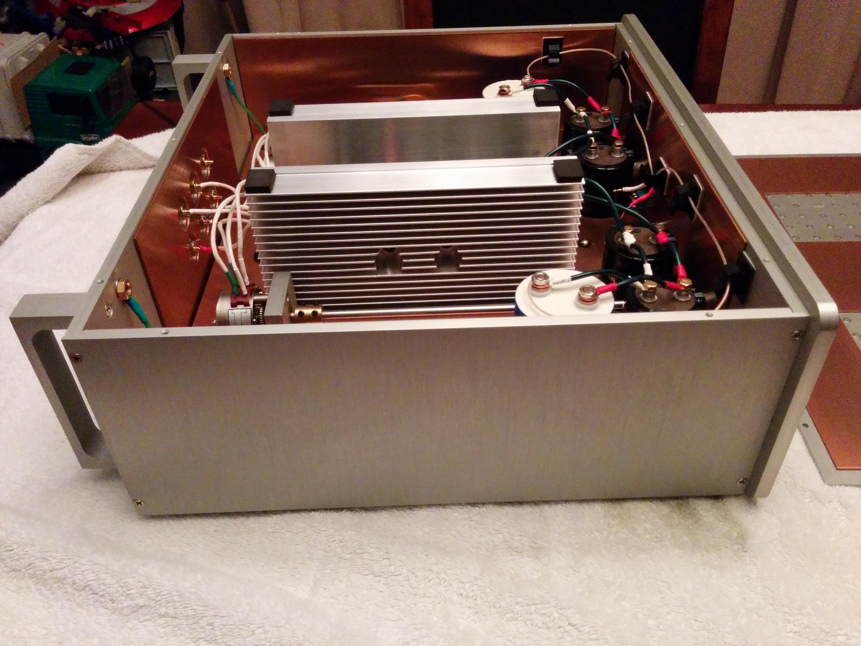

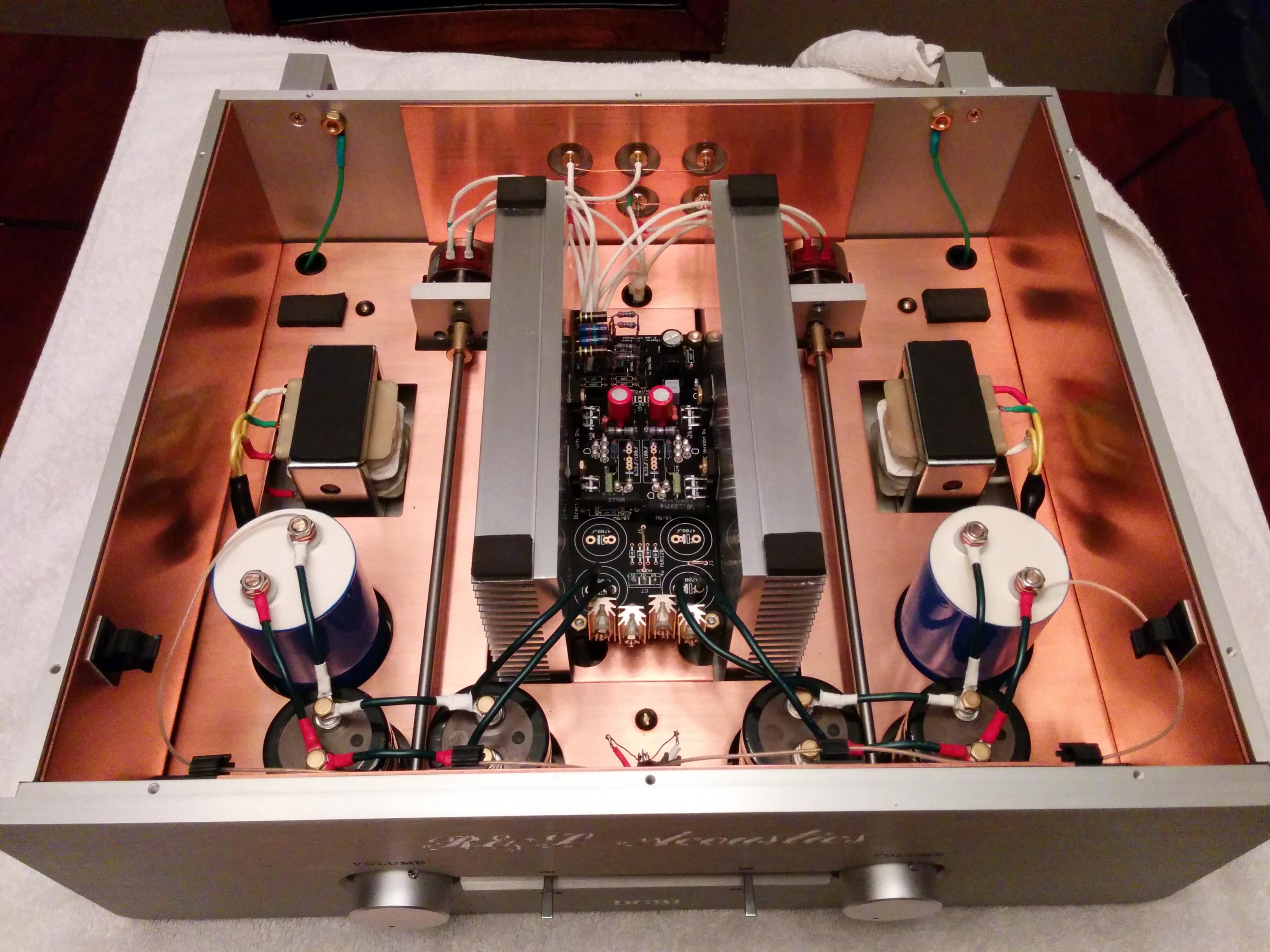

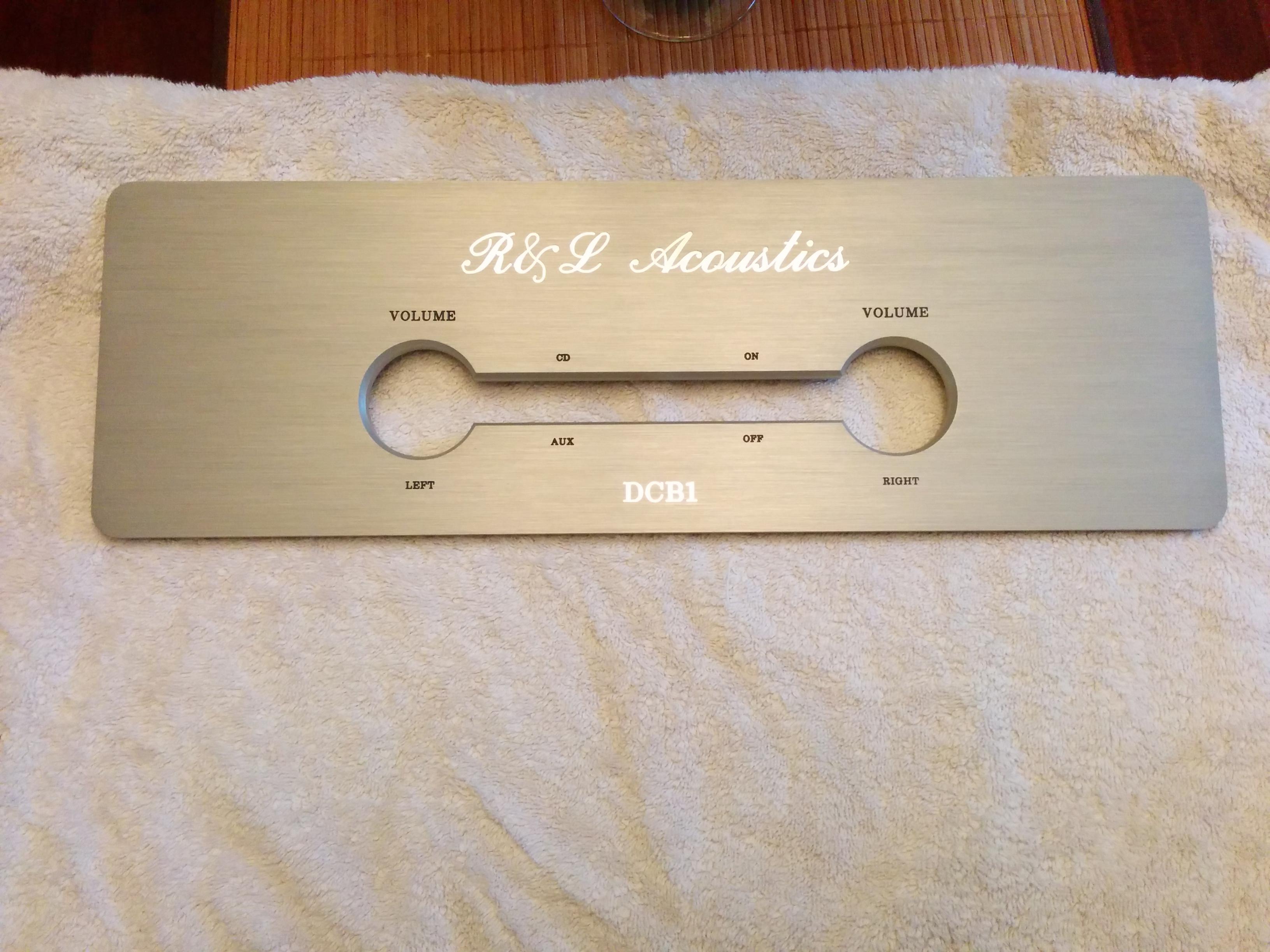

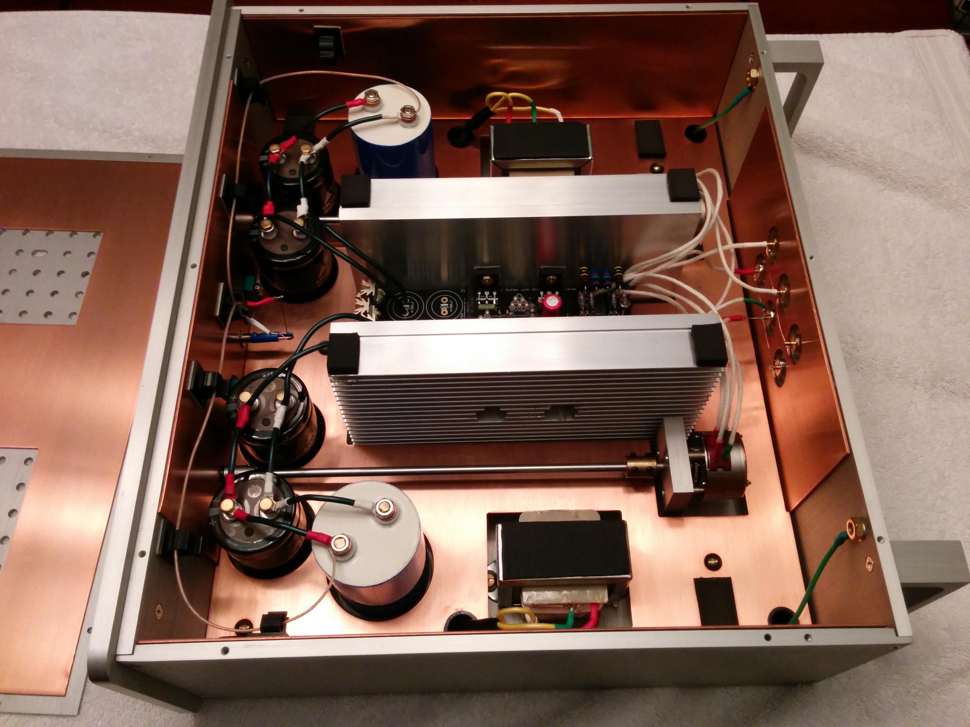

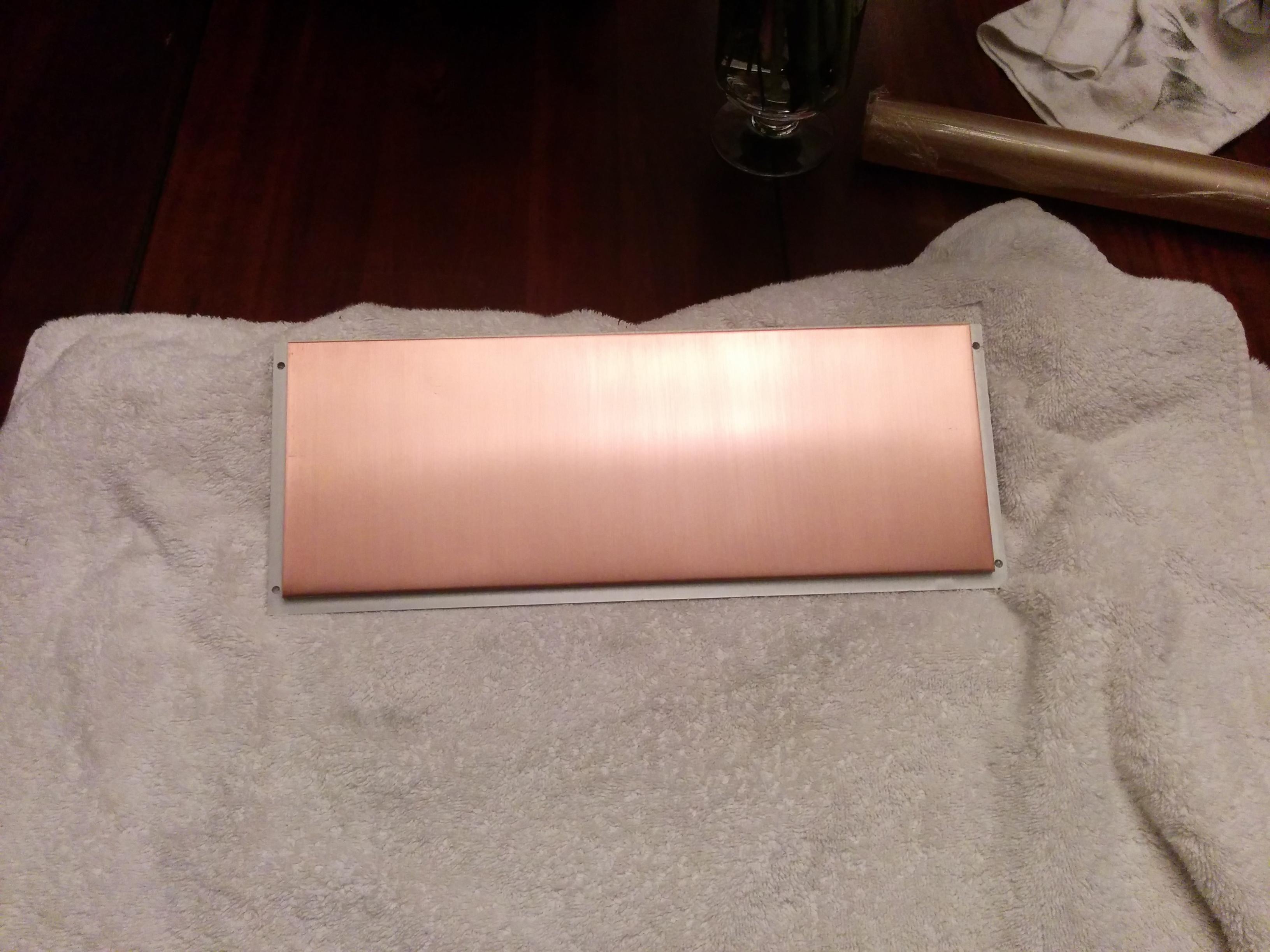

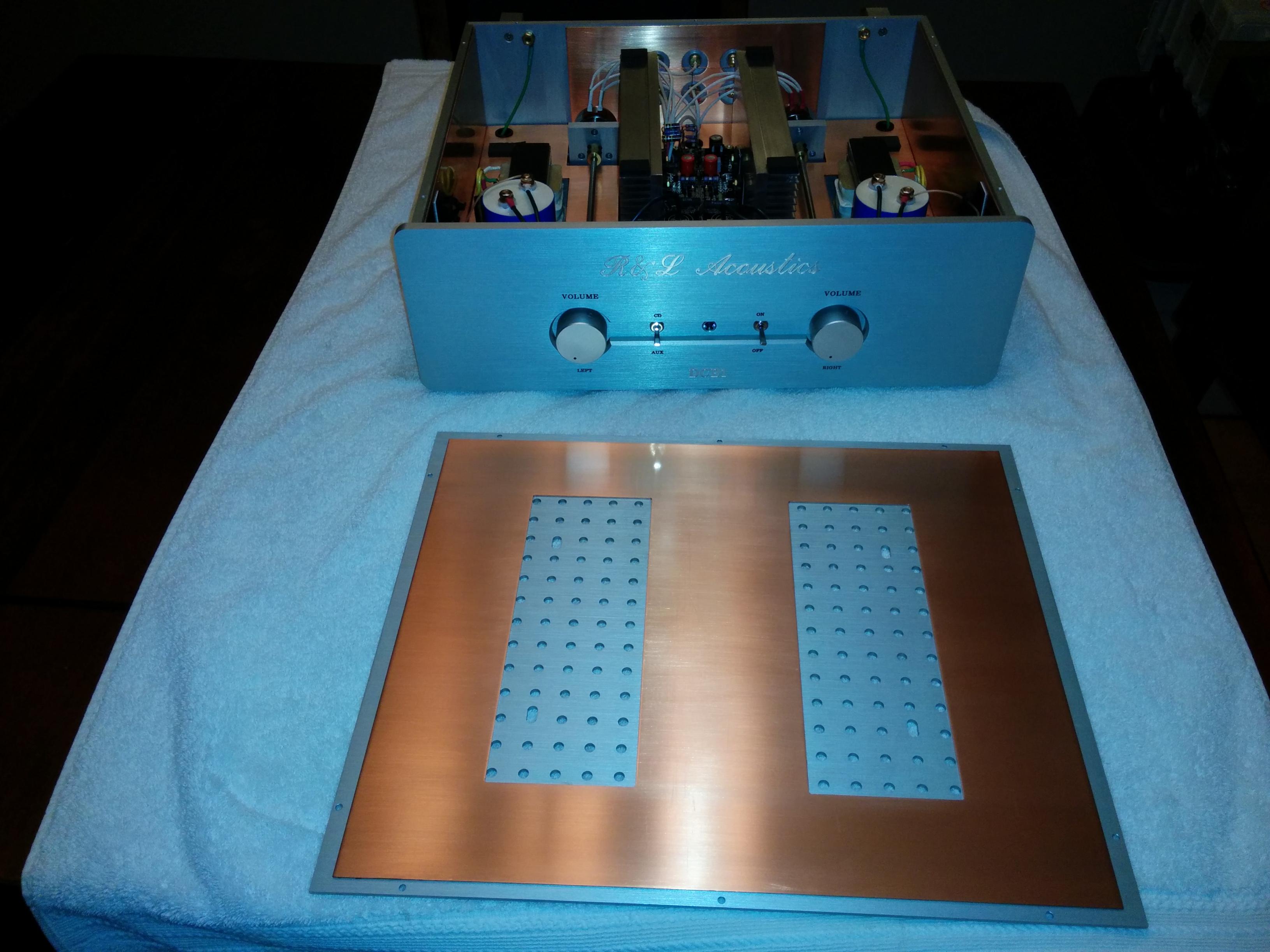

Scorpion Hotrodded DCB1

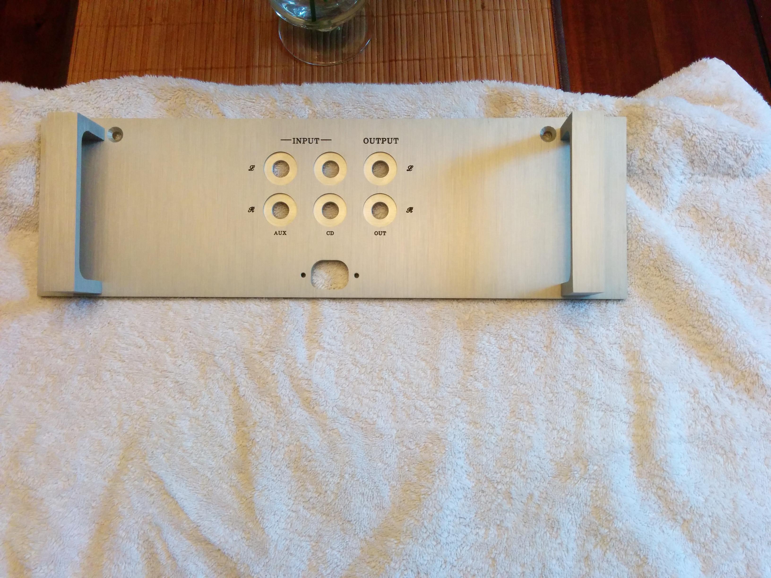

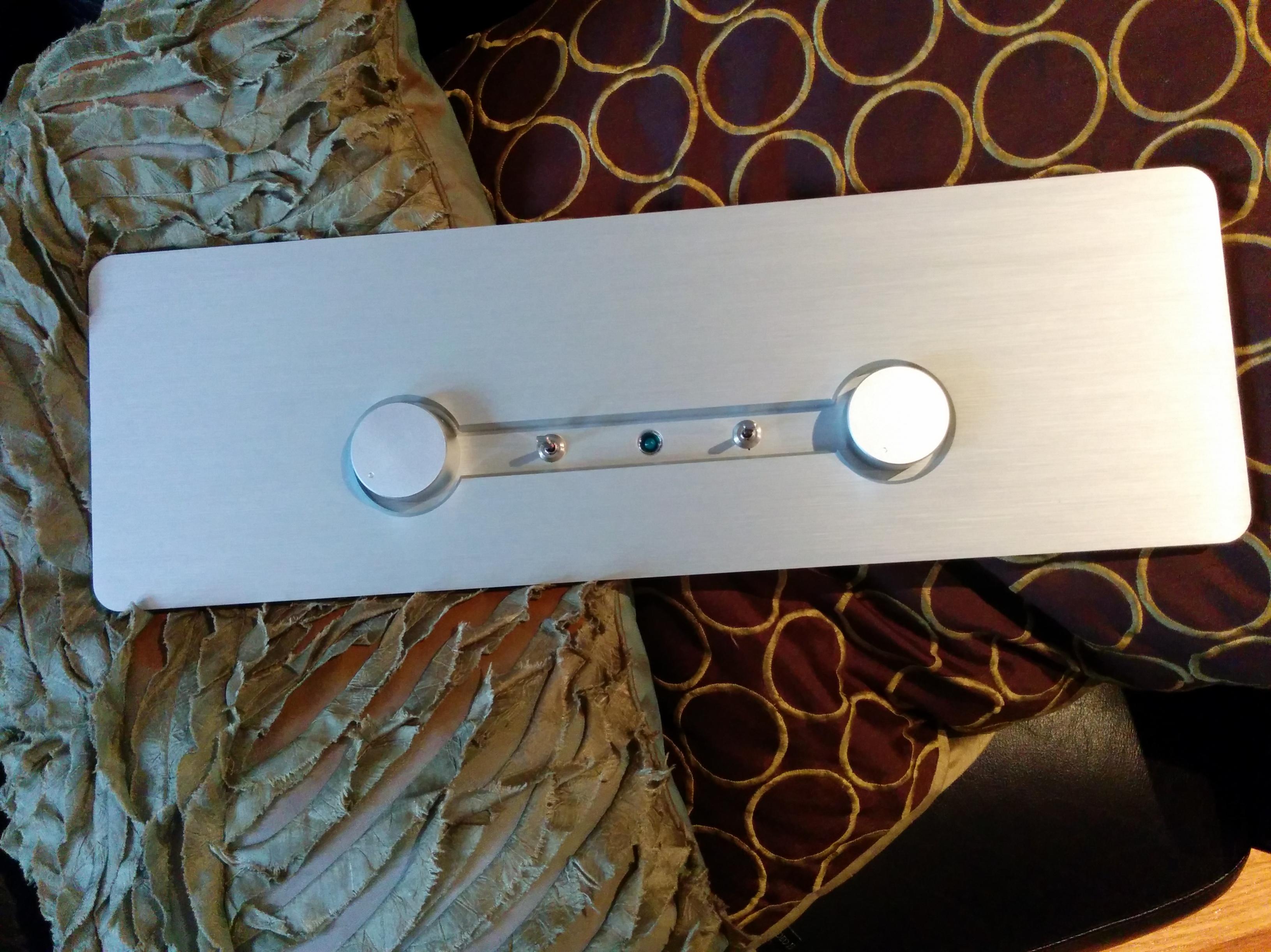

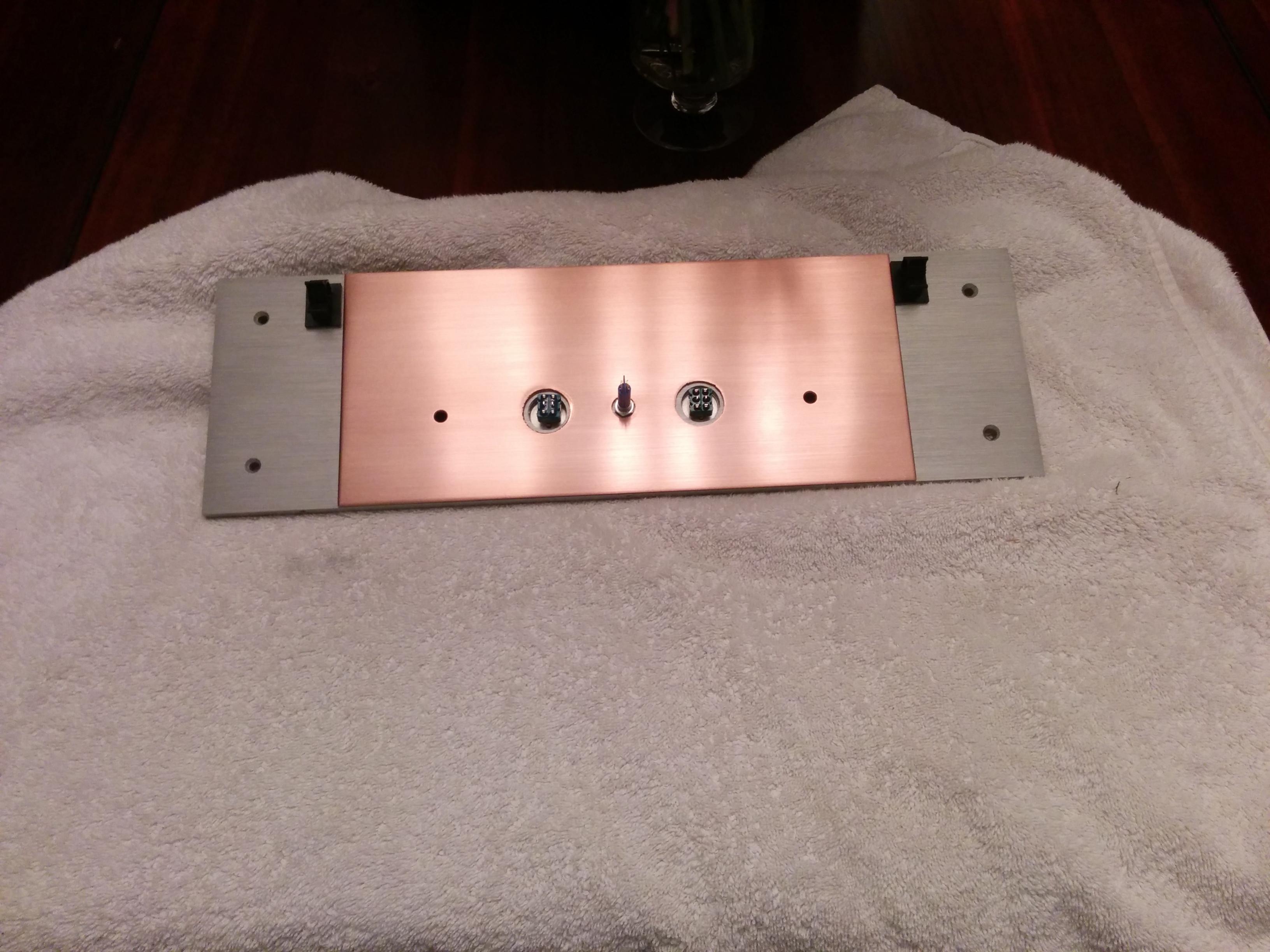

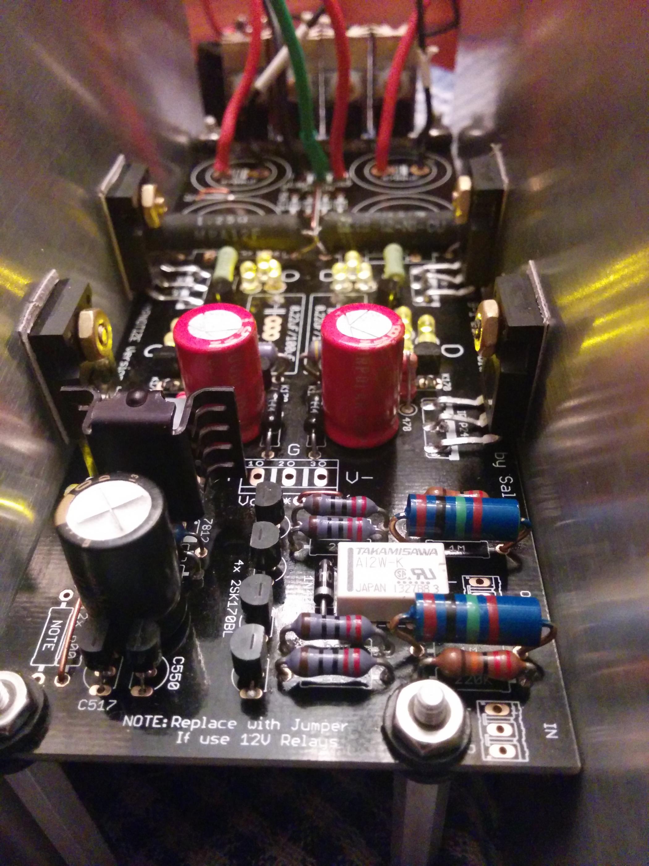

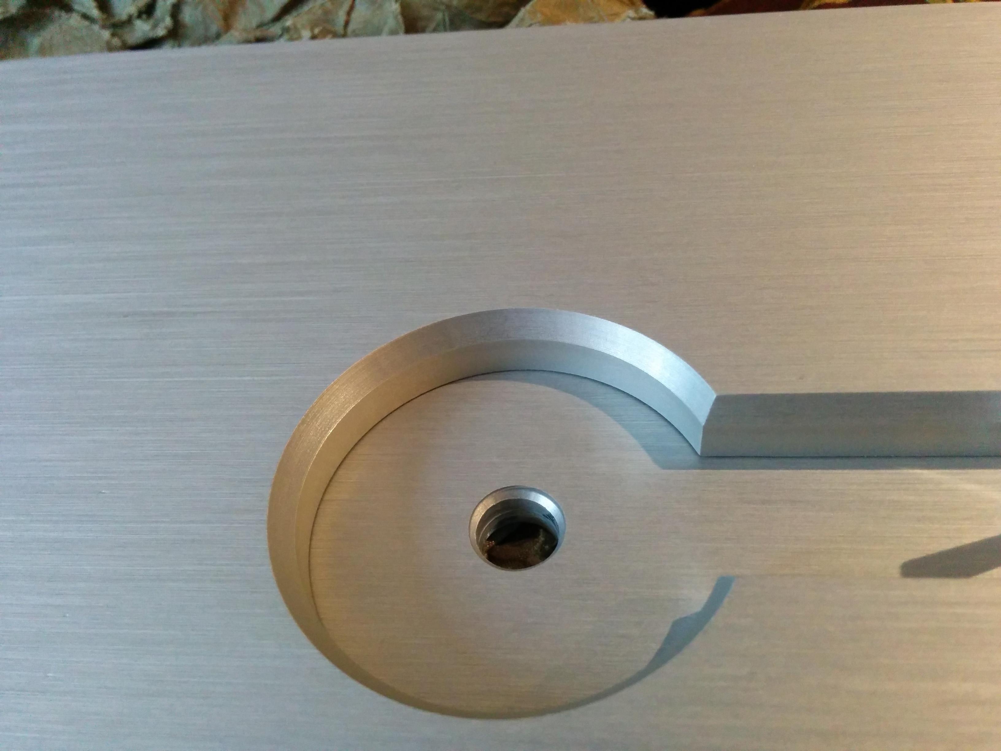

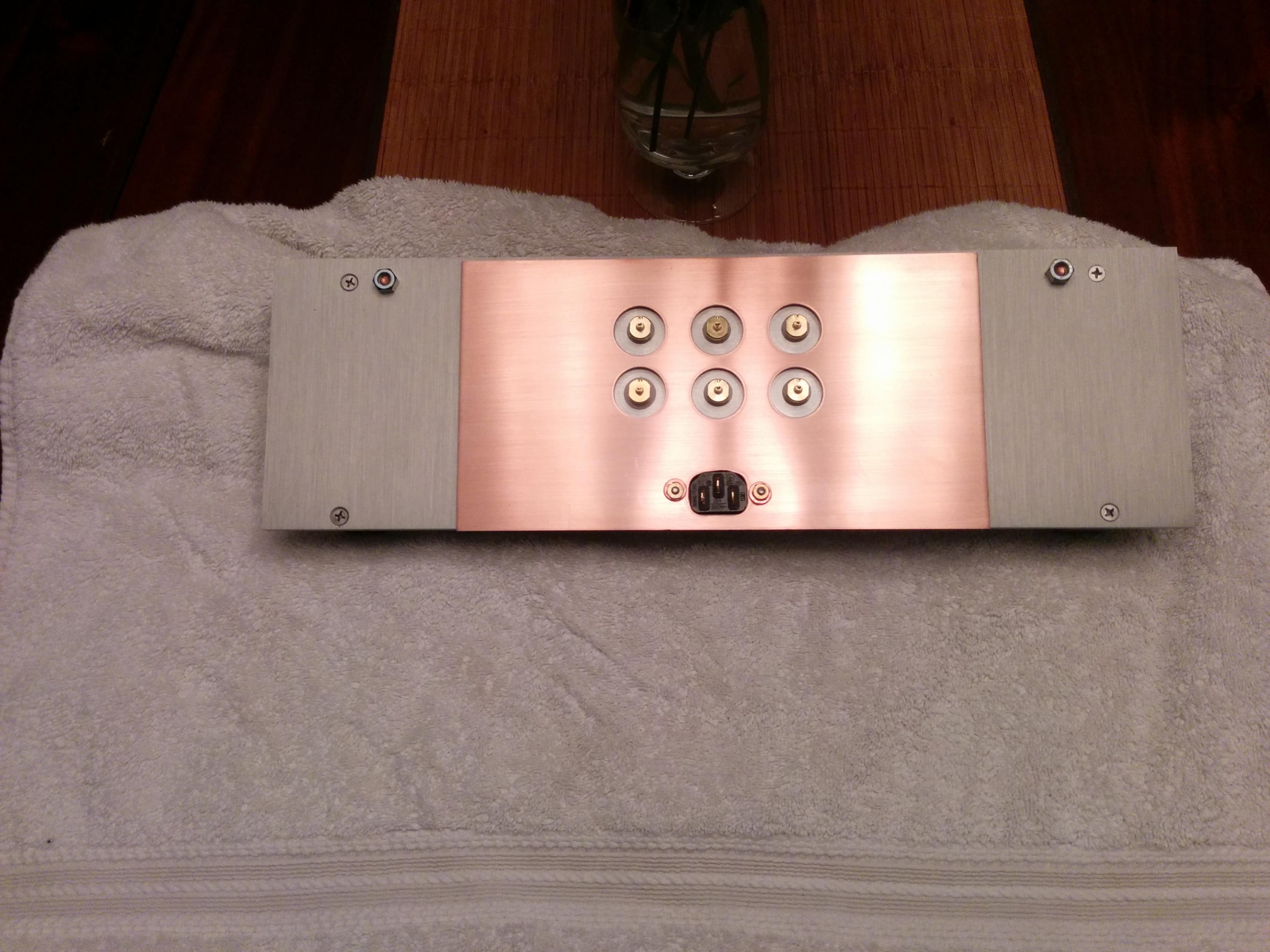

Hi guys,
Here are a few pics of my DCB1.
99% done. Just need to design an aluminum "ring" around the knobs in order to have volume gradation for my dual step attenuators.
Regards
Scorpion

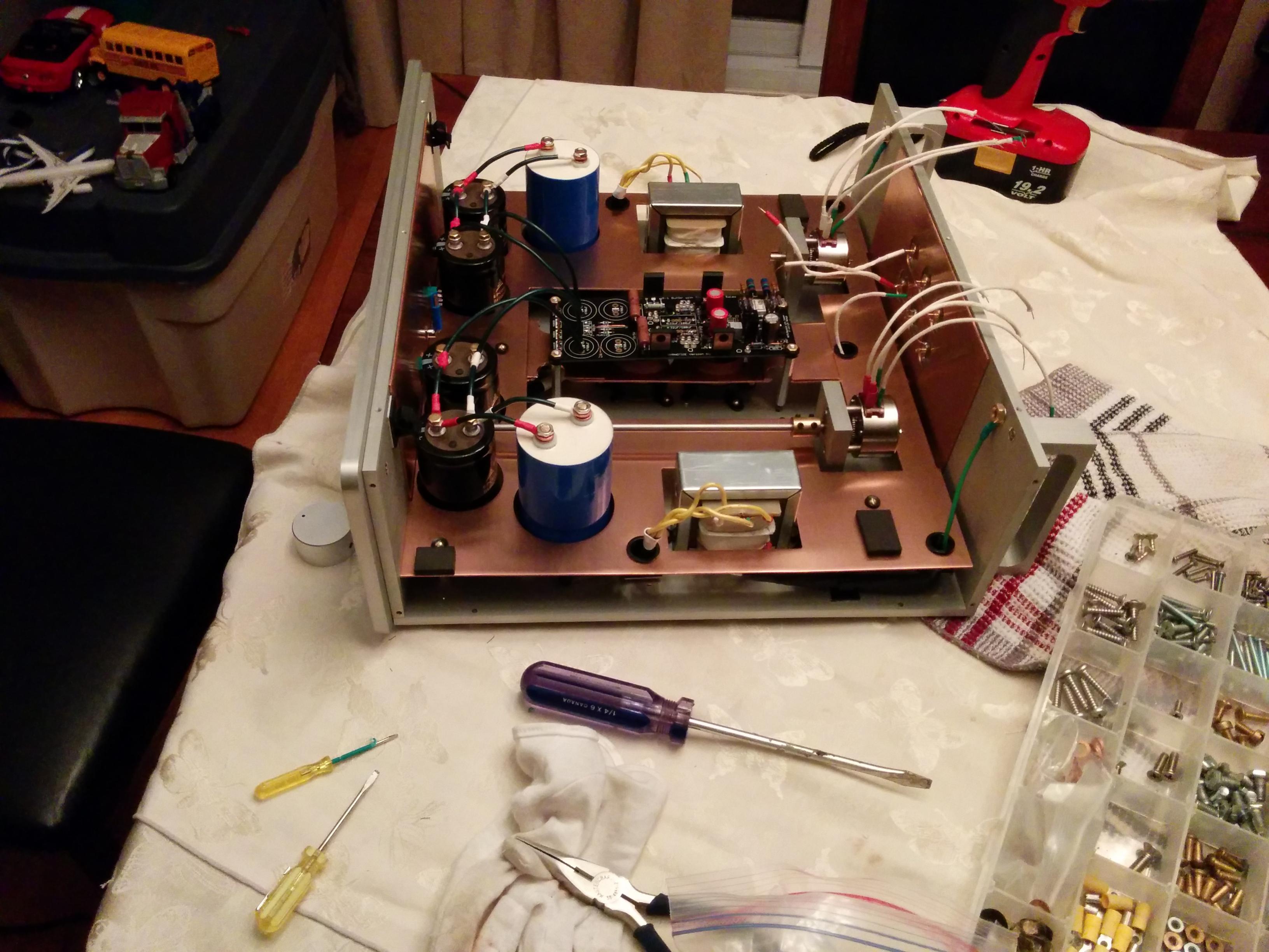

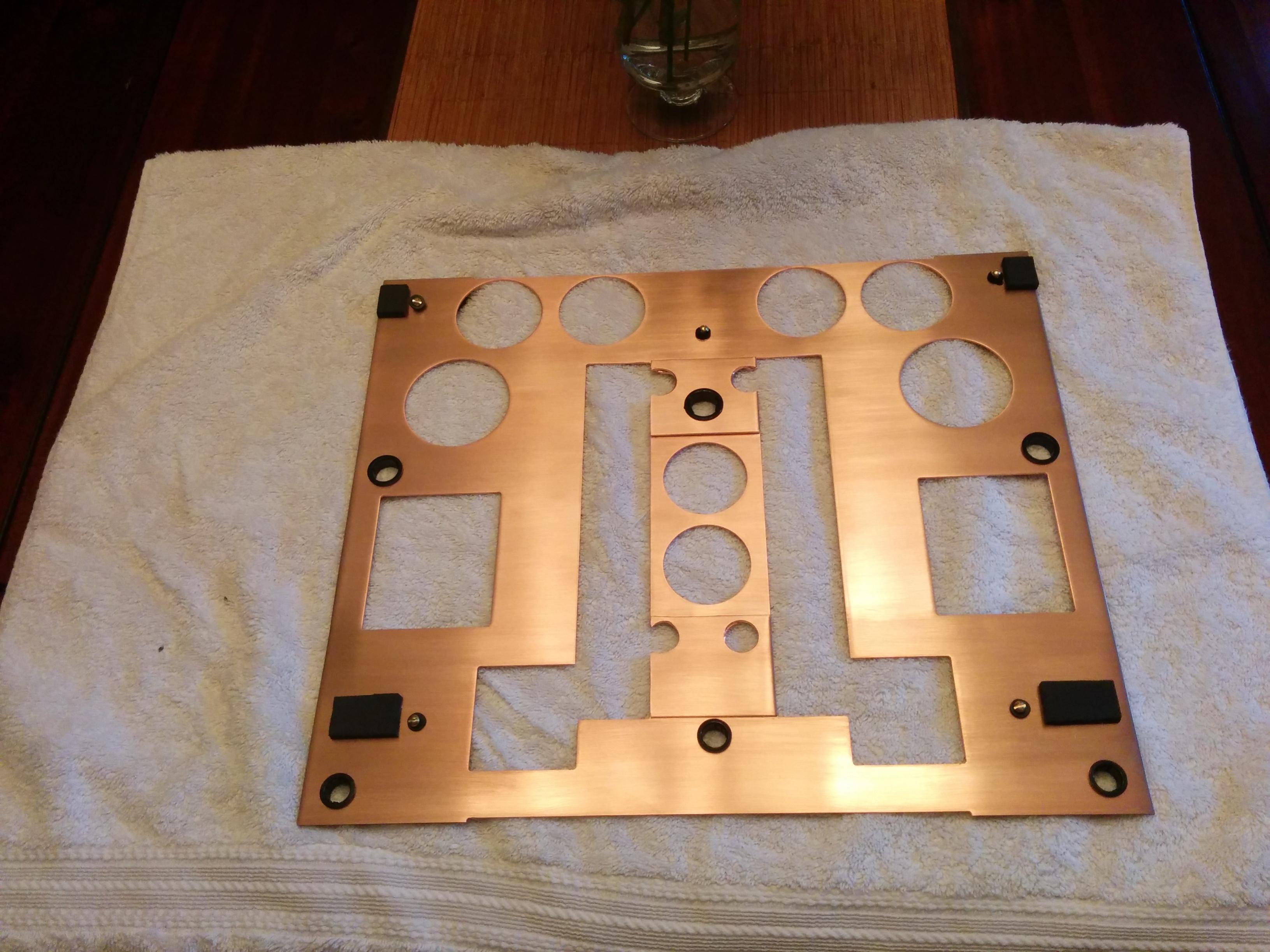

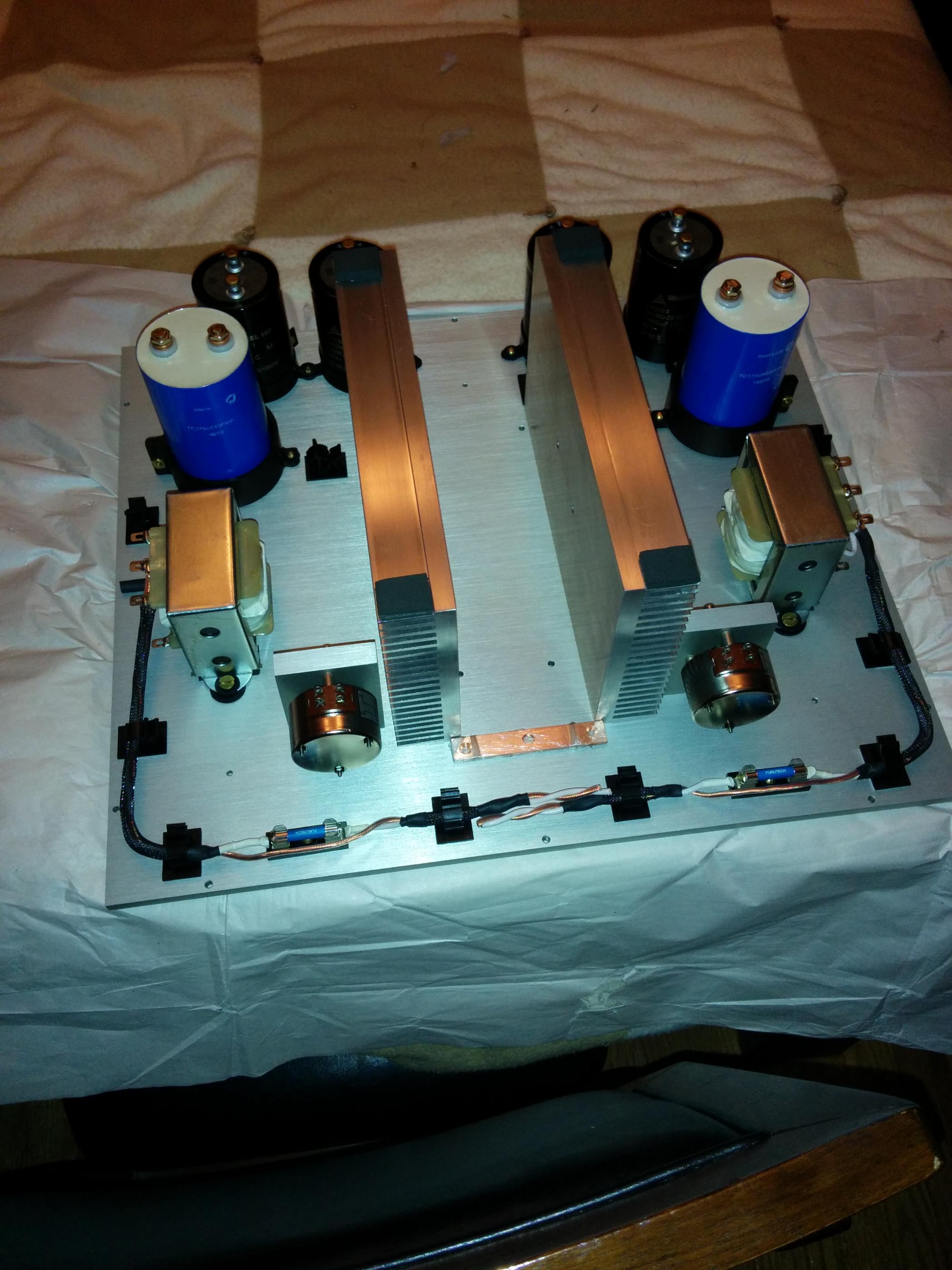

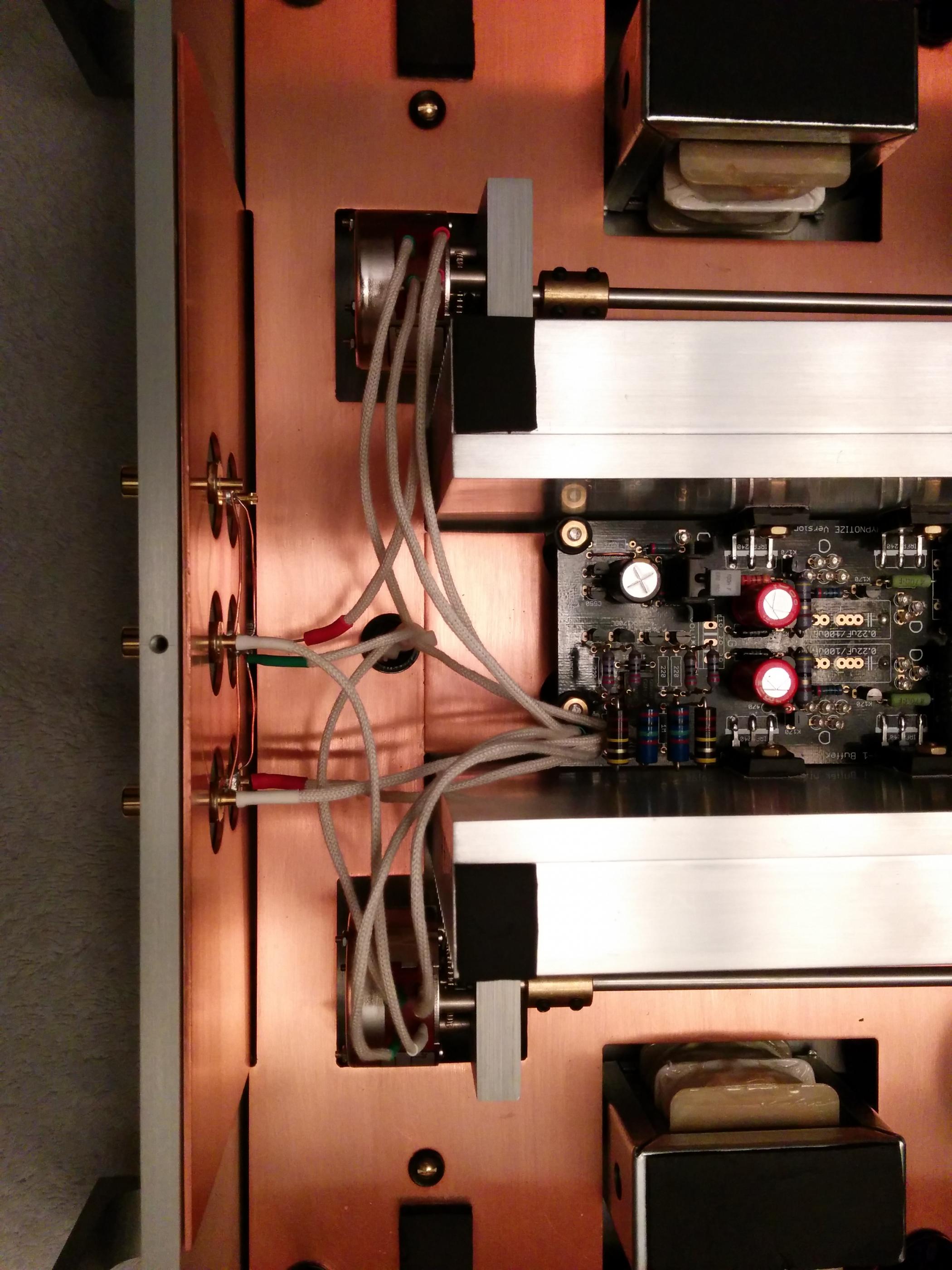

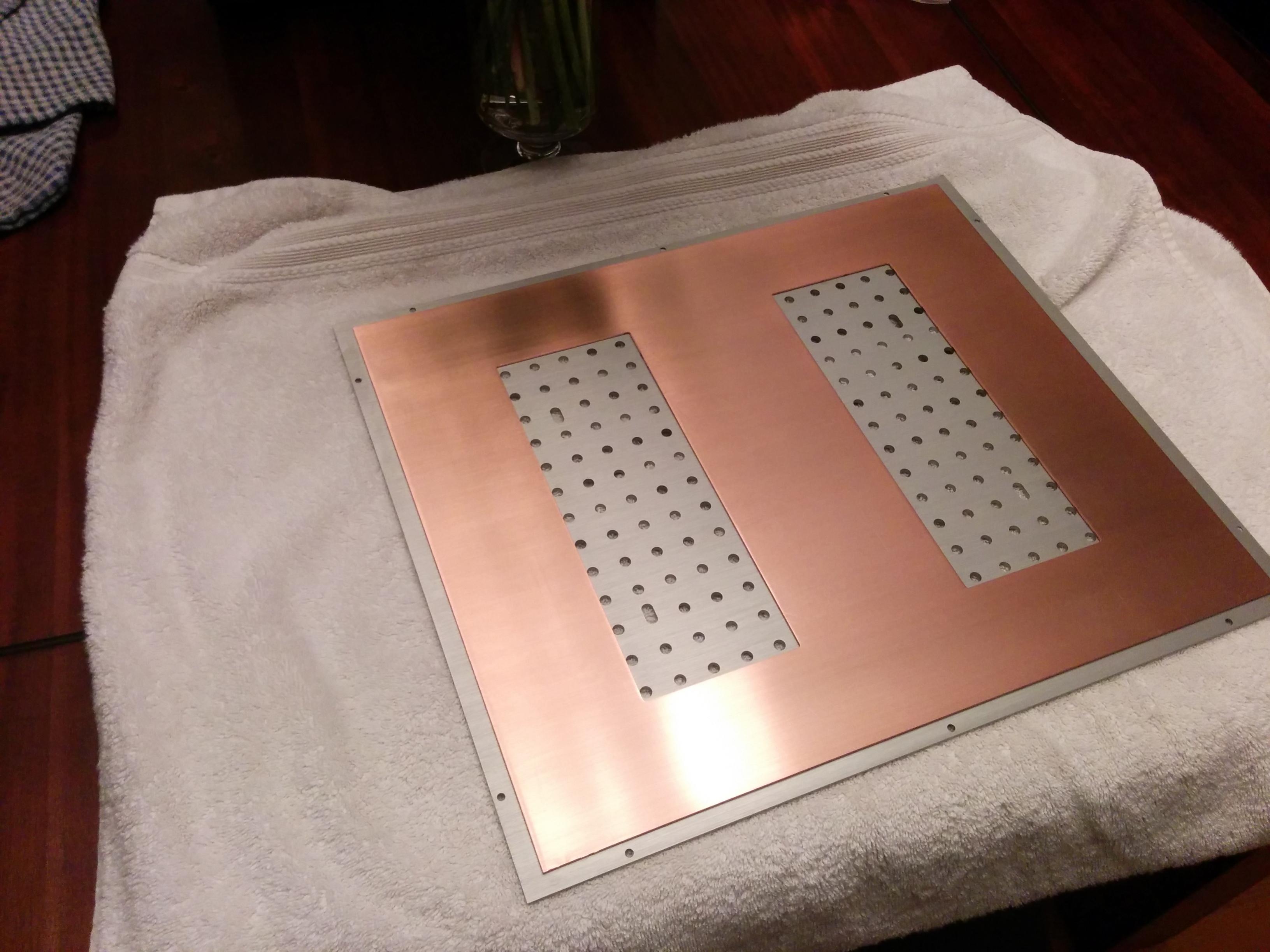

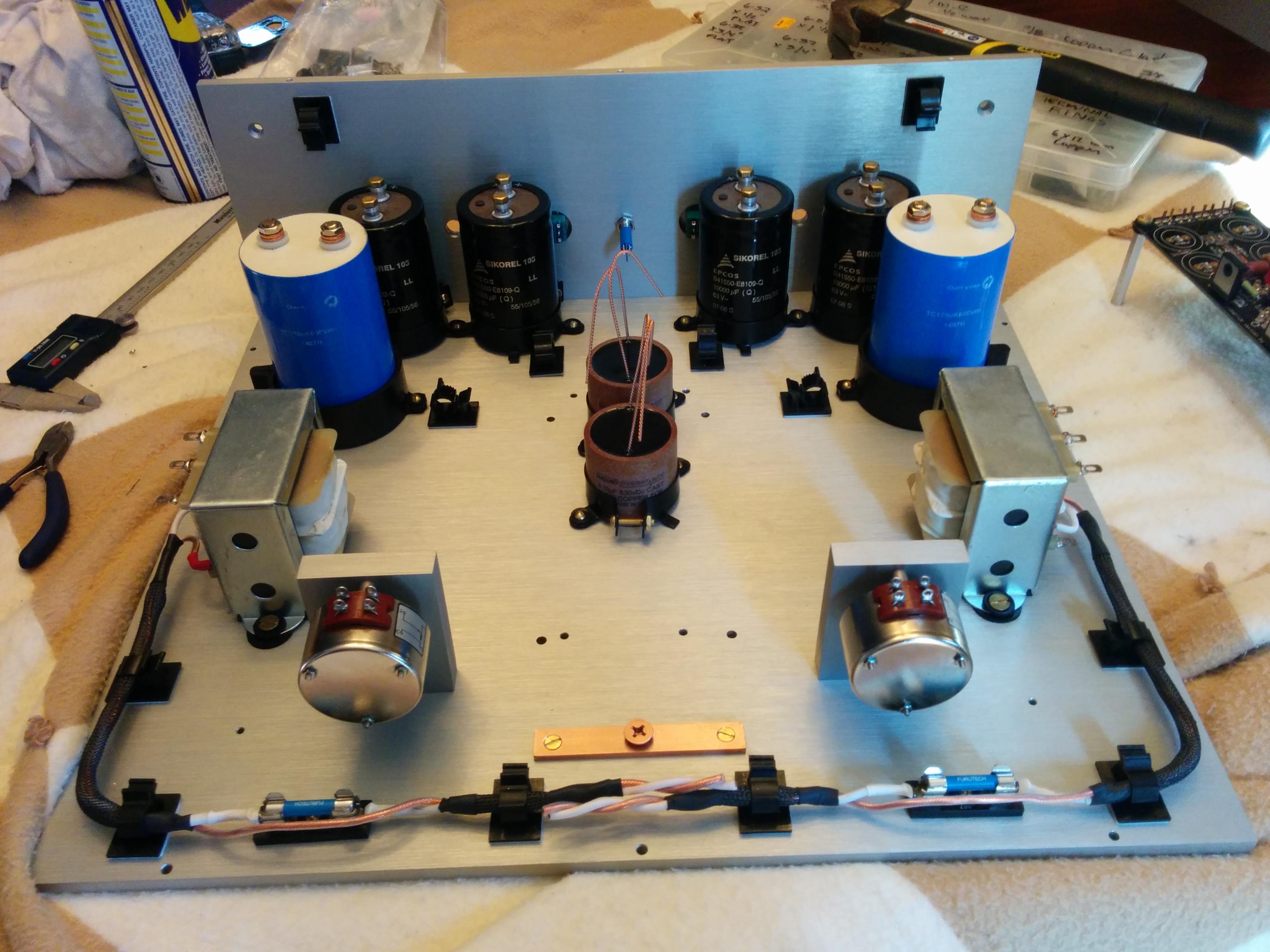

Hi guys,
Regards
Scorpion
