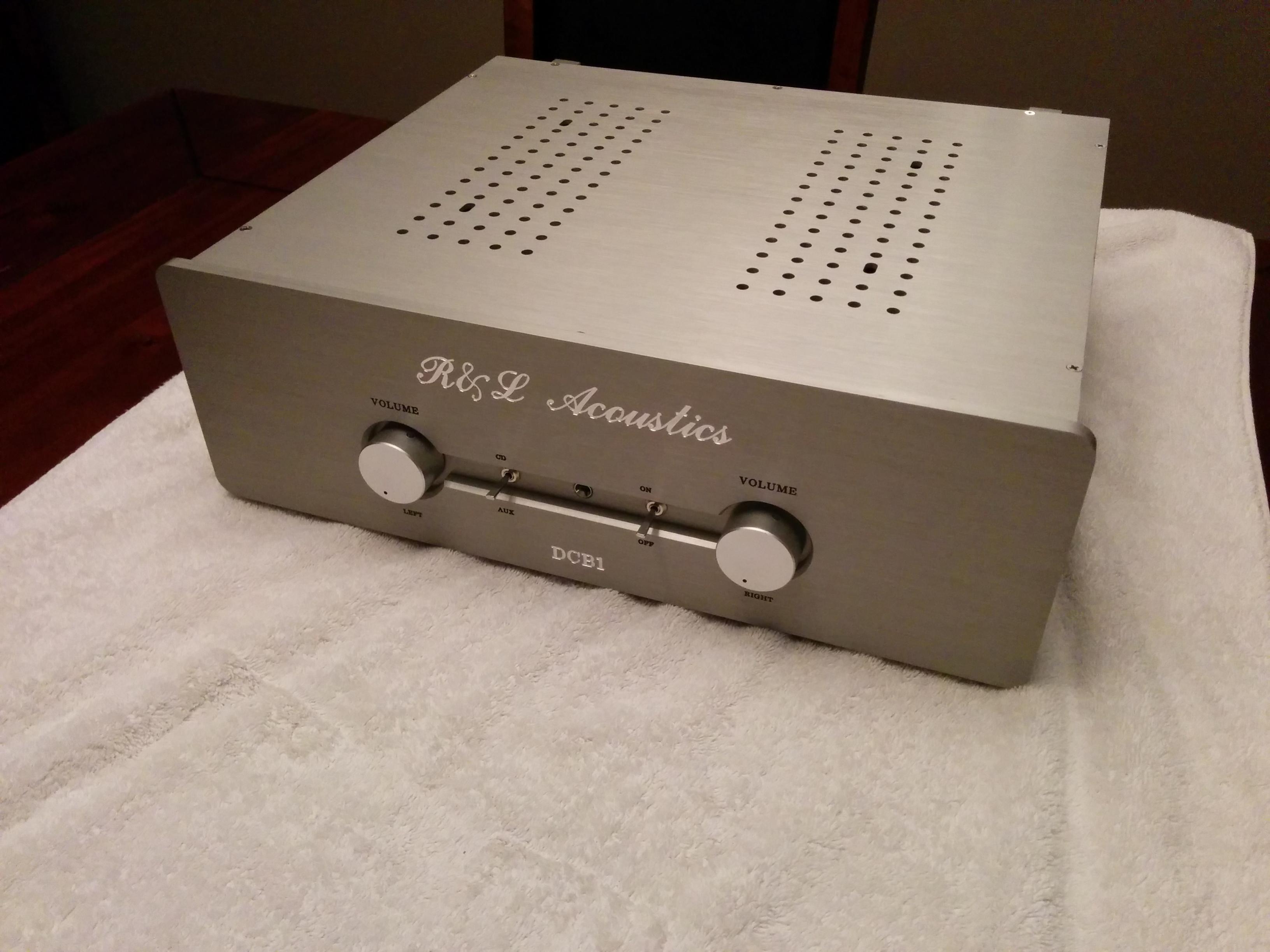

Congratulations Scorpion !
Excellent metal work and master class diy 😉

Those copper plates inside, are they for extra shielding or something else?
Yep, copper all around for EMI/RFI shielding. AC goes underneath main copper plate, PCB, signal wires and DC go above.

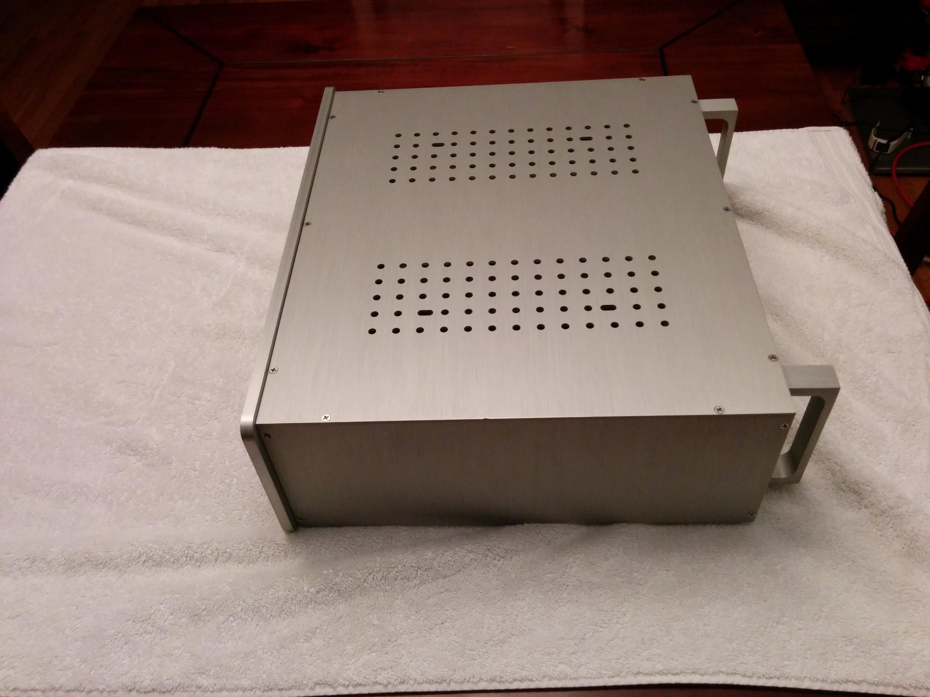

I will have to presume either the diyer has good access to CNC or good budget to a CNC😀😀
I do have a background in aerospace ...and an interest in machining. I made all the drawings and built almost everything myself. Bought the raw aluminum and copper at a metal supplier. But I had to have the faceplate and all the numerous holes on the top plate done at a machine shop (could have done the holes myself but it would have taken forever...wouldn't cut it with WAF factor !!!).
Of course had the engraving done also. About 300$ for both machining and engraving. Not cheap but still accessible.

Beautiful workmanship!
Where did you get the machining done? I'm looking for CNC shop

Pinocchio,
Machining of faceplate and the holes on the top plate was done at Lindax Inc in Montreal. Wheter there is a CNC or not, I don't know.
Engraving was done at AZ Pentograv in Terrebonne's industrial park.
Hope this helps.

Wow !!! Absolutely superb work Teti. Truly outstanding. Most "official manufacturers" don't have products half as well crafted !!
Congrats to you.
Can we see the inside please?
