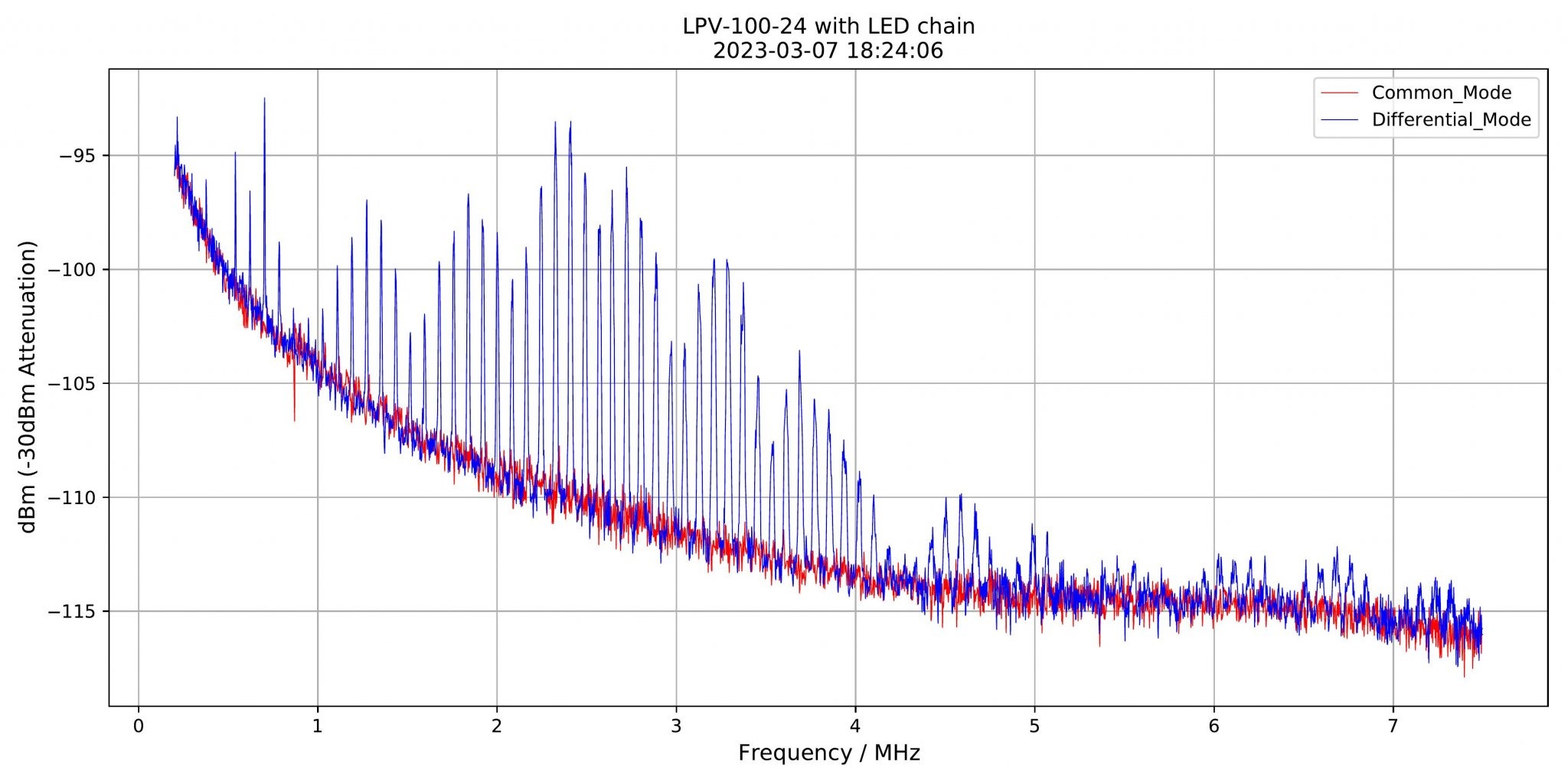

I have measured a Meanwell LPV-100-24 with a spectrum analyzer (SA) by using the DC LISN from Elektor, which provides 50 Ohm outputs on plus and minus. These outputs go into either a 0° combiner (ZFSC-2-4) or a 180° combiner (ZFSCJ-2-1, minicircuits) for measuring either the differential or the common mode noise. The input of the SA is attenuated by 30dBm in total, band width was 300Hz, the LISN goes from 150kHz to 200MHz. The load of the SMPS is 1.84A (24V DC).
=> All the noise is differential noise, apparently no contribution from common mode noise.
The switching frequency is around 70kHz (distance between spikes), from the noise pattern (distance of minima) the degree of PWM modulation could be calculated.
The apparently decreasing noise floor below 500kHz is due to the filters of the LISN and the transient limiter in front of the SA. A measurement of the DC voltage at the output of the SMPS with a 16-bit scope (AC coupling, +/-20mV resolution, bandwidth limited to 200kHz, Gaussian filter,) shows ample noise below 1MHz.

Thanks for posting. I'm not sure one can deduce from the 1st measurement that there is no common mode noise. WIth 50 Ohms in series with each leg into the combiner, you've effectively balanced the output first, a condition which doesn't exist in use. The 2nd graph makes more sense. If plotted on a log freq scale, it is very much consistent with others posted here.
? The 180° splitter inverts the phase of one leg relative to the other leg. If a common mode signal is present in both lines, the signal shows up, whereas with the 0° combiner the CM signal is fully cancelled (and the differential signals show). Correct?
@jean-paul: Regarding the use of this SMPS for audio: Never, ever... Even after filtering it wont be silent enough. I just wanted to know about the amounts and kinds of noise.
Not "signal", voltage. With the 50 Ohms in the ground leg, what were ground-contaminating currents (low-impedance) are now voltages which apparently cancel in your 50Ω splitter transformer (although the switching freq fundamental and 2nd harmonic are below the sweep start freq). A 50Ω system wouldn't be my choice to evaluate this sort of thing. Short out the 50Ω in the LISN (-) leg and try it.
Another POV: Your "common mode" noise curve shows about -95dB (is it dBV? dBm 50Ω?) at sweep start (150kHz). Assuming it's dBV, if we add 6db for the 50Ω division, and 30dB for the attenuator, -95 + 6 + 30 = -59dB, which is certainly not "no common-mode noise"... it's in the same ballpark, maybe even worse, than the filtered outputs that I was measuring.

"ground-contaminating currents": No, these measurements are done following the CISPR 25 standard. The LISN I use is described here:
https://www.elektor.com/elektor-dual-dc-lisn-150-khz-200-mhz
TekBox offers a CISPR 25 single line LISN, therefore you would need two of them. Connecting the outputs of both LISNs to the TBLM1 LISN-mate (done in my measurements with the 0° and 180° combiners) distinguishes then between DM and CM noise.
"Ground" has in these measurements little to no meaning, as we measure fully differential voltages (going into 50 Ohm).
A nice application note from Analog Devices shows on how both emissions are measured with the splitters I also used:
https://www.analog.com/en/analog-di...emissions-in-conducted-emissions-testing.html
This note shows also that the LISNs are the same for DM and CM measurements, but the combiners differ (see figure 3 in this note).

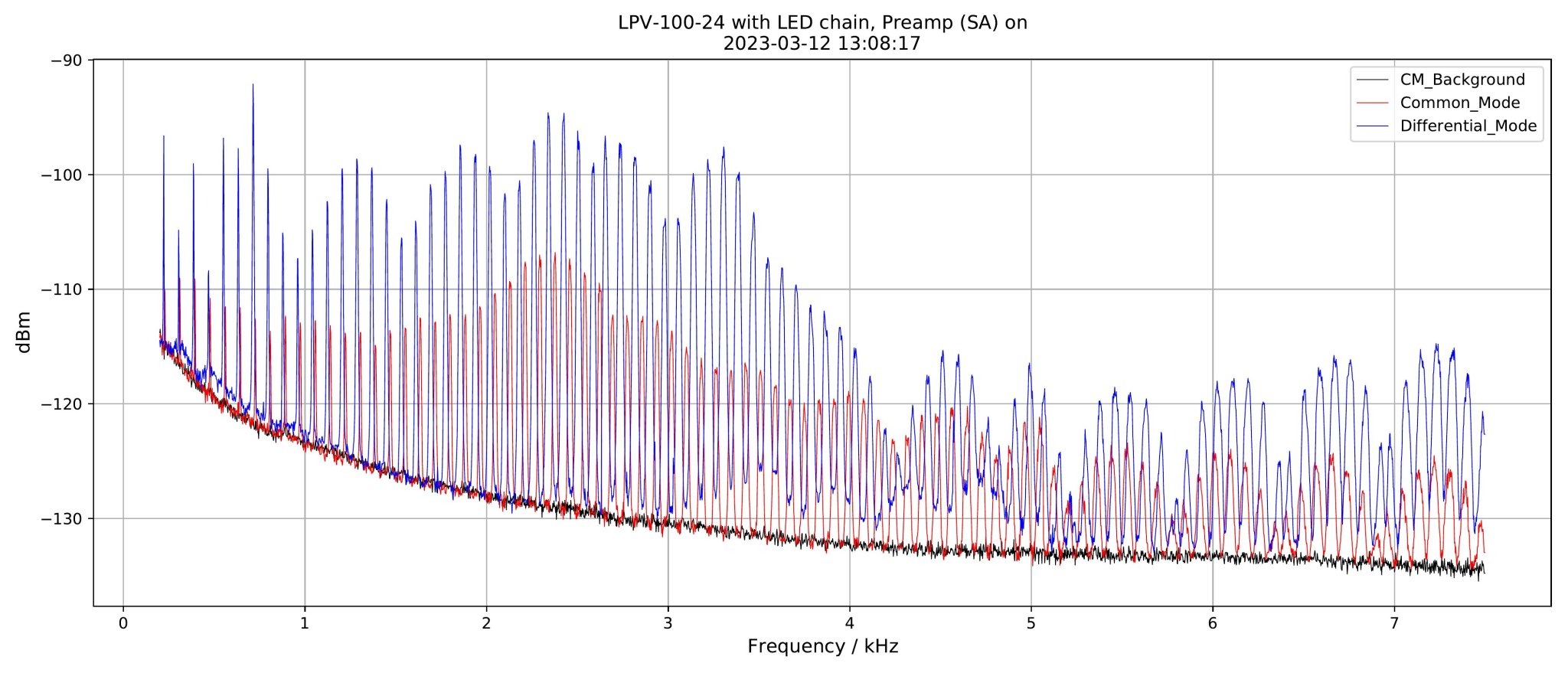

Meanwhile I got my internal preamp for the SA, which lowers the noise floor of the SA by about 20 dBm (@jbau: the noise floor shown in my first figure above stems essentially from the SA).
I remeasured the SMPS with exactly the same conditions (the 10dB attenuation of the LISN is included in the 30dBm total attenuation), and now my statement above (CM does apparently not contribute) is changed to: It does, but on a very low level relative to DM noise.
Please note the Y-scale, which differs from the figure above, it goes 20dBm lower.
The bottom trace is the noise of the SA attached to the setup, but the SMPS is off.
So the next step should be designing a filter to get rid of this noise.
Thanks, your new measurement is making more sense.
And note that the freq scale is MHz, not kHz as shown.

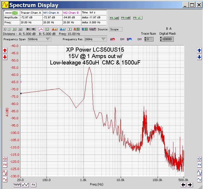

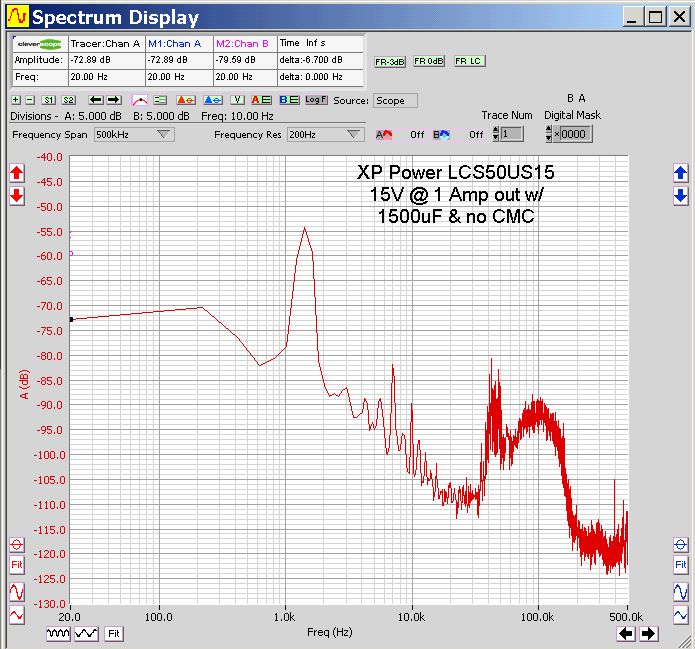

I did some experiments today using the XP Power smps tested first in this thread, chosen because it is easily the noisiest smps I've measured. I wanted to see what difference, if any, a CM choke with low leakage inductance makes. And compare them both to no CM choke. And I expanded the measurement bandwidth to 500kHz to see noise beyond the first two harmonics.
The first plot is with the same PE-62912 CMC I've been using, with a 1500uF 20mΩ ESR cap on the load side. The PE is rated 3mH but measures closer to 4. It has nearly 60uH of leakage.
The second plot is a bifilar-wound 450uH CMC which only has 400nH of leakage, followed by the same 1500uF cap.
The third plot is with no CMC, just the 1500uF cap.
Besides still concluding that this power supply really sux for audio, it is clear that the differences between these three configurations is not dramatic. The CM chokes are not delivering a significant amount of common-mode attenuation. The 3mH CMC has the lowest overall noise, but the 2nd harmonic at 100kHz is actually no different than with just the cap on the output. The low-leakage CMC is a little better above 100kHz but not hugely so.
The other point is that, like other smps I have measured, the switching freq and its 2nd harmonic are by far the worst offendors, by 20dB or more. Except this model also has that unusual 1.5kHz noise spike.

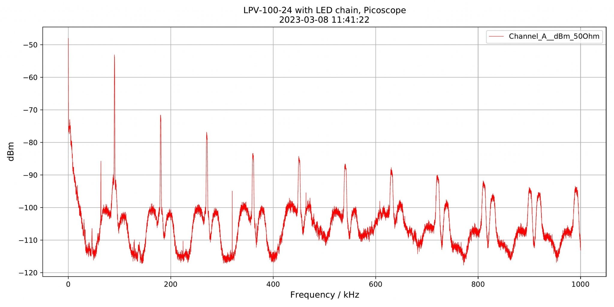

For me, the spectrum does not look like a pulse-width modulated square wave (cf. my picoscope measurement above). Do you have an oscilloscope to have a look on the actual waveform? Maybe this would give a hint about the origin of this strange 1.5kHz peak?
