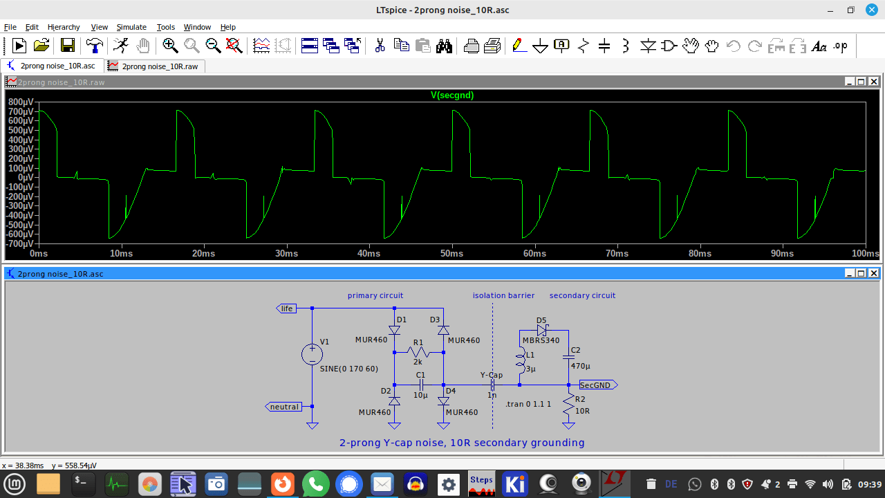

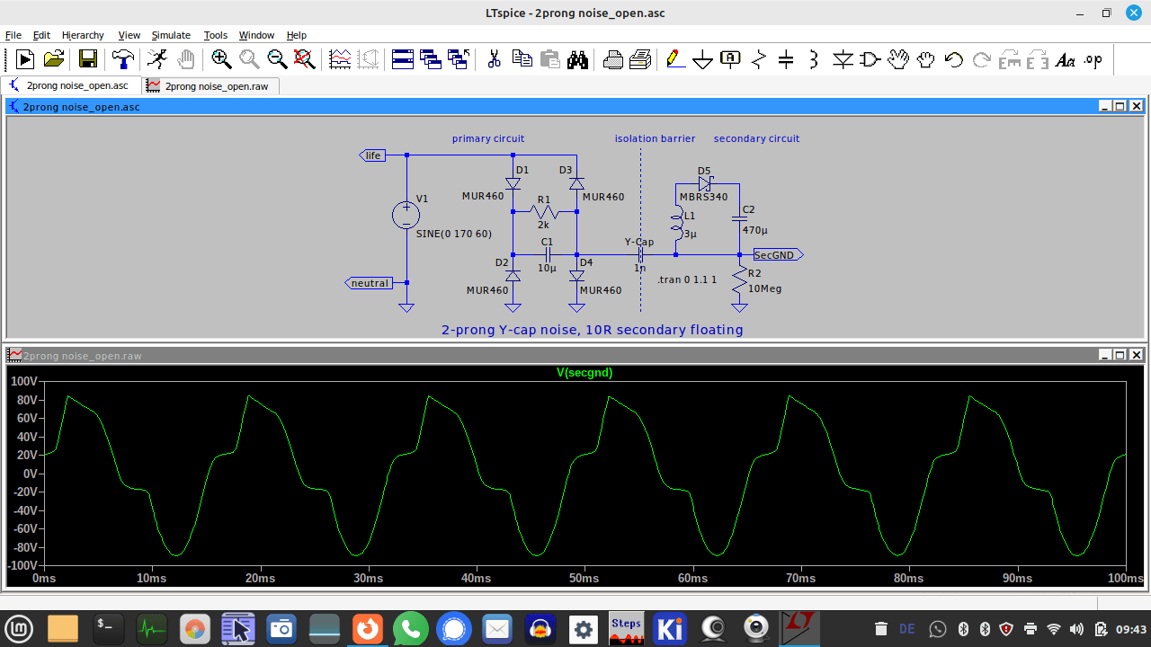

Good to know you are a pro in this field. I do mean to test. I am thinking of a case (anecdotal) is a power outlet strip (unfiltered) that I have a linear headphone amp plugged into. The moment I connect a cheap SMPS (one of those LED drivers into it, or a small 5V USB charger) I hear noise in the previously quiet headphone amp. What is that coupling mechanism ? I think the SMPS is probably lacking a blocking cmc filter on its power inlet. The noise it makes bleeds back on the power strip and maybe into the rest of the house. How does one simulate this on LTspice?
This is a typical case. Specially for audio it makes a big difference between a 2-prong wall wart and a 3-prong labtop brick or similar 3-prong SMPS. The 2-prong SMPS has y-caps between primary DC-circuitry and secondary dc-circuit to tame rf noise sent to ac-line. These caps with typical 1~5nF conduct some 100uA ac current. This is not pure 60Hz current - but full wave rectified 60Hz, that is 120Hz full distorted. Which makes this much more annoying noise than 60Hz sine wave. By nature this is a common mode noise, any secondy LC-filter will help - nothing at all! There is a common mode noise current coming from the wall, with a well noticable spectrum in the audio, that will seek its way to ground earth, via capacitive coupling. Long, unscreened wiring of sensible audio are affected by such leakage currents.
Bottomline is - you cannot filter the common mode noise emanating from 2-prong SMPS, because this would require common-mode chokes of very high impedance - measured at 120Hz. Connecting secondary circuit to PE solves this problem.

@bucks bunny - are you saying all one needs to do is connect the secondary (2 prong) circuit low side to a PE ground and that will solve the noise from the Y2 cap filter induced ground loop? Wouldn’t a GLB be good to use here? 10ohm or NTC with a 22nF in parallle to ground.
You are right, exactly that is what I am saying. As the coupling mechanism is a common mode current source (1nF driven by several hundred volts of 120Hz sinoids) a small series resistor would do no harm at all and may prevent from 60Hz hum loops. What is GLB?

Staying in my 2-prong scenario as described above. The common mode noise is here a leakage current. High frequency leakage current is measured with a current clamp around the entire bundle of primary or secondary cables using a high sensitive broadband spectrum analyzer. For the audible leakage we are talking you can measure leakage current simply using any good AC-current measuring DVM inserted between floating secondary output and PE-GND. In the simulation this corresponds to an AC-current meter instead of 10R resistor (R2). You will read something in the ballpark of 50..100uA rms. With a direct PE-connection of the secondary circuitry this current is diverted from the meter and its readings drops to zereo. It is really simple like that.
