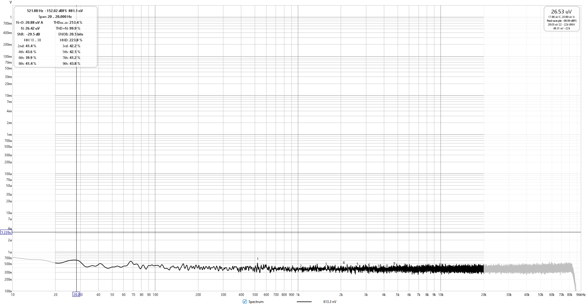

Yes I know its not a value SMPS but FWIW some measurements I grabbed last year playing around with SMPS - Hypex PS500DIY +70V/-70V SMPS in a stereo class AB wolverine chassis. Not at all representative of wolverine distortion profile due to distortion in topping DAC as sine generator. Wolverine distortion way, way lower.
RCA input shorted -> speaker output to 8R non inductive 200W resistor -> E1DA ADC 35Vrms input-> laptop on battery.

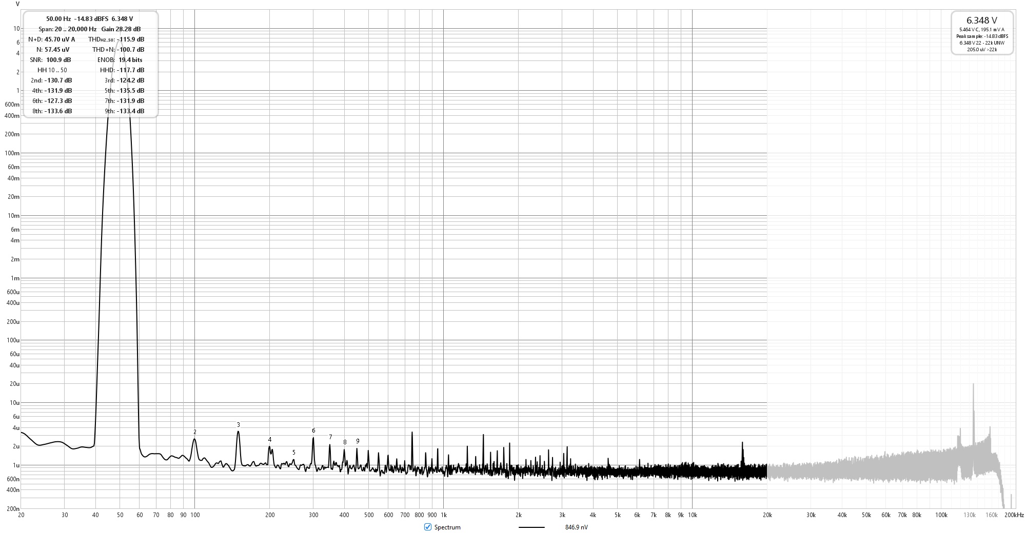

50hz ~5W; REW on laptop on battery -> topping e30II powered from laptop -> rca to amplifier -> speaker output to 8R non inductive 200W resistor -> E1DA ADC -> laptop
You can see the 130-140khz switching noise. "see". Noise at 16khz is USB induced noise and varies depending on USB cable lengths and layout.

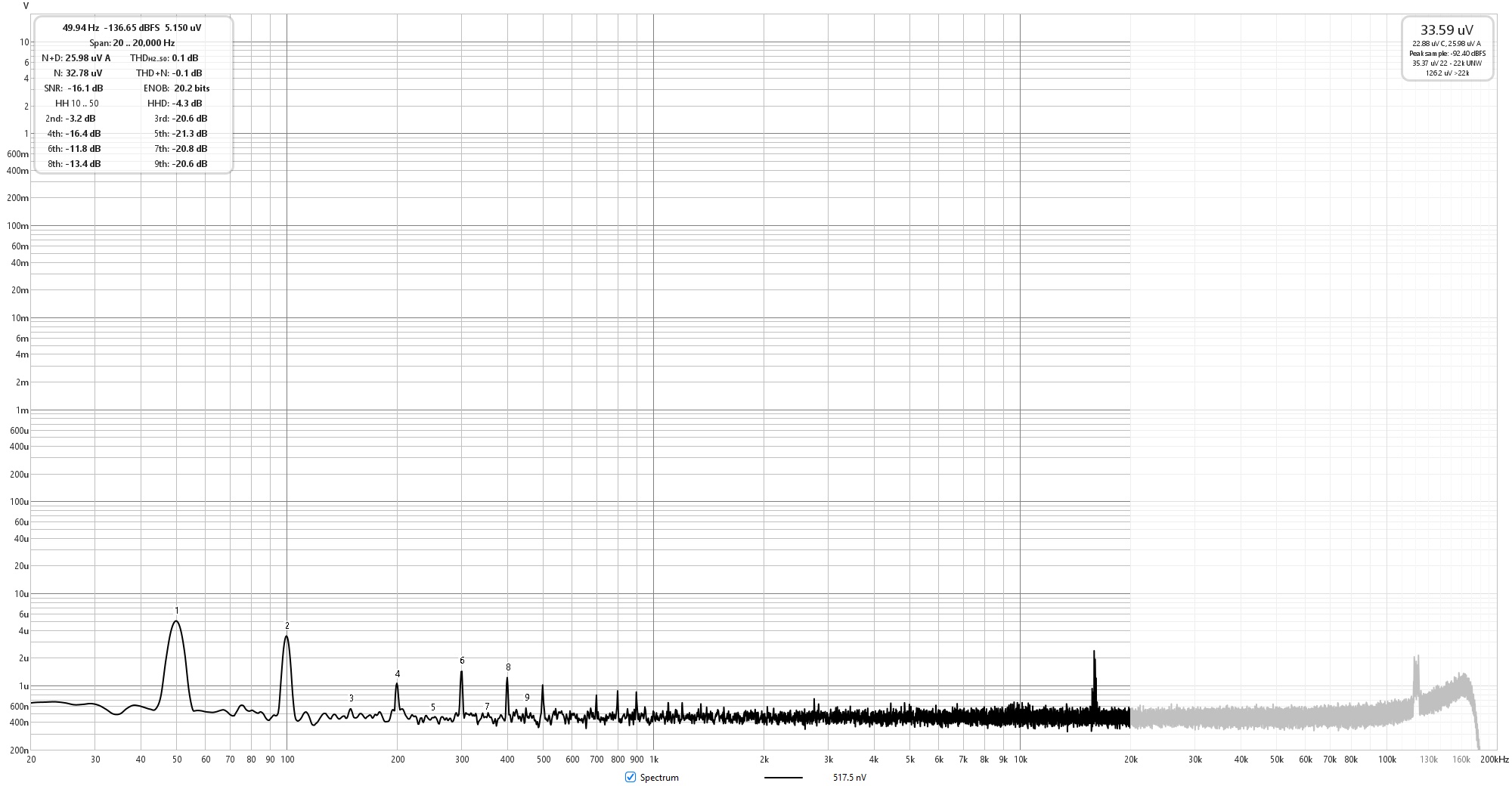

E1DA self noise / noise floor no input connected for reference.

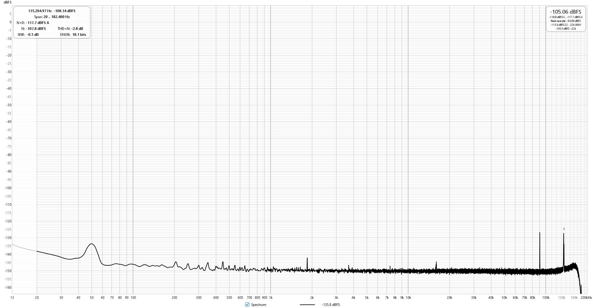

Oh and here's the SMPS1200A400 in the same chassis - a cheaper non-regulated (above ps500diy is regulated) 100khz switcher with no PFC.
Noise floor (input not shorted, E30II connected and idle). For some reason I didn't grab this in V scale, but I assure you the input voltage was calibrated correctly, so 0dbFS is 35VRMS as the E1DA ADC in its aux 1.7/35VRMS jumper config.

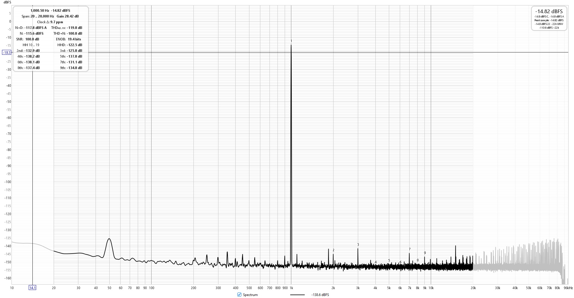

1khz 5w/8r 0dbFS 35VRMS - showing vanishingly low switching noise buried in the DAC noise shaping. As above, ignore harmonic distortion, not representative of the amplifier but instead inherent to the E30II DAC being used as the signal generator.
