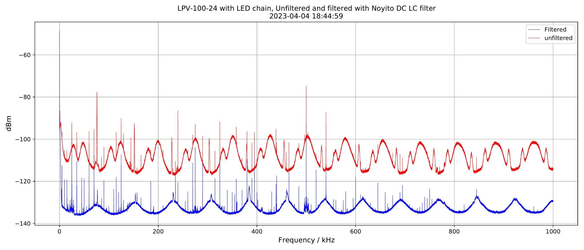

I got a Noyito LC EMI filter for DC (<20A) and placed it between the SMPS and the LISN (measurement conditions equal to those used in the previous measurements):
Compared to the unfiltered spectrum, two aspects show up:
a) Common-mode noise is completely below the noise level of the spectrum analyser.
b) The DM noise is substantially lowered with a minimum around 4 MHz, but at higher frequencies attenuation gets smaller almost up to the unfiltered levels. This might be due to the electrolytics in the filter path, which probably become inductive at these high frequencies.
Interpretation: This filter works and noise is reduced to really low levels. Would it be audible? I dont know.
Next step: Measurement with the osci in the frequency range between 0 and 1MHz.

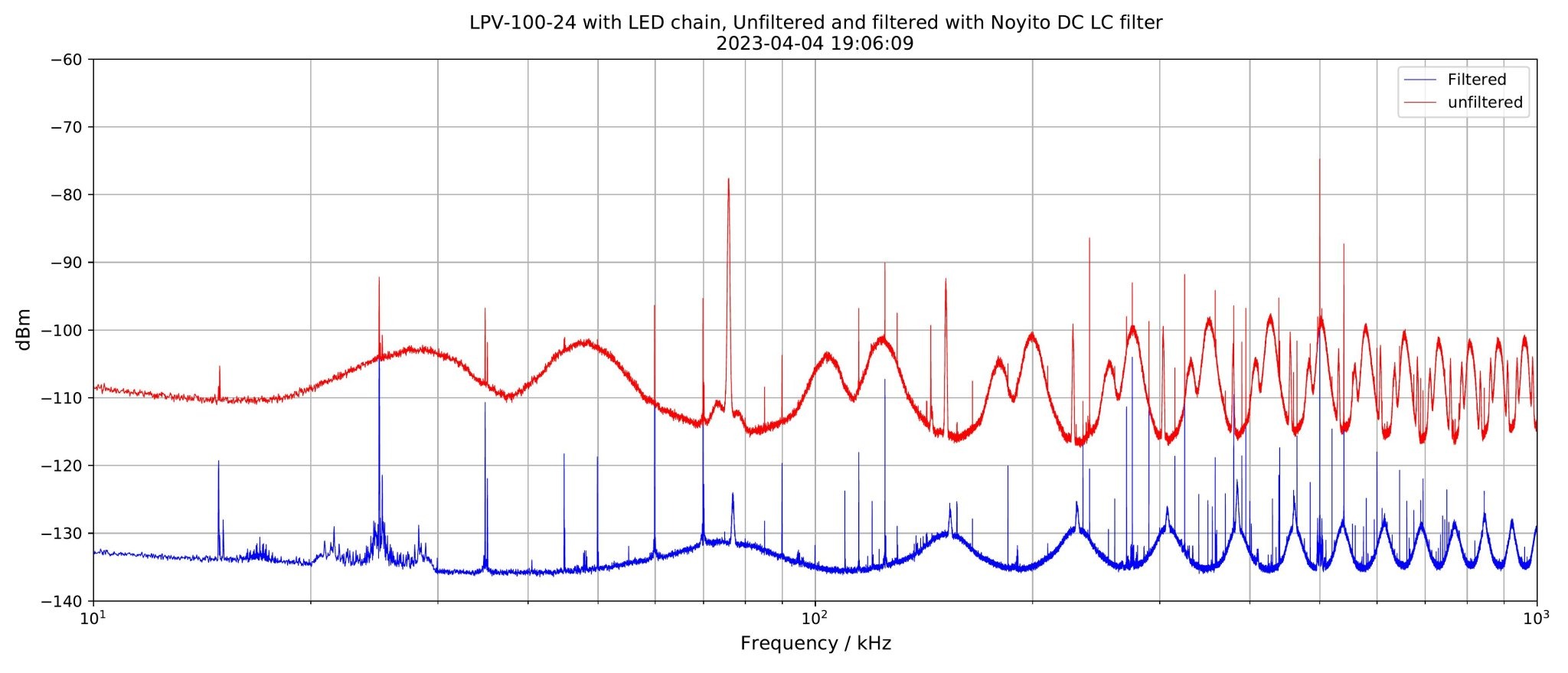

@jbau: Saw your answer too late, so
here with a log-scale. Interesting on how the spectral contents shift and change with the filter. Unfortunately, there are no data at all for the filter, so maybe I disassemble it and measure the chokes and caps for modeling it with LTSpice...

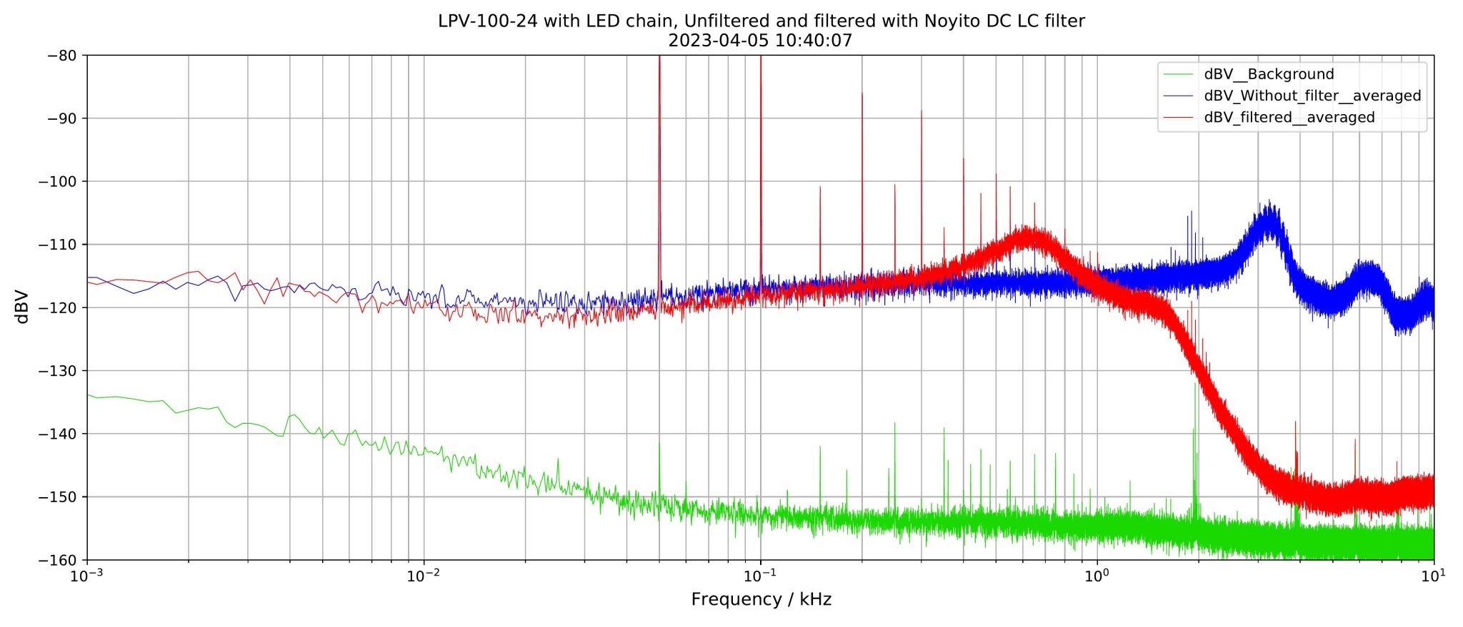

Not measured (yet), but I did now:
Note that the x axis is again in kHz (comes from the Picoscope program) and starts at 1Hz and goes to 10 kHz.
The background (green trace) shows noise coming from somewhere, the SMPS data contain both noise from the AC mains (50Hz and multiples). The spikes at 50Hz and 100Hz go to -75dBV in both filtered and unfiltered data.
The filter action above about 1kHz is clearly visible, but I would like to mention a caveat with averaged measurements:
This scan enlarges the bump around 4 kHz and shows peaks reaching substantially above the averaged bump (-78dBV versus -105dBV). I have measured SMPS, which sweep their switching frequency on a second scale. When measuring on a longer time scale with averaging decreases therefore the maxima to a more "pleasant" niveau (and the SMPS may now fulfill the limits according to CISPR in a miraculous way:wave2:).

Boy, that averaging filter has some serious peaking before cutoff!
No, this peak does not come from averaging in the scope, it is the noise (smoothed somewhat due to averaging). In a single shot the bumps are already there.
IMHO, the shift of the bumps comes from the changing impedance the SMPS sees at the output, when the filter is inserted between output and load. This changes the pulse width modulation accordingly.

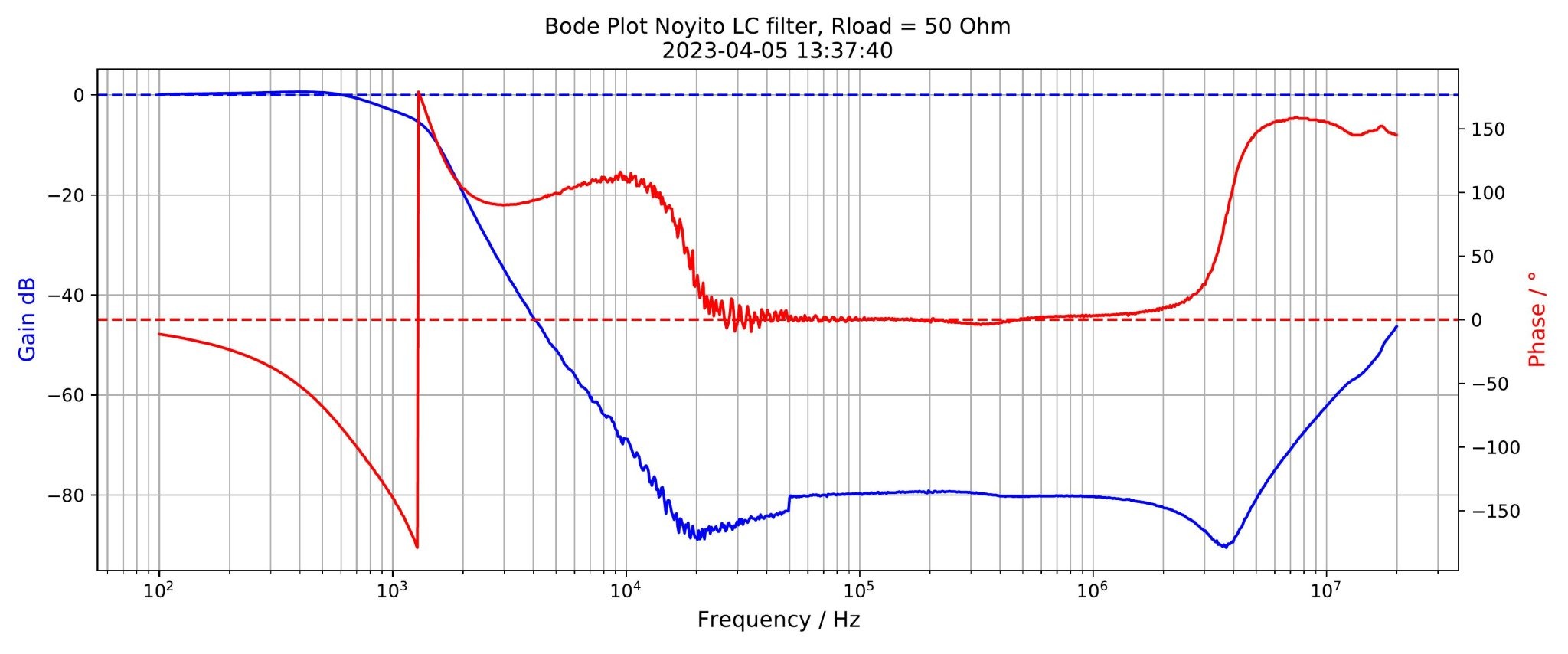

I measured the impedance up to 20MHz with a load of 50Ohm:
Above about 3.5MHz the filter behaves like an inductor, which is (as you mention) probably due to the self-inductance of the elkos (470uF) on the filter board.
The damping of >80dB is in reality spoiled by the ohmic resistance of the LED chain (about 12 Ohm).
