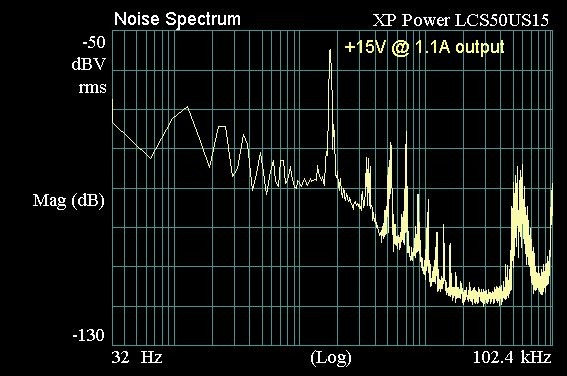

I'll start by posting one to avoid, the turkey that prompted this inquiry for me. An XP Power LCS50US15, rated 15V @ 3.4A. This thing stinks for audio, the largest noise spike is at 1.7kHz (and its harmonics). And this measurement was with 1,000uF on its output. Stock, it's even worse. I had to float the analyzer input, it does not like its output earthed.

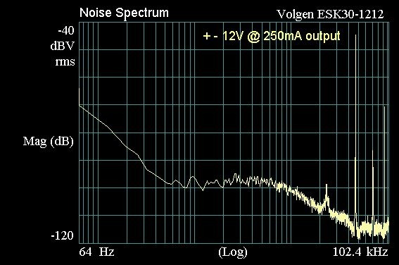

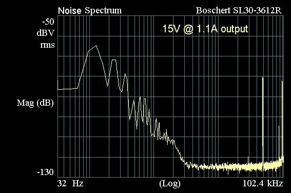

For context, here are a couple oldies that perform pretty well. Both were earthed.
An open-frame Boschert SL30-3612R industrial switcher from the mid-late 80's. Output variable from 10-24V at 5 Amps. I've used these for numerous things on the bench for quite a while. Not excellent, but good enuf.
And a Volgen ESK30-1212 from the 90's. + and - 12V @ 500mA, and 5V @ 2.5A. I've used the bipolar 12V outputs for raw DC to a DAC with good results. Noise curve is excellent in the audio range.

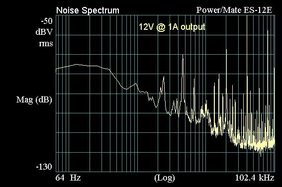

Here are a couple 12 volters. Both were earthed.
I have used the Power/Mate ES-12E 12V @ 5A to supply raw DC to a Stax headphone amp for the last year. It is worlds better tnam the linear wallwart that Stax supplied. Had I checked the noise output I might have looked further.

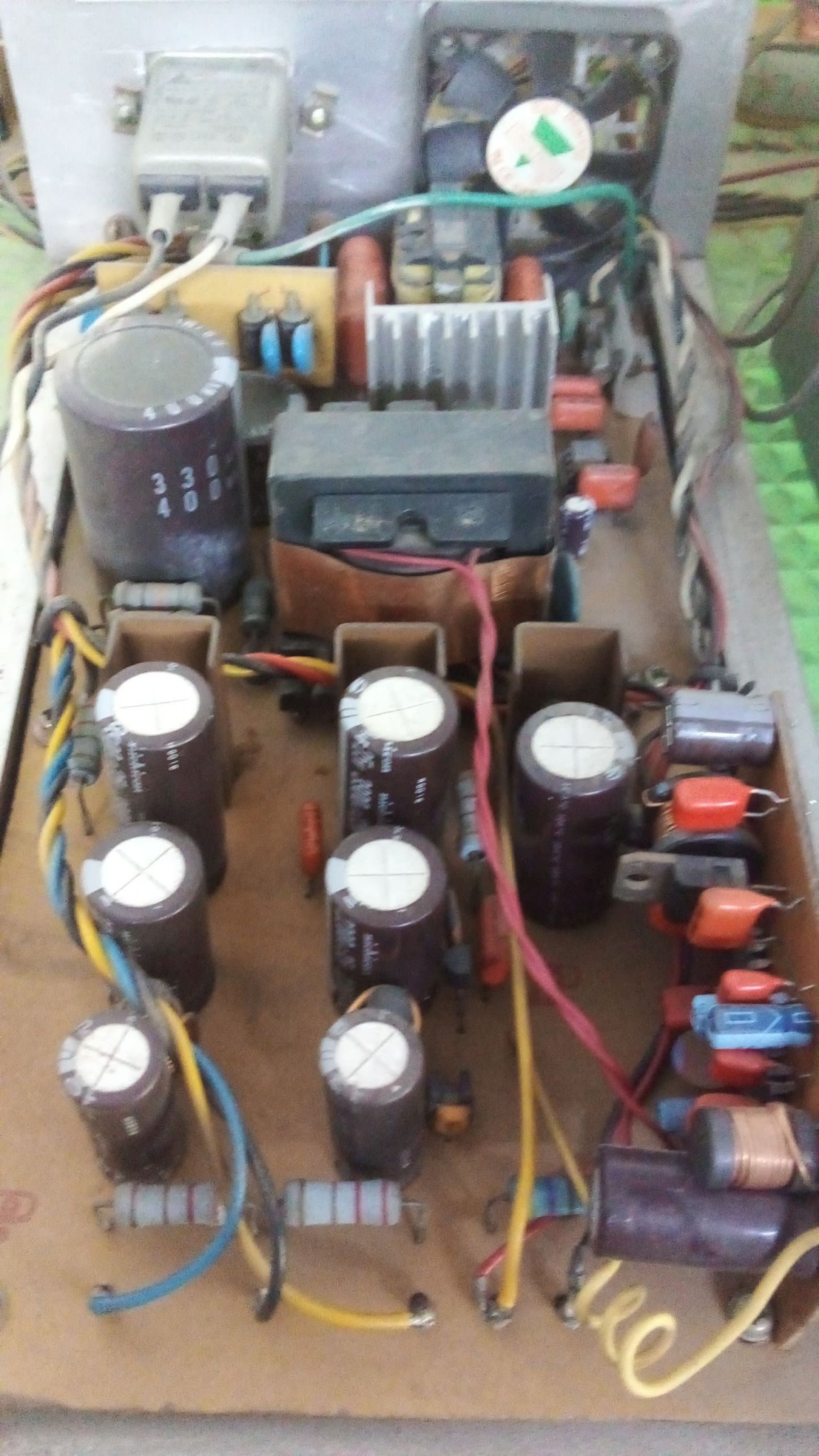

I had been using my own designed SMPS in my system. No measurements of such kind because I lack of those instruments. But I sincerely didn't had any trouble during the 25 years of regular use diarily.
It is a one MOSFET switching FlyBack topology current mode using UC3842 as controller. MOSFET is a 7N60 both from STM and are re-used. Voltage control is TL431 and photocoupler PC817. It includes double line filter on board (2 x 2 x 36mH common mode chokes) plus 1uF X type and 0.01uF Y2. There is another built in the mains socket. The rectifiers are BYT13 1000 and is a 0.001uF parallel to each one. The drain of the MOSFET has a VK200 choke. The heat sink returns to high side negative. There is also a .01uF Y2 from negative to ground to close RF parasitics through trafo capacitance. Post rectification there is a 47uF 400V, a 150uH and 330uF more. All those elements provide from scrapped PC monitors including heat sinks, capacitors, active elements and chokes. Only new is the PC817 and the PCB. Snubber ate a 0.01uF parallel to 20K and diode is BYT01 1000.
At the secondary, 3 BYW98 200 gives me +/- 14V for TDA2030 and 12V for TDA2003 (3 each). Input filter capacitance is 3900uF, a 1uH small choke and 2200uF more. A second post regulator around L4794 from 12V to get 5.1V for logic. As it is a specific design, I took very care about layout of the PCB and filtering.
I have the schematic if any is interested in.
Thanks for sharing!!
That Volgen looks pretty good. I checked the price - around $600-700 (!). I can build a high-quality liner power supply unit for that money (with a total of 4 very low noise small-signal transistors & 2 paralleled TO3 pass transistors).... single rail, around 6-7A constant current delivery. That includes high-quality capacitors as well. Sounds amazing.

BTW, the XP Power unit above had 1,000uF on its output in the above measurement. Without it, its even worse.

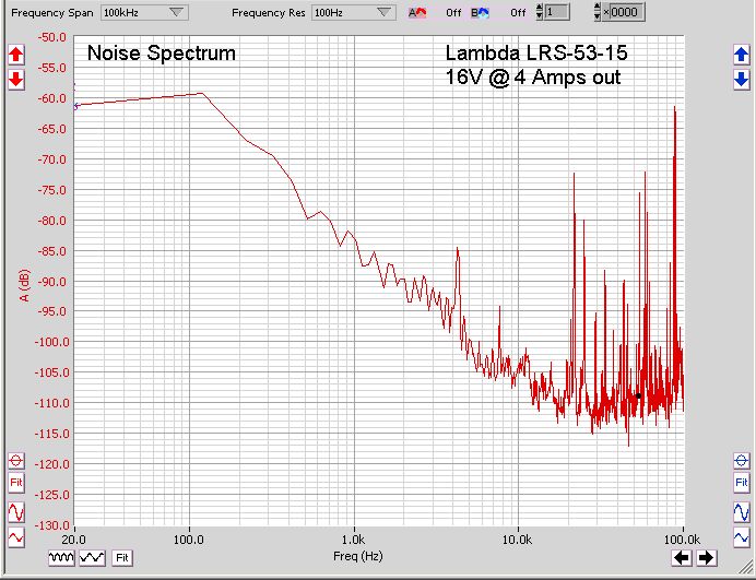

Here's another industrial switcher, a 150W Lambda LRS-53-15, rated 15V @ 10A. Putting out 16V into 4 Ohms (4A) for this test. I used this supply to power a couple of JLH amps last year but abandoned the project before I could make any judgement on how it sounded.
This test was done with a 10-bit USB scope (Cleverscope) on the 30mV range and you can see it has plenty of dynamic range for this test. Even an 8-bit with averaging will probably produce useful data.

The XP Power LCS50US15 plot shows a strong signal just below 2kHz, along with harmonics - if that response is typical of that supply (and not a fault) then yes something is definitely below par with its design. I would expect very few commercial supplies to generate such specific high level signals in the audio range.
For sure all the smps with switching freq below 96kHz will show a signal at their switching frequency and its harmonics (if within the bandwidth of the measurement setup, so typically 96kHz max).
