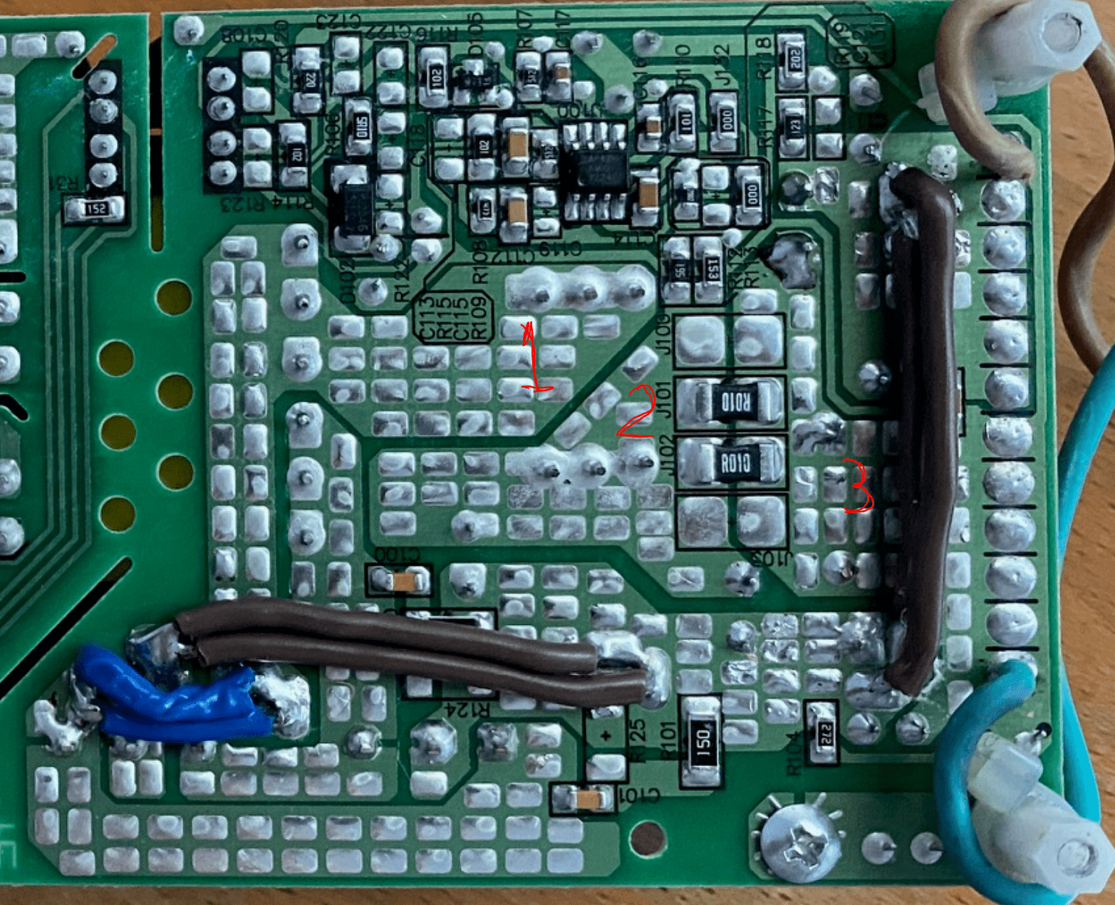

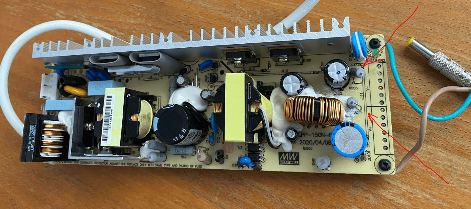

Here are the Meanwell photos:
1 = dirty ground
2 = semi-dirty (after the choke)
3 = "clean" (output) ground, after 2 x 0.01 ohm SMD resistors (notice: there's provision for 4 of these reisitors, but only 2 were used)
The top view... I replaced one of the filter capacitors with the same-value Philips cap that I like. Notice 2 x 270ohm resistors that are loading the output when the power supply is idle => 110mA of the constant current draw... which in this case might be too much due to the minuscule size of that heatsink that runs too hot even with no load connected:
AU$76 at Mouser... I looked a bit more... AU$46 at the local shop in Sydney. So, yeah, it will power up something that needs 15V... but it sure is a noise generator with appalling ground uniformity... it also needs the fan cooling to keep the whole thing under control temp-wise even when it's idling. That is all despite the very latest and greatest ultrafast-switching diodes used (D92-02).
Just a friendly reminder for all who are planning to play with these open-frame types... the big black 400-odd volts capacitor LIKES to keep the charge for around 5-10min. Either discharge it with a (what I use) 10ohm/50W resisitor, or let it sit on the bench for a while.

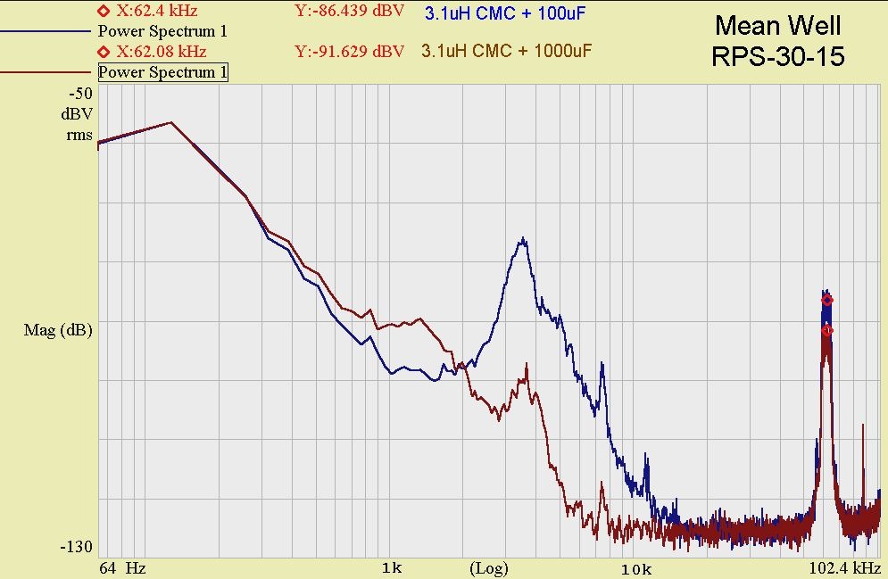

Now let's see what difference a common-mode choke on the output makes. Most CMC's are designed for mains input filtering and are high-inductance (1mH and up), not suitable for a ps output. Something in the 2- to 5uH range is suitable, as it maintains low output impedance over most of the audio band.
The CMC I used is 3.1uH per side, with 2mΩ DCR. For a 65kHz switcher (the MeanWell RPS-30-15), the impedance of 3.1uH at 65kHz is about 1.3Ω. With no capacitor following the CMC, noise was the same as without it. So all by itself, the CMC isn't giving us anything.
These noise spectra are with 100uF and then 1000uF after the CMC, 1A load on the RPS.
The 65kHz spike is only 6dB lower with the CMC compared to without it. The capacitor is what makes the biggest difference.

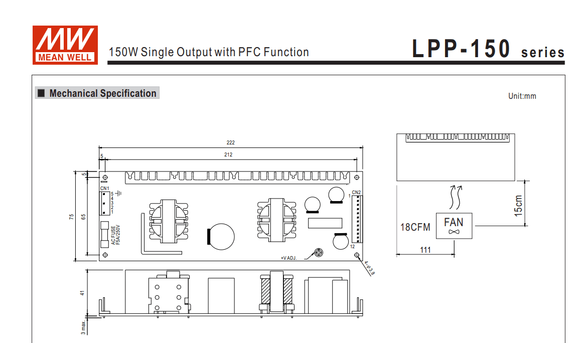

I compared the spec sheets for the one you tested (RPS-30-15) and the one I posted the photos of (LPP-150-15). I noticed the same noise figures (100mV pp); however, the RPS has only 0.1W max of idle power consumption (7mA) and therefore - does not need forced cooling when idle, whereas LPP, despite the claim of 10A max current capability, will need the forced cooling as soon as it is placed in the chassis (enclosure), due to idle current draw I mentioned earlier (110mA !!!)
Of course, the spec sheet for LPP does not state anywhere the idle current / power consumption. The fan is shown in the mechanical drawings section....

Capacitors over 1000uF yield no reduction in the 65kHz peak.larger chokes might have mH of common-mode inductance, but much less differential-mode inductance - µH or so. Just use a bigger capacitor afterwards if you need low output impedance though.
Also note in the plot that the noise was worse (about 8dB max) from ~ 500Hz to 1.8kHz with the 1000uF cap vs the 100uF one. That is real, and is caused by the resonant interaction of the L and C chosen. Larger caps push the resonance even lower. The two-stage filters have this as well. These are not "maximally flat" networks...

It's possible that a higher inductance CMC would improve on my results, but the output impedance would be very messy. Of course, one can create all sorts of "midrange magic" with impedance peaks in the audio passband...

Indeed, because at 65kHz the attenuation from larger capacitors is limited by ESR and ESL. You need a bigger choke to get more attenuation at 65kHz. Larger capacitors will give you the lower output impedance at audio frequencies that you wanted though.Capacitors over 1000uF yield no reduction in the 65kHz peak.
