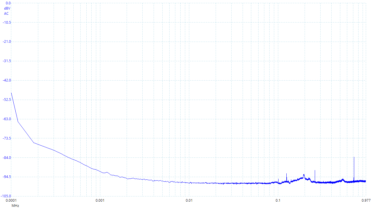

Alright, just to demonstrate that common-mode chokes can reduce noise substantially if used appropriately, here's the same wall-wart from post #38, with the same 2A load, this time with a choke and capacitor between it and the load.
I can't tell you a part number for the choke because it's just a random one I had in my parts drawer. It measures 2.2mH common-mode, 8.6µH differential-mode @ 100kHz. DCR is 0.05Ω (both windings in series). The capacitor is a standard 1000µF 35V part, with an ESR of 35mΩ @ 100kHz.
The switching noise at 120kHz is gone completely, and the noise floor has been pushed down quite a lot.

Actually, it's not completely gone... it's at -84dBV, which is in the same ballpark that I was getting.
Your noise floor is definitely lower, though.

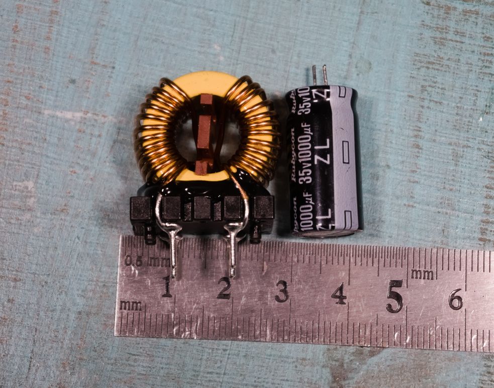

Can you post a pic of the choke? That will give us some bearings on it.
Also, for clarity, pls explain how you're measuring the inductances.
Here you go, one photo of a choke, plus the capacitor I used.
I measured the inductance with a DE-5000. Connect the windings in series, and reverse the polarity of one winding to switch between differential and common mode.
There's something at -84dBV, but it's not the switching frequency. It could be a harmonic, but given how much less it has been attenuated than everything nearby, I suspect it's actually radiated interference that has been picked up, perhaps from my poorly shielded PC.
Thanks, my 3.1uH choke is pretty much the same.
Ah, right, my bad. Your switching freq is down around -92, which is about the same as I was getting with the 3.1uH choke and 1000uF. This suggests to me that we may be in the right ballpark already.

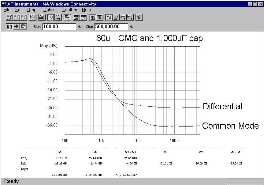

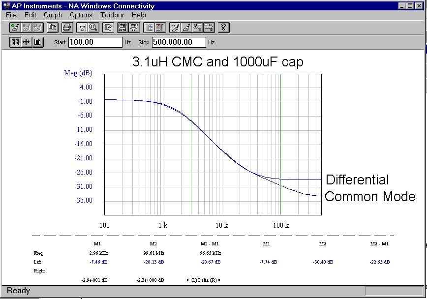

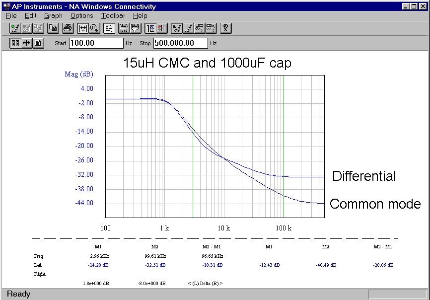

Here's the attenuation curve for the two CM chokes I've been playing with. My assumption is, we want a large cap on the output side, so a 1000uF cap is there. I wanted to see the difference between the chokes in differential vs common mode. And in particular, I wanted to see a reason why the 60uH CMC had 10dB less attenuation at 65kHz than the 3.1uH one did.
Here's the 3.1uH curves.

Common mode configuration definitely gives more attenuation, 5 to 10dB.
However, I don't see why, as I measured a few days ago, the 60uH had 10dB less attenuation of the 65kHz switching freq than the 3.1uH did. These curves say it should have been about 8dB more than the 3.1uH. Any ideas?
BTW, I'm calling these by the inductance of one side, not with both windings in series. If the latter is the correct way, then these are actually 6.2uH and 120uH CMC's.
So there's more to figger out here. The 3.1 definitely needs to be about 3 times larger inductance to be effective at 65kHz.
I tried a 1500uF cap with the 15uH choke and it was worse.
So smaller cap and larger choke is needed to get the null closer to 65kHz.

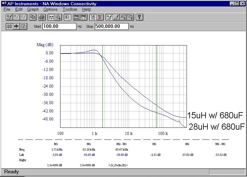

Here's the 15uH with 680uF, and a 28uH with 680uF. Note the vertical scaling has changed to accomodate the greater attenuation. Definitely heading in the right direction, though some peaking has returned. More to come.
