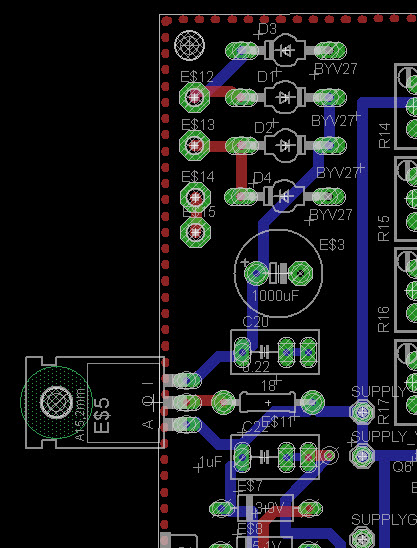

I think your pcb is the first edition.
Thank you for the pic.
Look post nº2 of this thread and must be least one more.
Regards zeoN_Rider

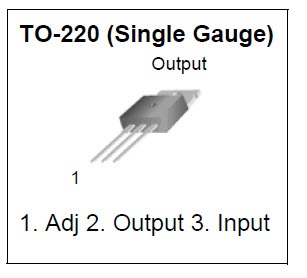

you're right , but that was obviously mistake in post #2 http://www.diyaudio.com/forums/anal...n-man-optical-volume-control.html#post1675967
whatever , pcb is clearly made for T0220 package , and there is just one - normal and straightforward pinout for T0220 LM317
and , logically , table in Cookbook is having exact T0220 type reg .
as I said - I (we) would never use 100mA capable reg for 70mA CCS duty
so - just untwist those legs 😉 ......... or , even better - put new one in place

I put the LM ok and get the same measurements.
I must revised other parts. Perhaps the resistors. Because the curret go to JMP02.

Hello friends:
I stell with the problem. I revised all resistor and gain potentiometer and all looks well, but now my multimeter don´t read mA through the jumper 01 and across the jumper 01 is dangerous high. Any sugestion for the next work?
Perhaps change Q1 and/or Q4?

Sorry, I wont tell across jumper 02 are more current, 40 mA and the jumper 01 nothing in any position of potentiometers.
That's not good. Power it off, and do as Zen said - re-read cookbook .
http://dl.dropbox.com/u/20665608/PSM LS Cook Book.pdf
-are you having approx. 15 Vdc after reg ?
-what's voltage across VR1 ?
- is LED1 lit ?
Yes I have around 17v. The led shine well. In Q3 2,3V . Across VR1 don´t remember now. I´ll see tomorrow and read again the cook book.
