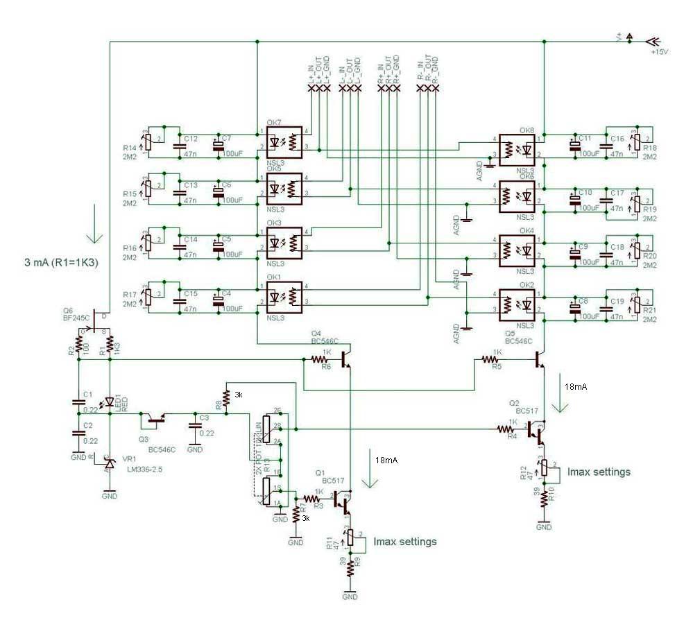

result of collaboration of few Serbian DiyAs - one engineer mind (sp300b) and one sick mind (ZM)
as usual - ZM does all back of napkin drawings and some testing , sp300b does some much more testing and pcbs ;
find schematics enclosed ; pcbs are in stage of testing ..... in fact - pcbs for PSM Optical Volume
are ordered , and pcbs for separate buffer are in developing ;
first - PSMLS schematic ; nice drawn by sp300b ( not in my usual gorgeoushandscribing way )
it's intended either for stereo balanced or stereo unbalanced ( omitting
4 LDRs)

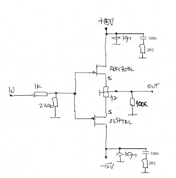

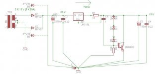

separate pcb for buffers and dedicated supply/reg will contain 4 buffers
.........4 pcs of good ole JC buffer , as sp300b's wish ...... even if I intent to use real poor man's choice - pair of J310 jfets in "source follower up/CCS bellow" configuration .....
this time my fave back of napkin drawing

The question is : will it drive F4?
yup , certainly - if instead buffer part you use
steenoe said:ZM & Spavleski, great job
Where can we order, I wanna try some of that lightnin' stuff.
Nice little supply for the buffer.

reg for buffer is nothing special , except one little trick ,and even that is boiled water
I'm sorta shy-proud with LS circ ..... buffer reg is trivial
DVBjunky said:Me too...me too!
ZenMod, will we get a detailed description of the "Schematic" of the PoorSerbianManLightspeed.....whats different compared to the lightspeed Mk2 or Papa´s LDR?
You like the J310 jfets? Tell us more
Thanks in advance.
cheers
Alan
difference between Mk's of Lightspeed is ( at least as I see it ) is that Mk1 is series fixed resistor/LDR to gnd , and Mk2 is LDRs in both positions .....
so - solution here is same as in MK2 and in Papa's version - LDRs in both positions , so just reg is different , with few other tricks in it .
here is different , comparing to Papa's only that we used rather primary current regulator than voltage regulator ..... in fact - there is not much different , but I have impression that this variant is pretty good ;
NB - I didn't analyzed Papa's circ in deep , so I can't tell right now is it current or voltage oriented (even if that's just matter of wiev) ;
I just goes for different solution ...
parallel resistor to lin pot is trick borrowed from Eliot Sound ( his site is treasure indeed)
regarding J309/310 jfets - I'm using them in my
I see them as 2SK170V ...... on steroids
