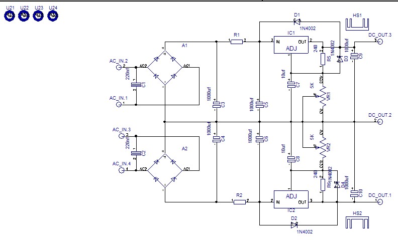

Buffer PSU
¡Happy new year!
I´d like built in my own board (matrix dots) this PSU for a headphone amp but I´d like too can adjust the voltage between +/- 9 V to +/- 15 V or so. for test sound. ¿Can I put trimers in any place of circuit? This way is very confortable.
Thanks a lot.
¡Happy new year!
Thanks a lot.
Jose
HNY to you 😉
which PSU ? shunt , for buffer stage ?
you need to tell me which headphone amps schm , so I can make needed changes , that circuit suit your needs
HNY to you 😉

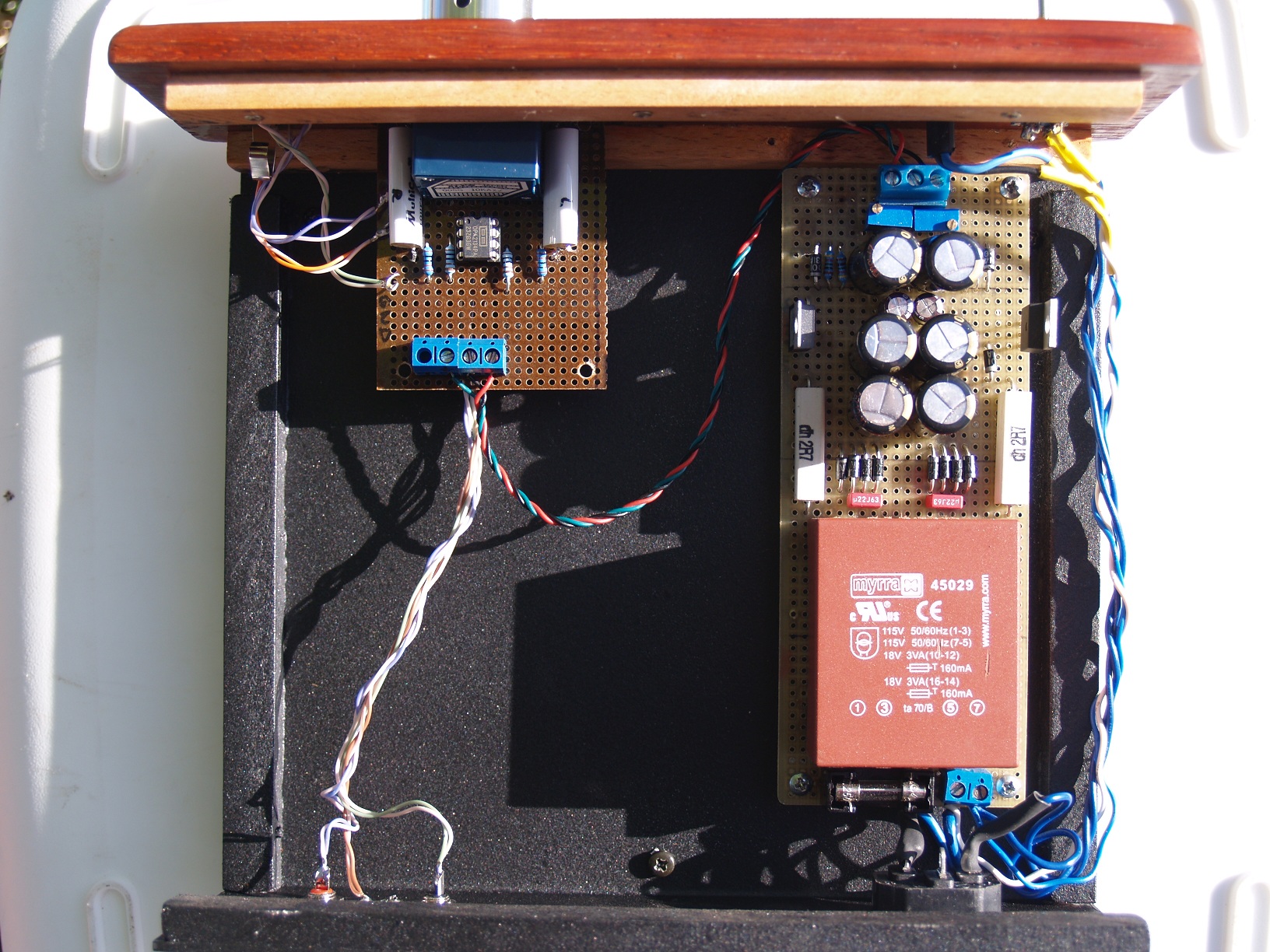

you made proper bipolar supply , as I can see from pics ?
so - 2x18Vac/6VA xformer , and you need 2x9Vdc up to ......... we'll see what max can be
tomorrow , please 😉
tomorrow , please 😉
