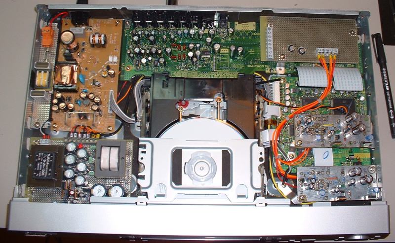

I looked through the section that interested me most. The place that I find easier to mod is the output stage. I also found from other machines that the analog section can make a huge difference to the sound. Changing numerous power supply capacitors and the clock is more difficult and we have a parts problem over here. Even Panasonic FC caps are not available here.
Maybe some judicious supply decoupling after probing with a scope might help the digital section.
At the moment I think I can take out the analog signal just after the DAC and use a passive filter and better opamp and external power supply. That way the board is not affected much. At the most I might remove one SMD resistor . Currently I will not make any holes on the rear panel but will pass it over the rear panel. The top cover might have to be lifted slightly. I will also shield the opamp circuit completely to avoid RF pickup , maybe in a copper foil case.
I want the option of being able to put back everything ( one resistor I guess ) if I want to sell the machine after I am done with it. That would happen only if I can get a machine that is 'much ' better than this one .

I have had good results modifying my DV565A, basically made circuit boards using FET OP-AMPS each with its own regulated PSU that replaced the IV converter hanging off the end of the DSD1791. Here is are the schematics and PCB layouts if anyone is interested. it uses the proteus PCB design package you can get readers from http://www.labcenter.co.uk/ , there is also a bitmap of the schematic. The compressed file is a rar compressed file, I think winzip should cope with it.
I'm listening to my almost completed 563A for about 2 weeks working on my tube preamp. The sound is much better with the new caps, op-amp, separate power supplies with fast-recovery diodes and mechanical damping sheet. The unit weight is now much more substantial. I already installed the +/-Jung PCB for the new analog output stage. You can see the bare board at the back reday to receive the circuit. I may have time to complete this mod next week. Here the picture of the actual player.
The sound is no more agressive in the hights. I'm using my DIY SDS headphone amp and my trusty Grado SR-125. Before the mods, listening using headphone can give you headache really fast. More to come...

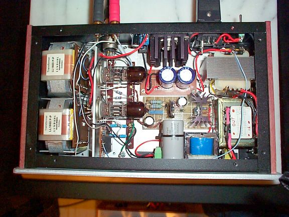

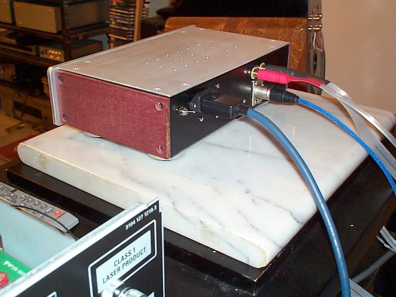

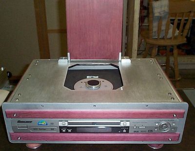

Hi all who have been following this,
Just to let you know that I have just finished a new outboard tube output stage for my latest version of the Pio.
It has a balanced configuration, transformer loaded output using two 6N30 sections per channel. (Like a long tailed pair) . ( I used Lundhal transformers)
There are no caps in the circuit at all, the balanced transformer taking care of the offset. I did not use a roll-off filter, relying on the output transformers' own roloffs.
The Left and Right +and - signals were taken straight after the dac, with the ground, and brought out to a 6 pin connector which also carries the muting relay actuation signal. I made an umbilical using teflon covered silver cable to take the signals to the outboard circuitry. The wires are carried in a nylon mesh chord. The outbaoard chassis uses a 6 pin XLR connector.
The filament supplies are regulated as is the Hv supply. The muting relay circuit is powered from the raw filament supply.
I guess that is it, except that it SOUNDS GREEEEAT!
Some pictures follow.
Nic.
