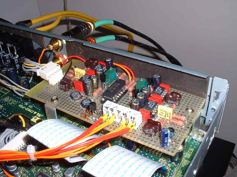

I've just bought the Australian version of this player (DV-667A) and started fiddling around. I anyone could send me the service manual (or even just the schematics) i'd be most grateful.

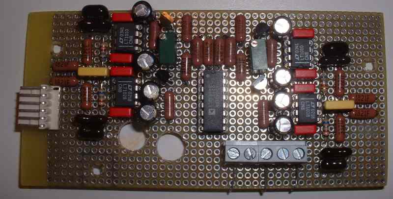

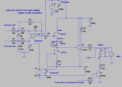

Here my last version of the new op-amp section. I settled on using relay for the mute. The AD411 was too much complex and the relay is just fine. The mute is perfect.
Finally, after months of working on this simple project (there is nothing as a short project with DIY) 🙄, I finally completed all the mods and start listening to the result.
I must say that this new op-amp section is much better than the original section in the player (even upgraded with OPA2604).
I`m using Jung Regulator and quality parts. The sound is much more rich. The original section sounds very good but present like a flat sound.
Now this little player is very acceptable. It sound as good as my Copland that cost 10X more
It is a project that I recommend very much. Thanks Nic for all your help.

It's Alive! - New output stage.
Thanks for the kind words Sylvain.
I'm happy that you and your family like the result of all your work.
The schematic and board work look really clean and professional.
Most importantly, the sound is great.
