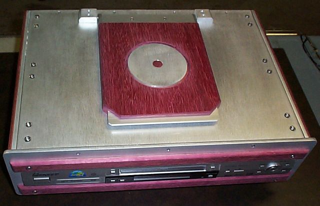

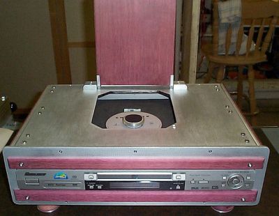

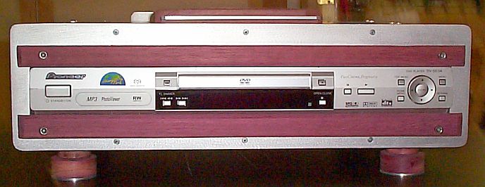

An Updat- DV563 in new clothes
Hi all,
This thread has been quiet for a while.
I thought I would update you on my further adventures.
I bought a new Pioneer unit and started to redo it from scratch.
It has a new chassis made of 1/4 inch alluminum plate and it is accented with purple heart wood.

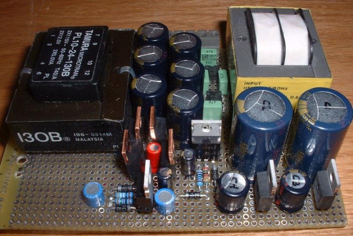

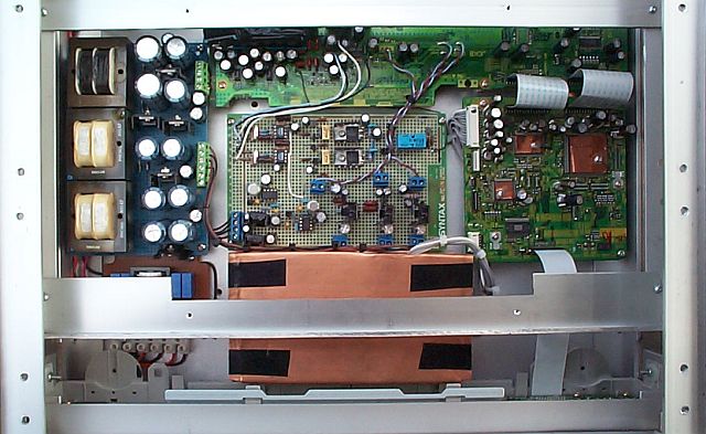

It is a top loader, with 3 new transformers and double regulated 3.3v, 5v and 12v supplies. It has also a new output board sporting OPA 604 single chips which are buffered with a FET and Lt1010 output buffer. This board also has its indepentdent supply, regulated down from +18/-18v and then regulated again using Sulzer style regulators to +14/-14 volts.
Most of this I have outlined on this thread before, so you can get the details there.
I made some further changes to the stock boards.
I replaced all electrolytic capacitors on the "analog" board with Panasonic FC types. The values are described in the earlier posts. The values of the other caps are 50 to 100% higher than stock.
I bypassed each electrolytic on the "digital" board with an equal value Panasonic. The swithcing power supply is modified as before, but is now contained in a covered copper box. The large digital chips have been shielded with copper foil which is grounded to the ground plane.
All new supplies are also fed from a balance capacitor, balanced choke and capacitor filter. The new supplies are meant to be left on always.
I'll post some pictures.
