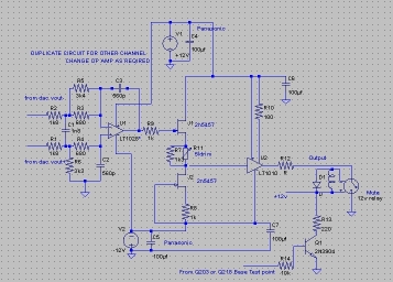

The output circuit I used is a combination of a lot of other people's work. Ben Duncan for the relay muting circuit (Hi-Fi News and Record Review, Nov1987) , Paul Marchese in Audio Amateur 2, 1990 for the Fet Lt1010 output buffer/offset trim, and of course the Texas Instrument DSD1791 spec sheet pg 30.

Output Muting
A suggestion for the muting, no relay click and response time.
Use the Analog Device Quad SPDT Switches. The turn On resistance is less than 35 ohms. You can get free sample from www.analog.com
Just put the switch in serie and add the needed logic to get the switch open when muting.

Why don't you post a schematic of the logic and the pick-off point on the Pioneer so we can judge better how to use the device?
Also, why does this switch have to be in series with the signal, when all you want to do is mute the output to ground?

We want to remove all resistors from the output. To short to gnd the output, we need to let one resistor in serie with the output, then ground the output to mute.
I taught that by opening the output with the switch, that will mute the sound and there will be only the switch small resistor in serie with the output.
I just bought a 563A and I ordered the ADG411. I will try to use it this week. I may also use a 75R resistor in serie and short it to gnd if the switch open trick doesn't give good result.

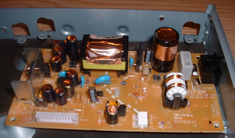

In addition to the capacitor upgrade, did you make any other changes to the smps? Rectifier diodes for example.

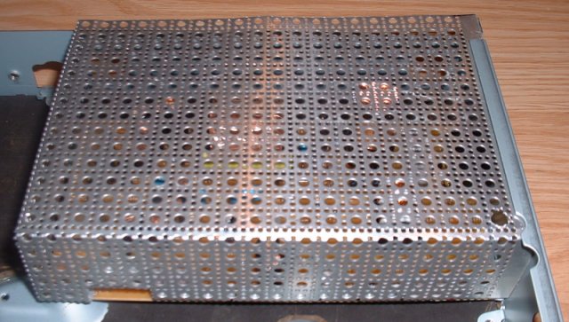

I see that you used copper foil to cover different parts. Did you ground the foil?

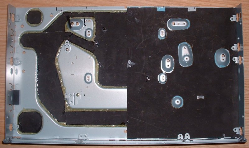

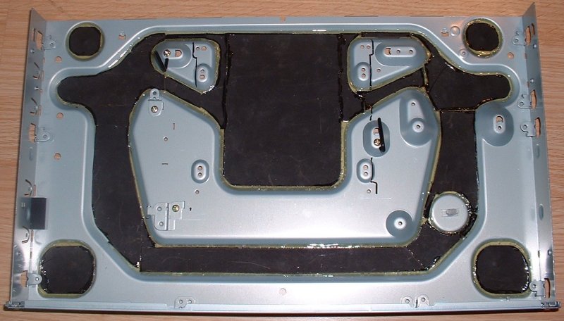

The extensive damping looks neat. I plan to do the same but to the bottom on the outside and then bolt the chassis to a platform of some thick, heavy material. I can't decide on an mdf/sorbothane/mdf sandwich , or go for real mass with a piece of damped granite or marble. I would welcome suggestions!
One more question. I see that you removed everything from the chassis to do your damping. Did you undo the flex foil connections? If you did, can you explain how to take them off, short of unsoldering everything? I don't have any experience with this type of wiring harness.
