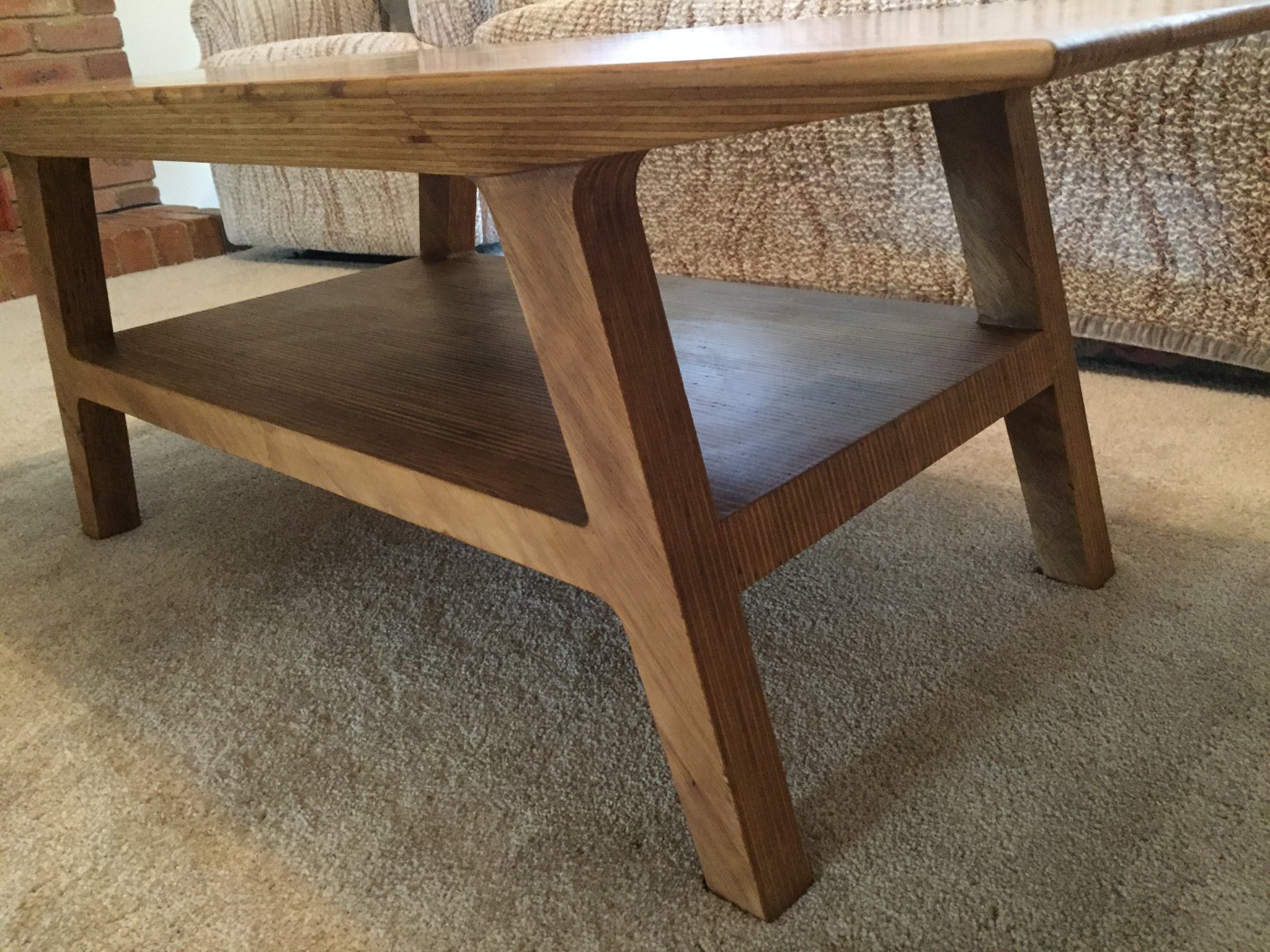

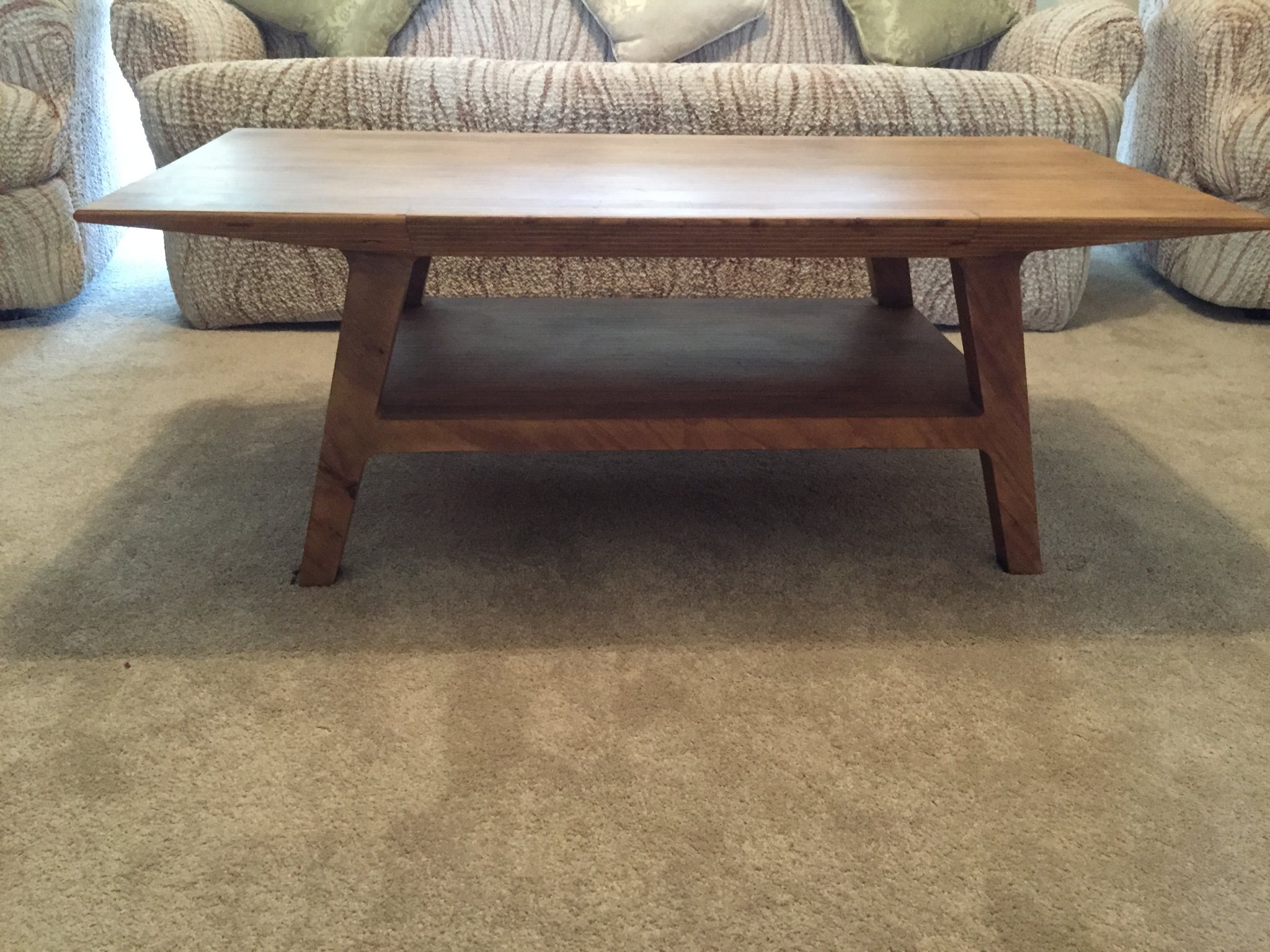

As an avid constructor I have used a fair bit of QUALITY plywood, over the last couple of years I have built a record cabinet out of veneered ply and three coffee tables, one of which was end grain (pictures below) I can honestly say that I have come across zero cavities during these builds. If you are getting voids in your ply I would suggest that you change your source or supplier
