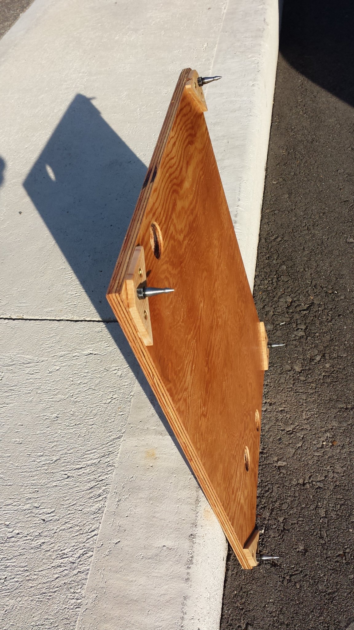

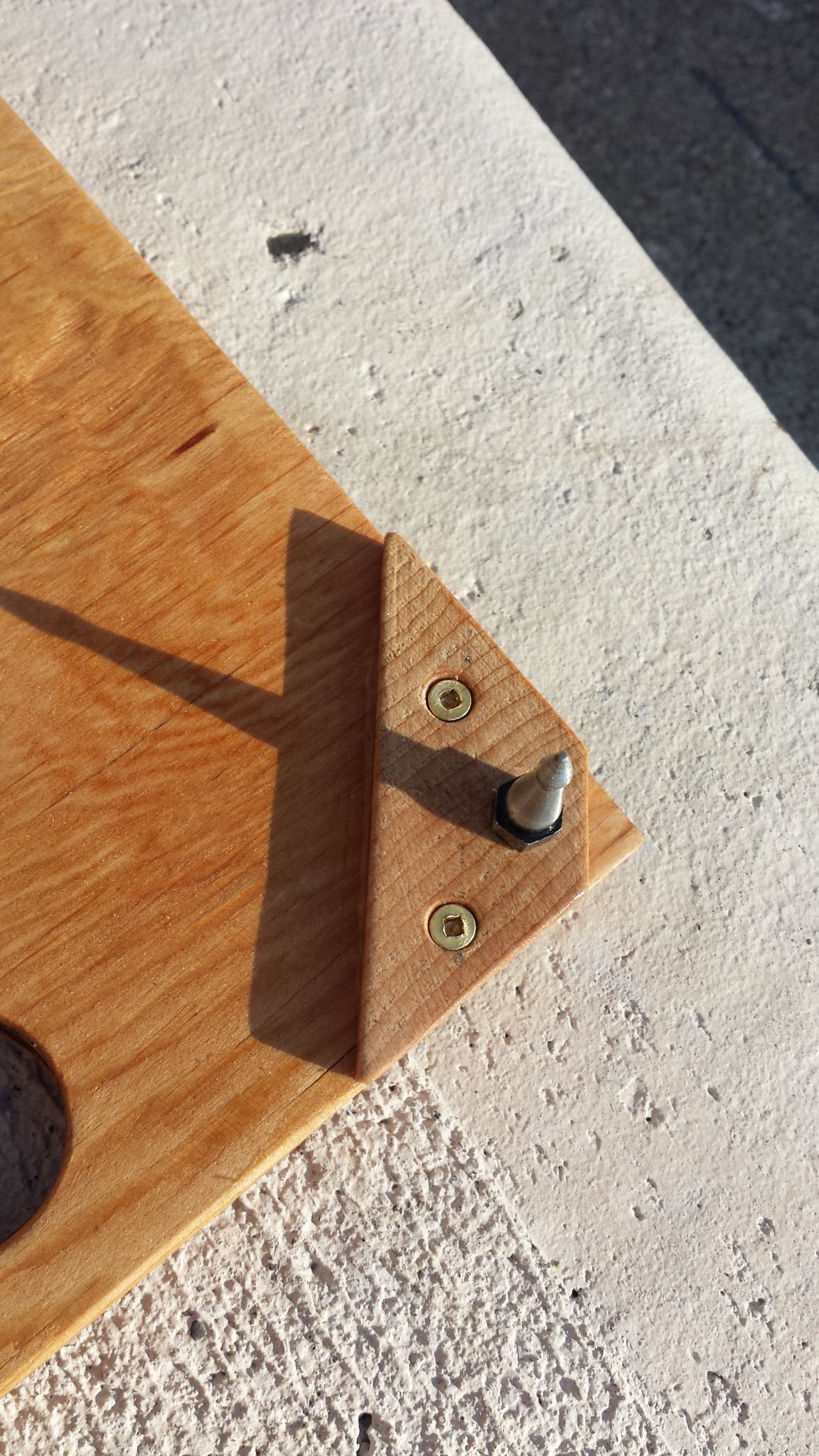

I prefer ply over mdf. This veneered ply was meant for open some open baffles. I changed direction to a flexy rack x 8 shelves. The shelf I need more atm.

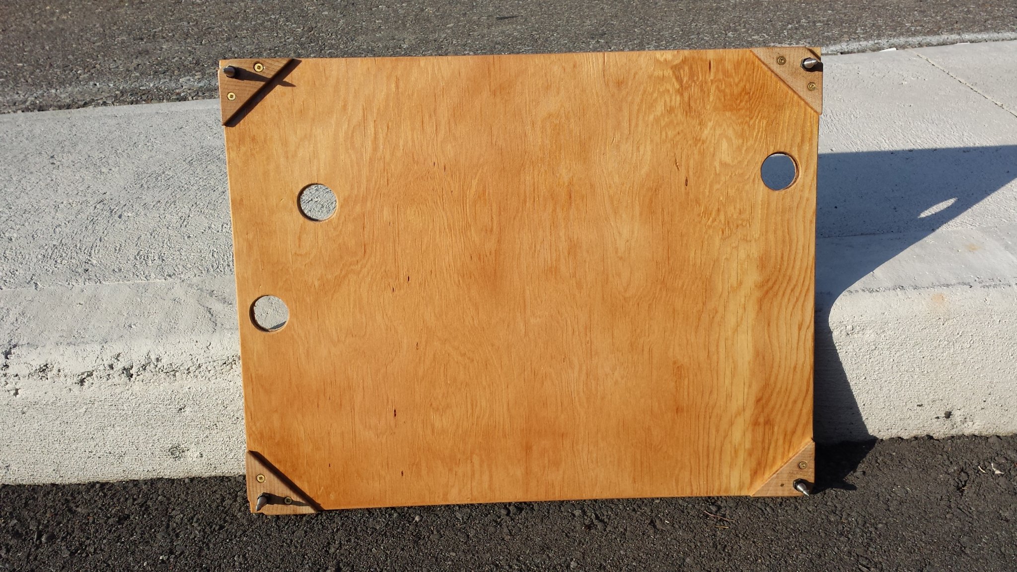

I also made my Thoren's 160 base cover with marine grade ply, 1/4" Many guys prefer MDF for this application. I can't say which sounds best, but mine beats the the original inferior part.

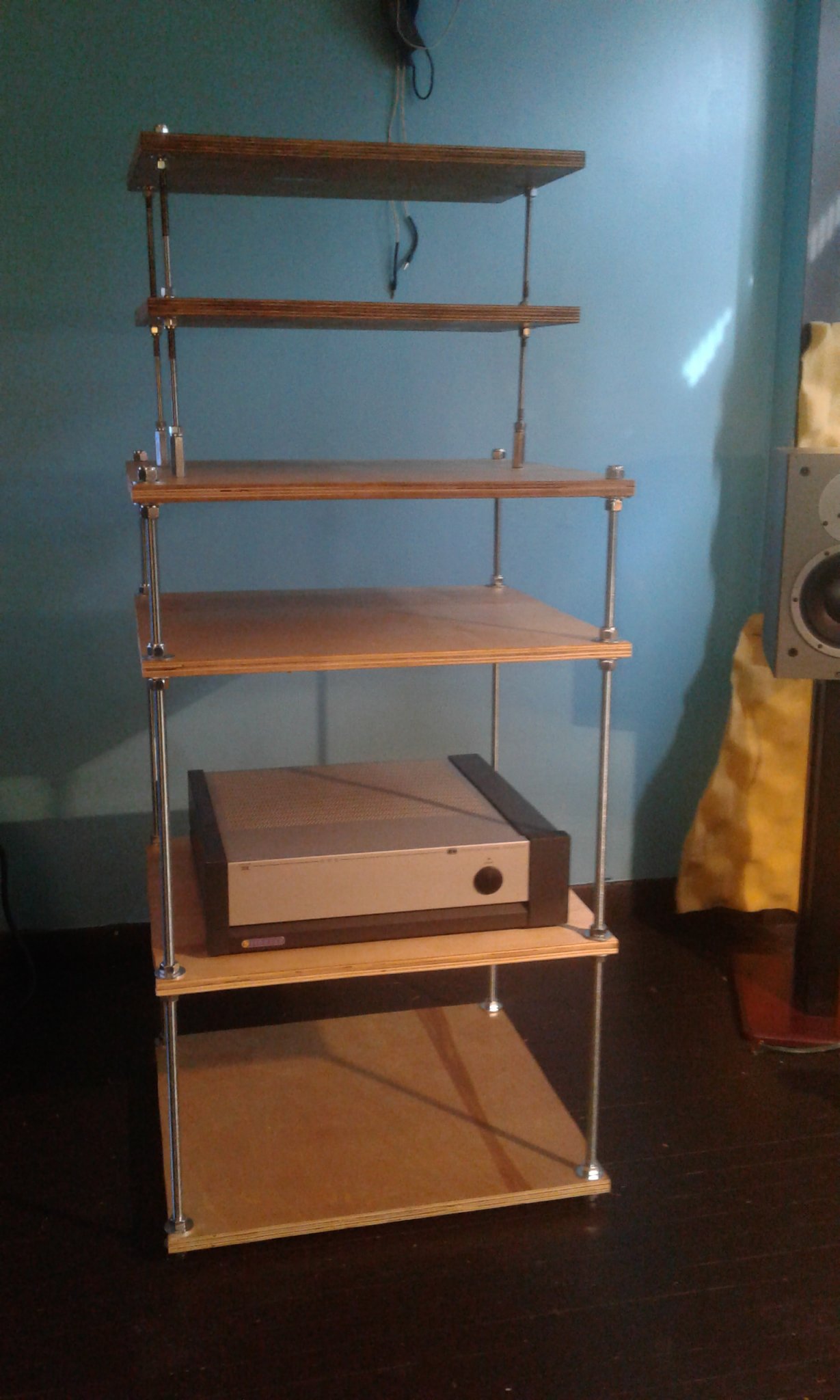

I finished the flexy. If I made it out of MDF I'd still be picking sawdust out of everywhere. Besides the shelves would start to sag by having a 50-60 lb amplifier on it. The ply feels as stable as can be.
I already got another plywood project lined up.

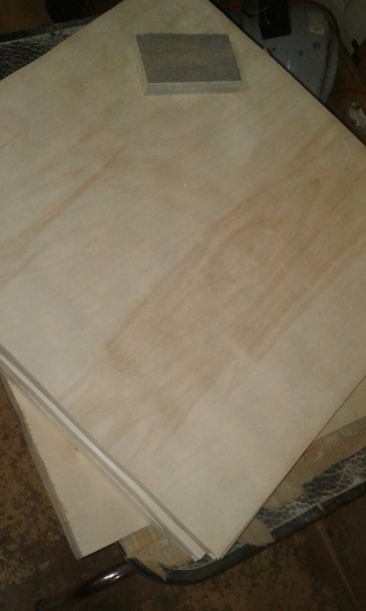

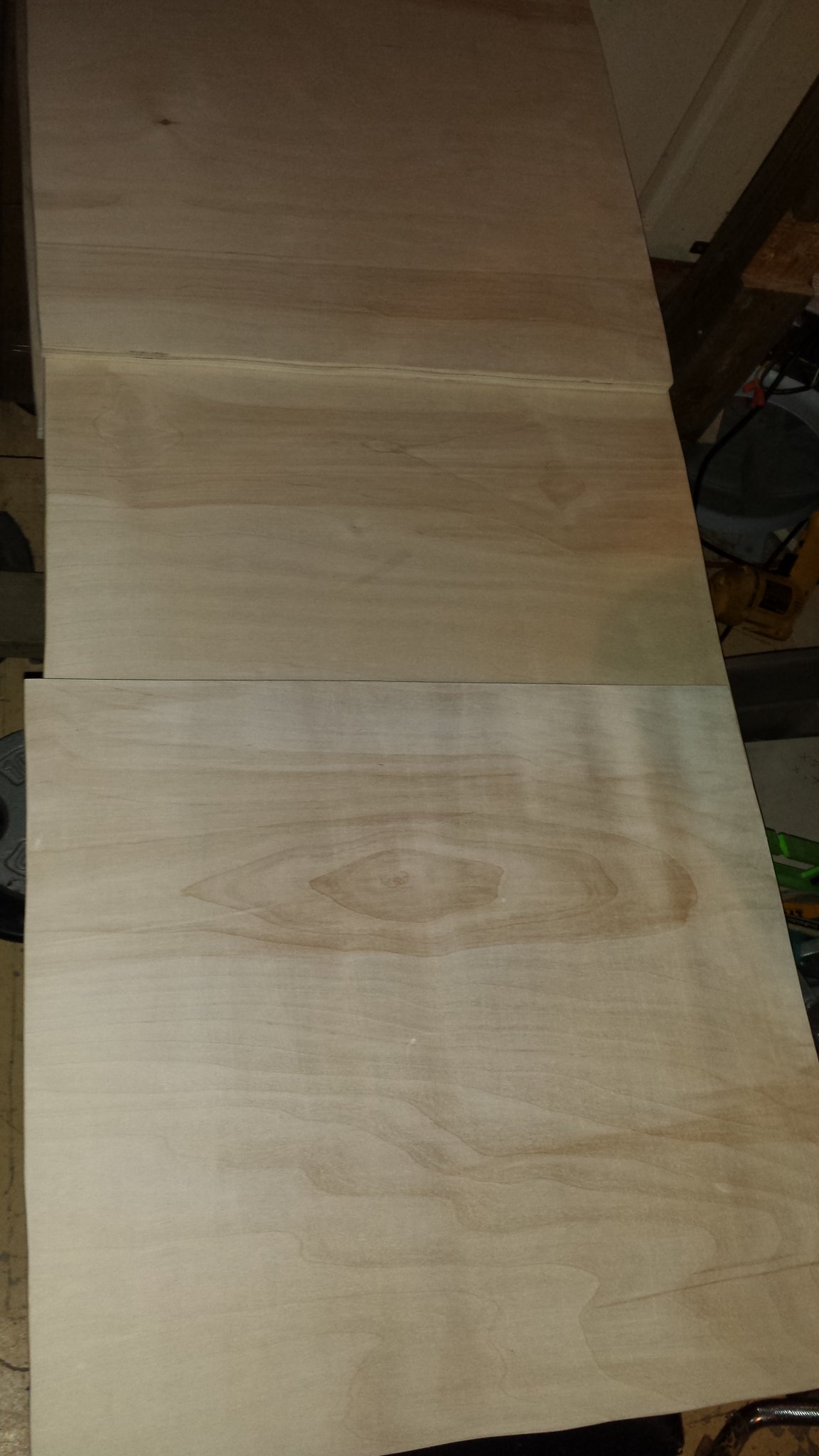

I think I will build a second rack with genuine Baltic Birch. I ran out. The top tiers are Baltic Birch you can see how much nicer and consistent the ply layers are in my image. Its stronger, and is said to have better acoustic properties.

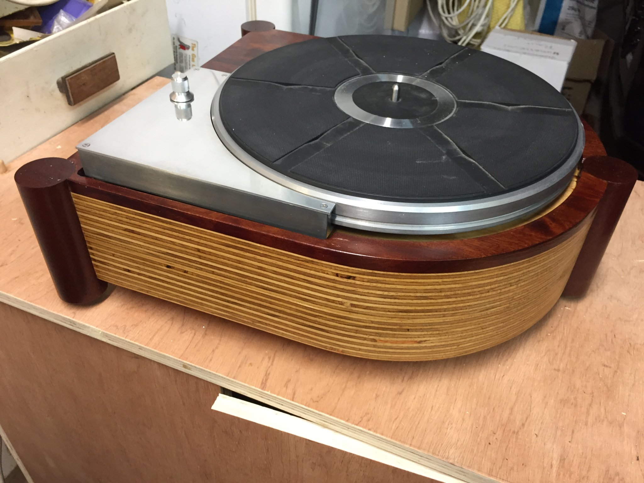

Liking plywood, will probably like my turntable build then.
Awesome, Baltic Birch plywood plinths not only look great and to have so much going on, the options for them seems almost unlimited. Then theres also the acoustic values.
Thats a match made in audio heaven. The base I did for the Thoren's, the end game involves a 8 or 10 inch BB plinth. My analog stuff has to remain on a shelf so I can focus on speakers and inside the digital domain for a while.

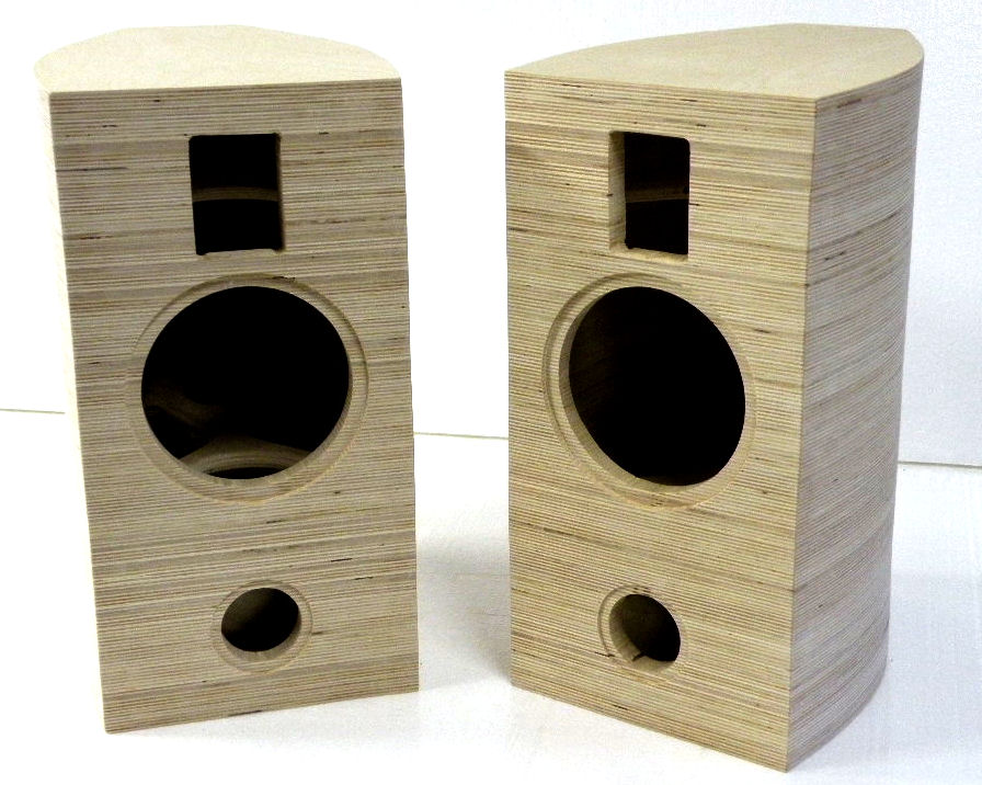

That was a piece from a boat cubby, so even less than perfect. I prefer recycling timber whenever I can. The age and wear just gave it more character. MDF might of disintegrated by now.
