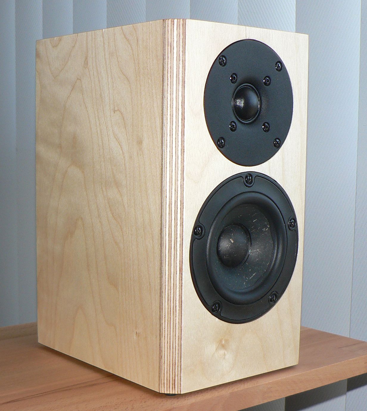

I only used 1200x600 sheets which was adequate for bookshelf speakers and subwoofers. The sheet arrived sandwiched between MDF sheets and wrapped for transport protection.
The price depends what you are willing to pay for quality material and the outcomes expected. I know most Diyers are tight but a lot of personal effort goes into a build and I don't mind paying for a good final result.

That build looks really nice mate!
