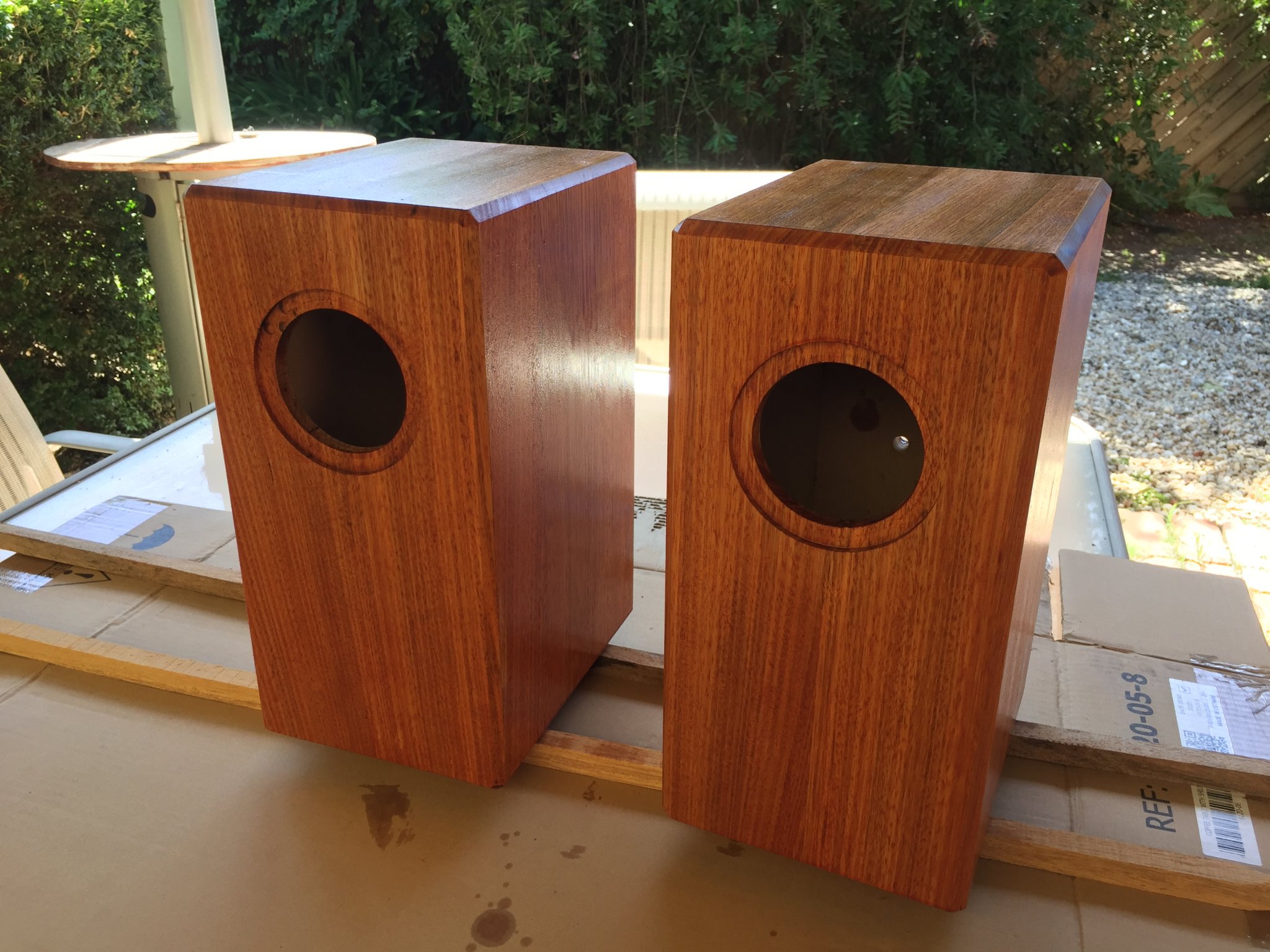

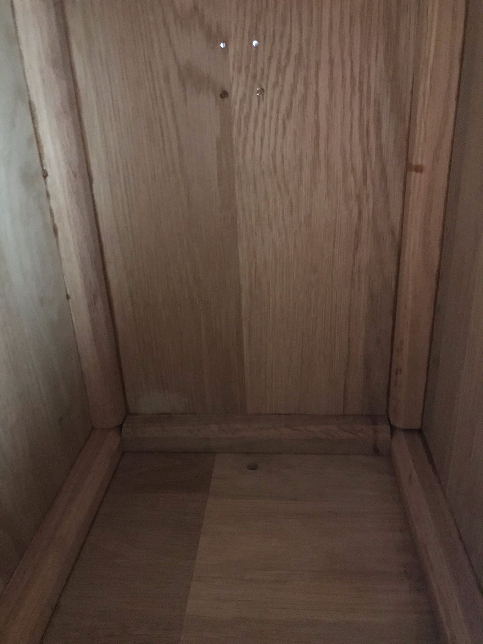

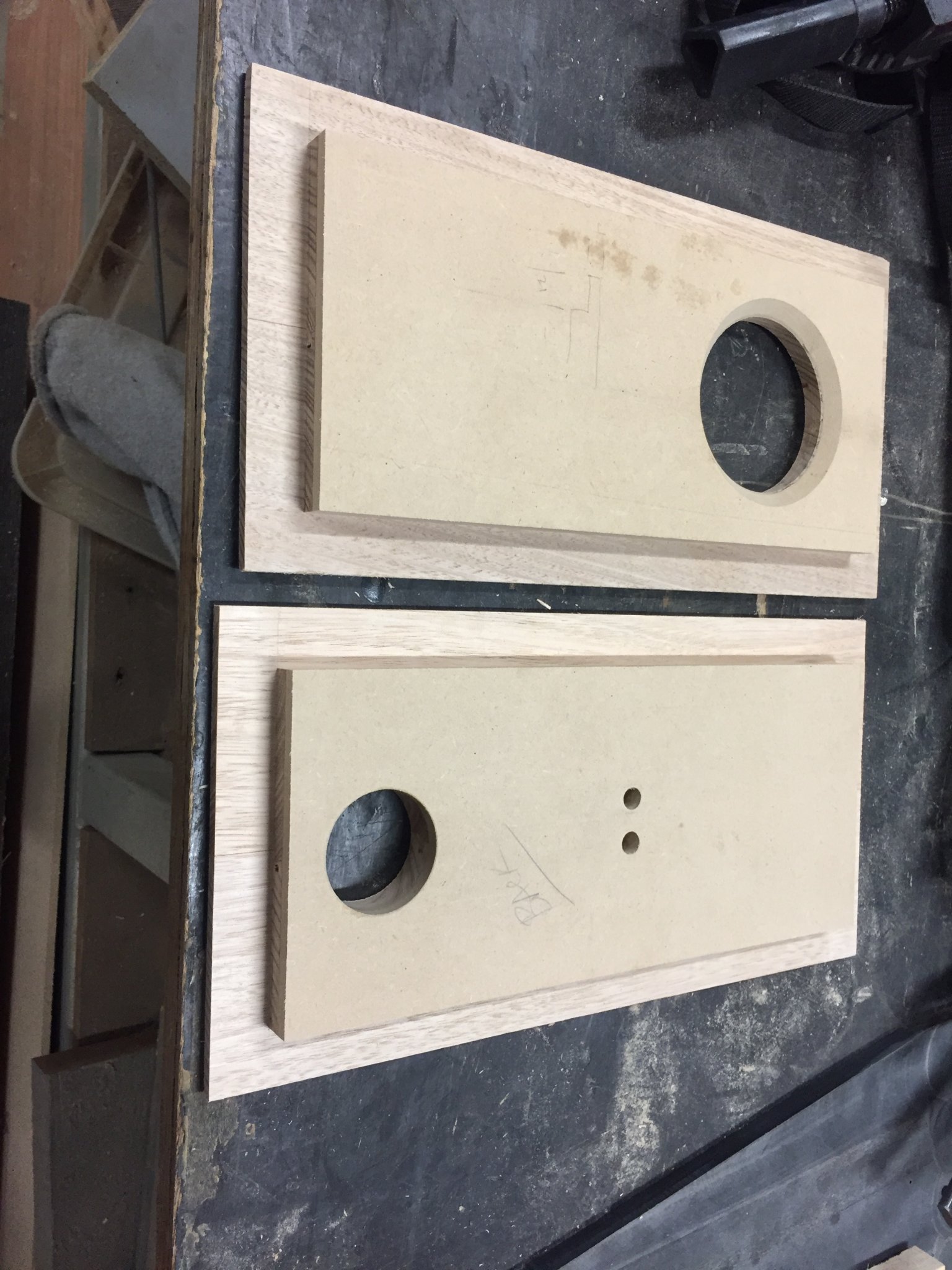

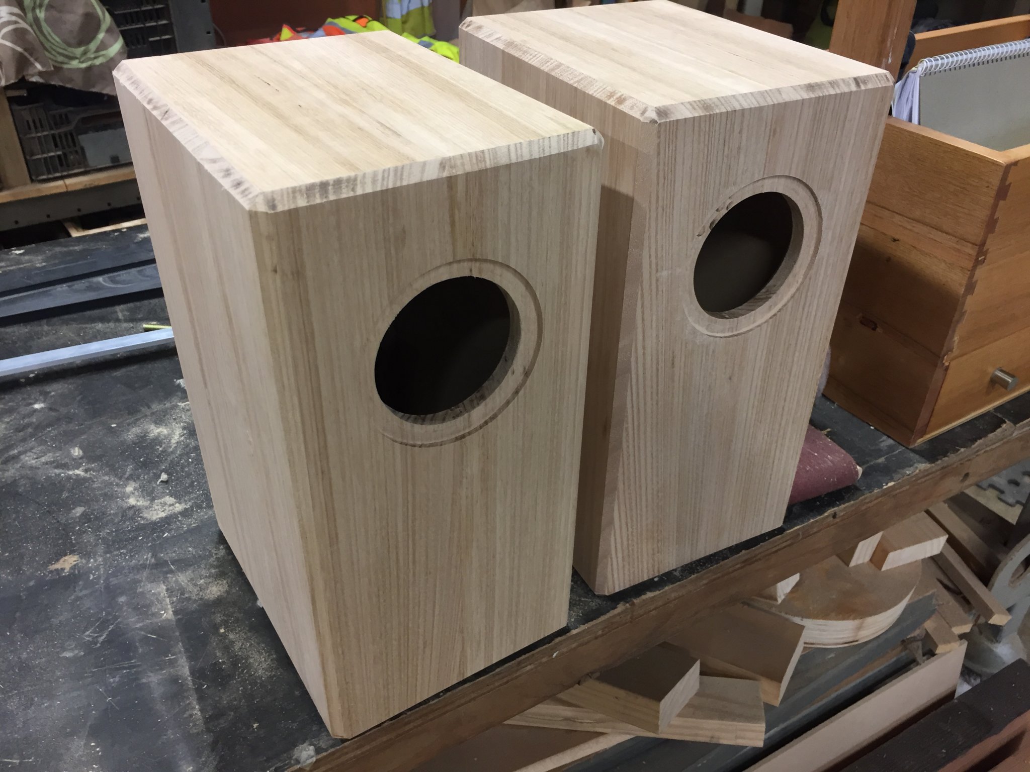

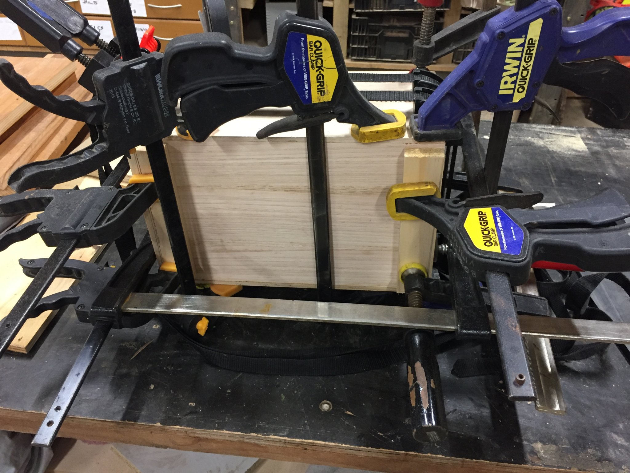

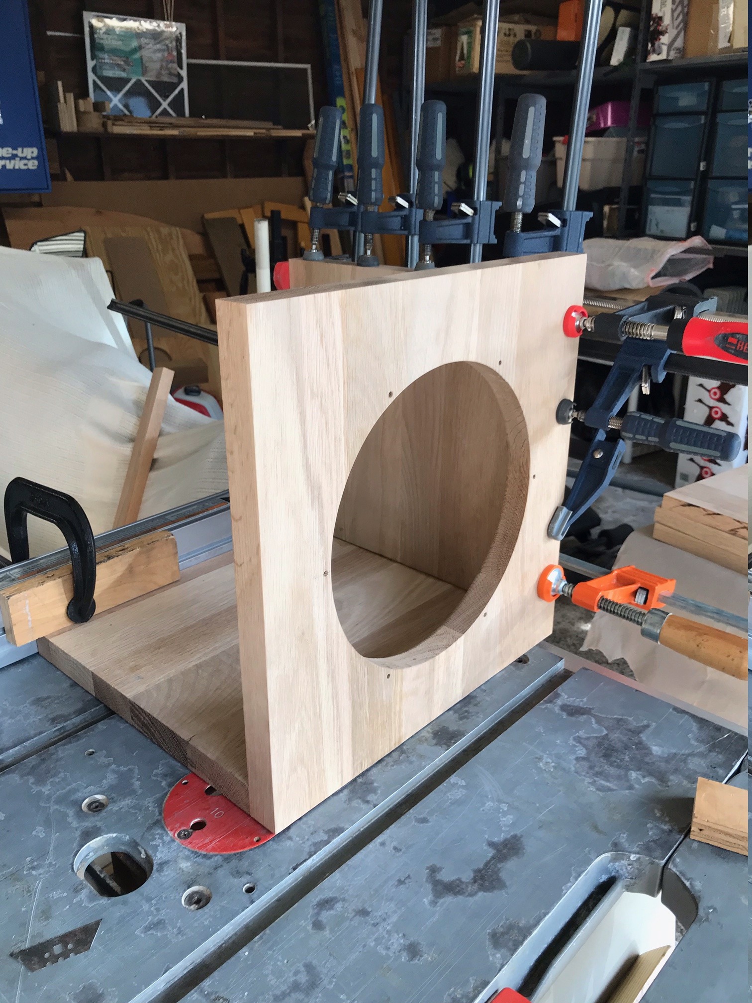

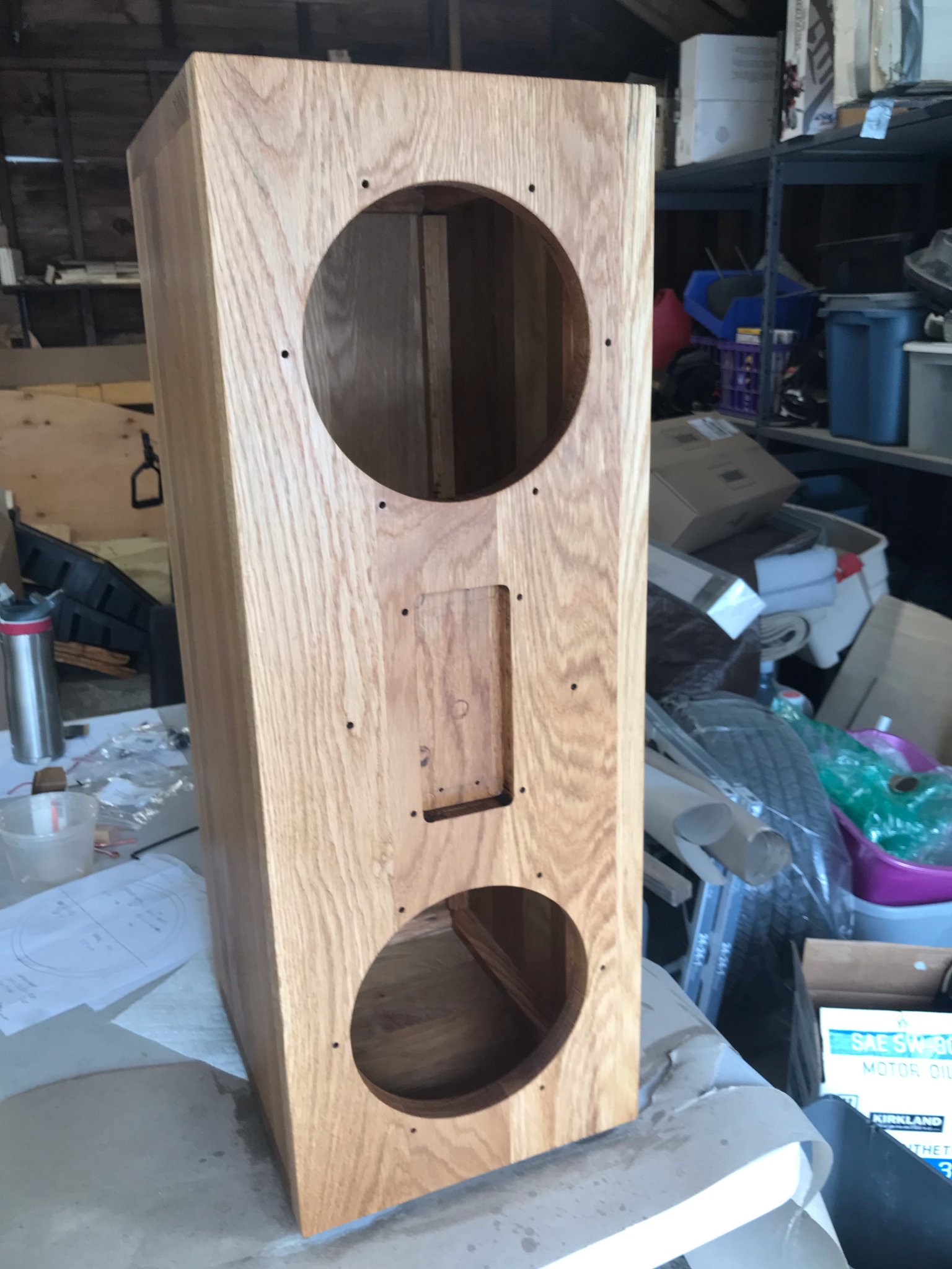

As mentioned previously, this is my latest speaker build. A pair of full range with 4” drivers, the timber is Tasmanian Oak planks 14mm thick with 6mm MDF adhered to the inner surface, all surfaces glue fixed with Titebond wood glue. I’ve applied a stain to them this morning, clear coats still to come.
How is the cab finishing coming along?
Staining solid oak brings great satisfaction.

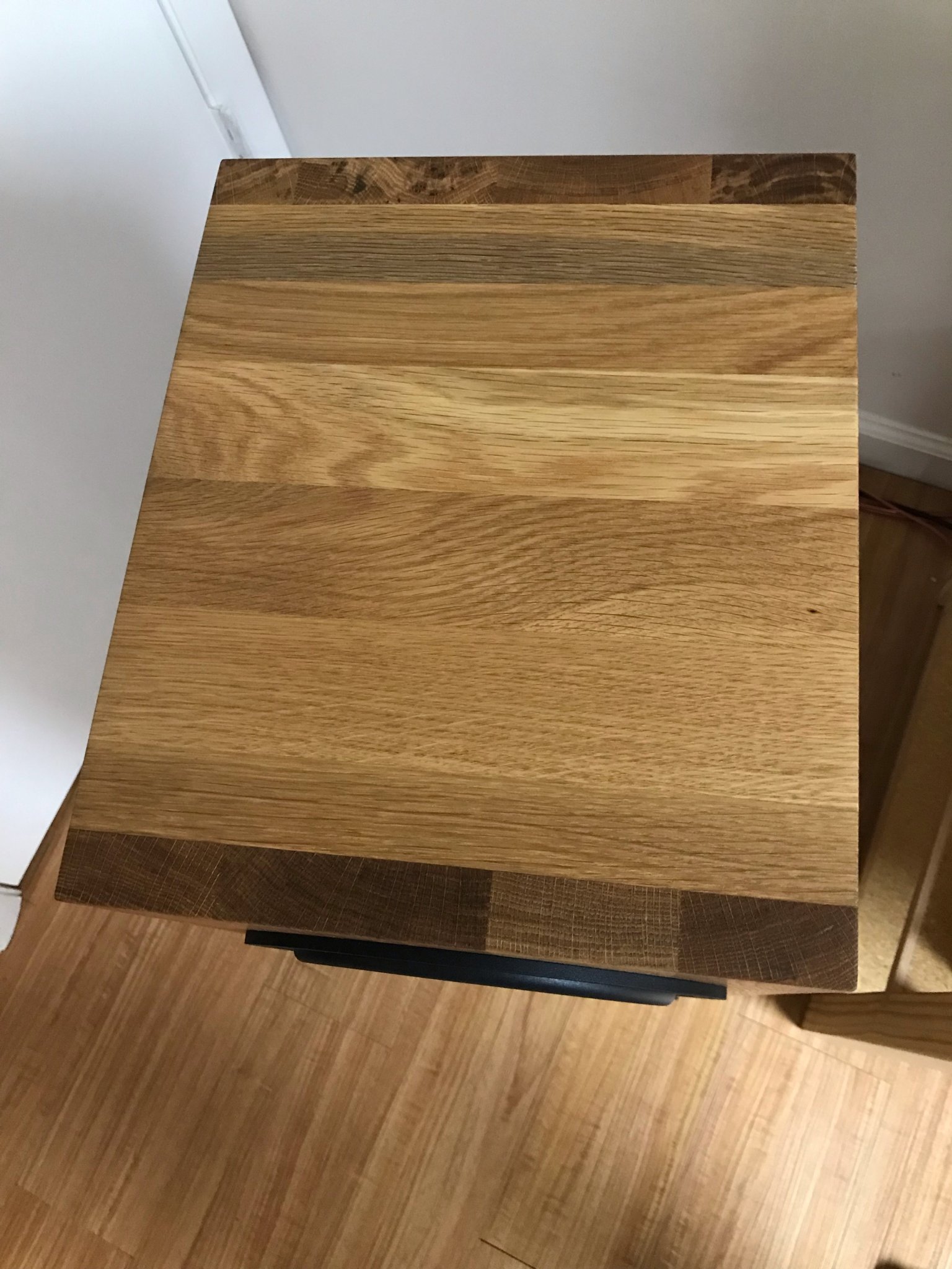

For my last two projects I used laminated white oak boards - as an experiment. The boards were 1" thick, 11.5" wide and available in various lengths. They are sold as "stair treads" here in the USA by the home improvement stores. I was happy with the results. The cabinets are rigid and sound good but also very heavy at 45 lbs empty. After a very dry winter I have some minor cracking to deal with, but that probably could have been avoided with a varnish finish instead of the Danish oil that I used.

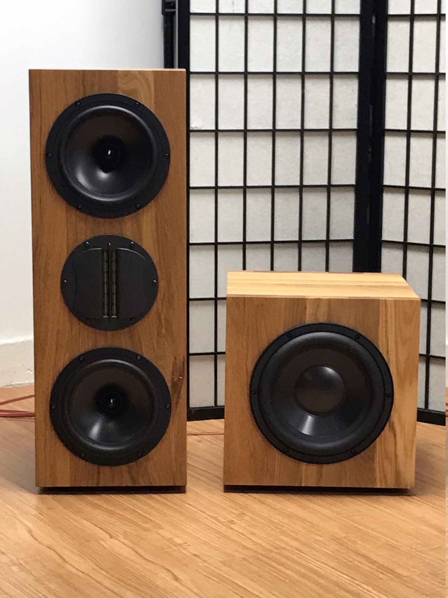

I built my cabinets out of 3/4" MDF, braced internally with additional MDF pieces dependent upon cabinet size, then typically finish them with another layer of 1/4" or 1/2" baltic birch, oak, or cherry plywood for added mass and for appearance. I find MDF an ideal cabinet material.

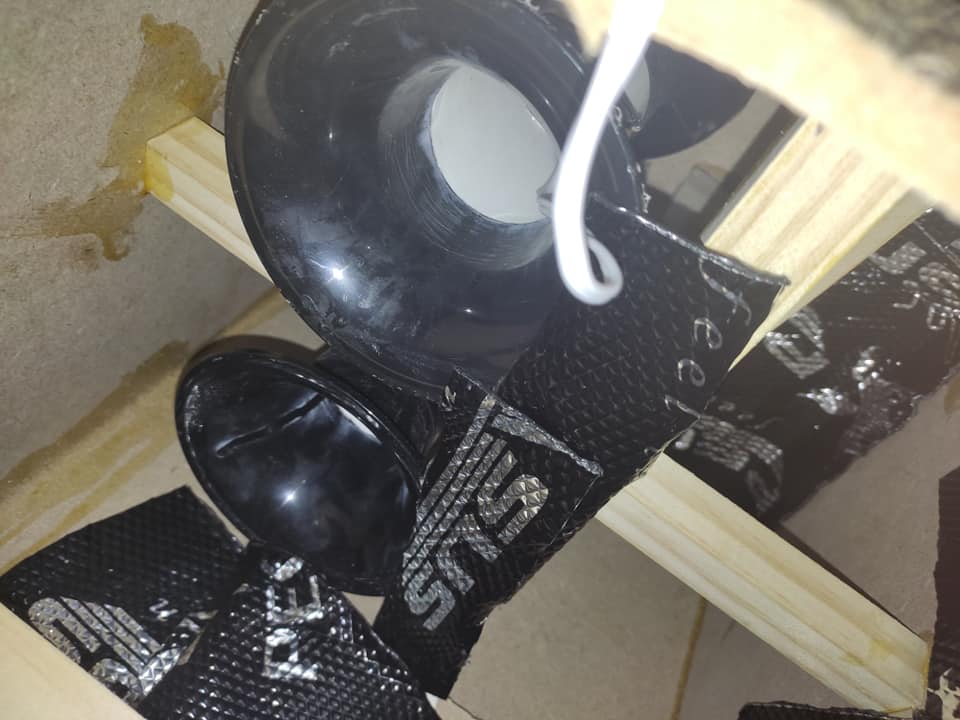

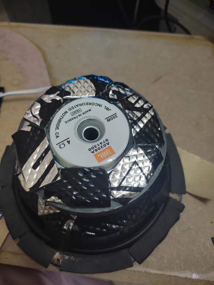

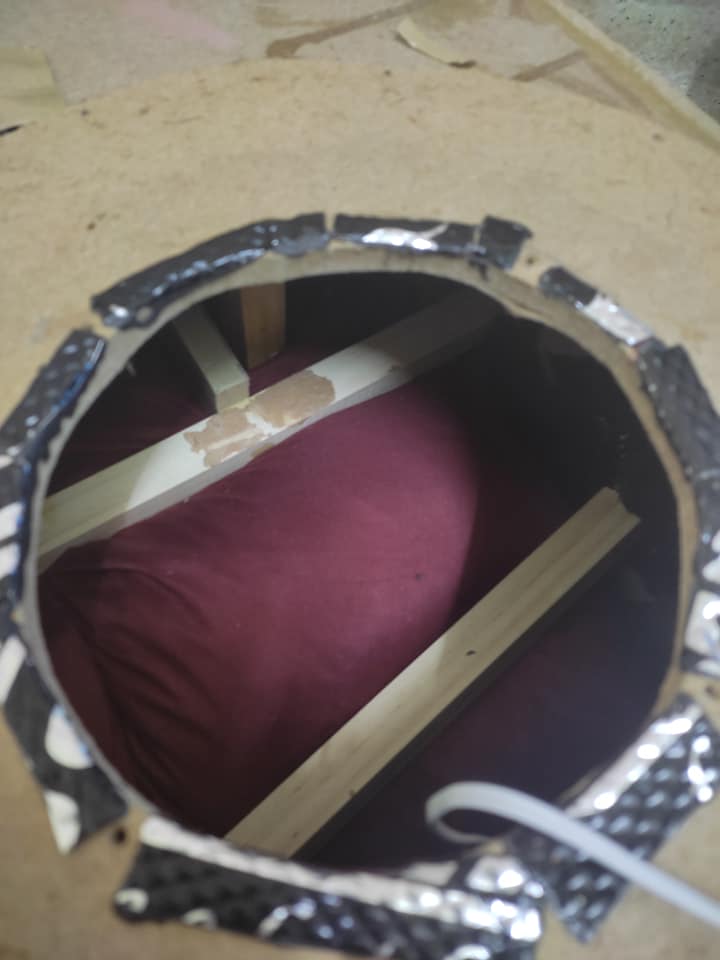

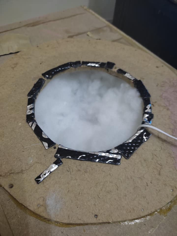

yes agree ... and the resonant can be reduced significantly by adding damping material such as sound proof sheets and polyfiber (and maybe few smaller pillows) they work really well ... shown below is my subwoofer project for a 6' cheap driver ... damping material and polyfiber all over the place and some soundproof around and on the driver magnet made the whole box almost resonant free (the MDF itself only 9mm thickness) ... during testing on the raw stage( no bracing no damping no treatment) even using MDF it resonates badly) .... i ended up using MDF for almost all my projects due to nothing better than thisEverything is resonant MDF included.

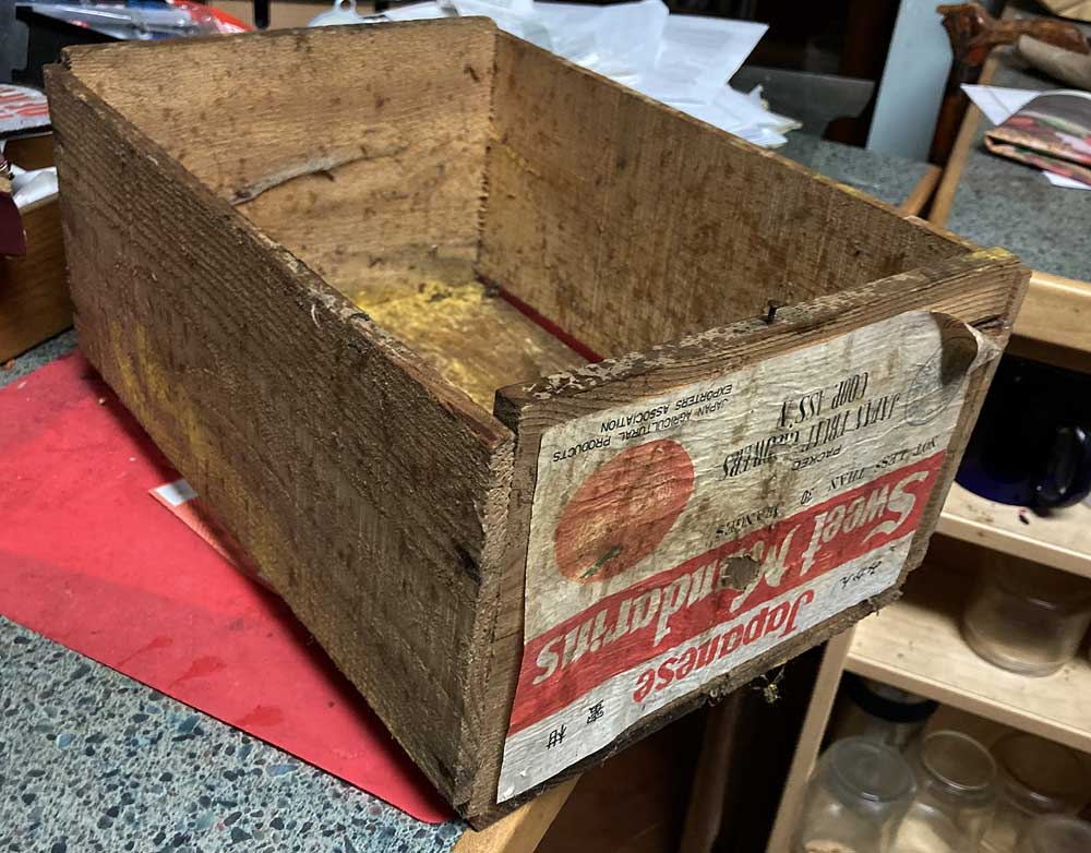

I am sure many have little clue of what i speak. My dad was a bit of a hoarder. Going thru the dregs of his stuff i found this, likely some 55 years old.… mandiran orange boxes ...
