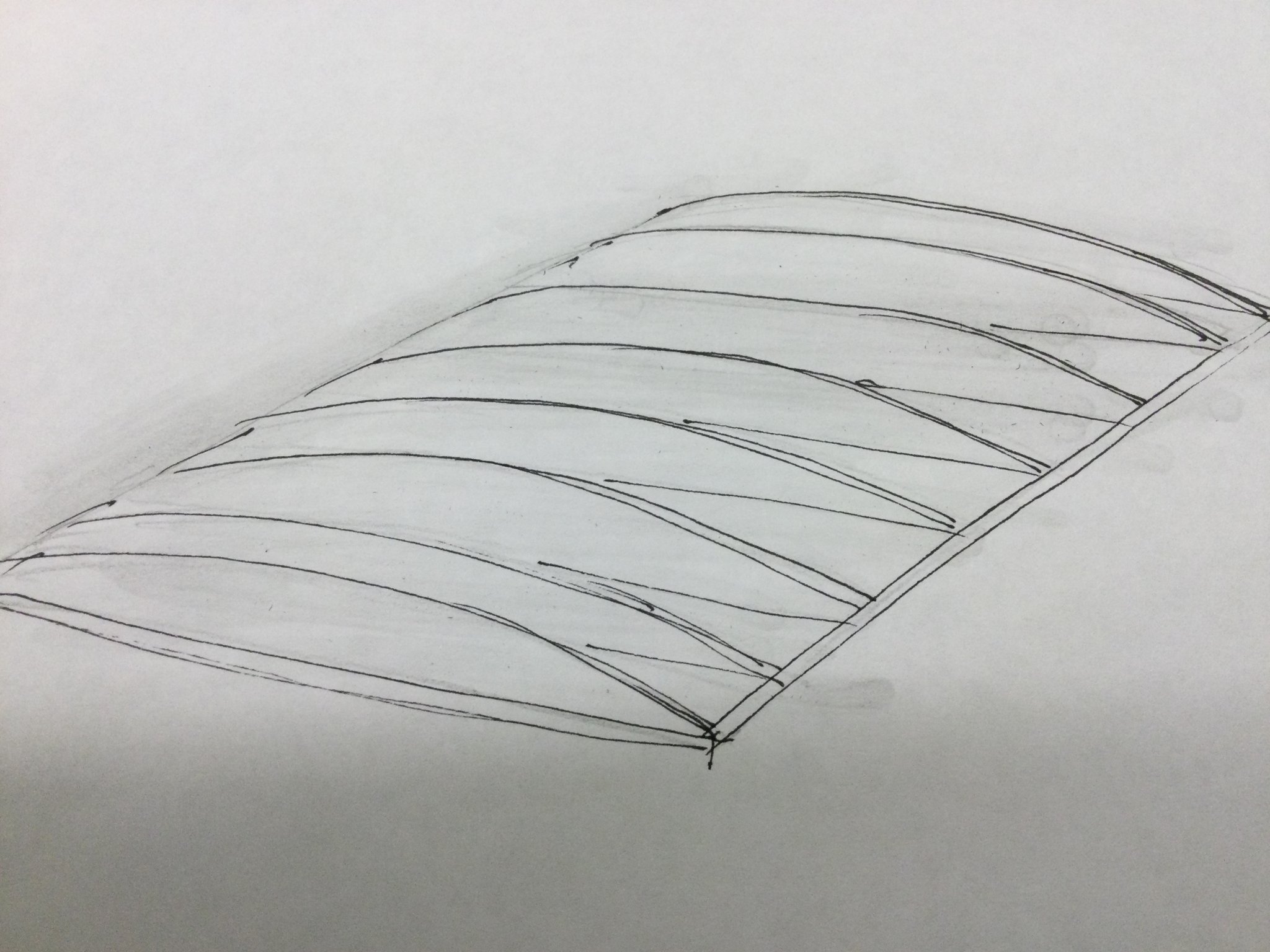

I’m more interested in bookshelf size enclosures rather than the large floor standing ones in Dave’s pics. I would cut a number of ribs and cut the desired radius on one edge, attach these to a board (something like the rough sketch below) the size of the former needs to be larger than the finished piece. I would include a timber strip along the underside of the curved edges so the clamps won’t slip off.Car panels are curved for stiffness among other things, so yes a curved ply or anything similar will be stiffer...

The actual laminating will take a bit of experimenting, my first thought would be to laminate the layers together flat, clamp one edge on the jig and work the ply over to the other edge while the glue still has slip. Two pairs of hands would definitely be required plus a lot of clamps.
Alternatively, layers could be applied separately by screwing them along the edges, offsetting the screws and allowing cutouts for final disassembly.
