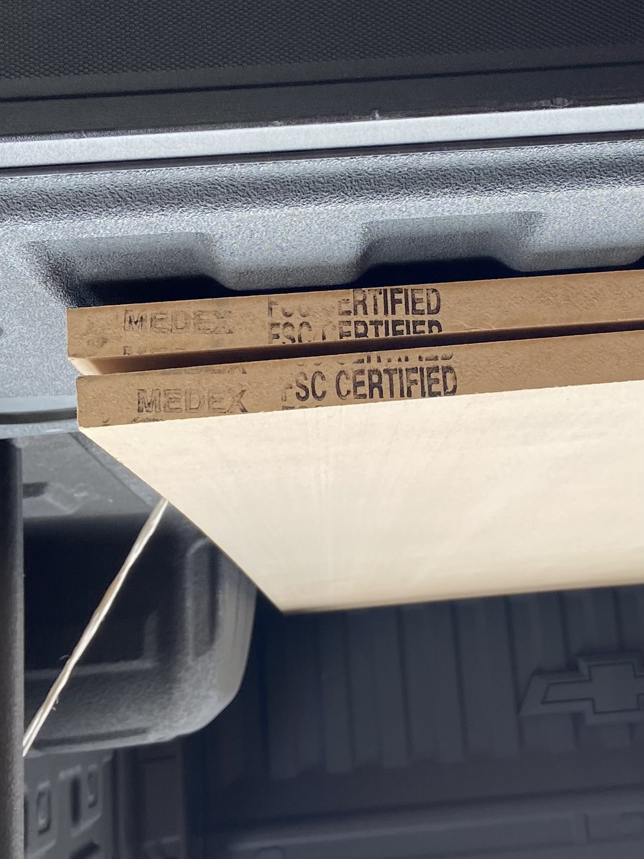

MDF, so many grades out there. A large box store chain ad cut/pasted a premium grade photo on their website and I went running down there.
Getting a good laugh now because it was the worst recycled cardboard product I've ever seen.
That was enough for me to order this wonderful product, MEDEX
Cost $111 vs the box store recycled cardboard at $59
[Was able to squeak out 4 boxes from one sheet]
There is a mom/pop lumber yard around the corner, they were sell a high grade mdf shelving board 12" and 16", almost as good as this.
They may have sold it all by now, next week I'm going back up and look for old stock, sample in hand!
- Moisture resistant
- Full 3/4"
- A solid/dense product
- Machines beautifully
- 1" oversized

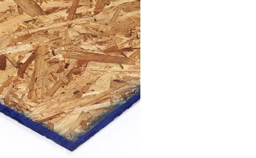

Has anybody tried oriented strand board? IIt might be a cheap alternative, half way between MDF and plywoodI have been thinking about it for my next project.
It has been used. In particular i recall Variac’s big BOFU BIB(?). It could have been one of the other big BOFU boxes.

I have heard osb tends to not be airtight. So it may need some kind of airtightening (lacquer).oriented strand board

I've used It. Much more rigid than mdf, close to plywood. There are different grandes, the best is OSB 5.Has anybody tried oriented strand board? IIt might be a cheap alternative, half way between MDF and plywoodI have been thinking about it for my next project.View attachment 1045686
Main problem is finishing, especially the edges. Routing and sanding carefully helps.
If you dont mind a rustic finish, go for It.
