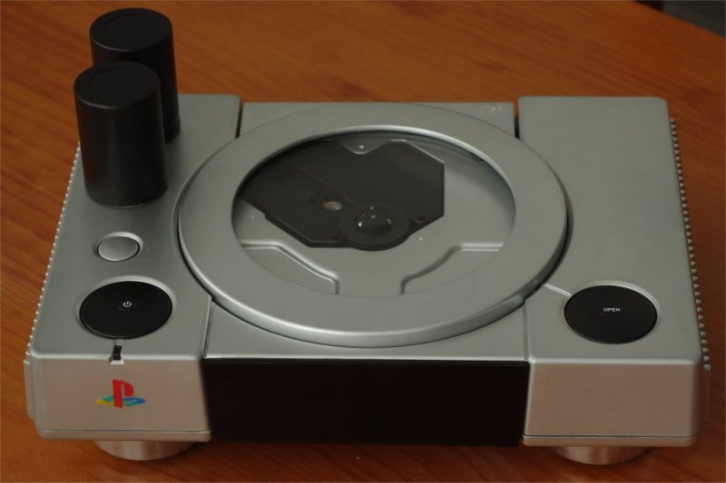

I'd do it by adding a mute circuit, ON by default, that would be turned off by a long sound provided as input (the Sony sound).
It works also on 1002, as any PlayStation with parallel- & serial-port.
That 7502 is my "devmachine", saving 1002.
Next step is to make it boot from cartridge without pc.

Boots from cartridge, but needs bootdisc (any official blackdisc).

Small step.
PlayStation CD-player with LCD, in progress pt.3 - YouTube
No need for PlayStation Controller.
Buttonboard from some old monitor connected to Arduino.
Arduino sends commands over serial to PlayStation.

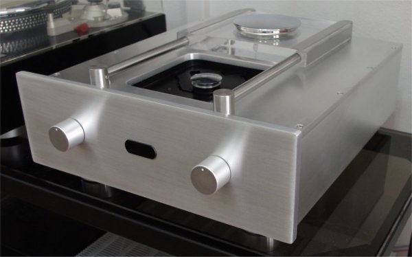

Recently picked up a Shanling scd-t200 with reading issues. My plan is to transplant a scph-1002 in it. Any idéas for button config or reusing any of the original shanling circuits?

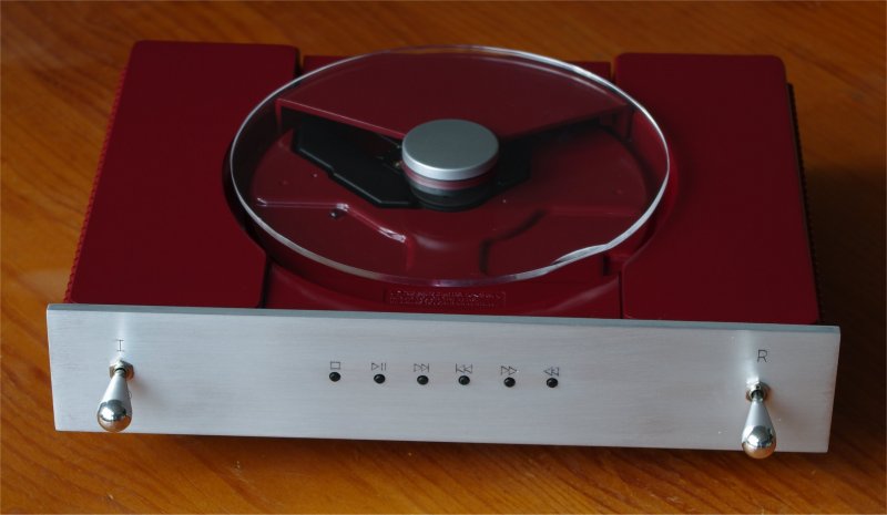

anyone know what are the values of the potentiometers in the motherboard pu-8?
i not speak english , translated by google
Ps1 SCPH-1001 PU-8 Rev2 March 1996 with new KSM440-BAM at 24.4mV

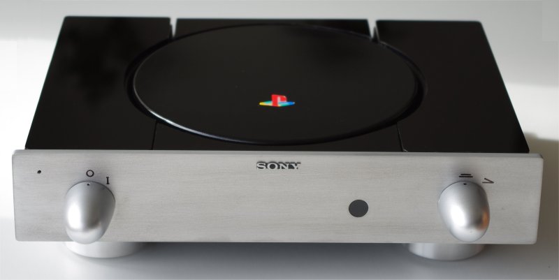

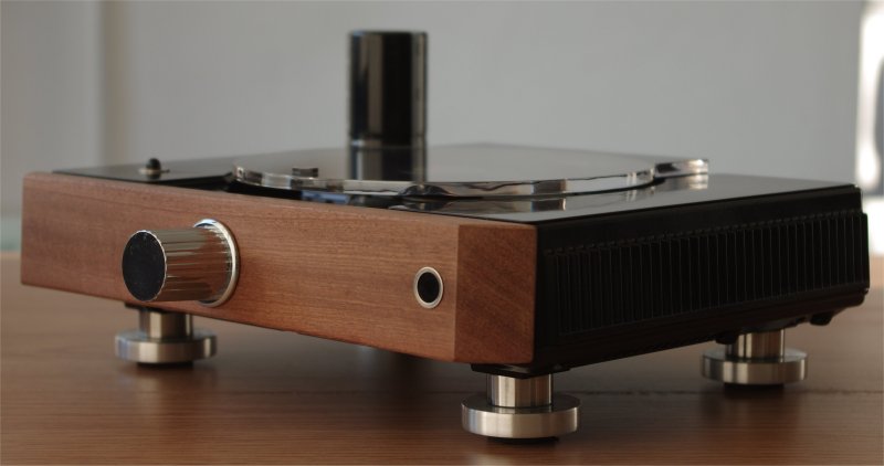

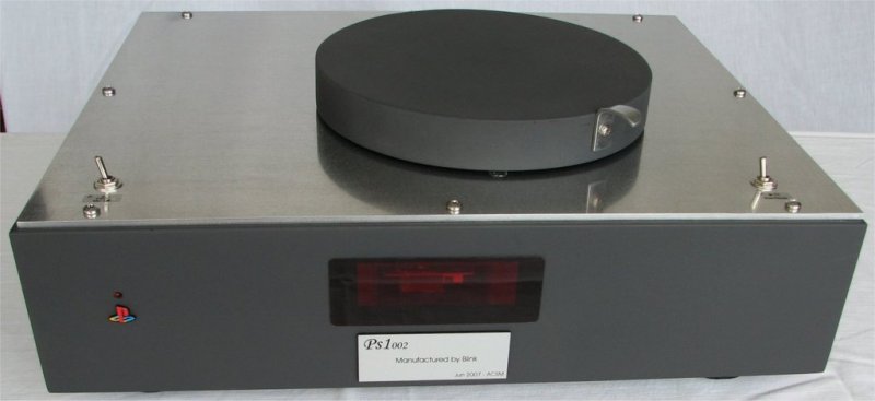

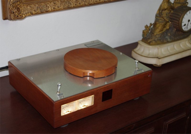

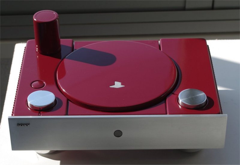

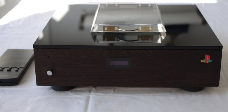

All playstations that will build up to date ...
- Digital Source
- Playstation as CD-player
