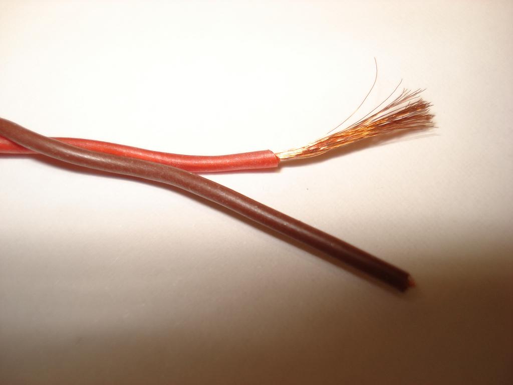

Hookup wire affecting sound?
Marvin,
Over the years I have found that different conductor materials, dielectrics, and geometries (as in single strand solid core, multi-strand, etc) have a profound effect on the sound. Silver conductors can sound very "fast" (although they aren't fast, but they seem to get out of the way and perturb the electric field less), as does Teflon dielectric. Try some regular stranded (small gauge) copper wire and compare (you have two that are identically wired so a comparison would be easy).
I think you may find that copper sounds more "analog" compared to silver. This is just an observation though. I know there are plenty who would digress. The same can be said of solid core vs. stranded wire.
My favourite wire is a very cheap and good wire, sometimes sold at RadioShack: 30 gauge stranded silver plated Kynar. A pretty good compromise, it sounds "quick" and clean, yet retains the copper characteristics. About $10 per 100'. I've used it in tonearms, interconnects and signal carrying internal wiring in diy projects. I have never felt the want to change.

For all my work, I take French copper, for tonearms, i take it in 0.14 mm²

wire?
pixel: no probs
Cochise: 0.14 mm² is between 25 AWG and 26 AWG, so we agree on the basic dimensions (I suggested 30 AWG, but 28, or 26 would be OK as well. 30 AWG is what I've used, that's all)
pixel: no probs

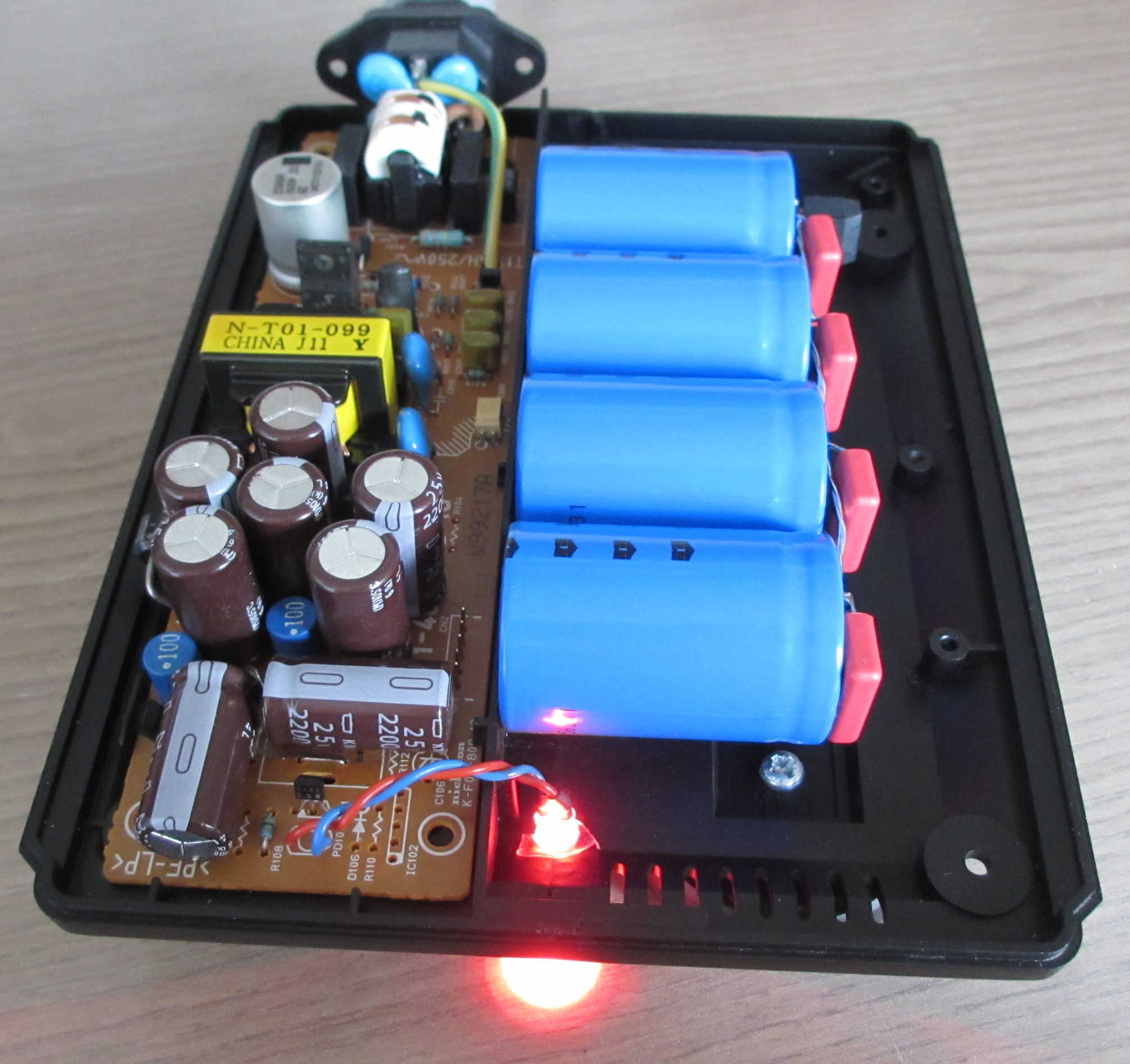

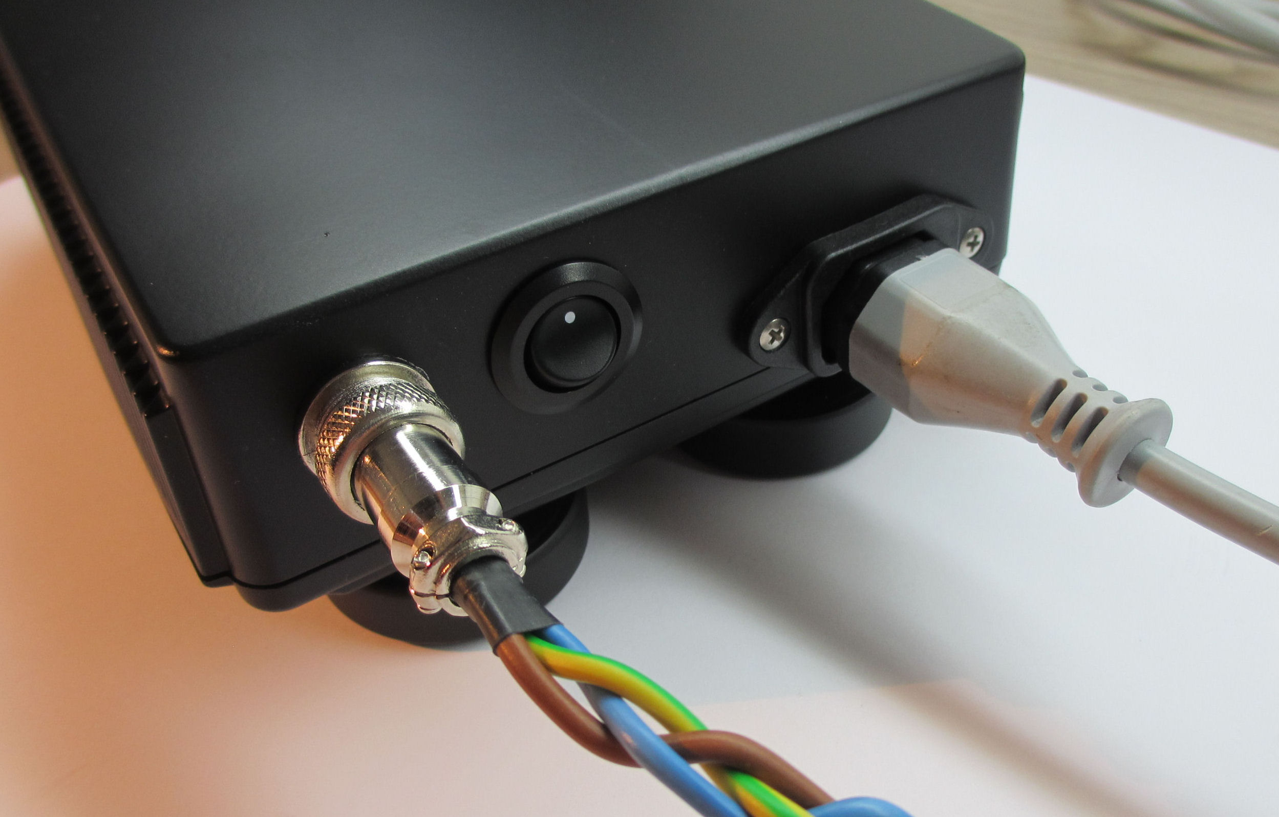

NEW´s from Mr. Manfred
he has a new external power PSU with Sony Design for his Playstation 1.
A detailed sound description will be developed shortly.
Neuigkeiten / News Playstation 1 SCPH-1002 High End CD Player deutschermanfred.de
