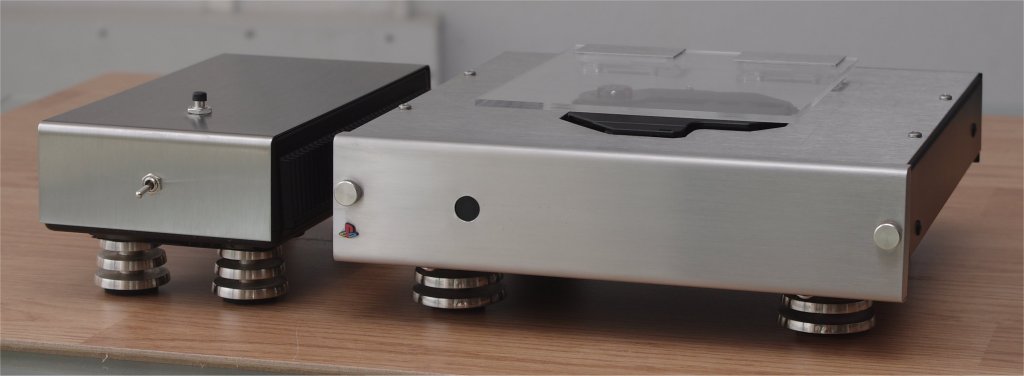

Hi everyone!
Thanks to this thread, I've managed to get a 5502, planning to mod it.
So far, listening through it's multi AV connection, it sounds great but comparing it to my m-audio 2496, there's one thing I'm not happy with: hiss noise. It's clearly noisier than my sound card, just the hiss.
Other than that, the sound is really promising.
My question is: anybody thinks that applying the output circuitry mod will lower the noise?
Or maybe it's from the power supply and I have to replace it with a linear one?
Many thanks!

I wish to use top end capcitors, can anyone instruct me how to and obtain Mundorf Mcap on the PS1. I see the tutorials on that site, but I've seen some really nice setup here on this site. I hope some of you professionals can show me some detailed pictures and what I need to make this project work. 😀

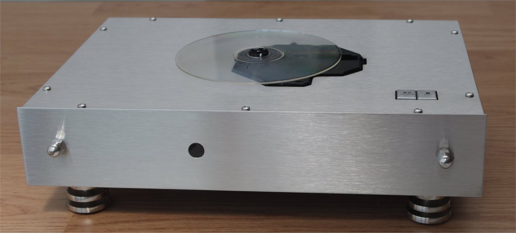

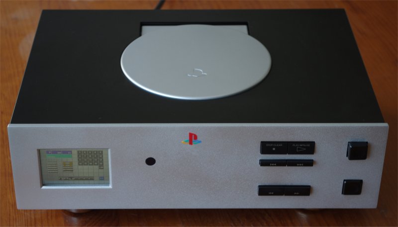

PlayStation CD-Player, May Day 2013 release
Download: PlayStation_CD-Player.May_day_2013-SCPH79.zip
PlayStation CD-Player, May Day 2013 release - YouTube
PlayStation CD-Player with 16x2 lcd-display
PlayStation Serial -->-- MSP430 -->-- HD44780
Burn cdplayer.cue to cd with ImgBurn.
You need modchip to boot burned disc on PlayStation (or use swaptrick, or some other way..).
Use Energia IDE with MSP430 LaunchPad to program your microcontroller.
Controls, Gamepad 1:
X - Play/Pause
[] - Stop
R1 - Next track
L1 - Previous track
R2 - Forward
L2 - Rewind
Start - LCD Timemode, Track/CD
Select - TV mode, PAL/NTSC
Files:
PSCDDisplay/PSCDDisplay.ino - Sourcecode
PSCDDisplay-schematic.png - Schematics
cdplayer.bin - cd-image of CD-Player bootdisc
cdplayer.cue - cue for cd-image
readme.txt - this file

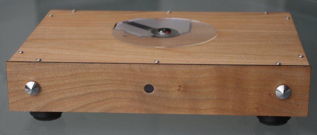

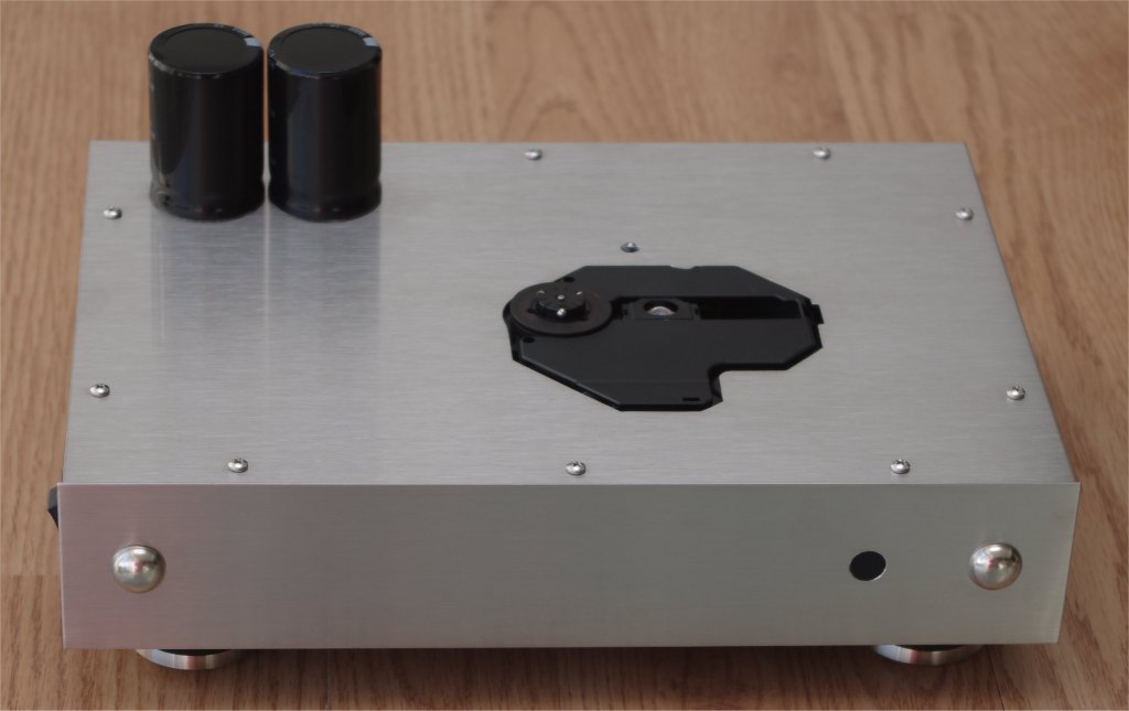

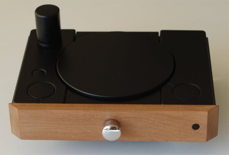

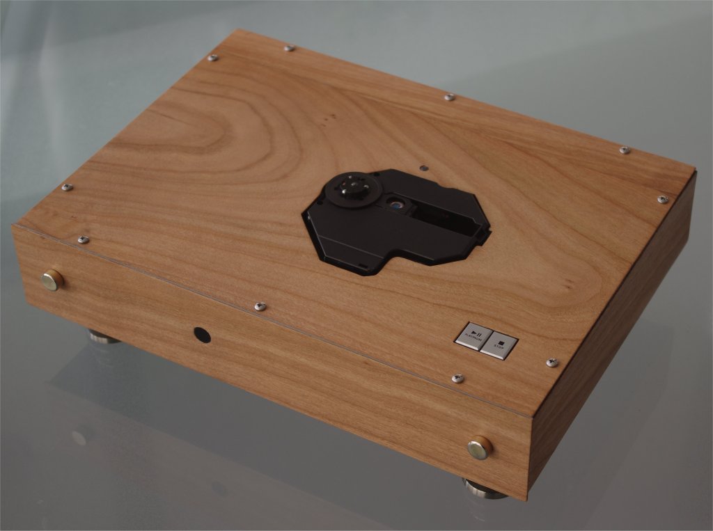

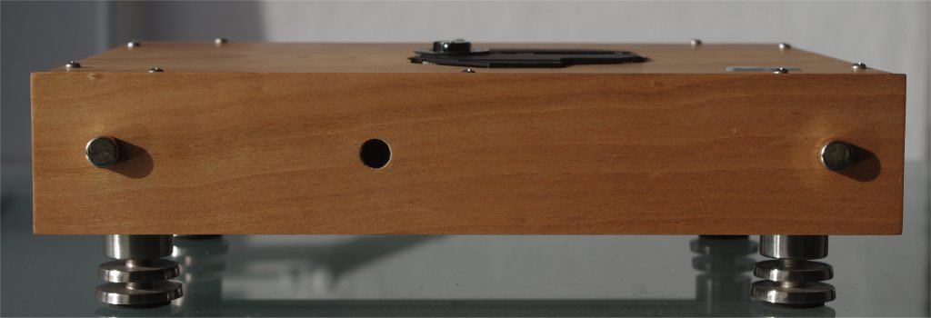

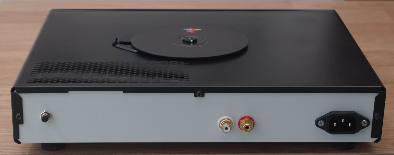

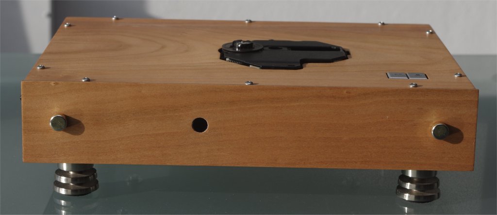

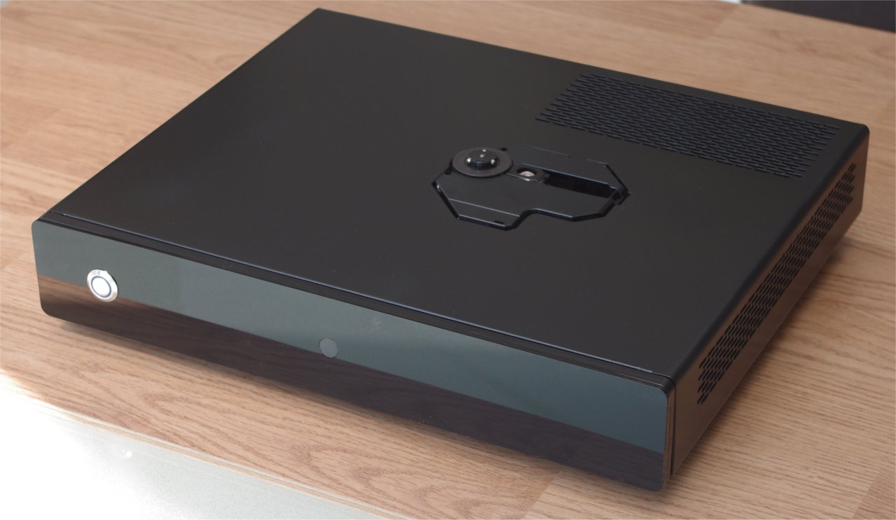

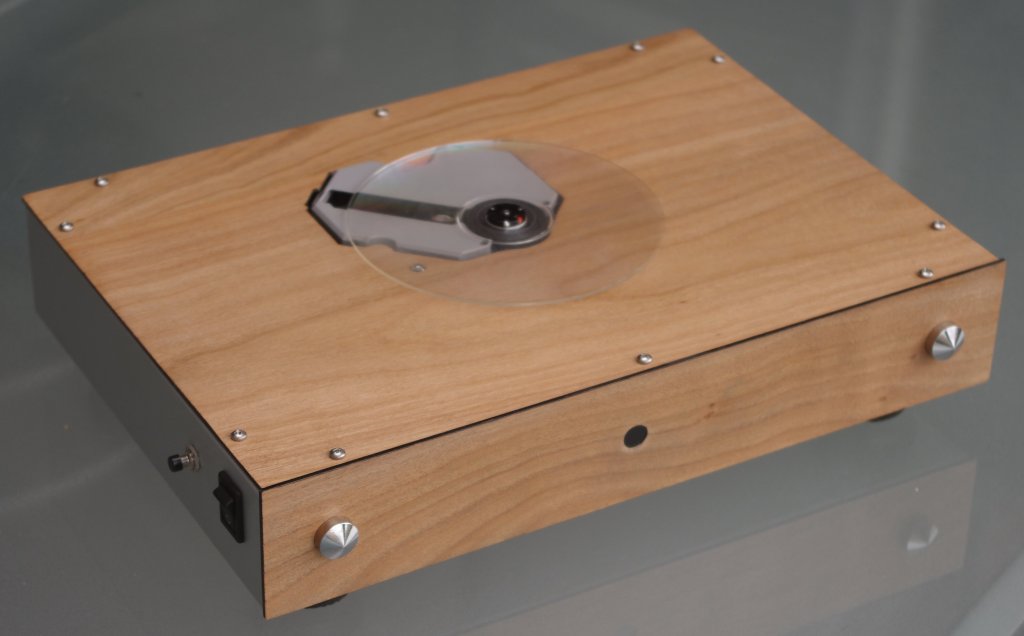

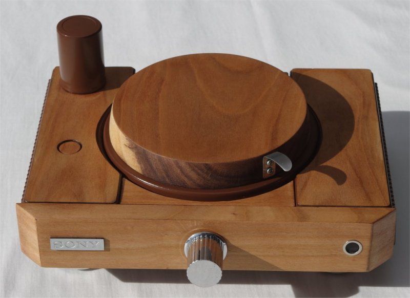

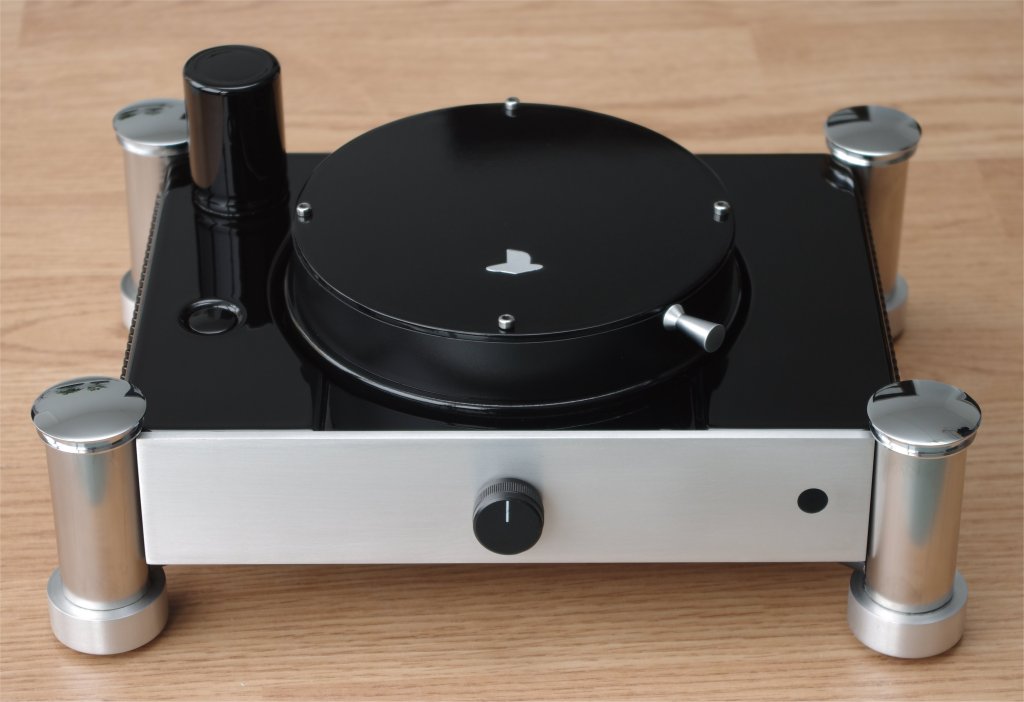

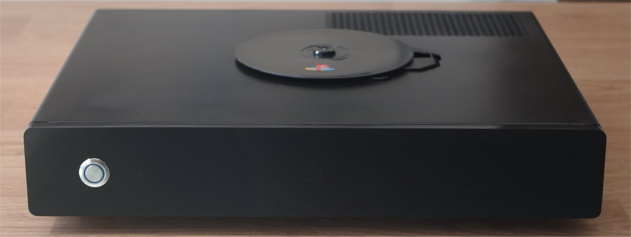

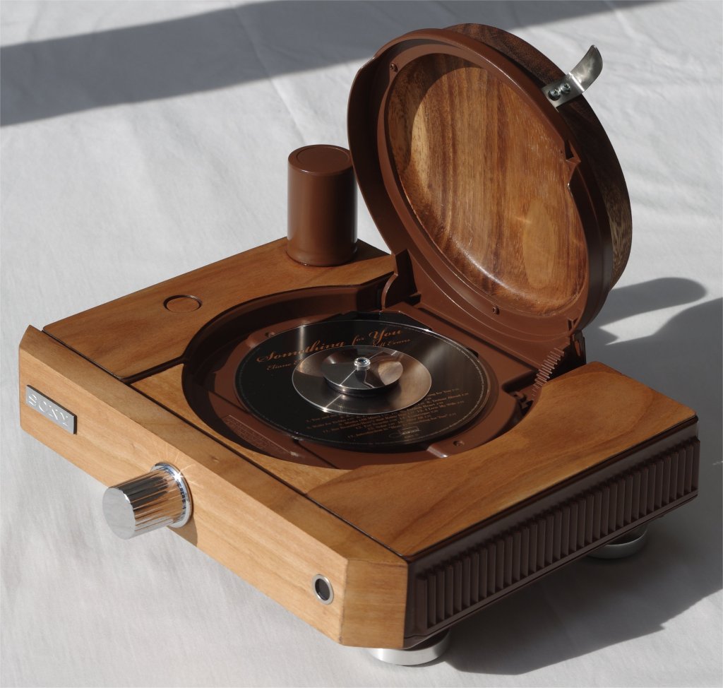

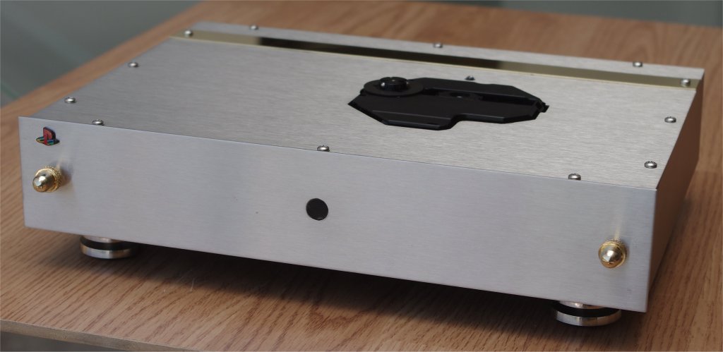

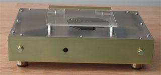

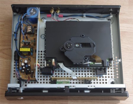

My last job.
Very nice and excellent work !!!
What did you build inside?

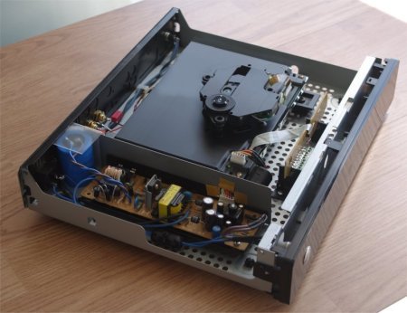

The modifications required for sound quality....
Thanks a lot for the nice view inside.
