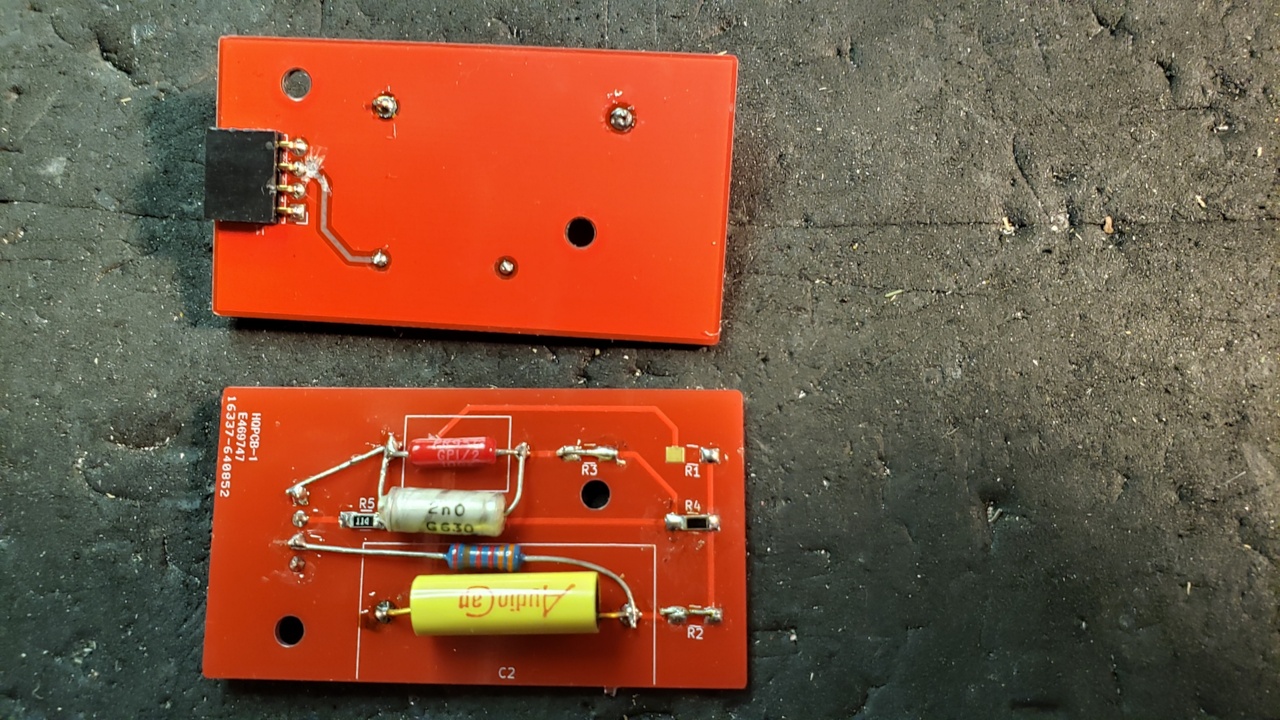

One more thing...to any of you guys that bought the cards and transformer but haven't built it up yet: if you'd like to sell the set, I'd like to take it off your hands, and I think DIYspaceW might also.
One member responded to this and offered to sell me his completed unit. So now I have a working version, but have only had a few minutes to listen so far.

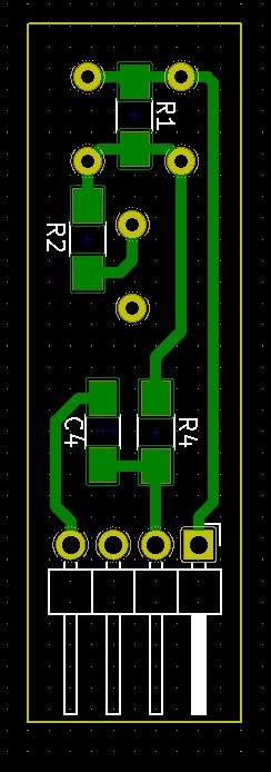

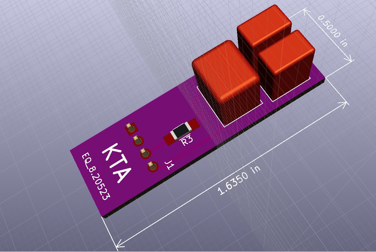

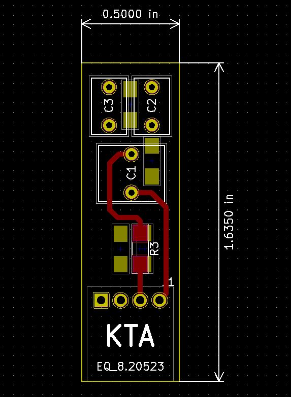

REV.8 Strain Gauge EQ
I do not recommend implementing the EQ in the previous post, that design has an unintended effect on the low frequency response - very bass shy.
For those interested I have a new EQ that you can experiment with and am in process of getting some real boards made to test in my pre-amp. I am going to release the Gerber files for these boards and you can go to Oshpark and get your own made for roughly $4.00

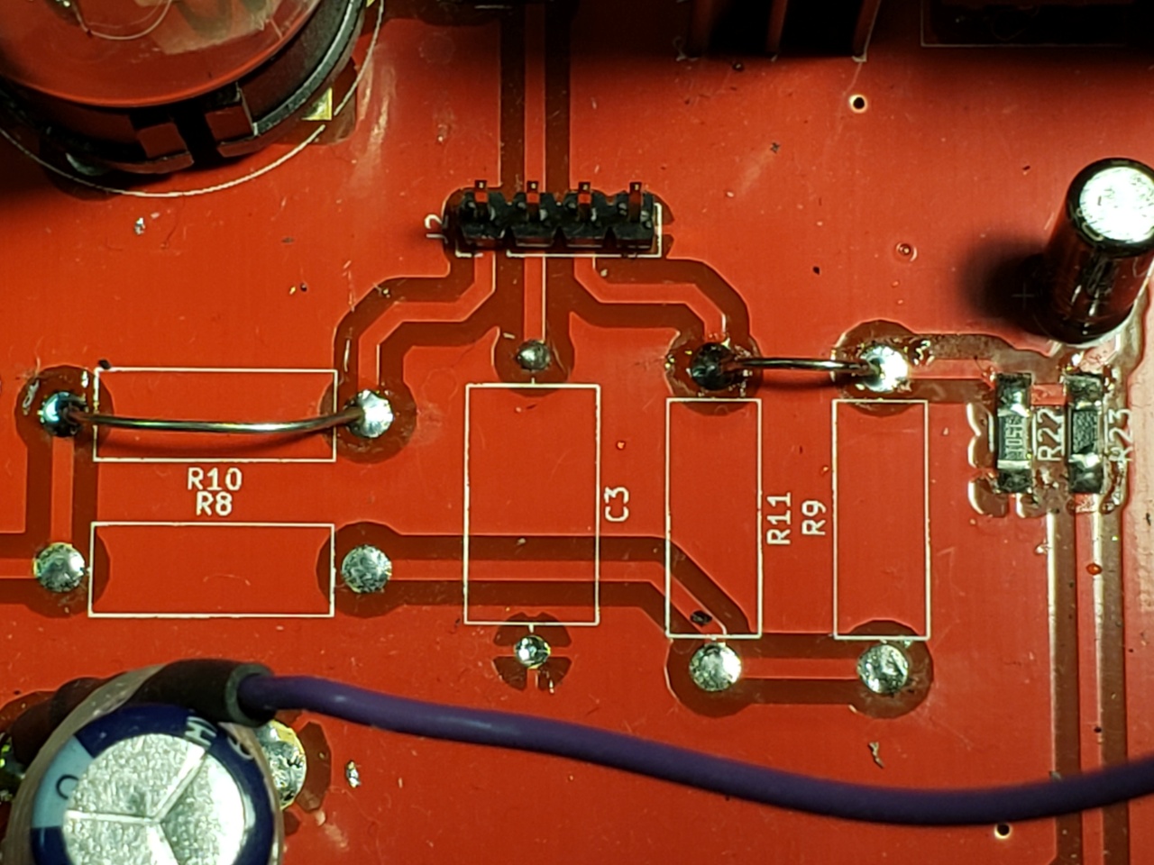

The new filter requires some minor rework to the pre-amplifier card which consists of removing R8, R9, R10, R11, and C3. R10 is jumpered, and there is a jumper from R9 and R11.The EQ will now all reside on the EQ card, except for the final LPF which relies on the rather excessive miller capacitance of the succeeding triode amplifier stage to do its job. (Fortunately that value is not extremely critical.)

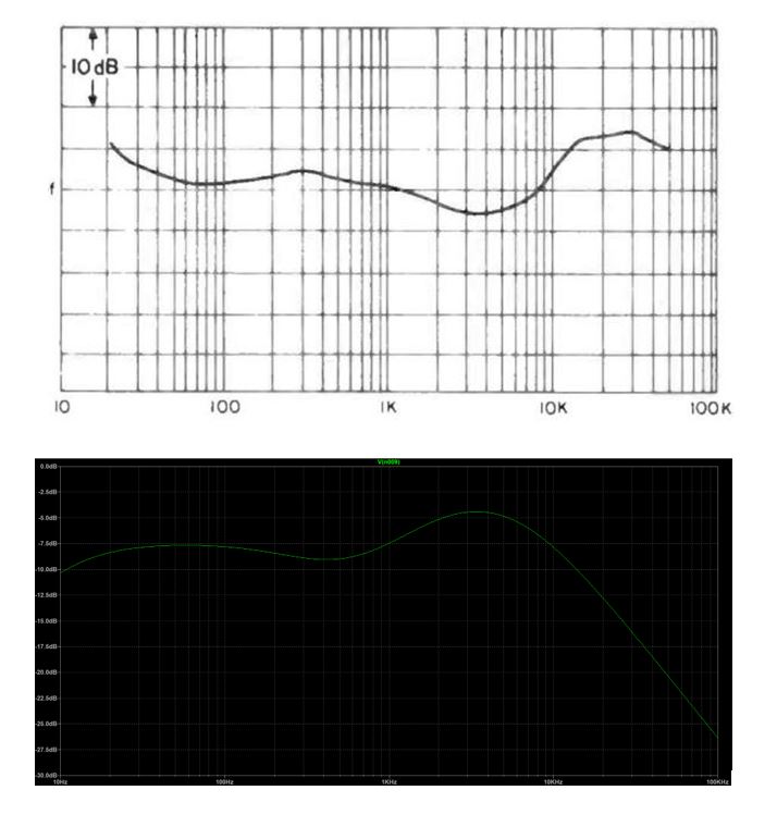

I'm a lot happier with this EQ than I was with the prior. I will probably continue to improve the EQ where possible.
Basically low pass step filter between 0 - 200Hz, a high pass step filter between 500Hz - 1.8kHz, and an LPF at 5kHz. Coupling capacitor choice provides about -3dB at 10Hz high pass to partially compensate the cartridge's rising bass response below 50Hz.
Note1: I don't recommend reworking the EQ card to implement this EQ as it is a kluge at best. New boards from Oshpark are nominal cost.
Note2: Connector shown on bottom view of EQ board is wrong gender due to a library issue, but is correct footprint for the required part.
Note3: OSH Park ~ Just drop the zipped gerbers on this point indicated and they will do the rest. (Total will come to $4.10 if you just need one set and a spare..)
BOM added
Please provide feedback if you do the upgrade described in this post. Thanks! 😀

I'm looking forward to your feedback, I have struggled to EQ this cartridge, but I am happier with this than I was with the previous iterations. The simulations align fairly well with the known anomalies and at least partially correct them without screwing things up elsewhere.
I expect I will find the need to further fine tune over time. I just switched from an ET-2 with a 451CR on it to a prototype Sorane ZA-12 with a 465CR on it. Probably needs a bit of work there too.
The 465 has sat for 2 years since it was last used and they get a bit weird when the elastomers are not exercised for an extended period of time. I also suspect that they may have some sort of warm up time, I again suspect it is mostly the few mW of heat in the confined space just heating the elastomers a bit.
It's not quite a match for a Mutech Hayabusa on a TK-850L into one of my Muscovite Mini IV pre-amps, but it is very pleasant and relatively resolving. I can probably do something to better damp the cartridge.

I was previously using C2 = 0.1uF on the pre-amp board and simulations previously indicated that 0.068uF was a better choice to deal with the rising response below 50Hz. See the pdfs for the details, the first one contains graphs aligned showing the cartridge response (from long ago review) and the current EQ. The other is an updated schematic.
I think I slightly prefer 0.068uF based on a short listening test.

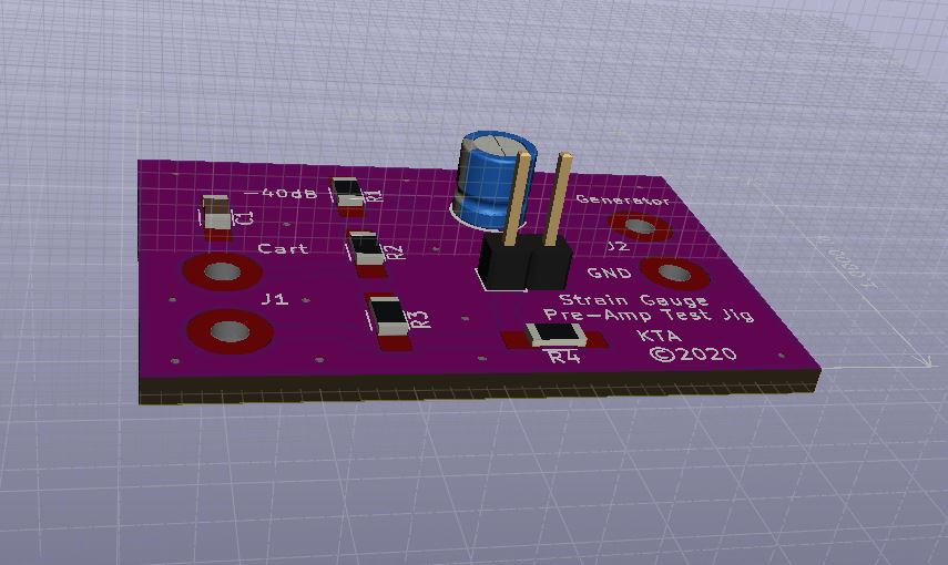

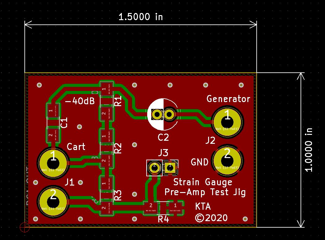

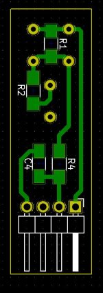

This is a test jig you can use for pre-amplifier measurements, while it is intended for use with the strain gauge pre-amp discussed in this thread it is suitable for use with others, and offers a reasonably accurate attenuation of -40dB if fitted with 0.1% resistors.
The Gerber Files are included and these boards because they have a fair number of vias will run $7.50 for 3 at Oshpark. They are intended for personal use. (zip file)
Values, tolerance and recommended manufacturer for parts is included in attached schematic. (pdf file)
1 100 mil 2 pin header and jumper is also required. Gold pins recommended.
10 ohm resistor (R4) not critical as to value or tolerance. (1206 package)
Use BNC, RCA or any other means of connection preferred.
Solid ground plane on bottom, top ground plane is tied to bottom at multiple locations using vias.
