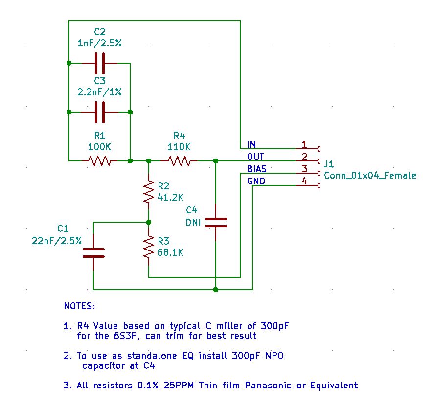

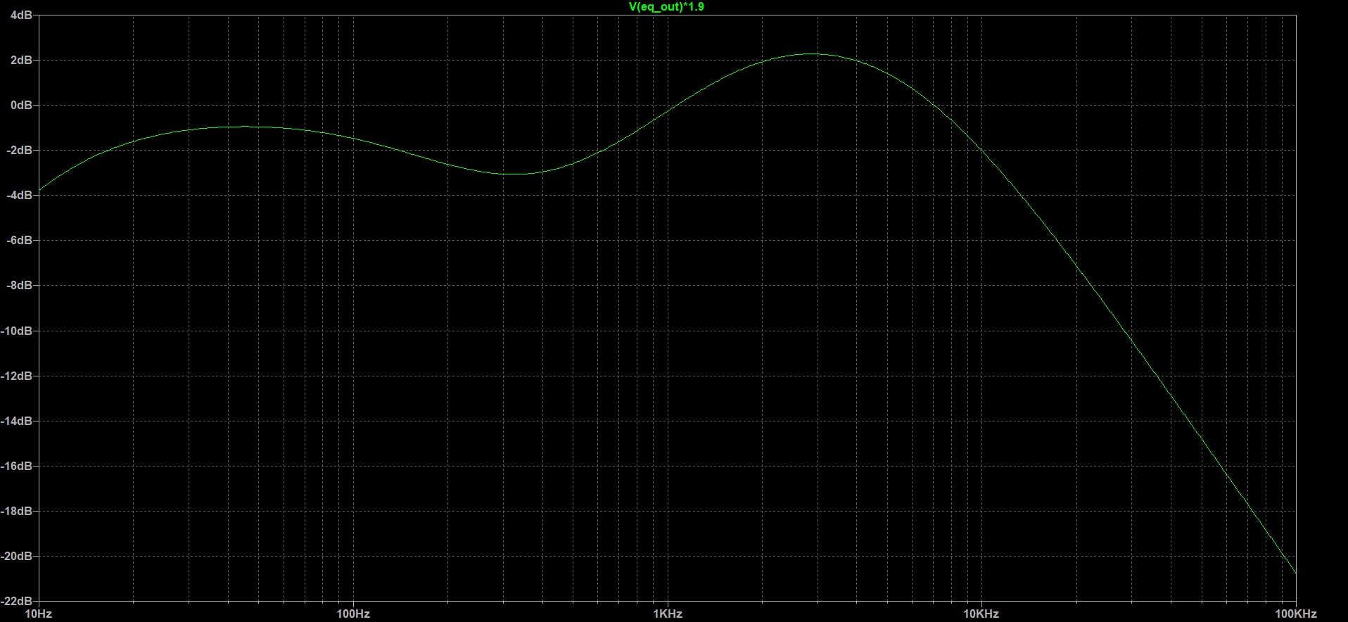

Here is the latest iteration, and I am finding the result very satisfactory indeed. I recommend R3 in the range of 56.2K - 68.1K.

I have the rig together and working, but it's a step or two behind your changes. All the changes on the main board are up to date, with C2 = .068. The EQ board has R3 at the original value, 36K5. I mounted one of my 451C bodies that I had never used before, with an original Panasonic Shibata stylus with very few hours. Ran it for a couple of hours to break it in. Blue-tac on the nose, no other damping yet.
My (very initial) listening impression tells me it's too bright. And my measurements show a broad peak in the treble of 3 to 4 dB. Low end is flat to 30 Hz, so I'm not in a hurry to change C2 on the main board. I'm using a test record with spot frequencies, 30 is as low as it goes. I have not yet built the test jig, so I'm not measuring the preamp itself.
My next step is to move R3 towards the values you're using.

My initial impressions were the same, adding C2 shifts the boost in the lower midrange downwards slightly, and made a surprisingly big and completely unintuitive improvement, also matches my target curve better.
R3 IMO needs to be 56K or higher for satisfactory results, and here is where it gets a bit tricky - I'm at 68K and that might be just a bit more than optimum, but it's certainly closer. I've struggled a bit with LF behavior in these cartridges because it seems to be heavily influenced by arm mass and how well coupled to the arm the cartridge actually is.

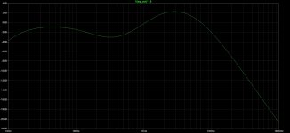

I used pink noise on an STR test record the last time I tested EQ which was several iterations back, even then it seemed to be in an acceptable range although I was never happy with the subjective result. (within a +/-2.5dB range except at the top where it rolled off a bit excessively)

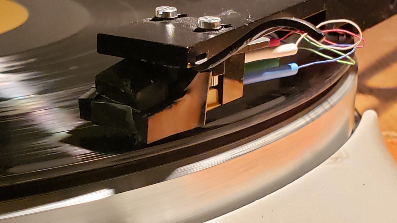

It's not pretty, but it does seem to work: sorbothane that is.. Specifically Isolate IT! 1/8" x 12" x 12" sheet - this stuff is really sticky, and more effective than the blue tack it replaced in damping some of the body resonances and cross talk.
The bodies of these cartridges are really a big weak spot...
