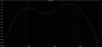

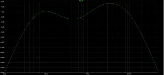

Improved EQ
I have felt for a long time that I never got the bass EQ quite right. In addition to that I made a change to the T filter circuit to improve the response in the region between 100Hz and 1kHz.
Four components need to be changed in total.
On the pre-amp card proper change C2 from 0.047uF to 0.022uF - this corrects the cartridge's inherent LF boost below 100Hz.
On the EQ card replace three SMD resistors R1, R4, and R5 with 49.9K 0.1% Panasonic resistors DigiKey PN P49.9KBCCT-ND
The most critical change here is C2 on the pre-amp card as it corrects the LF response which is excessive.
The other changes improve mid-bass through treble region response flatness.
These improvements were driven by other changes in my system as I went to fully active with six amplifier channels, electronic crossovers, and re-equalized the system. The bass response abberation which was tolerable (and very difficult to measure accurately) became intolerable with the new set up because the LF response no longer rolls off quite so early (the wonders of EQ)
See the myriad attachments for details.
REV.06 EQ supersedes all previous versions and the changes are recommended for all completed units as well as any currently under construction.
I apologize for jerking everyone around as I flounder through iteration after iteration of EQ.. LOL I'm still learning how to make these cartridges sing, and it's not an easy task. My measurement hardware,lab space and system have all undergone major upgrades in recent months and I am now starting to get things a bit more sorted out.
The improvement on most systems will be immediately apparent.

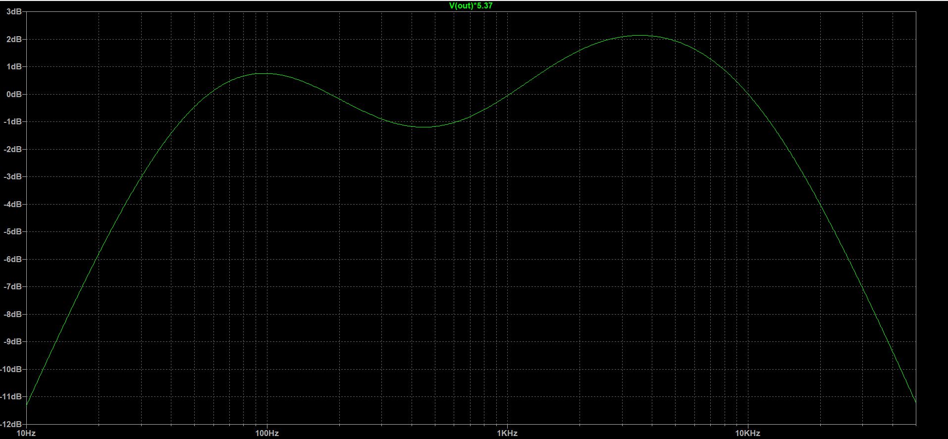

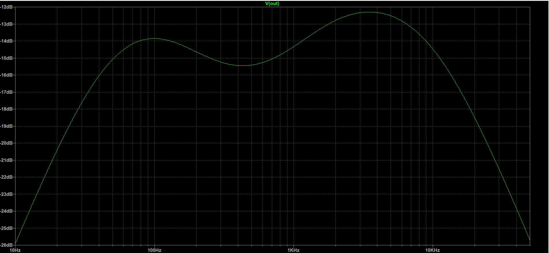

In listening I prefer this EQ slightly to the previous version I published a few days ago, but the differences are very subtle. Only one component value changes between this and the last iteration. R2 on the EQ PCB changes from 33.2K to 30.9K.
The difficulty is that small changes in the EQ affect most of the in band response so even though the amplitude response at any given frequency has only changed slightly the impression can be of a tip in response upwards or downwards or of an accentuation of a specific frequency region.
The behavior of this filter is not intuitive either and that makes it difficult to tune.
Both of the recent filters are a significant improvement in subjective quality over the rev. 5 EQ.
The intent is for the overall presentation to become more spectrally balanced (i.e. neutral) with each iteration. I lack the experience to relate the measurements or even simulations in some cases to the perception of improvement or the reverse, and have to listen to make that determination.
I probably overshare as well in terms of "half-baked" EQs and if some of you feel jerked around by the changes I apologize for that.
Some of you may prefer one or another EQ which is why I suggest trying both of these at least. Systems with a very lean bottom end (not the case here) may be acceptable with REV. 05 EQ as well.

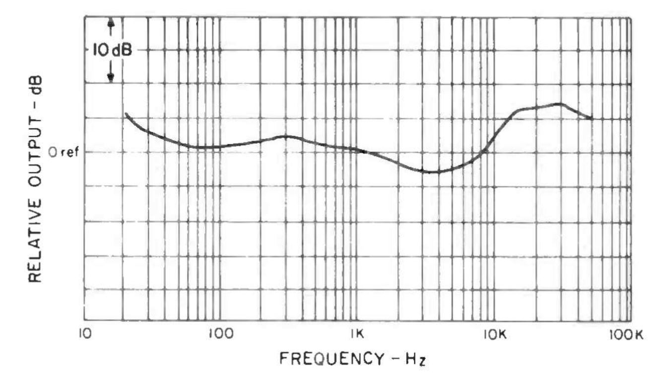

I measured my SG 451C. The angle to glue the cantilever back to the U channel is important. The angle should be 65 degree without VTF compensation. It will be nice to measure the angle under 2-3 grams VTF, too.
Although this thread has gone quiet for three quarters of a year, I can't hep thinking I'm not the only person still watching it.
I'd like to reach back even further, to May of 2018, to revisit one detail. Super, in the discussion of replacement cantilevers you made a nice drawing of the angles involved. But in that drawing the offset of the stylus rake angle is going the wrong direction. I think we all agree that the deviation from 90 degrees in the SRA is to match the cutting stylus. In all modern cutting systems the top of the stylus is closer to the pivot and the tip of the stylus is farther away.
There is not unanimity about how much--some cutters are are set up with one degree offset, some with two degrees. But there is unanimity of which direction it's offset.
If we rotate your drawing so the the rake is two degrees off vertical but in the correct direction, the tracking angle changes too, and winds up at 21 degrees. This is closer to the industry standard than 25 degrees.
This is all academic until we have a measurement of the actual angles with the cartridge in its natural position, meaning with the application of VTF. It would obviously rotate everything in the direction I'm describing, but how much?
Super's original drawing makes this easier to visualize. It's on page 56 of this thread.
