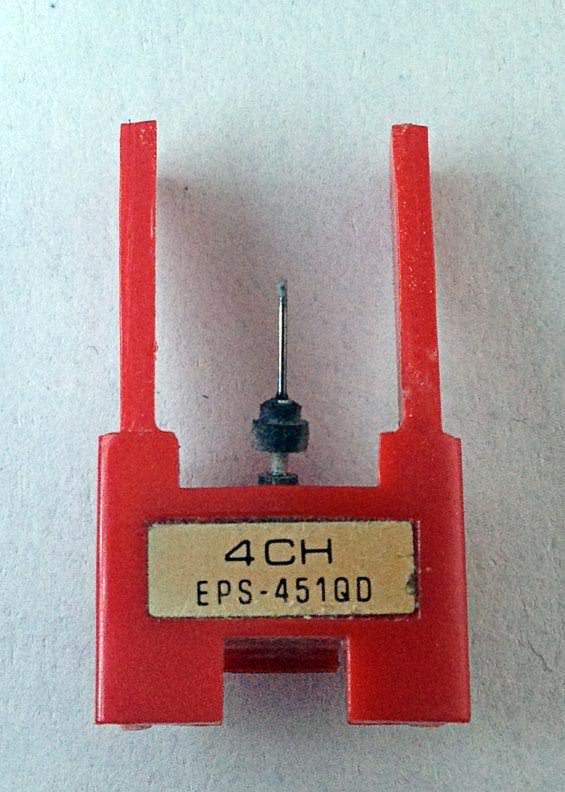

Center of donut to tip of diamond = .205 to .207 on 3 examples. All red nude square shank from the early 80's.
super10018's drawings look great for the angles.

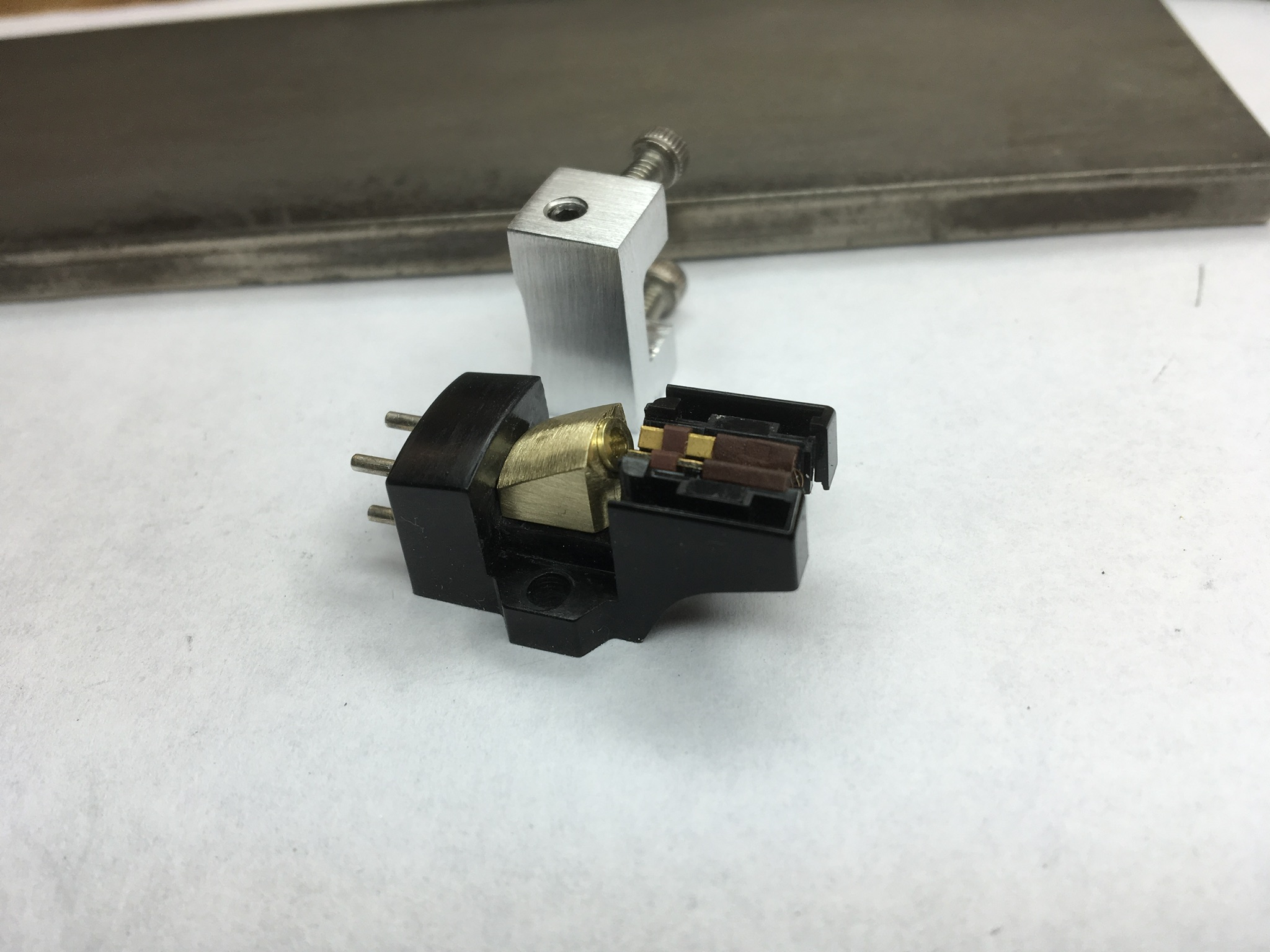

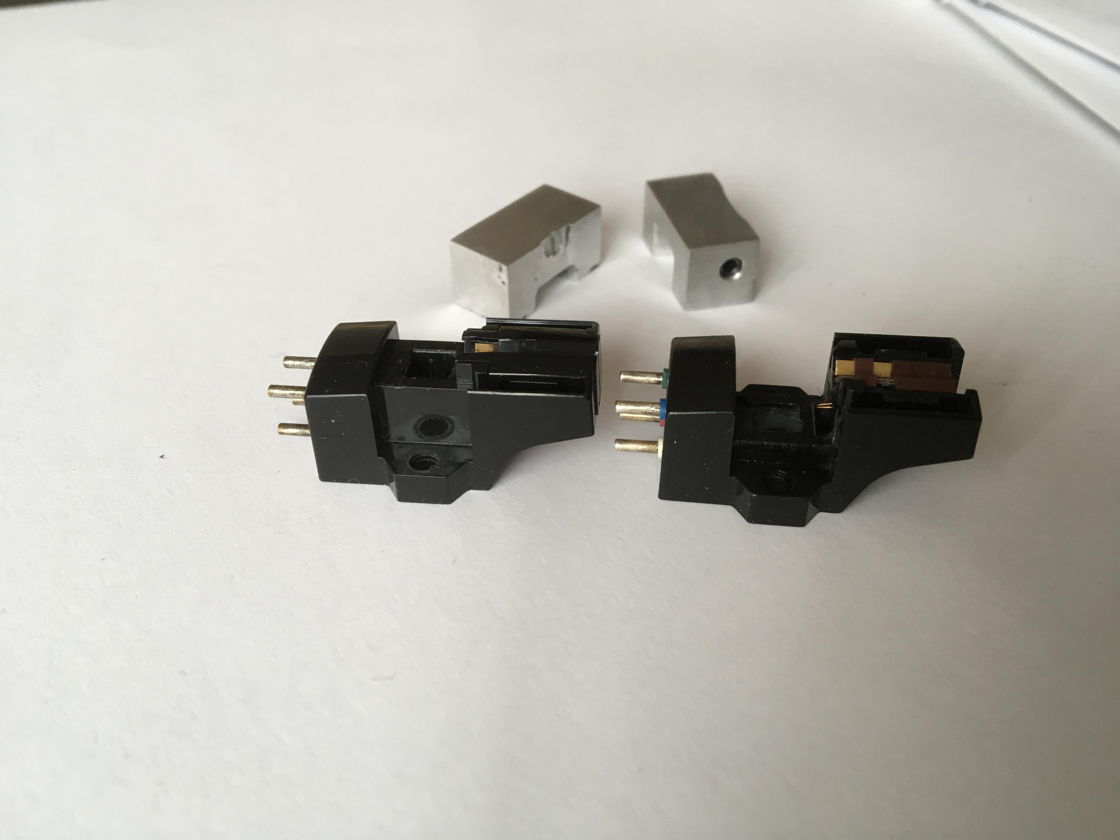

I reasoned that since there is so much real estate around the mounting holes why not use it to clamp and stiffen the body at the same time.
Regards
David

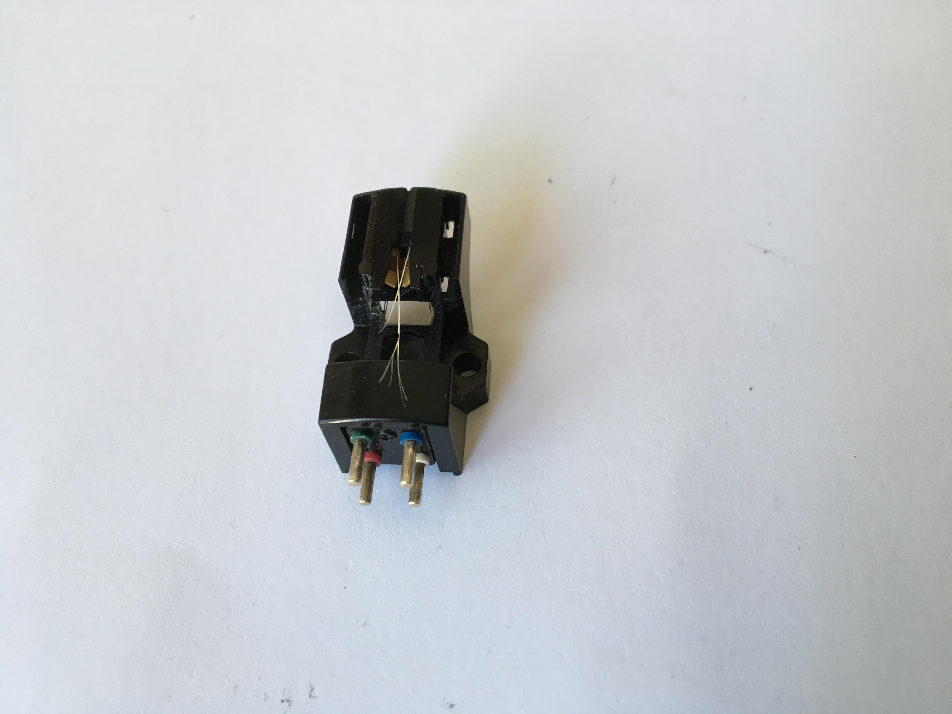

Something probably needs to be done at the rear of the sensors, I found quite a while ago there there was a lot of cross-talk between them through the body in addition to some resonances and other nasties that were well controlled with a blob of blue tac.
The plastic clip that covers the elements ( “ L “ shape) and wraps around the front should be glued in or removed and covered with nylon mesh. That piece doesn’t touch the SG strip holder either. The blutac is damping this area piece along with the top curved cover plate and most of the “ tin can ringing “signature I think...
All resonant cavity’s. Those 2 wings extending from the cantilever assembly and fit in the 2 troughs of that cover are loose also . A piece of paper can slide in and around them. both should damped together if kept. IMO
The actual wires that wrap around the nose I will speculate actually move a little because of the soft nature of its captured surround.
I am hesitant about firmly anchoring those wires other than further upstream filling everything else with hot melt and maybe covering the wires exiting the SG with a soft foam lightly pressing in on them .
There was a reason why they decided to mount the SG elements in such a gooey soft capture material that maybe should be maintained ? Not certain..,.

Maybe pulling off the L front piece and sandwiching a piece of sorbathane against the wire end, that way it’s reversible.

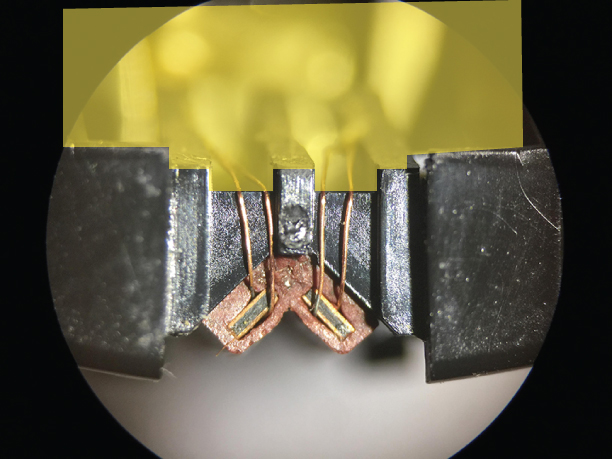

The position of the front dampener will need to be investigated too. All the examples are different.
Also the actual beam position in the body. 2 bodies the beams are positioned less than .001 difference. That would be front to back. 3rd is .003 or .004 different.
That first dampener band is more than likely the most significant one in the whole cartridge IMHO
On both the 450 c2 and 451 the center of the donut pushes on the SG edges equally on my examples

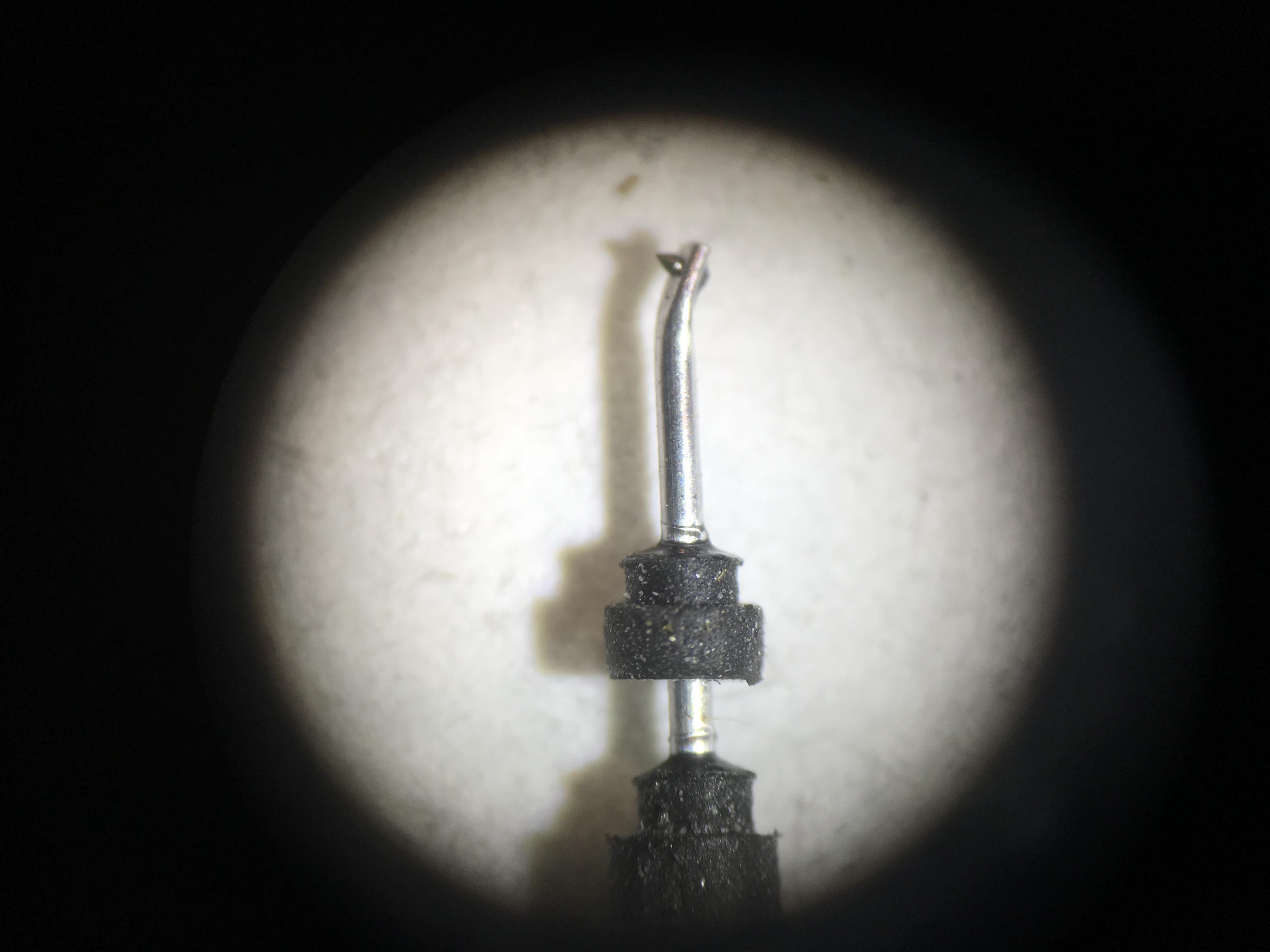

I snipped the "wings" off of a new bliss stylus. Probably crazy as this one differs from the others in that it has a much lower mass stylus than my other two examples.
Something else, at least with the bliss replacements the SRA may be too extreme, performance seemed a bit better overall with the stylus not fully seated. I may investigate this a bit further. (Seems to reduce the coupler angle relative to the surface of the transducers.)

In another design I want to make the cantilever variable as to it position where it presses on the elements.
Here is an article of the Winlabs SDT-10-2 / SPG -10 combo from the Audio Critc 1980. Notice the separation figures...,. You might have seen this back in the day. Sound Smith quotes 25 db at 1k for his version.
I am wondering if cutting the elements soft capture down the middle and making its foundation separate would improve these figures so one sides movement will not influence the other.

I placed 2 brush hairs (.005” ) between the strain elements and the top cap to see if what I thought was a dead space gap and couldn,t pull them out - so it does touch and noticed the impedance went up on both channels
There is a little rectangular piece sandwiched between on one channel only that might have been some kind of production
error correction on all my versions (speculation only)
One could adjust each channels static impedance by trying different spacers if it would make difference and wonder if the sidecscrews on Sound Smith’s version move the elements around for channel balance ?

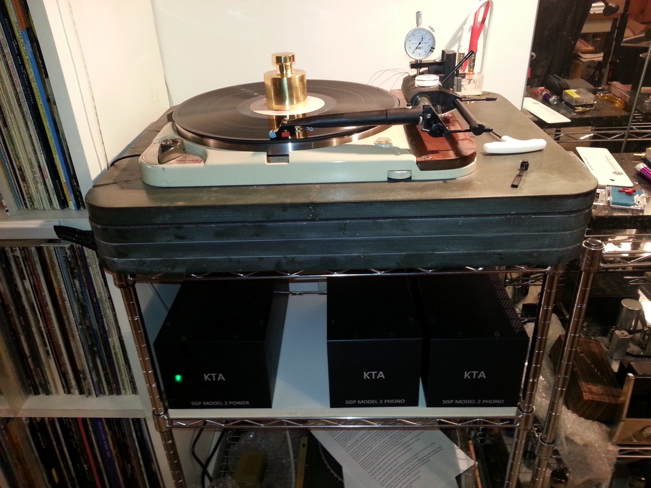

I have been focusing on other turntable problems after it dawned on me that perhaps the strain gauge was trying to tell me something about the turntable.
This table has a Papst 3 phase aussenlaufer motor on it with 3 phase power from a modified Siemens Micromaster MM410, a Mirko stainless steel platter with Gem Dandy mat, no slip platter, and of course an ET-2.5 air bearing linear arm. A friend made me a very nice record weight recently. It shows some promise.
Other distractions include the new amps I have just finished, and the crossovers that I have designed and ordered parts for, but have yet to build.

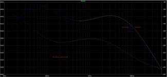

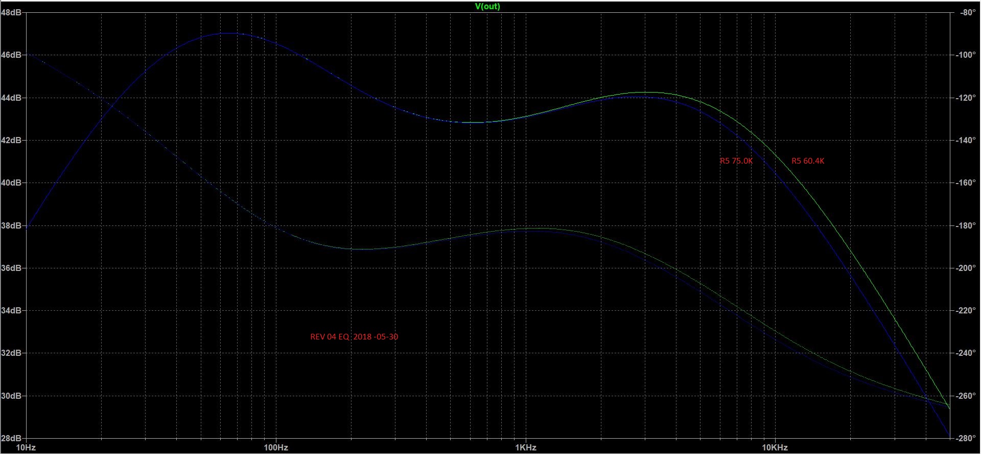

EQ Update: REV.04
As I indicated I will from time to time tweak the EQ and if I think there is an improvement I will share it.
I have concluded that the REV 03 EQ was not quite (to put it mildly) the last word in HF extension.
The new EQ results in a slight boost in response starting at approximately 3kHz and is up approximately 0.8dB at 10kHz which results in somewhat more top end air.
The change is very simple and involves replacing R5 on the plug in EQ card with a new resistor value. (Please use a thin film resistor)
R5 goes from 75.0K to 60.4K, but could depending on preference (and perhaps stylus used) vary from 56K to 75.0K.
Anyone who has not changed the coupling capacitor C2 on the pre-amp board proper from 0.068uF to 0.047uF and finds the bass overcooked should also make this change

Hope that was 0.047uF otherwise you have zip for bass.. LOL
The simulations indicated 56K would be fine, will result in very slightly more rise at 10kHz and below.
It is a significant improvement, just a little more air up on top.

Another EQ Refinement
Sorry guys, I've done it again. There is yet another EQ iteration.
I have increased the boost a bit more, reducing R5 to 49.9K which based on the last measurements (REV 03 EQ) helps to fill in the response trough between 1kHz and 10kHz a bit, it does increase the extreme HF response some as well, but I've found the lack of HF air one of the bigger problems with this EQ so IMO it's is better all around.
I don't think I am ever going to be able to completely flatten out the peak, but killing the upper mid range and lower treble response to control it doesn't sound right either.
