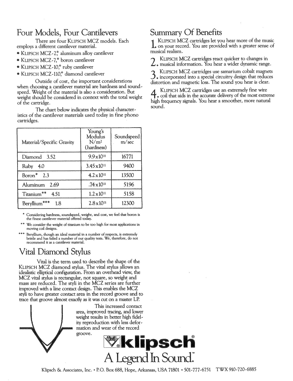

Here’s an add I found on transmission speeds/specific gravity’s of various cantilever materials
JCarr designer of Lyra mc,s mentions this also . He did mention damping changes are needed other then a simple material swap.- Audiogon discussion-
This is beyond what most of us can accomplish or even the retippers.
Even though I will probably match them, you can see even when keeping the same lengths,
Bending strength modes are still different despite similiar dimensions. It is a violent vibrating system after all and everything matters
Regards
David

But they never fully admit WHY transmission speed matters. It's almost as if they've all worked out that cantilevers work as a transmission line,but none of them want to openly say that Shure got it wrong in their AES papers.
Beware of the specs on useful magnification for inexpensive optics, eye relief goes hand in hand with this. I've been burned. Have you ever used a Nipkow disk microscope?
No. I don't have any experience with microscope.
That's interesting since presumably they had the resources to figure all of this stuff out as one of the biggest cartridge makers on the planet. I'll admit I have wondered from time to time exactly how the cantilever plays its role, but haven't bothered to investigate - it requires physics I have forgotten or never knew.. (So many other things vying for more immediate attention) lol

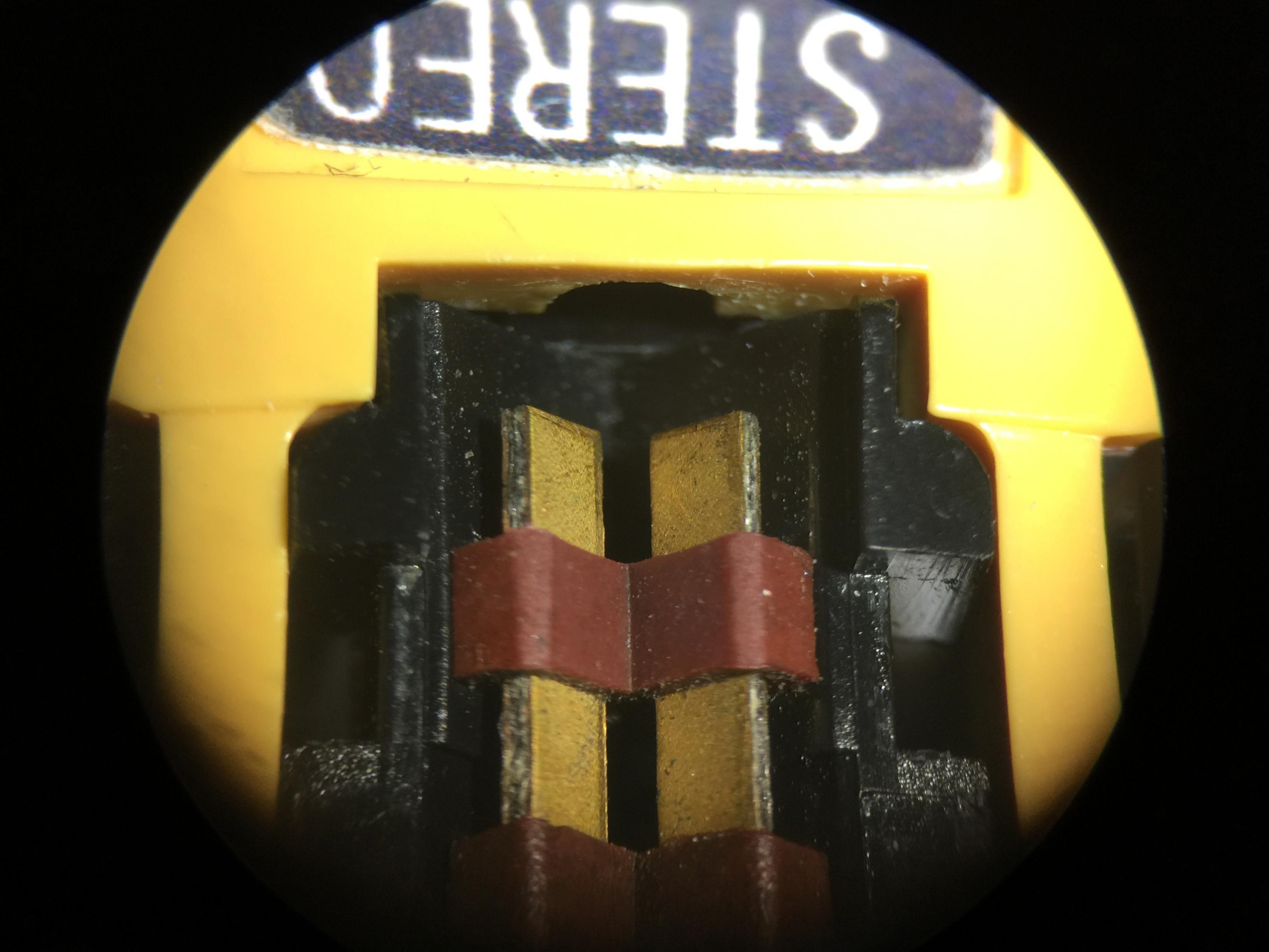

Hi AVWERK -

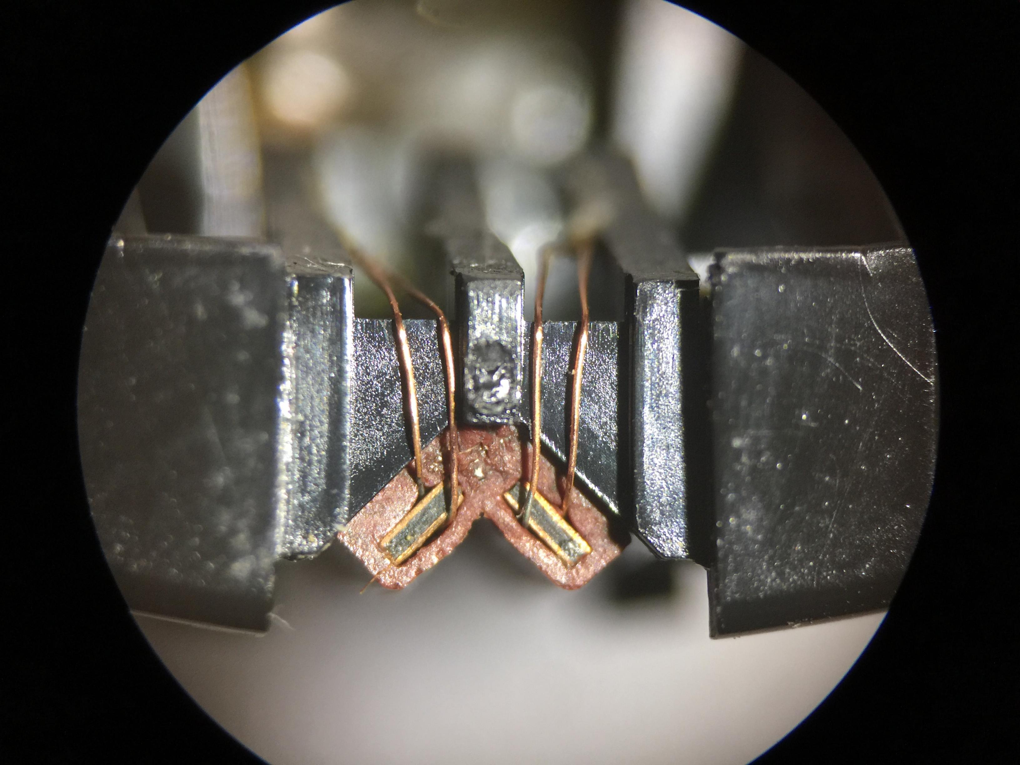

In your picture in post 550 there seems to be a ridge of epoxy a short distance in front of the coupler.
Is the rubber coupler still fixed to the cantilever or have you moved it? I am wondering if they can be moved or are they glued completely with what seems to be epoxy and maybe would tear if moving is attempted.
Dave
Dave

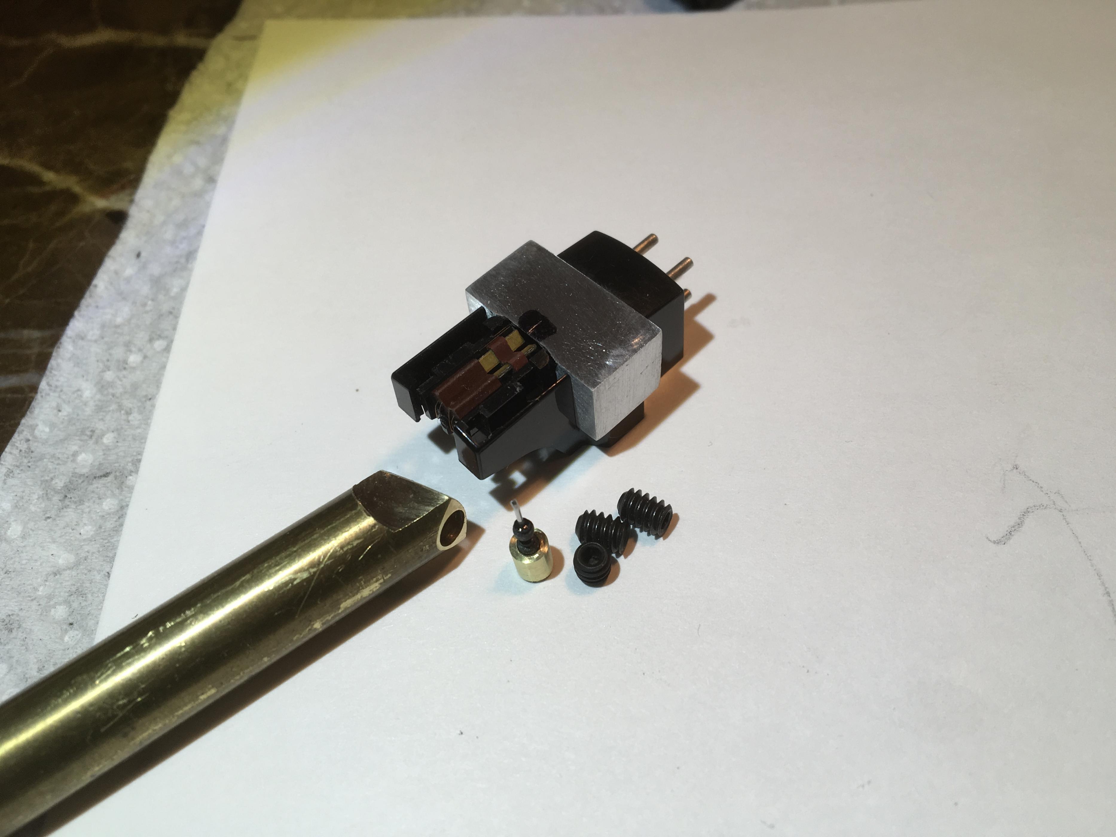

Yes it is stock. One could make a sharpened brass tubing the size of the cantilever and slowly rotate under the sponge rubber for removal
Messing with the compliance of different rubber or silicone will most likely change the frequency response ,just a guess on my part though.
Plus the SG elements are surrounded in a another soft material.
The whole shooting match is placed in a very soft environment overall when you start pressing in on the materials.
I will first make another removable cantilever aluminum structure to house the cantilever with set screws pressing in on a brass square post /cantilever Mount -with the screws on the sides so I can move the post left or right for needle centering and maybe up and down also.
This will require cutting out the body down to the mounting base where the removable tip structure stops. The aluminum will be captured with the mounting screws for rigidity.
I am beginning to think the actual body itself is maybe not a huge issue when you consider
The the amount of soft material the SG elements lay in. This may render a stiffer housing unnecessary. The voids should be filled in of course.
I will do the the cantilever structure first and then consider the body second, that way others could easily do the same if there is a sonic improvement
Tightening up and changing out all the soft materials to hard would be an interesting exercise and maybe an ultimate end game
