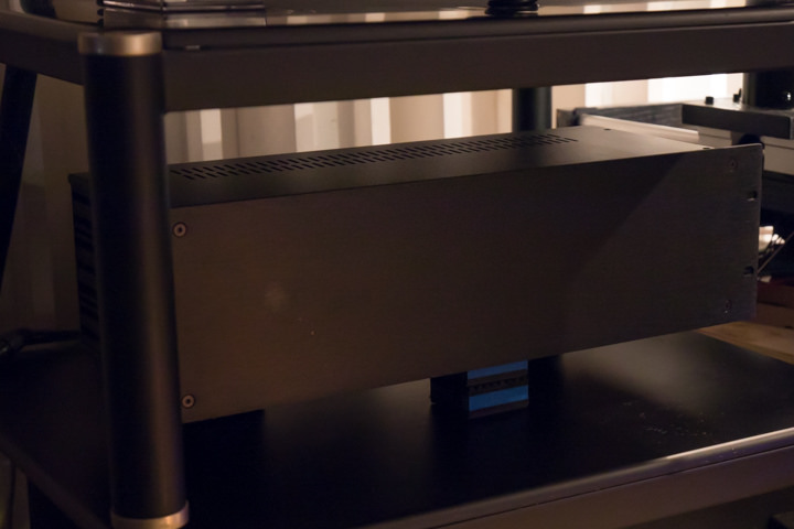

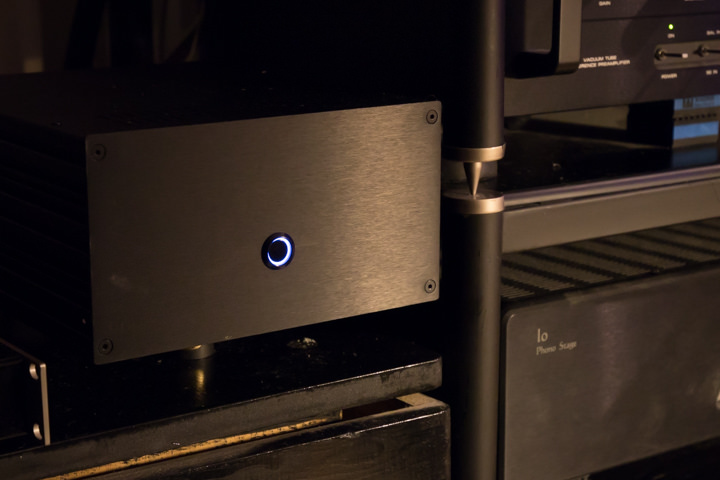

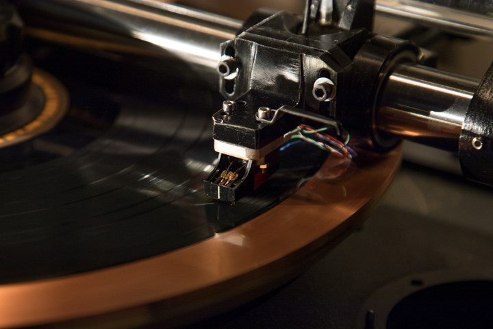

I finally got the SG phono pre done. I had trouble to finish the phono due to my very limited electronic knowledge and experience. Kevin was kind enough to repair and finish it for me.
My reference LP playing back system consists of an Aesthetix Io phono. It is two pieces of phono with power supply in separate chassis. I love this piece of audio equipment and own it for more than 10 years now. It has almost unlimited dynamics and very high gain for almost any low output cartridges. The cartridges I have in hand are Ortofon A90, Benz LPs, Modified and re-tipped Denon DL-103R and Koetsu Rosewood Signature. So, the SG system has a formidable task to challenge my reference standard.
I started to set the VTF of Panasonic SG EPC-451C at 2.1 g and ended it with 2.8 g. The cartridge sits lower than I expected. Even VTF at 2 g, I had no trouble to tack the records. The gap between surface of record and the body of cartridge is about 1 and 1.5 mm. I used cantilever of SG cartridge as reference to set its VTA. The tip of the cantilever is parallel to record surface.
For the cartridge, I did a tweak on it as I posted it before. I used a thin piece of lead to insert into the U channel of stylus with some epoxy.
From the photo, you may see the cartridge is naked without the cover because I took it off to peek inside of cartridge but I misplaced the cover and I can’t find it now. So, the cartridge has to be running naked.
Once I turned the SG phono on, I noticed it is very quiet. It is quieter than my Aesthetix Io although I understand my Io phono may need some new tubes.
The SG system has very nice high frequencies, detailed not harsh at all. For some incorrect set up MC cartridges, you can heard mechanical sounding caused by stylus. The SG system faithfully renders string instruments. In my system, SG cartridge doesn’t sound “splash” as someone described here but my ears can detect there was a hint of “splash” sound around 1.5kHz to 2kHz. Further damping for the cartridge is probably needed.
The SG system performed well in low octave. In fact, I had to turn my pair of subs down a little to reduce bass information.
The SG system also has excellent sound stage. Its sound stage was total 360 degree dimensional. The depth and the size of sound stage were also correctly rendered. I enjoyed it very much when I was playing Verdi Aida, complete opera conducted by Karajan on London.

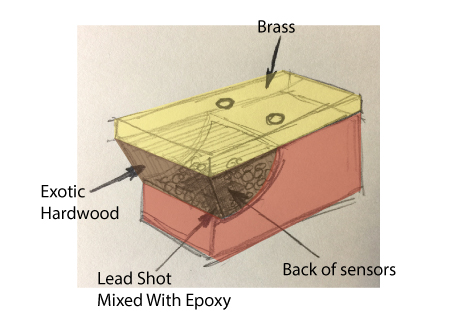

I will definitely try blue tack first for now. I am also thinking more permanent solution. After listening to SG system, it somewhat changes my mind. I thought the most important thing to do for SG cartridge is to change its cantilever. But now, I think it may be even more important to tweak the body because I feel the original stylus is doing pretty decent job. I didn’t feel I missed details too much comparing good MC cartridges. Peter at Sound Smith told me same thing.
It seems to me that we don’t have the option to re-make a complete new body so modifying the original body makes sense to me. This is what I am thinking now. Please see the image.
Fill the body with lead shots mixed with epoxy.
Glue a curved exotic hardwood to support back of sensors.
Use a piece fo 4 mm thick brass as base.

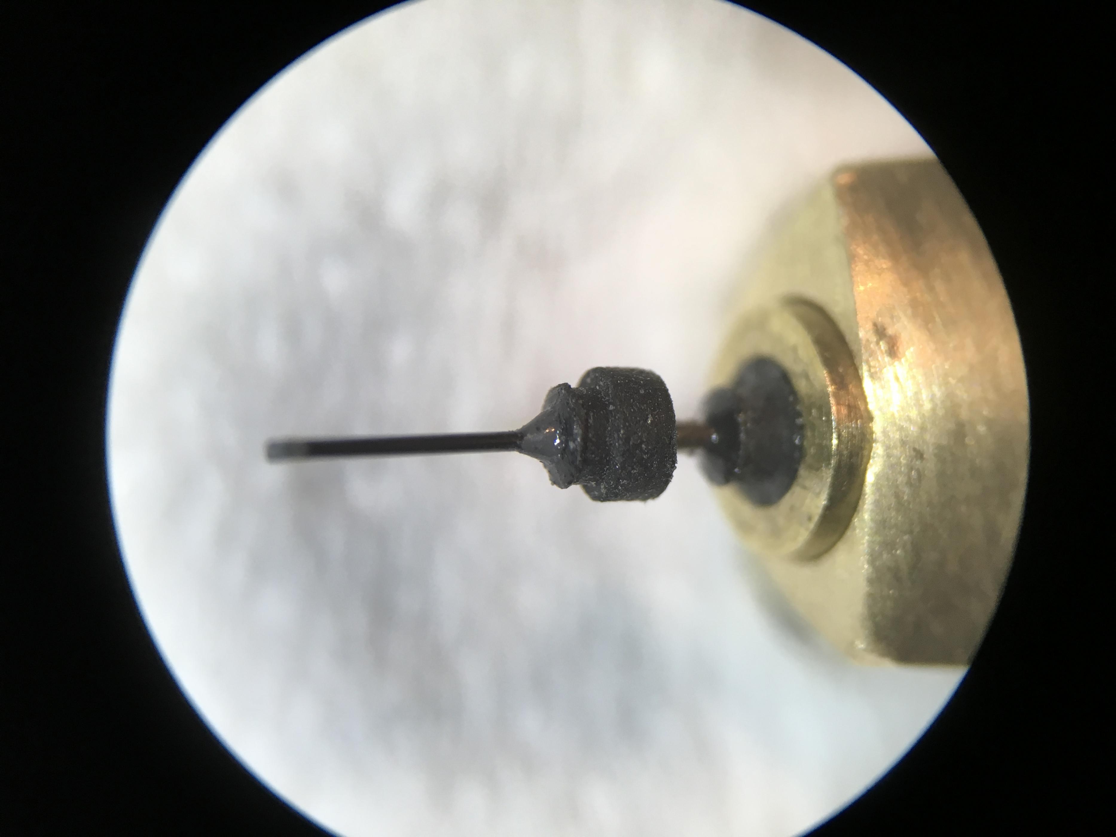

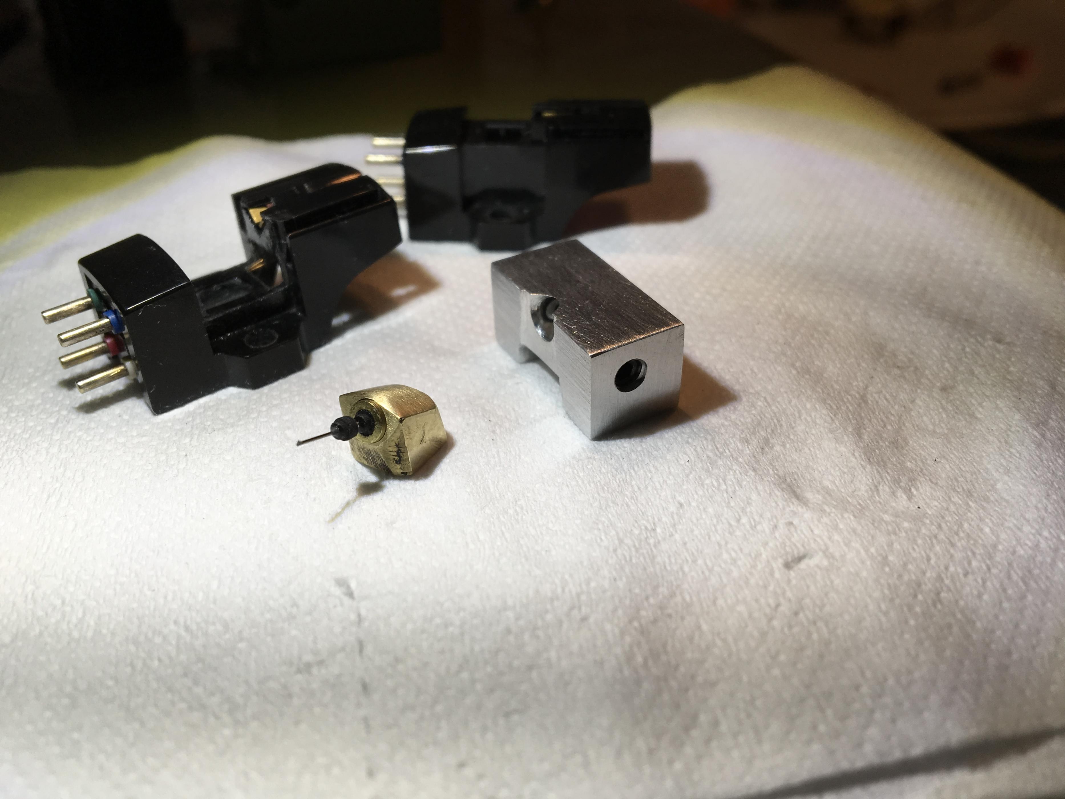

Sorry for the delay as personal attention was needed in other areas of concern.

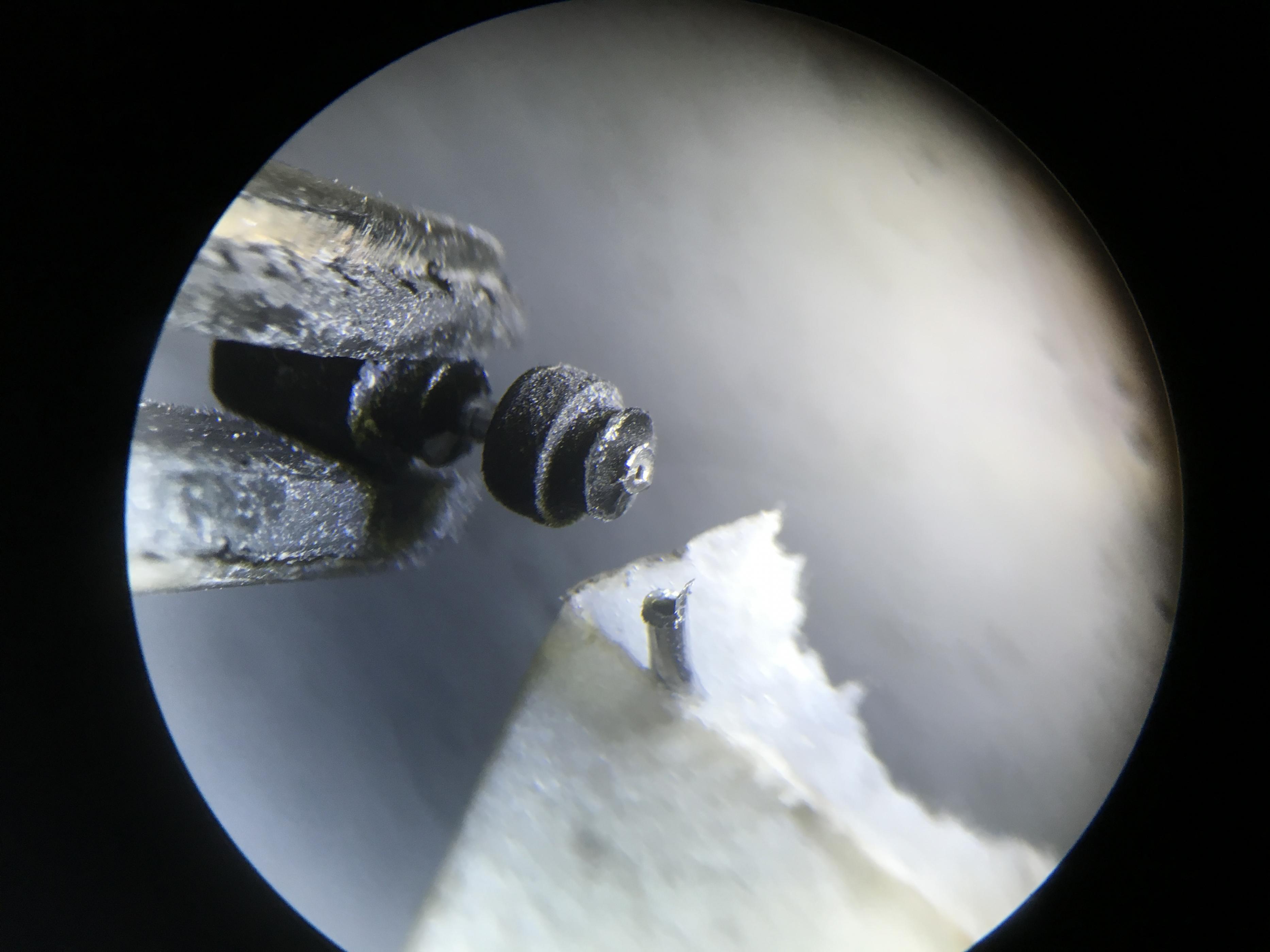

Some pics of progress..
It took 2 hands braced against the counter top under a scope to insert the boron cantilever with tweezers dabbed in epoxy. All epoxy mating surfaces were cleaned with Acetone beforehand.
This happens to be a 450c2 modified body first to see how it sounds.
I will move this to a 451 since this is the best version I have listened too so far of the stock SG cartridges.
The middle pic shows a stock unmodified body near the top cluster
I can adjust left and right as well as in and out in relation to where I want the donut to press on the Strain elements. All for perfect alignment perimeters as well as stiffening the stock body by being clamped solid to the head shell.
Now to hear if it does anything positive over a stock version
Expectation bias needs to be put in proper perspective and will compare it with the other stock examples
Enjoy !

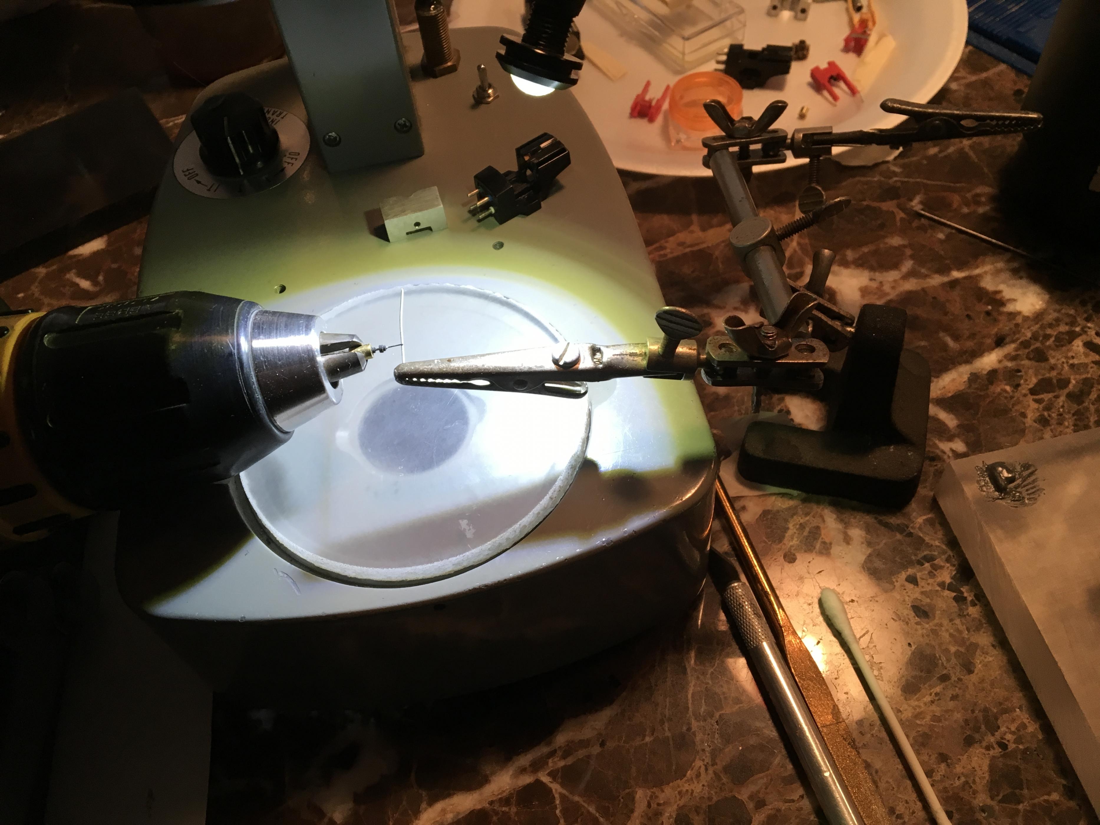

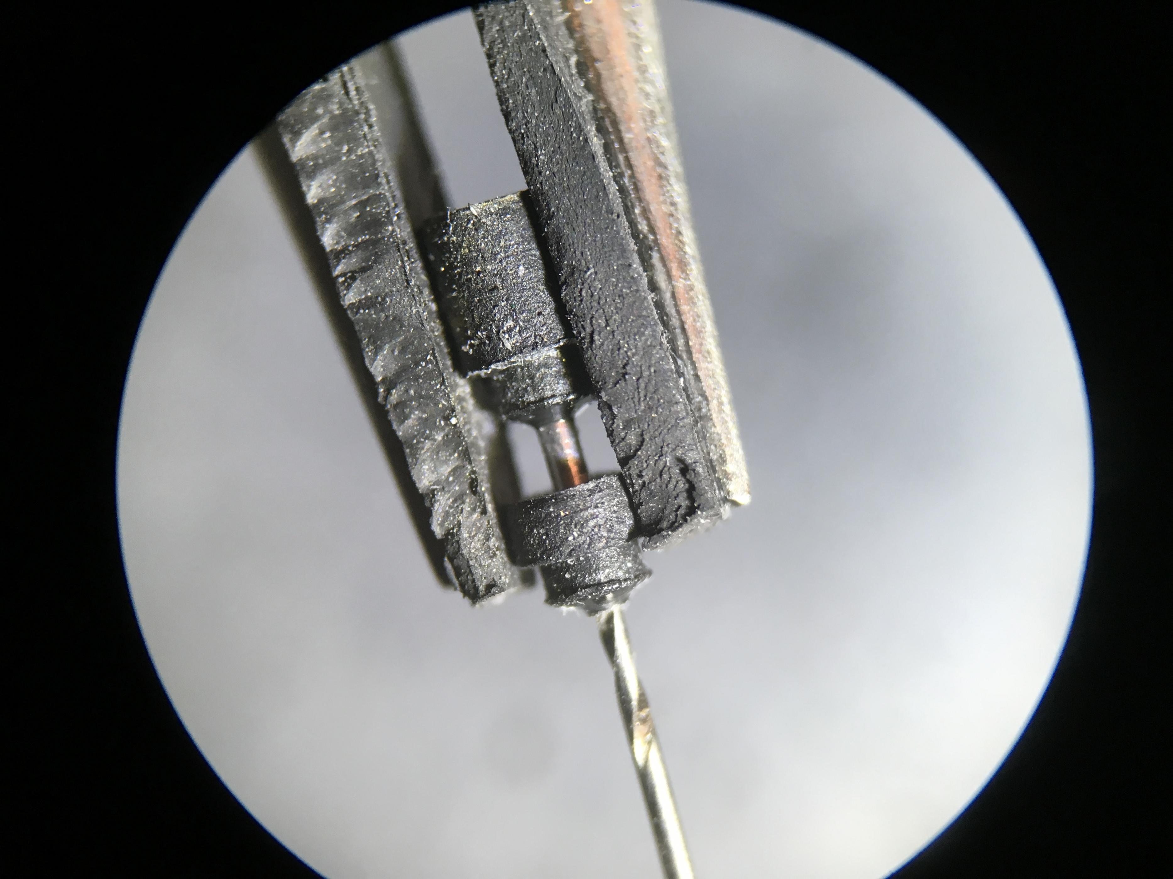

I was able to spin and look at the centering before bracing the boron rod while it dried. I use 4 hour setup time epoxy instead of the typical 5 minute brands available
I tested 5 brands for hardness ( 3 week cure time ) by poking them under a scope and noticed this was the hardest despite what all their specs said
I did mix in some diamond dust in all tests examples as well as without.
I did add it in with this cantilever.
I can remove and cut away and start over while saving the boron if I want so all is not lost if something goes wrong.

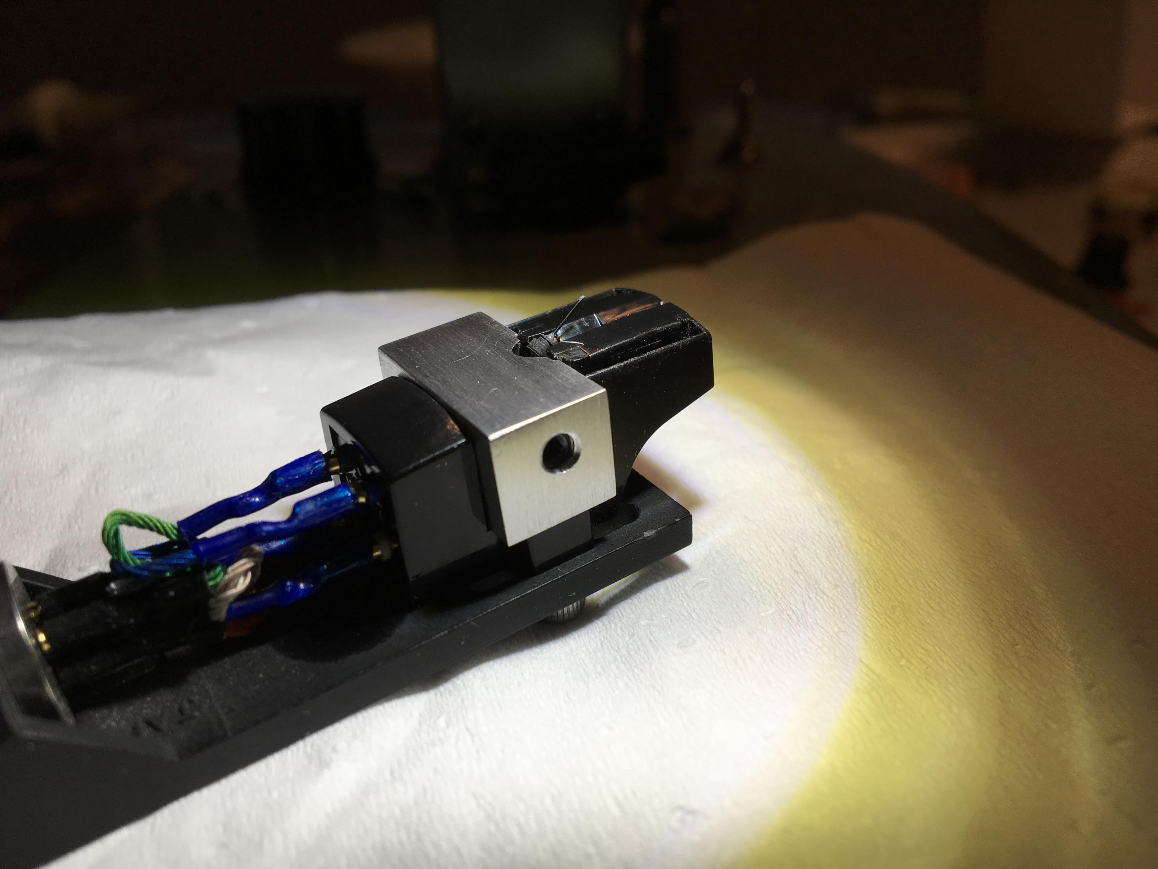

Hello , Dave
First I wanted the ability to adjust all perimeters where the donut presses in on the strain beams left ,right, in and out or where the donut actually presses on the strips.
To be able to do that, it required the brass housing which took up the stock body real estate and hence the cutout depth.
Out of 4 SG cartridges only 1 had perfect centering and I wanted perfect alignment
The brass flat section rests on that cutout actually and sets the proper location for the cantilever/donut angle.
The side set screws allow left right orientation and crab the brass housing from both sides and lock it tight.
There is another set screw on the bottom that locks the brass cylinder that holds the stock cantilever pivot point.
I was careful to not allow a tight fit and the hole was about .020” of clearance bigger all around the foam pivot and used 100% pure silicone to hold it stable.
I used 6061 T6 aluminum for the removable section and made a tight press fit right up to the edge of the SG strips and the added benefit the whole enclilada clamps the remaining plastic body very rigid or more so than a stock version could ever accomplish on its own.
No slop front and back and requires a firm press fit before screwing to headshell.

I recently acquired a stylus from Dave Slagle (he's a friend), initial setup and listening tests are promising. Some break in time is required interestingly enough.
I'll not be able to do any long term listening and tweaking until it cools down here. It is so hot here in Boston at the moment that the additional heat load from the amps results in intolerable temperatures here in the man cave in about an hour of listening. Six channels of SE DHT power amplification plus the ancillary electronics results in close to 900W of dissipation during listening. Welcome for the 8 months of the year here when it's not particularly warm, but oh so not welcome now. The AC down here cannot keep up and is noisy as all get out.
The system has changed massively over the past few months which provided the opportunity to add 4 new channels of amplification and electronic crossovers. I had the time to design and build all of this stuff as I was between jobs. I have a new & demanding position with a consumer electronics company so time is at a premium as well now.
All of this means I have lots of work to do ahead of me to get the system just "right."

Completely stock configuration, and as long as the cradle the transducers are mounted to semi floats it seems to align OK.
One of the possible benefits of the boron cantilever and MR stylus is a longer service life. I am not getting great service out of the OEM Shibata, about 300 hours is it, so the MR might give twice that.
Possibly a lot less work than I initially thought as I am still listening to it. (Digital source) The analog side of things has significant issues at the moment to be resolved this fall.
This is Dynavectors micro-ridge photo of the Namiki profile and you can see as it wears it maintains its tracing width tracking.
However, when it gets down to its limit it will start causing record wear.
I strongly suggest using Last Sytlast on the tip every Side played.
I use a small round stylus cleaning brush and brush from back to front in one direction and apply the Stylast with a dab of it
We have a solid boron rod and no mitigation will occur that might with those hollow versions
Haven’t tried their other products, but have used this stuff for over 30 yrs and feel it does help reduce tip wear.
There are plenty of Research info and electron microscope photos for proof it’s not snake oil.
