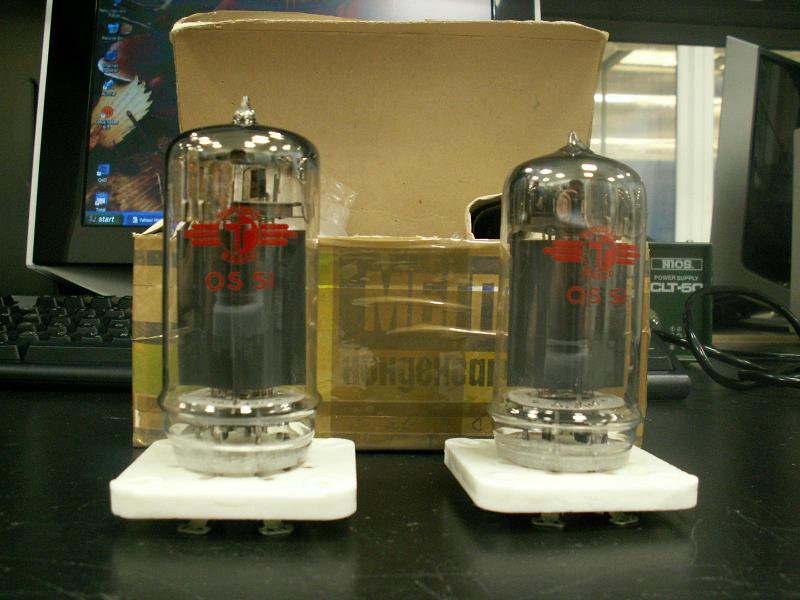

Recently I bought a pair of OS51 tubes (Pa=45W) that should give considerably more power than PL519, when running from 900V B+. Right now my hands are full, so I will post the results later...
Try doubling the number, or perhaps more, but the spacing should remain the same. A thicker, silver plated wire is a must for maximum efficiency.
The 813 would be a nice candidate for an overkill plasma tweeter, but it needs 1,5kV++ for full effect. I even considered GU-81, but that would be a really hazardous toy to play with.

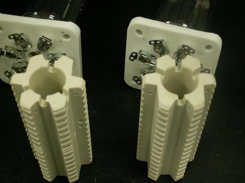

Hi there !
The wire does not have to be solid silver, that's a waste, just silver enameled wire("skin losses"). At higher frequencies only the outermost layer of wire is conducting, therefore we need greater surface. Thin, enameled copper ribbon would be ideal, but that is almost impossible to wind on a coil former.
I bought the materials in Budapest, Hungary.
A company called "HAM bazaar" is selling surplus military and radio-amateur stuff at really competitive prices (OS51 for less than 10 EUR, 40x90 mm ceramic coil former for 0,4 EUR ...)
Lord Winter this is very nice tubes and ceramic.
I made litlle search for tubes, but i didnt find it.javascript:smilie('

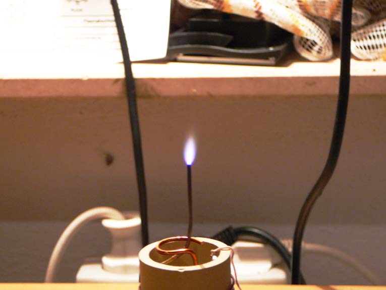

Yesterday i tried with double windings and working much better.
bigger flame and tube is not getting redjavascript:smilie('🙂')
smile
But i got other problems. It makes computer to confuser, cd player is not working properly, when is plasma tweeter working.
I guess i have now to make metal case and ground it.

Well done Bostjan !!!
You will never find almost any data regarding the OS51, but actually it is an exact copy of PE 1/100 - datasheet available.
RF shielding is mandatory !

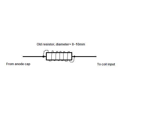

However I know a simple cure for this problem, it might help.
All you need is to put a "harmonic supressor" between the anode and the coil. Just take an old 50-220 Ohm / 2-3W resistor and wind a few turns of 1mm copper wire on it (6-10 turns will do). Solder the wire ends on the resistor leads and youre done !
I cannot guarantee the succes, but it will help to minimize the interference in the lower TV band.
