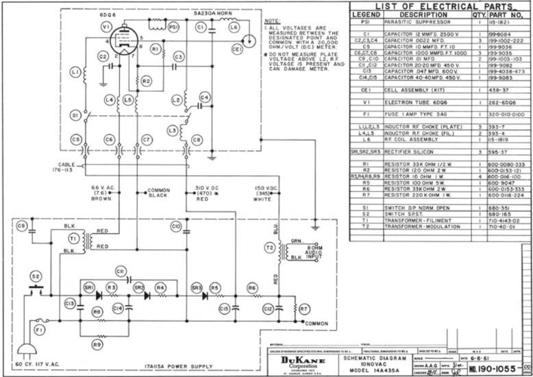

Recommended readings:
http://www.ionovac.com/dshistory1.htm
http://www.roger-russell.com/ionovac/ionovac.htm
Another point of research is the Hill Plasmatronic speaker.
Driven by 4 x 572B, iirc.
There may be threads in the archive here too...
