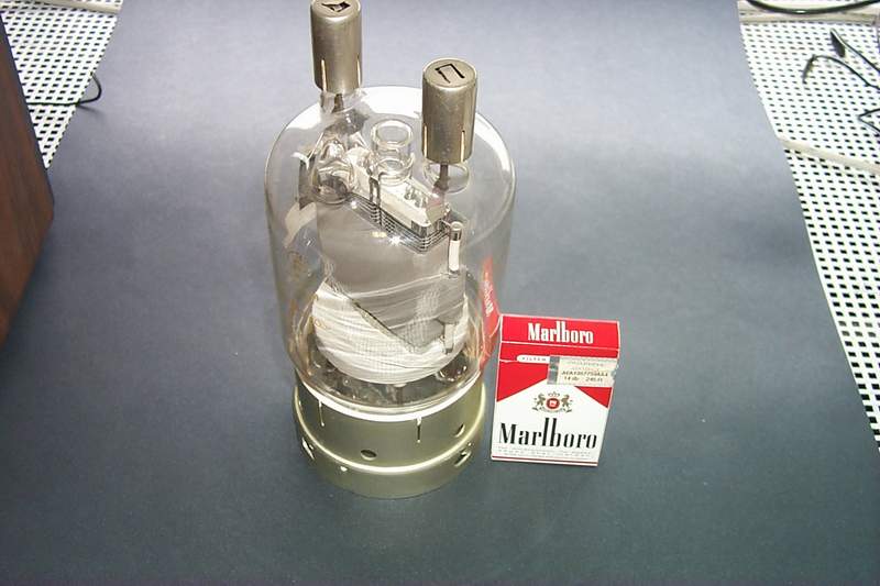

Word of Warning
Please guys don't wander off too far.
I believe all of us wants to build a working plasma tweeter!
During the experiments with my friend Ivan we found two serious issues:
1) Load matching: we used PL519 as oscillator, 600 V for B+,
120~140 V for g2, 15 turns on a 35 mm coil former.This is a
working setup but not ideal, perhaps the number of turns
had to be increased...
2)Modulation quality: altough we used heavy high-pass filtering
on audio signal, the unit is easily overloaded with mid
frequencies and starts to
distort, thus compromising dinamic range.this is perhaps caused
by inherent non-linearity of PL519's screen grid.In commercial
AM transmitters anode line modulation is used, i believe that
this is more linear.
As long as i dont get my babyes, i want to hear a few good advices regarding this modulation issue.
