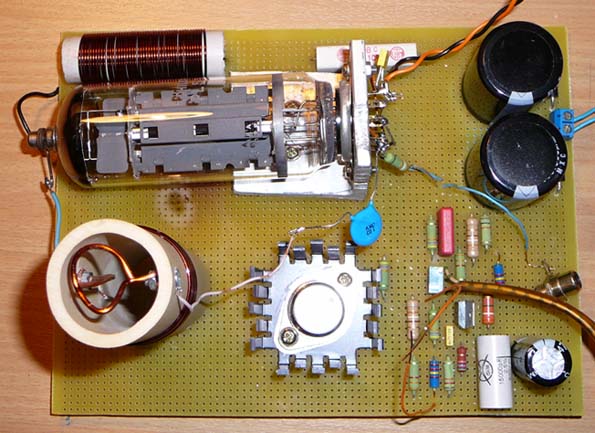

I have seen some pictures of your plasma tweeters. Do you have some more information regarding your speakers? I know you have solved the ozon problem with the high temp in your speaker. You use some kind of horn. What schematic do you use and what does your flame thrower look like?

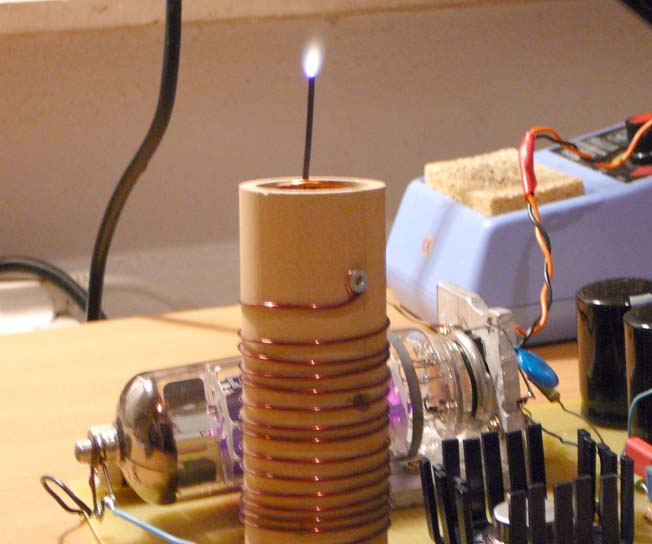

FWIW, I had the occasional red plate which IIRC was related to the coil. I experimented with various windings with various results. Your flame does look good. I feel you could extend it maybe 2-3 times in length and present a better load to the output device.
Your windings are very close. This creates a high interwinding capacitance and the resonance Q is less than optimum. You may have better results if you leave a 3-5mm gap between each winding. I would keep the same number of turns.

Hi Indm,
thank you for reply.
I will try today 3-5mm gap between each winding and make report.
Ceramic base i got as sample of one ceramic factory here in Slovenia.
I attach one foto more, if someone would interested to build.
This is just test setup. I plan to build maybe with alu horn.
regards, Bostjan

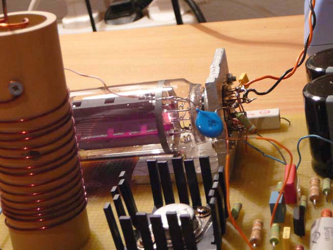

yesterday i tried with your sugestion of Tesla coil.
Distance between windings was 5mm.
Flame gets 2x bigger and efficiency is also better. javascript:smilie('😉')
wink
Music is now louder than before.
But still tube is getting red after 2 minutes.
Is it related this to the tesla coil?
regards, Bostjan😉
