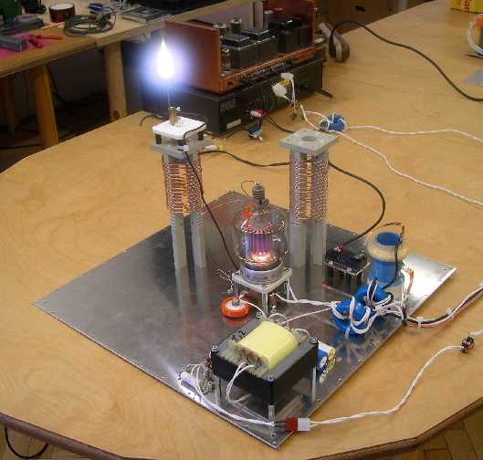

Bernhard, very clean implementation! 😀
DIYers, note the perf metal (grounded/shielded) enclosure around the electronics?

Hello,want to build my own too
Is this rf part correct.See my picture please.
Capacitors are mounts behind the choke coil(no value for the moment)
Is it correct?
At 35 Mhz ,are they necessary?
In mostly schematic they miss.
Thanks for reply.
Is it correct?
Thanks for reply.

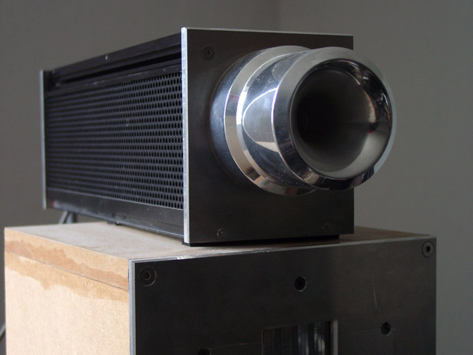

I had the acapella tw1 for repair and it was very lame performing for anybody that would use them at more than 90db...
Audio distortion of a plasma tweeter is never published for a reason. I measured 5-10% distortion at 110db@3inch (equal to ~92db at 2Meter listening position)
they do not worth the effort at all IMHO. (very respectfully)
acapella ion TW 1S plasma tweeter measurment and impression

Hello,
How you designed your horn?Please.
Have you a draw?
