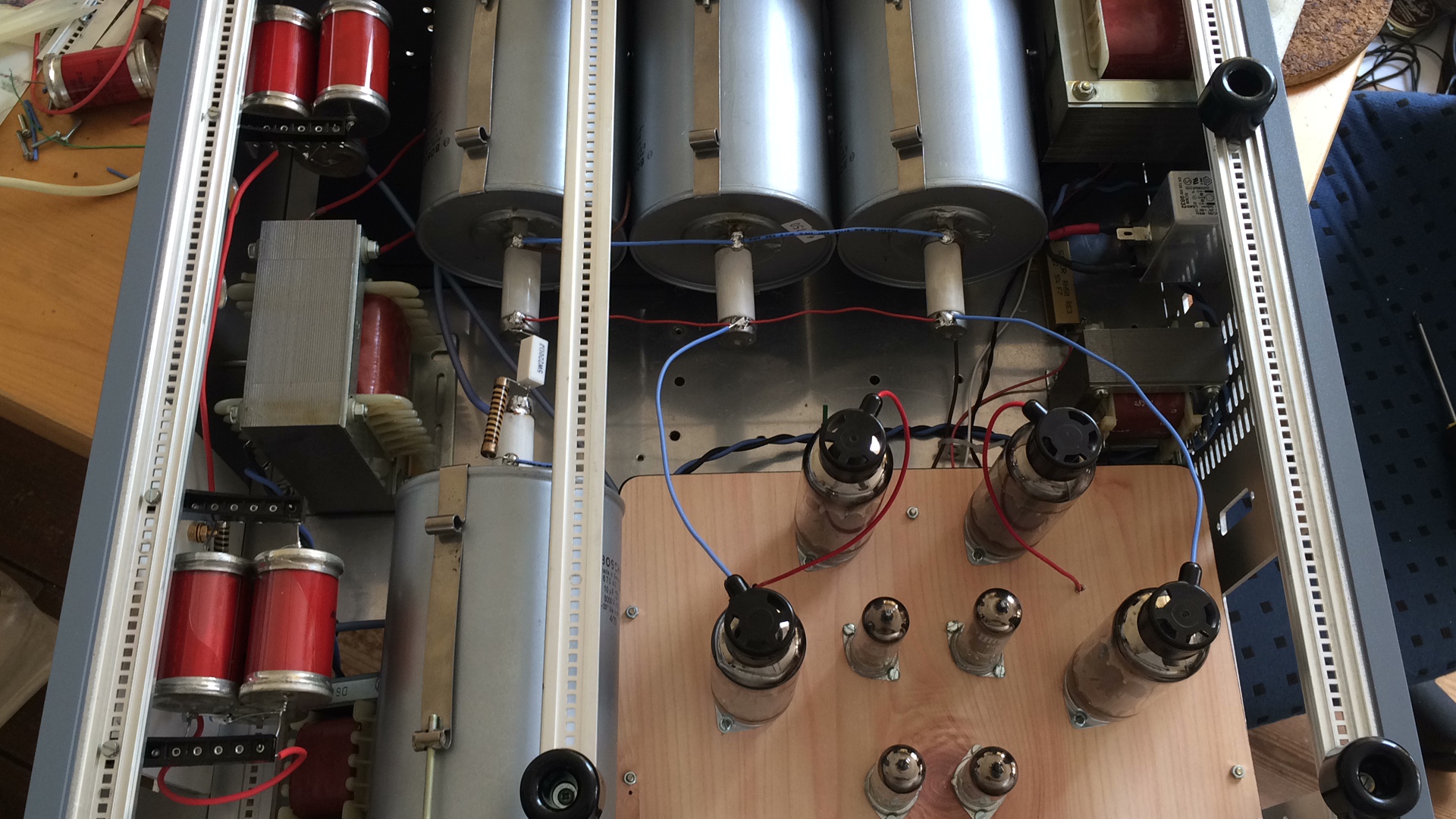

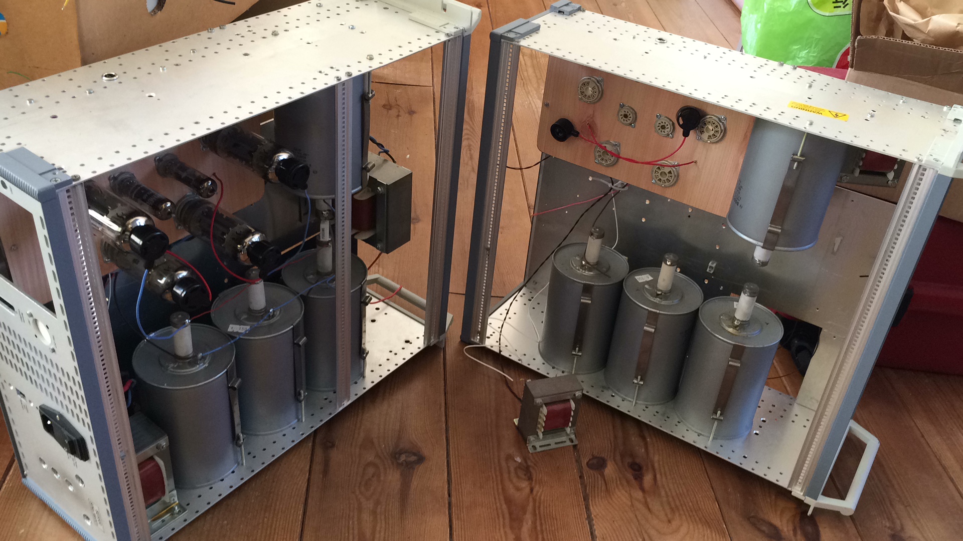

Hello,
I builded my own plasma tweeters because it was a simple low cost project and it abble to me to learn the tubes electronic.
I don't earded any berylium tweeter but they are my best tweeters of my speakers.
