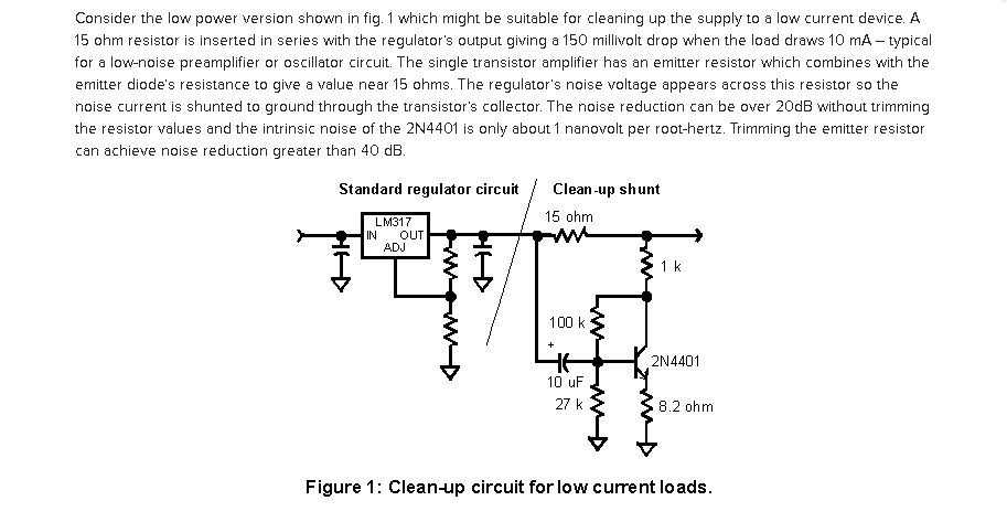

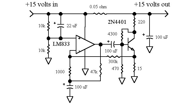

431 reference as shunt
This noise reduction method is better (easy). It integrates
most of wenzel's ultra shunt into one little package.
At <200nV/hz , not bad .... but still not close to wenzel's
last op-amp shunt circuit (below 1= <20nv/hz).
Finding a op-amp to work on 5.5V might be problematic , so
just the simple one BJT shunt (below 2) still gives <100nv/hz.
So , just a LM317 (emp) sot232 IC plus another smd BJT (and a few caps/
resistors) gives at least twice the performance as the standard IC
shunt.
I guess where you use this tech depends on how sensitive the digital
IC is to the noise ??
This is definitely something for the "toolbox" that allows for above
average designs !
PS - three "levels" ....
TL431 = 200nV
(below 2) = <100nV
(below 1) = <20nV
